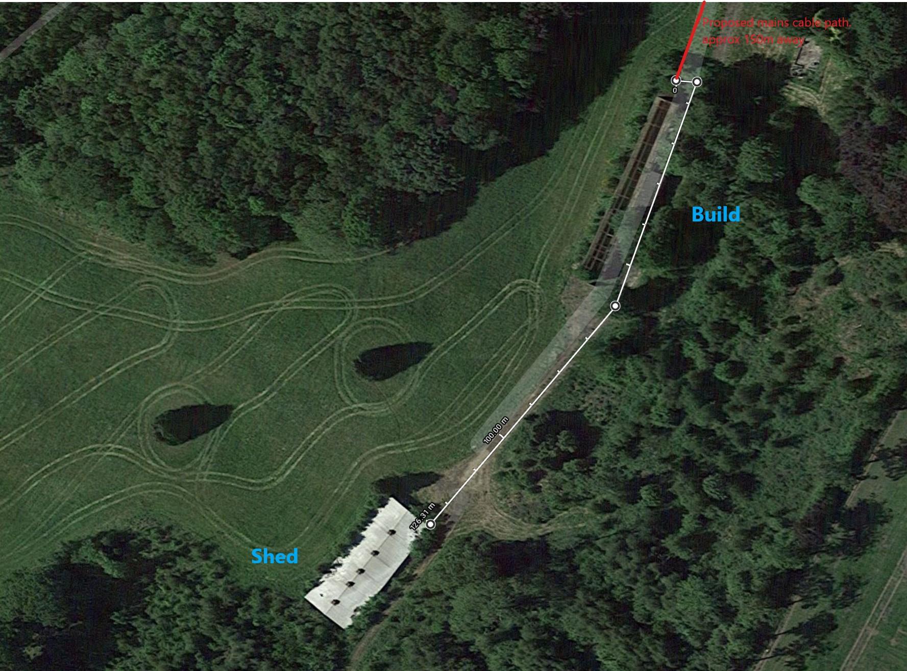

Nickfromwales Posted November 29, 2021 Posted November 29, 2021 Power over Ethernet ( PoE ) will do 100m. Can you run a Cat6 SWA? Can be surface mount if you don't want to dig.

pstunt Posted November 30, 2021 Author Posted November 30, 2021 Having looked at Damon's off grid solution it truly looks impressive, although bewilderingly complicated to me. Although it seems to me that perhaps PV's may not give the power required during the winter ? At least not on a small scale. I'm having too rethink the whole approach. I will try and better explain my dilemma and have attached a crude picture to help set the scene. This is a rural location with our selfbuild hopefully to begin in the spring. The end goal will be to get mains power to the shed, which is about 120 m away from the future house. The nearest electricity pole is about 160 m in the other direction to the house. We were not intending to go live with the electricity until towards the end of t he build. Figuring the build will take 12+ months, that means at least 18 months of no power to the shed hence my initial question to get cameras up an running. We are not having PV on the house but having read the replies here, I was wondering if it would work if I put a typical PV setup on the shed now and then have that link in to the house once completed. Possibly with some sort of battery setup which would be enough to power lights and cameras / router in the shed ? I am weighing this up against the alternative option of having a temporary meter and digging everything up now. This will be the most effective way and possibly the cheapest in the long run but there is something attractive to being self-sufficient.
