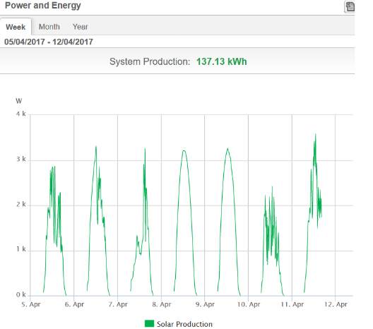

ragg987 Posted April 11, 2017 Posted April 11, 2017 (edited) Just saw this on my PV monitoring - a pair of beauties to remind me of the weekend of 8 and 9 April: It was great to bask in the spring sunshine and warmth on that west facing patio, barbie tongs in one hand and a drink in the other. Moments like this are what make that long 3 year slog of a self-build (from purchase of site to moving in) really worth it, so for those of you who are at the early part of the journey, I say "it all worked out excellent in the end, so persevere". Edited April 11, 2017 by ragg987 image did not paste first time... 1
MikeSharp01 Posted April 11, 2017 Posted April 11, 2017 Great curves! What is the azimuth and elevation of your array? Looks almost perfect due south +/- BST!
ragg987 Posted April 11, 2017 Author Posted April 11, 2017 Within about 5 degrees of magnetic south, 40 degrees roof pitch, almost perfect for maximising PV. We do have some trees on the east side that cut off early morning direct light, you can see that small wiggle on the left side.
