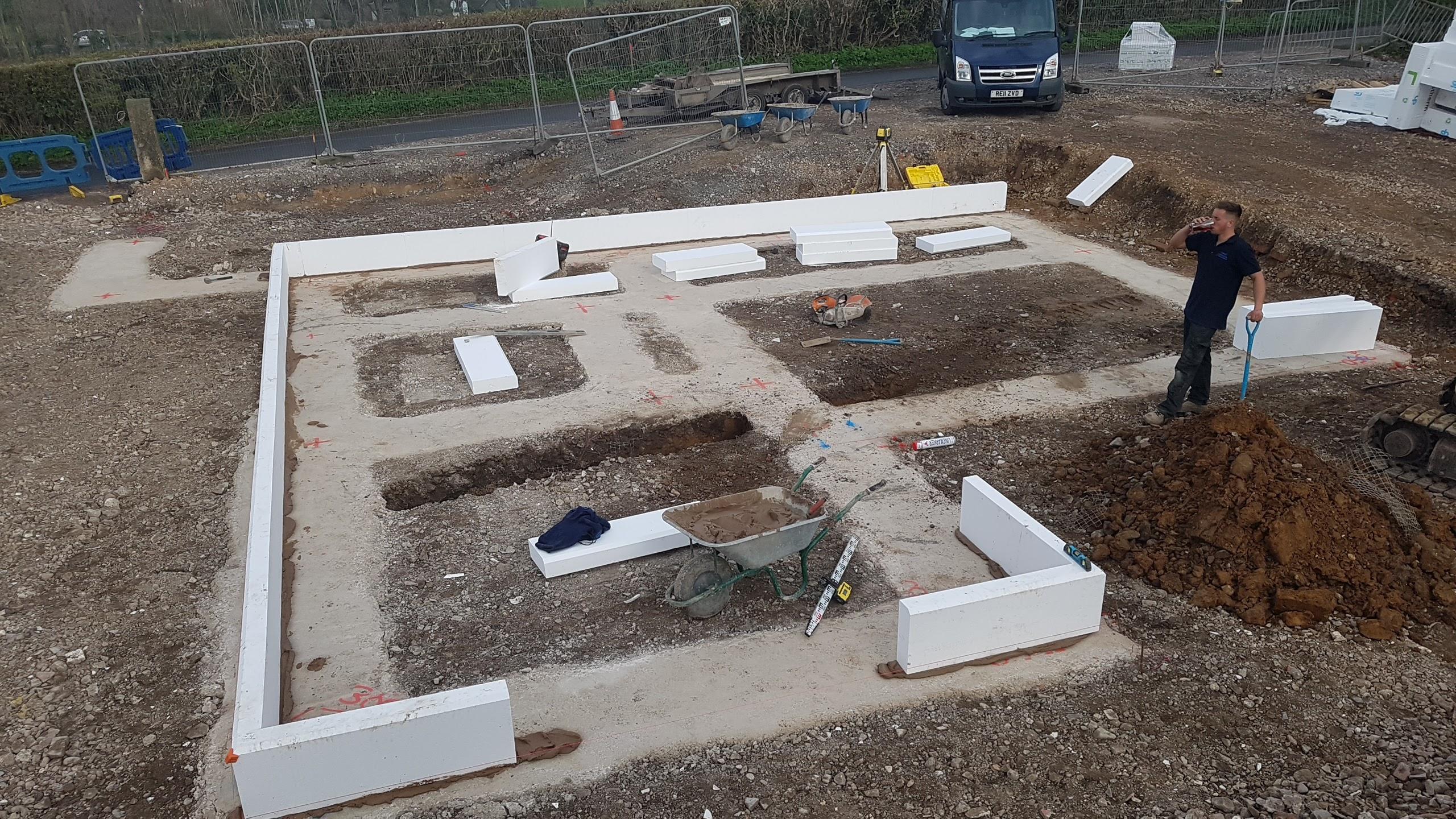

gavztheouch Posted November 9, 2021 Posted November 9, 2021 Thinking about building ICF walls on insulated raft. Has anyone done this? Anything to worry about in terms of failure of the foam under the slab, seems like a lot of weight pushing down. Possible worries would be, creep of the foam over time, rodent or chemical attack.
Bitpipe Posted November 9, 2021 Posted November 9, 2021 It's not 'foam' it's high grade, rock hard, EPS which is designed to take the point loading of the full structure above it. The SE will spec the grade of EPS once the full structure design is known. We built a 120m2 RC basement (with a TF house on top) built upon a raft of 300mm EPS 200 blocks. They were laid on 150mm compacted type one and 50mm blinded sand. Covered it with a gas membrane and the crew built the RC slab on it as if it was solid ground. We applied 200mm EPS 70 to the exterior of the basement walls so effectively the same structure as ICF minus the internal layer of EPS. I would not worry about rodents, only an issue if you have exposed insulation at ground level and this is easy to avoid with various flashing solutions. What would your external finish be? As for chemical attack, acetone can dissolve EPS but you'd need a lot of it flowing around your entire slab so not sure the circumstances where that could happen.
BotusBuild Posted November 9, 2021 Posted November 9, 2021 Building a semi-basement two storey house - 135m2 footprint RC slab. Similar build up as Bitpipe's. All insulted EPS will be either buried or covered with stone once complete. Unless you are building on contaminated ground (you shouldn't be!!!!!!!!) then I would think chemical attack should not concern you. With a raft foundation if anything moves, everything moves with it ?
Gone West Posted November 10, 2021 Posted November 10, 2021 15 hours ago, gavztheouch said: Anything to worry about in terms of failure of the foam under the slab We used an Isoquick insulated raft foundation and the insulation is called Peripor which is a type of EPS300. IIRC we were told it had been used in Canada for commercial buildings. The Structural Engineer will ensure it's suitable for your use.
Conor Posted November 10, 2021 Posted November 10, 2021 (edited) The limit will be the weight of the building above and the rating of the EPS used. We wanted an insulated raft, but our three story icf design was (according to our engineer) too heavy for the compression limit of the EPS. We would have had to use much bigger ring beam to compensate, which wasn't an option due to the limits of the excavation. So we had to go for a normal ground bearing raft. Edited November 10, 2021 by Conor
