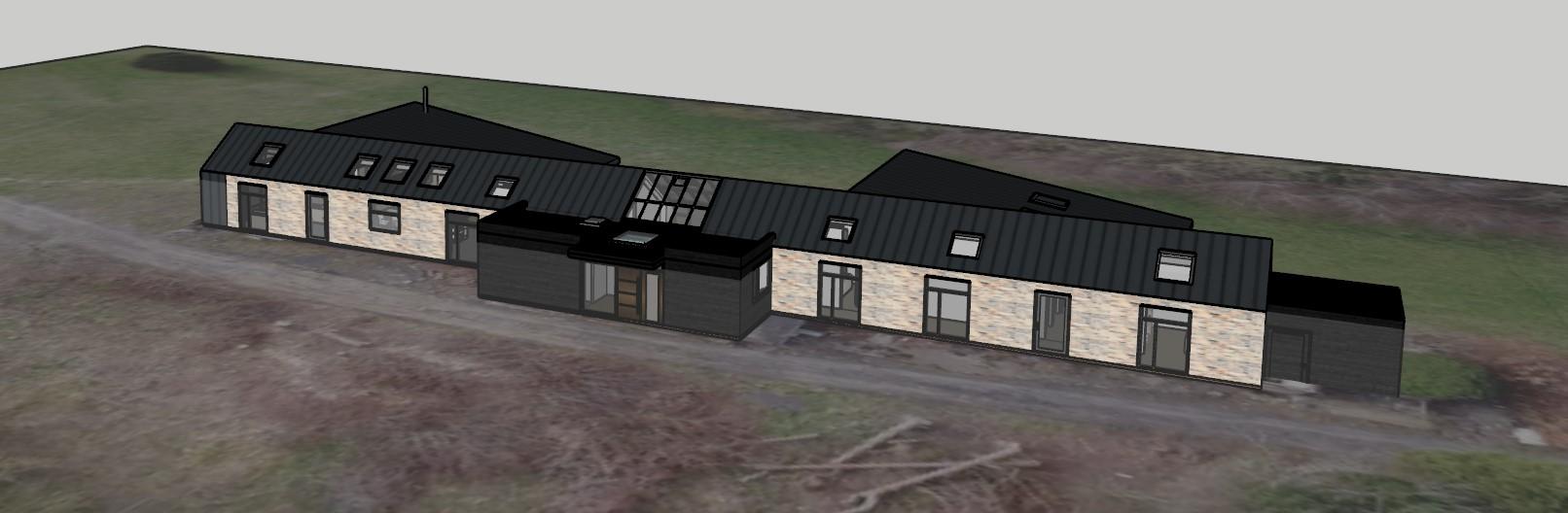

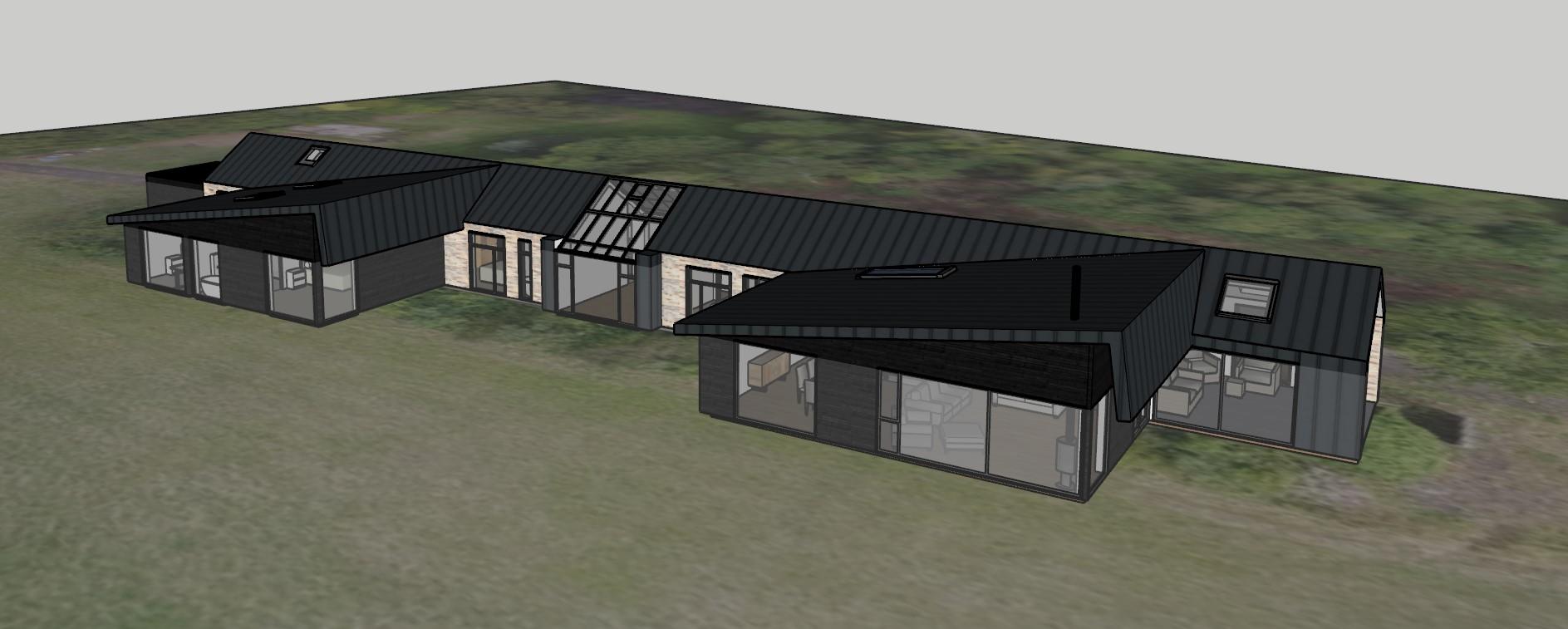

pstunt Posted November 4, 2021 Share Posted November 4, 2021 Hi, I am looking for peoples opinions / experiences regarding Pagurek Standing Seem roofs. First off, I should say that I appreciate Patrick is on this site and he has been extremely helpful, so in asking these questions I am not being critical. We have full planning to convert and extend an old stable and have identified a possible builder who has suggested using Pagurek for our standing seem roof, as opposed to Merlin Metals Snaplock panel, which is what my architect is proposing. I have included a couple of mock up CAD pictures which give you an idea of the build. One downside to Pagurek is that 8m lengths is the biggest they do, where as Merlin do 12m lengths. Our extensions are about 11m in width. Which would mean having staggered seems. Not a deal braker per se, but not ideal. I should state that Pagurek ( Patrick ) advised that they suggest having no more than 6m lengths any way as they become difficult to handle. Which makes sense to me. Obviously I would like to keep costs down but not at the price of losing quality / finish. Areas that also concern me are how the rooflights would fit and the flashing around them. Love to hear your comments and thoughts Paul Link to comment Share on other sites More sharing options...
IanR Posted November 4, 2021 Share Posted November 4, 2021 The renderings looks great. Standing seam really compliments the buildings in my view. I can't help with the choice between two different, steel, pre-formed panel brands, I've not used steel, but I have looked at loads as well as aluminium, zinc and copper while deciding what to use on my own roof. Pre-formed steel appears to give a more clinical, consistent seaming, and from what I looked at tends to show less deformation in the panels. ie. the final result will not always look like the renderings and the brochures, but steel tends to show less distortions and warps. Maybe it's more forgiving to a less well-prepared deck and poor handling. The downsides of using a less ductile steel though is that to my eyes it doesn't look quite the same as a traditional seamed roof, partly because it has less of the idiosyncrasies of a zinc/copper/aluminium roof, but also, due to its less ductile nature, other materials need to be introduced for areas such as flashing to roof lights. There are sometimes flashing kits available that match roof lights to certain brands of steel roof, but that may narrow your choice. The worst case is that you'll need some flexi rubber flashing to integrate the roof lights, vent pipes etc.. My personal choice was to have everything made and formed on site, out of a one material, straight from the coil, to give the look of a traditional seamed roof. I went with Aluminium as it was similarly priced to steel. Forming on site gets you away from issues over panel length, although my roofers wouldn't go over 13m due to difficulties with handling. It also allows for bespoke trims, verges and flashings etc. The idiosyncrasies match well to my agricultural setting, but I do have minimal warping and deformation compared to some I have seen. Darker colours with a matt finish tend to disguise any imperfections. Link to comment Share on other sites More sharing options...

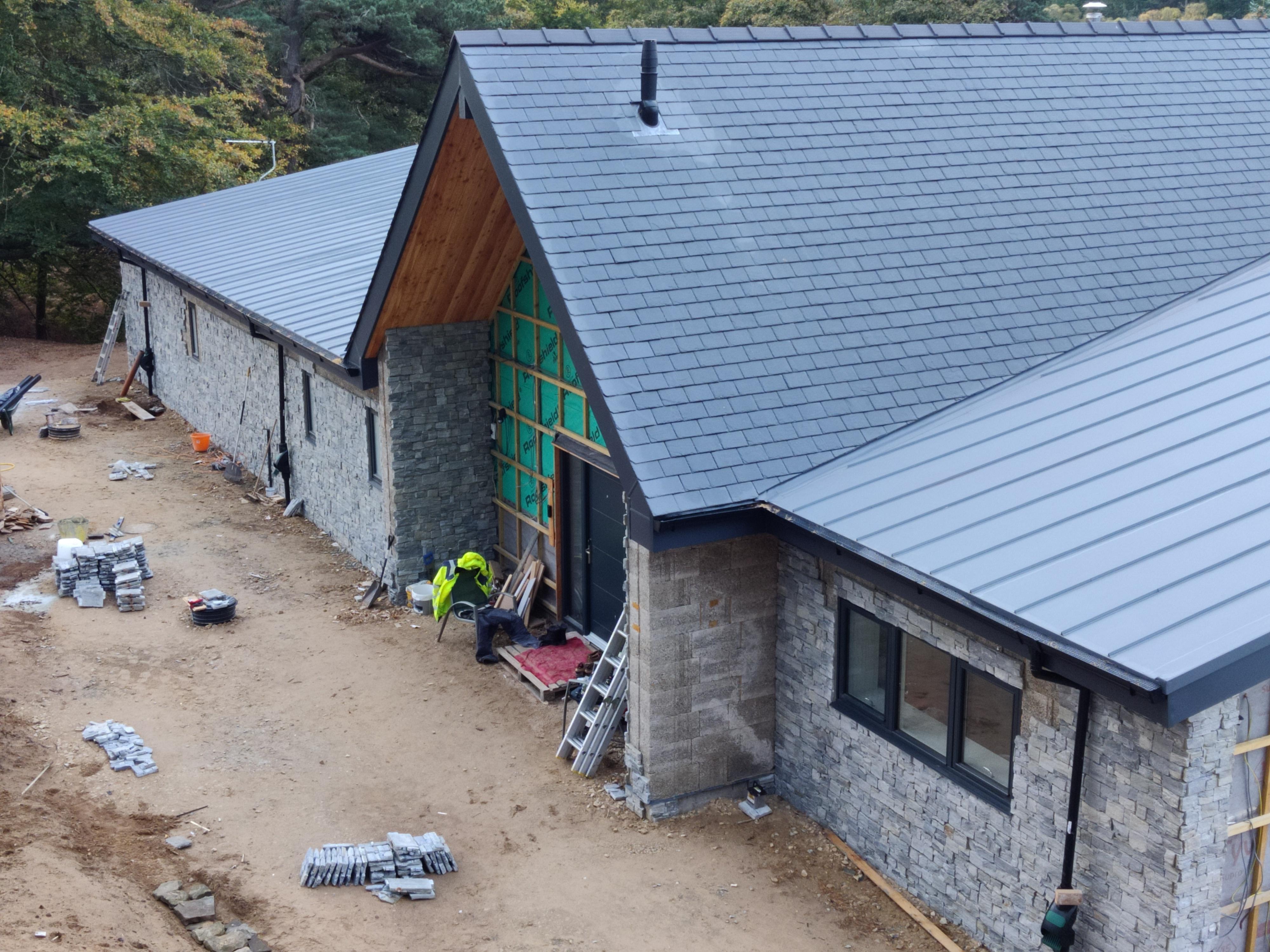

LionessHeart Posted April 14, 2023 Share Posted April 14, 2023 @pstunt - that's a beautiful and large home! We are also considering using Pagurek standing seam roof. Is your roof installed and are you happy with it? And did the installation of rooflights cause any issues? Link to comment Share on other sites More sharing options...
pstunt Posted April 14, 2023 Author Share Posted April 14, 2023 4 hours ago, LionessHeart said: @pstunt - that's a beautiful and large home! We are also considering using Pagurek standing seam roof. Is your roof installed and are you happy with it? And did the installation of rooflights cause any issues? Like many people, I am sure, we encountered many delays ( Major mistake by architect and window nightmares ) and the Pagurek roof is only nearly finished. We havent fitted the rooflights just yet as the builders and roofers wanted to complete the metal roof covering first and then cut through the metal sheets through to the roof window openings. I expect this to happen in the next few weeks and I can let you know. Overall I am impressed with the system. For what it's worth my builder is about to start building his own house nearby and he was going for standard tiled roof but since having worked with this one he has changed his mined and is going with Pagurek. We massively reduced the rooflights also from the older picture on this post, as they simply weren't needed. Link to comment Share on other sites More sharing options...
