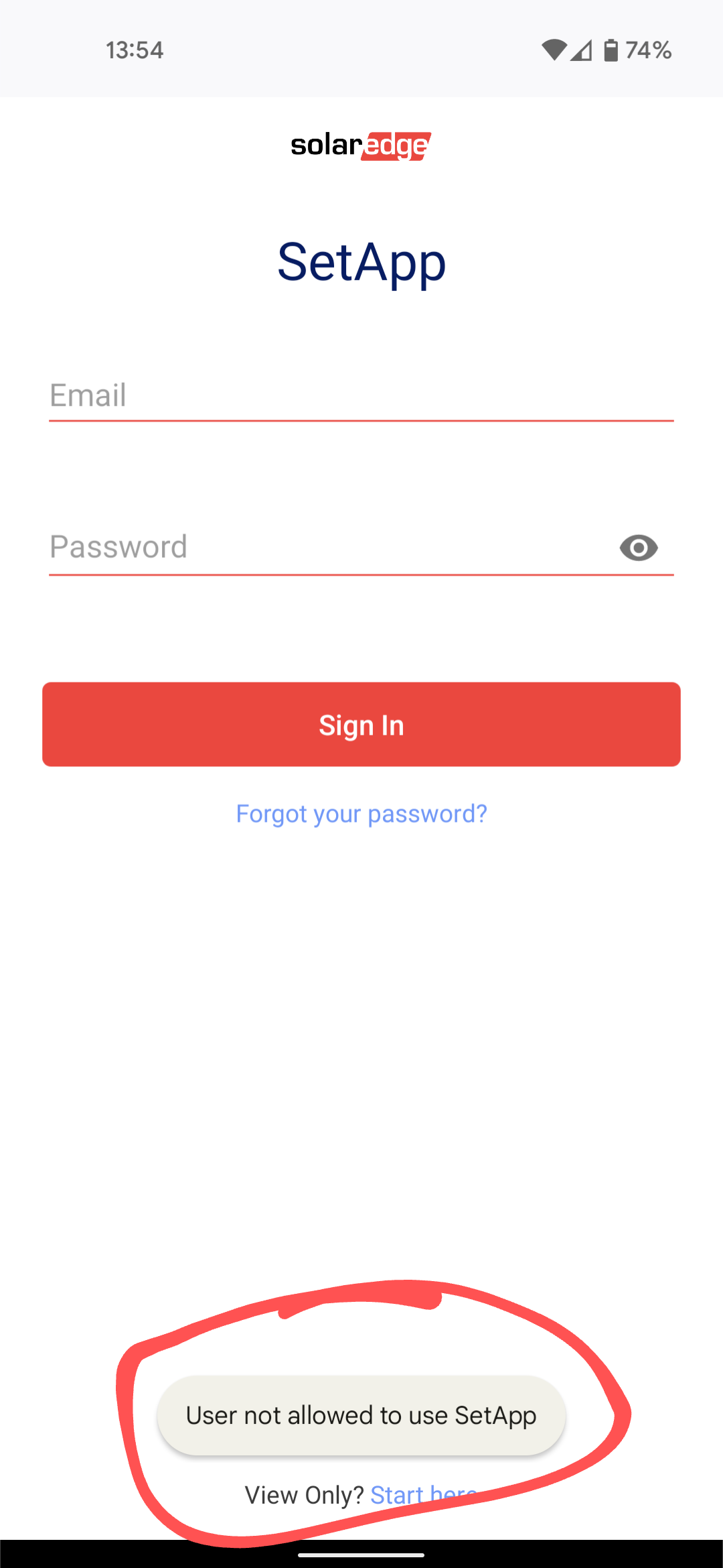

joth Posted November 23, 2021 Author Posted November 23, 2021 (edited) On 12/11/2021 at 18:36, Dan F said: @joth I realised the other day that the "mySolarEdge" app gives you limited options, but using the "SetApp" app gives you a lot more options. You need to use the "SetApp" route to enable Modbus TCP which allows Loxone to get data from inverter (without the need for a Modbus extension). @Dan F I gave this a go again and remember the error: when I try and login to the SetApp I get an error "user not allowed to use SetApp" Any idea who controls the ACL to my own inverter? The original installer I assume, or contact solarEdge? Thanks Edited November 23, 2021 by joth

joth Posted May 3, 2022 Author Posted May 3, 2022 On 12/11/2021 at 18:36, Dan F said: @joth I realised the other day that the "mySolarEdge" app gives you limited options, but using the "SetApp" app gives you a lot more options. You need to use the "SetApp" route to enable Modbus TCP which allows Loxone to get data from inverter (without the need for a Modbus extension). @Dan F I was finally in the right place and with SetApp Admin mode and enough time to survive the FW updates, so managed to get "Modbus TCP" enabled on my inverter at last. Next question: is there a dummies guide to using this interface to extract generation stats? Ideally directly into Loxone, perhaps a template device exists?, but I can go via some other SW if needed. I found the DE article below on using modbus TCP in general, but it leaves a bit of guess work (both in the incomplete EN translation, and mapping SolarEdge onto it). https://www.loxone.com/dede/kb/kommunikation-mit-modbus-tcp/ Thanks!
Dan F Posted May 3, 2022 Posted May 3, 2022 @joth There is a Loxone template, yes! This should make it easy. I think it might be already included in Config, but if not there are details here: https://library.loxone.com/detail/solaredge-inverter-127/overview Beleive it or not, after telling you about this I never actually got it up and running on mine yet! 1
joth Posted May 3, 2022 Author Posted May 3, 2022 3 hours ago, Dan F said: @joth There is a Loxone template, yes! This should make it easy. I think it might be already included in Config, but if not there are details here: https://library.loxone.com/detail/solaredge-inverter-127/overview Beleive it or not, after telling you about this I never actually got it up and running on mine yet! I feel stupid. loxone's search is crap https://www.loxone.com/enen/?s=SolarEdge&submit=Search But apparently this thing called Google works quite well https://www.google.com/search?q=loxone+SolarEdge Thanks! 3 hours ago, Dan F said: Beleive it or not, after telling you about this I never actually got it up and running on mine yet! LOL. I've somewhat stupidly put in a speculative order for the SE EnergyBank, so prepping myself with as much knowledge as possible about interfacing directly to the inverter. Couple observations from a skim: - Looks like loxone are linking an old version of the Tech note, there's an updated version here: https://www.solaredge.com/sites/default/files/sunspec-implementation-technical-note.pdf - Looks like SE is just exposing read-only interface over modbus, so I'll need to look elsewhere if I'm to gain any control over the battery charging priority.
