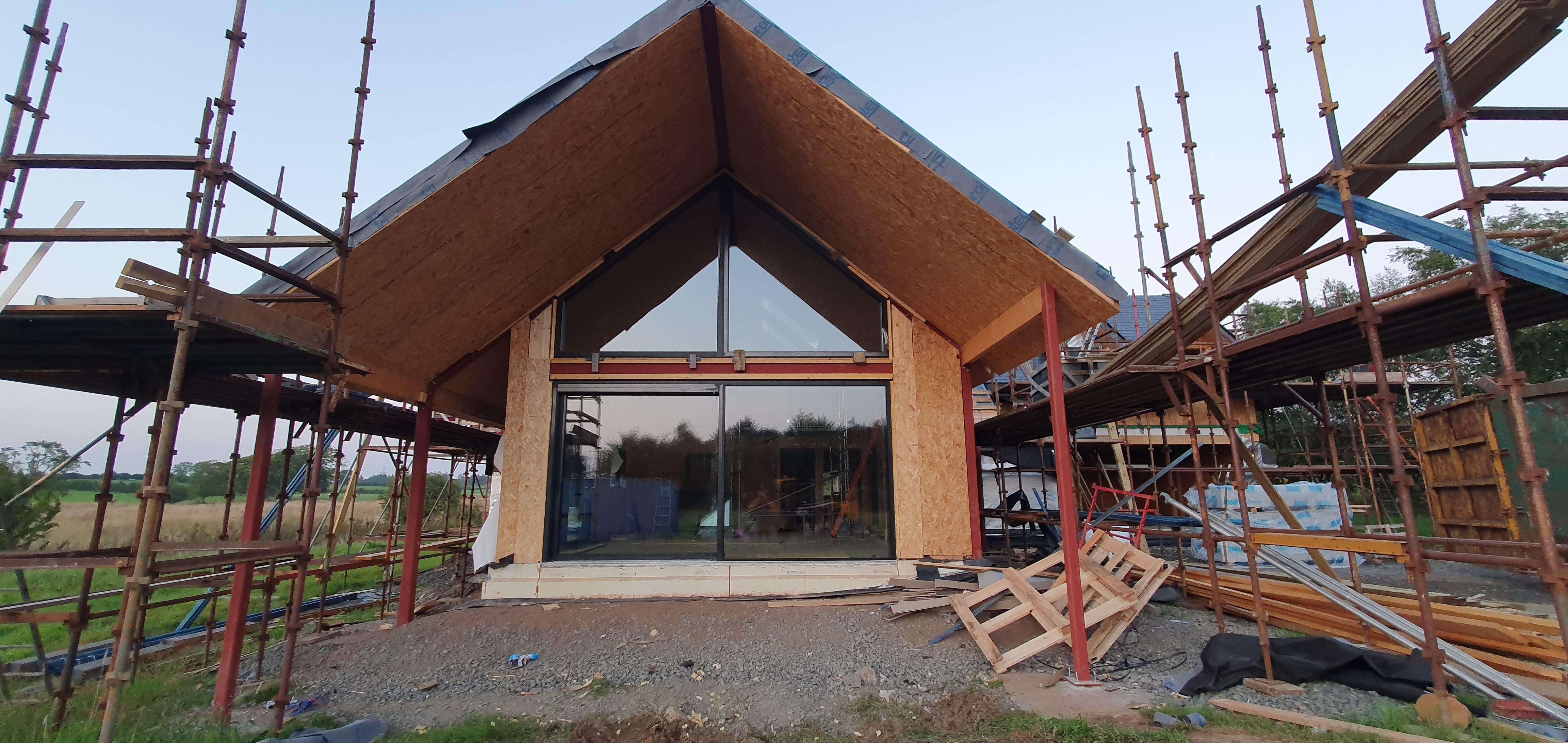

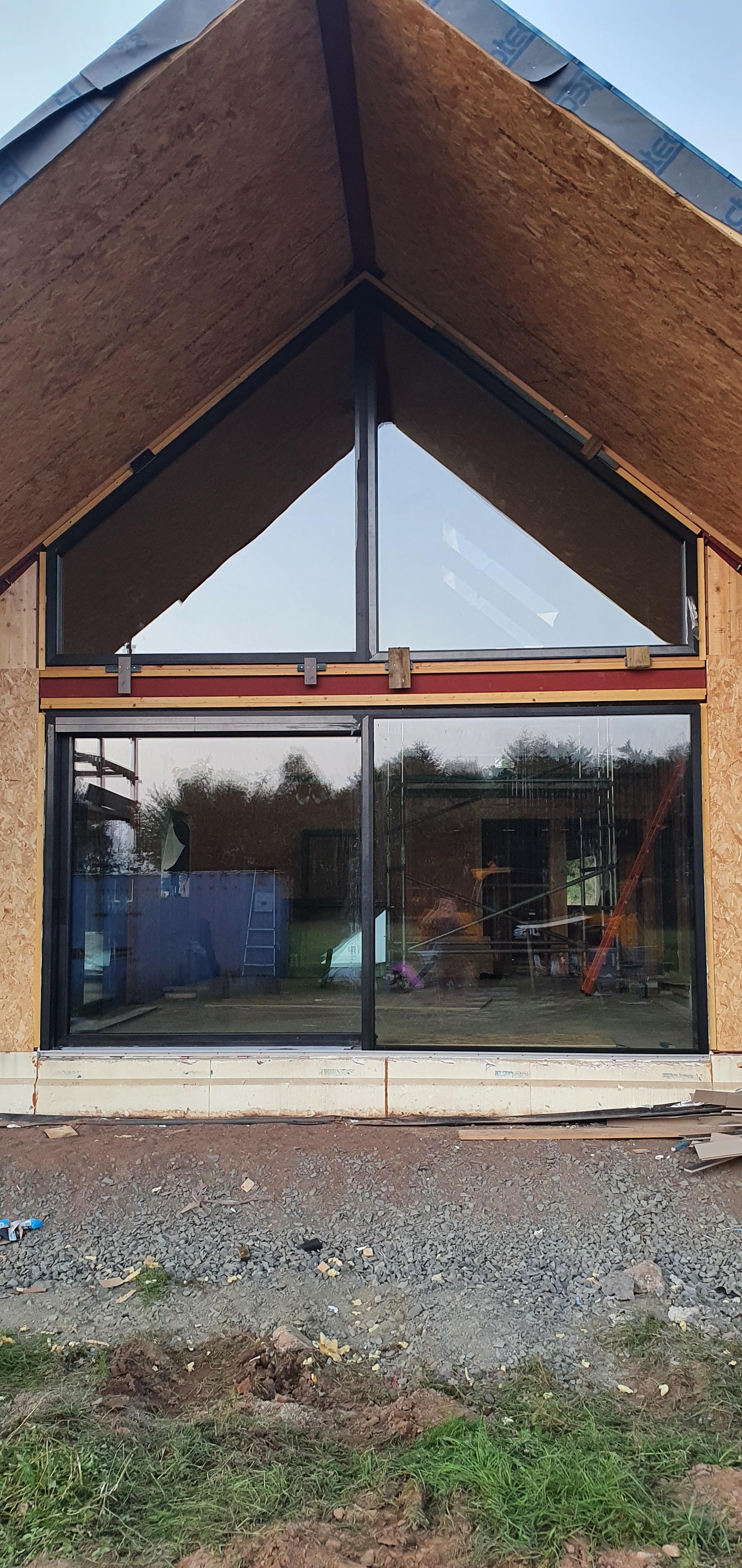

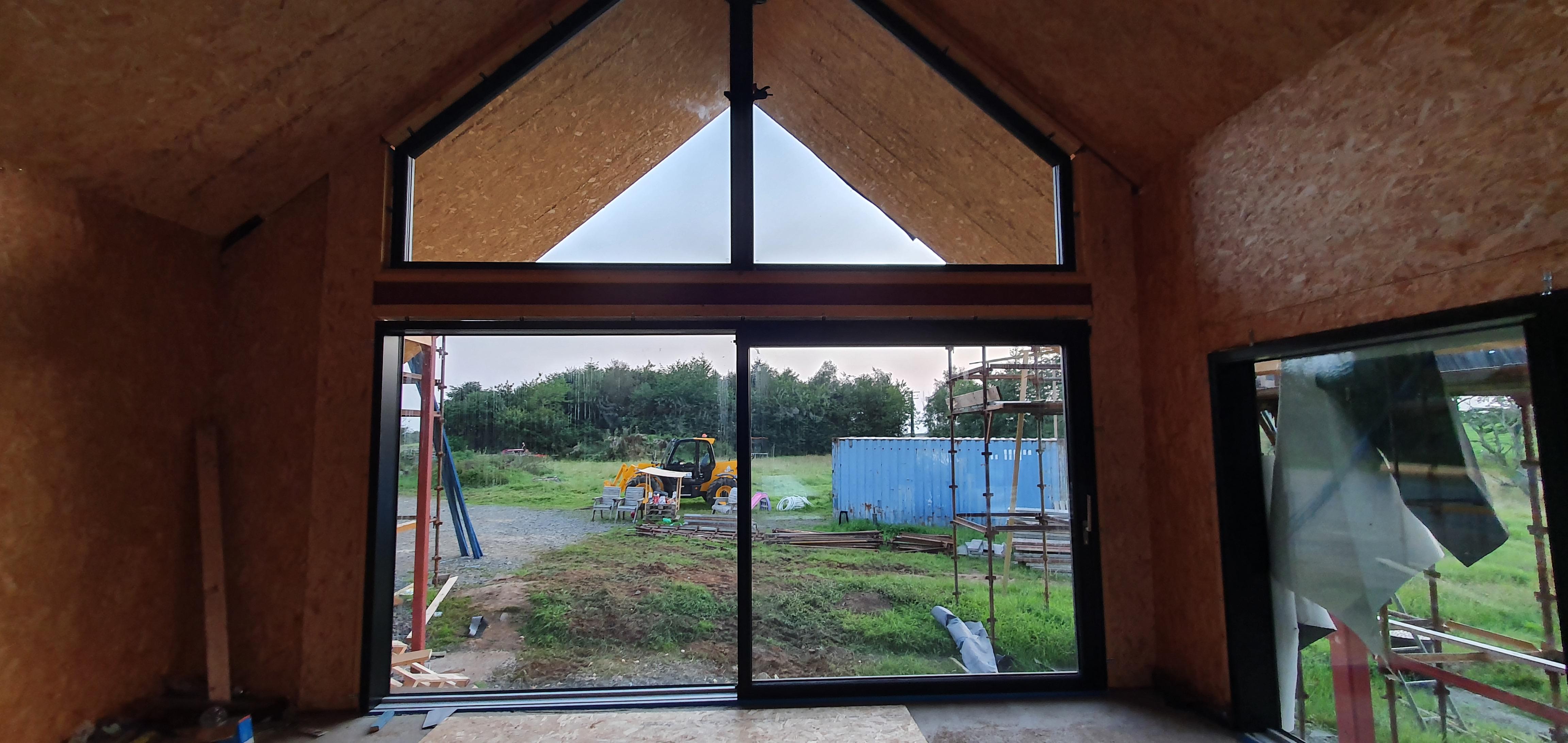

SuperJohnG Posted October 26, 2021 Share Posted October 26, 2021 I just installed Zyle Fenster 3g timber framed Aluclad supplied by Ecowin who is @craig on here. Plenty happy with the quality. I have black internally and externally. I had most of the slates on when wi down went in but if I didn't I wouldn't have been bothered. Plenty clearance at 10mm all round. Thats 4.6m wide and bottom 2.4m slider high 1 Link to comment Share on other sites More sharing options...

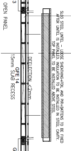

laurenco Posted May 24, 2022 Share Posted May 24, 2022 On 27/10/2021 at 07:47, Bramco said: Also because our sliders are quite wide, MBC have designed steels above all of the openings and we have a guaranteed 2mm deflection on these openings Hi Simon, Can I ask where it says about MBC guaranteeing a 2mm deflection on the openings and how long this is guaranteed for? MBC did ours. 2019. (Very happy overall). But we're struggling to open the corner bi-folds and the contractor who came out has found the corner has dropped 10mm. Thanks Lauren Link to comment Share on other sites More sharing options...
Bramco Posted May 24, 2022 Share Posted May 24, 2022 @laurenco Hi Lauren, the 2mm deflection is I think more about the centre of the structural opening and was a stipulation from Express doors for the sliding doors iirc. A sag on one side would surely indicate that the side of the opening didn't have enough support? In our case, the steels sit on top of some chunky side supports. If anything is still visible, I'll take a photo tomorrow. No photo tomorrow, means nothing visible. Your design looks much more difficult than ours. Our doors are all sliding doors within a wall, so nothing jutting out. Simon 1 Link to comment Share on other sites More sharing options...
Bramco Posted May 26, 2022 Share Posted May 26, 2022 @laurenco Hi Lauren, no photos I'm afraid. However it did strike me that you should be able to see the detail of the frame from the Site Pack. The Site Pack contains all the details about the structure. If you didn't get this from MBC, you should still be able to get hold of a copy. Below is a snip of one of the structural openings. You can see the build up of 5 studs on each side of the structural opening to take the steel which is there to ensure the 2mm deflection at the centre of the opening. In addition, the windows suppliers normally have a 10mm gap to allow them to actually get the windows in place, so actually there's plenty of tolerance - at least in our case. Simon 1 Link to comment Share on other sites More sharing options...
Nickfromwales Posted May 26, 2022 Share Posted May 26, 2022 On 24/05/2022 at 15:22, laurenco said: the contractor who came out has found the corner has dropped 10mm. If the frame had dropped 10mm you'd have cracks the size of the San Andreas fault showing inside and out. That looks like poor installation of the door frame, eg lacking support in the bottom corner of the frame where all the loads sit. Have you had a spirit level on the door, door frame and threshold, both horizontally and vertically, to see which thing has actually gone awry? 1 Link to comment Share on other sites More sharing options...
laurenco Posted May 26, 2022 Share Posted May 26, 2022 3 hours ago, Bramco said: @laurenco Hi Lauren, no photos I'm afraid. However it did strike me that you should be able to see the detail of the frame from the Site Pack. The Site Pack contains all the details about the structure. If you didn't get this from MBC, you should still be able to get hold of a copy. Below is a snip of one of the structural openings. You can see the build up of 5 studs on each side of the structural opening to take the steel which is there to ensure the 2mm deflection at the centre of the opening. In addition, the windows suppliers normally have a 10mm gap to allow them to actually get the windows in place, so actually there's plenty of tolerance - at least in our case. Simon Thank you, this is really interesting. I'm going to look at our pack Link to comment Share on other sites More sharing options...

craig Posted May 27, 2022 Share Posted May 27, 2022 (edited) Classic case of deflection here. Not enough tolerance has been allowed been the door and the steel. Steel has deflected, most likely PU foam which turns solid has been used for installation/insultation. The steel has deflected, pushing down on the PU foam which can only push down on the frame of the corner opening bi fold which will not be a load bearing item. I can only think of two solutions. However, before this, take a level (laser preferably) and check. Speak to the bi fold supplier and find out what the measurement from the bottom track to the top track should be and measure it - you should be able to check this at each hinge side (wall side) of the bi fold. It will all lead to a weight bearing issue from the deflection from above in the corner - that is what I highly suspect has occurred. Solution 1: Open up above the bi fold, scoop out all the PU foam (that's what I presume has been used) and replace it with compriband only which is compressible. So when deflection occurs, it deflects into something that compresses so it doesn't push the top track of the bi fold down. Solution 2: Acro prop, push the roof back up (only slightly, you're only looking to get approx. 5mm). Look in the top tracks of the corner of the bi fold for a couple of locations you can pop 2 long screws in either side. Acro propping this up allows the screws to fix the item in place. Rather than trying to put the screws in an pulling the track up (which won't work). If you don't have an acro prop a car jack and a 2x2 and an another bit of timber to put between the ceiling and the 2x2 to try and prevent any damage to the ceiling. In my honest opinion and looking at the pictures, this is the only remedies I can think off. Edited May 27, 2022 by craig Link to comment Share on other sites More sharing options...
Gus Potter Posted May 27, 2022 Share Posted May 27, 2022 On 24/05/2022 at 15:22, laurenco said: Can I ask where it says about MBC guaranteeing a 2mm deflection on the openings and how long this is guaranteed for? MBC did ours. 2019. (Very happy overall). But we're struggling to open the corner bi-folds and the contractor who came out has found the corner has dropped 10mm. Pity your bifolds are sticky. Ok a bit of maths first!.. and a bit of a story.. grim at first but good news at the end! @laurenco Say each of your bifold panels are conservatively 800mm wide, you have 3 panels. Thus from the top outside corner of the doors back to the roughcast on the main house wall you have a distance of 2400mm. Above the bifolds you have a section of rendered construction, above that the frameless glass, more forgiving often in terms of movement than the bifolds. Now the panel above the bifolds will be fairly stiff on the inside and to some extent flexible between the inner and outer rendered layer. The load from the balcony will likely be on the inside and you'll probably have some flexible ties so any movement within the panel structure above the doors won't immediatly manifest as cracks in the render. But assume (conservatively) the panel above the doors maybe acts as one unit and rotates about the point where the bottom of the rendered panel meets the main house wall at the level of the top of the doors. Now assuming the panel above the doors acts as a unit then if the outside corner of the panel above the top corner of the doors drops by 10mm that means that the panel rotates downwards by tan (angle) = 10 /2400 = 0.24 degrees. If the panel above the doors is 900 mm high then at the point where the bottom of the balcony glass meets the main house wall you could expect a crack to be at the top end of tan( 0.24 deg) * 900 = about 3.8mm.. not a lot actually and hard to see. That may be why you don't see massive cracks at the moment. Even then you would be hard pushed to distinguish this between movement crack and a shrinkage crack. Going back to your design and looking at it conceptually there are a few ways of designing this as an SE. You have the balcony above so a bit of load there, doors that are sensitive to movement, a timber frame that shrinks and swells season to season and also dependant on how warm / cool you like your house.. it's a "living" thing that reacts to moisture changes. Timber frame.. it's going to move about quite a bit! a lot more than 2.0mm on standard stuff, any cantilever arrangement is going to move a lot more than 2.0mm. A first glance to design something SE wise like you have I would ask what your budget is. If you are very tight for cash but still want that type of bifold arrangement I would look at making the outside corner of the bifold as a hidden structural post / column. If you want, look up a window bay pole on the internet that will give you the jist of it. The thing here is that you remove the cantilever effect, reduce significantly movement, make significant savings not just on the balcony, beams but also on how you connect the produding balcony back to the timber frame. MBC may have made this "baypole" assumption so check. The design philosophy is often lost in the wash and that is how these things happen. Alternatively you can go for everything cantilevered out from the main house wall, using the first floor as a means of supporting the cantilever. You will get a lot of movement here though. If you use steel and ordinary bolts then the bolts go in holes of 2.0mm greater diameter than the bolt size.. the bolts initially can move about before they take up their final position. To sum this up. Your starting point here is to go back to the structural design and see how it was intended to work, what caveats the SE specified, the design deflection limits. If you want post more info it would be of interest. If the SE has gone for the "bay pole concept" .. a column at the outside corner, could just be a heavy aluminium corner frame? then you need to check that the bifold supplier has been made aware of this and implemented that SE requirement.. if not you have a major safety issue you need to address. If you check this structural stuff out first and make sure there is not a fundamental structural problem and all is ok then I would, as a next step, get a hold of a local window / door installer that knows their stuff to give you the right advice. It may be that all you need to do is take the beads off, square the frames up by repacking the glass with the plastic spacers... one days work and that will be you for a good few years until the moving parts wear a bit, then get the same guru back! Sometimes things jamb as the spacers between the glass and frame at the top of the door come loose and slip down so the frames sag and get sticky. @craig good point about scooping out the foam and how it hardens up. Now sure about jacking stuff as a first choice personally until you really get to the root of the problem. Lifting things locally could move other structural stuff off their friction bearing that we rely upon and that could lead to structural instability.. you can lift several tonnes with an accrow one you set you mind to it.. great fun but there are concequences. That said, once you understand what the problem is then controlled jacking and packing is a good potential solution. Link to comment Share on other sites More sharing options...
craig Posted May 28, 2022 Share Posted May 28, 2022 On 27/05/2022 at 23:31, Gus Potter said: Now sure about jacking stuff as a first choice personally until you really get to the root of the problem. Which in my experience, no one wants to take responsibility for and or advises that the issue is the window/door suppliers problem for not allowing the relevant tolerance in the first place. Which to be fair is a valid point, however, obtaining the deflection in the first instance can be like getting a needle from a haystack. Usually the simplest solution is to just jack things up a touch (just enough) to get the clearance for smooth operation to occur and then fixed the unit again in that position. It invariably falls onto the window/door supplier and isn't always there fault. Link to comment Share on other sites More sharing options...
