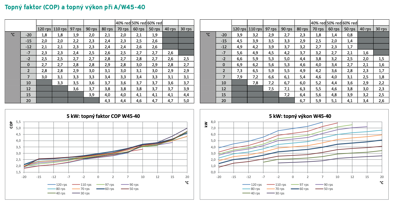

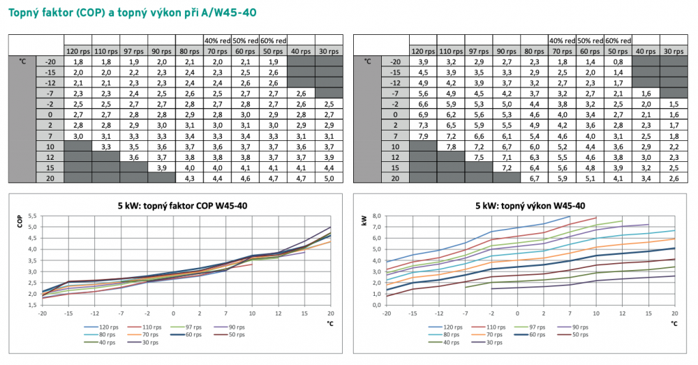

Dan F Posted October 21, 2021 Posted October 21, 2021 (edited) The one caveat here is that the ASHP power also depends on i) outside temperature ii) what mode the heat-pump is in, and iii) the flow temperature (which increases as the tank heats up). The 5kW specified is just nomimal. We are also having a Vaillant ASHP installed (7kW aroTHERM Plus) and I had exactly the same query so I have the datasheets and found the following: - The Vaillant aroTherm Plus's comes, from factory, configured to run in "eco" mode for DHW which means 50% compressor speed. This can be disabled. - The power output of the 5kW model (eco mode) at 2C external temp is 3.6kW. - The power output of the 5kW model (max mode) at 2C external temp is 7.3kW. The same datasheets quote a time for heating a Vaillant 188L tank from 10-40C as 57 minutes. That would imply approx 1hr 12min for 48C. (they don't specify external temperature or DHW mode, but it seems fairly obvious that this is not eco mode.) Edited October 21, 2021 by Dan F 1
AdyHoggs Posted October 22, 2021 Author Posted October 22, 2021 So the kWh needed to heat the hot water is just under 9, so does that mean it will use 9 units of electric, thanks, Ady
Dan F Posted October 22, 2021 Posted October 22, 2021 9 minutes ago, AdyHoggs said: So the kWh needed to heat the hot water is just under 9, so does that mean it will use 9 units of electric, thanks, Ady No, as COP (coefficient of performance) is 3->4. See the table on the left). I think you're safe to assume around 3kW in the winter and closer to 2.25kW in the summer. (Assuming arotherm plus monobloc) 1

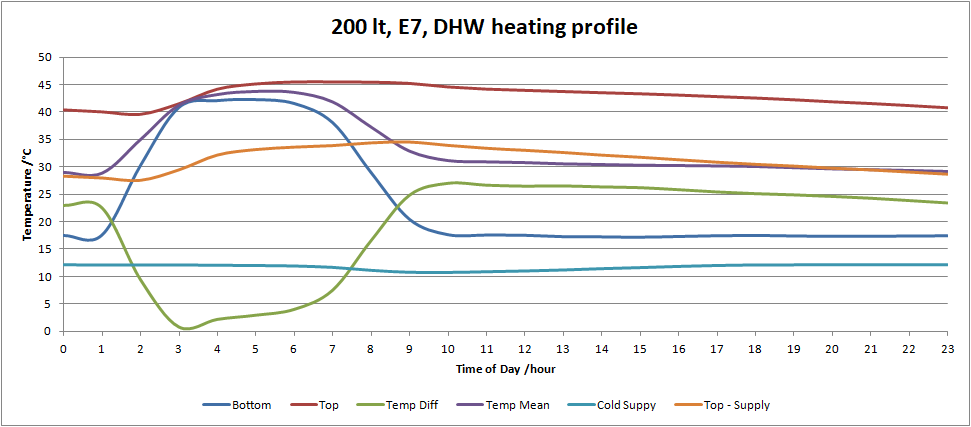

SteamyTea Posted October 22, 2021 Posted October 22, 2021 It is worth remembering that it is very rare that a hot water cylinder will drop to the incoming mains temperature. Mine rarely goes below 30°C and I only heat my water to around 45°C, so about 3.5 kWh. This is double checked with my energy meter and is about right (I am all electric so easy to monitor). When I get back home, after a week away, my cylinder will be cold, I shall check the temperature if I remember as I have some probes on it, so easy to do. Then I can see what the overnight electricity usage is. My system is a vented system, so the 100 litres in the loft header tank is often above 20°C. This is, in effect, passive solar heating. That changes during the winter though. Not had a full year logging the loft tank temperatures yet, but the data is being collected. I have posted up my water temps somewhere on here. Here it is. I cannot remember what time period this chart comes from, I should have put it into the title. 2
