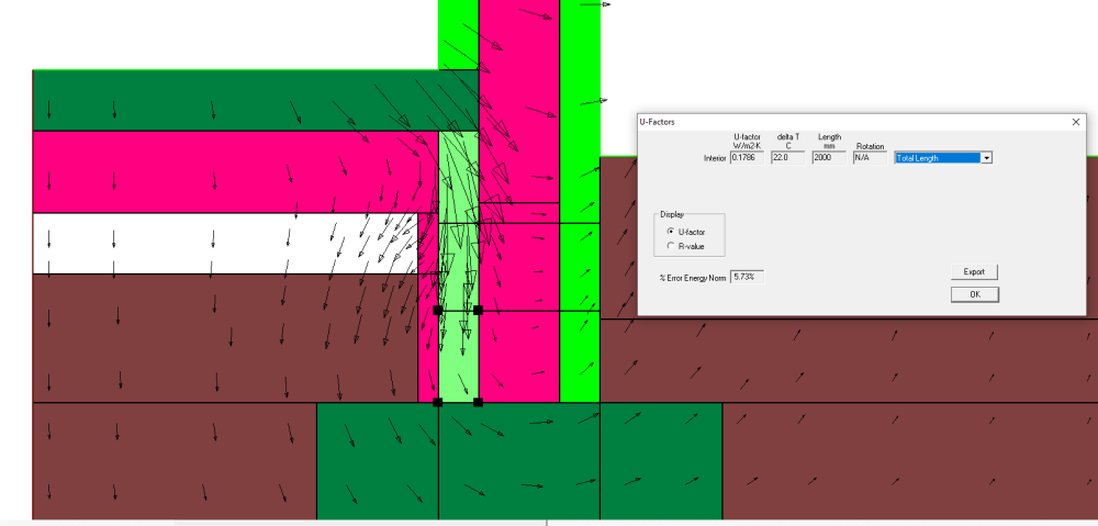

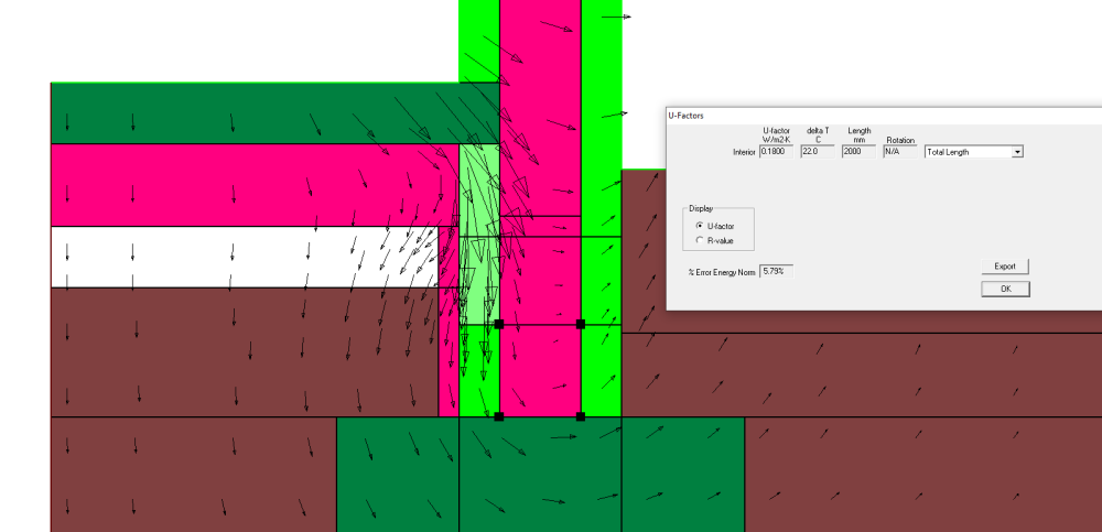

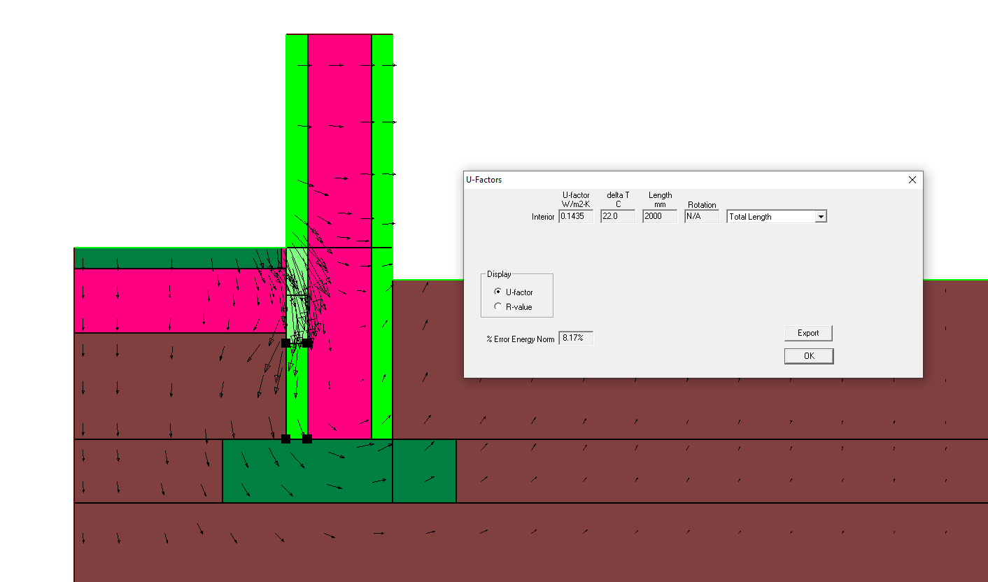

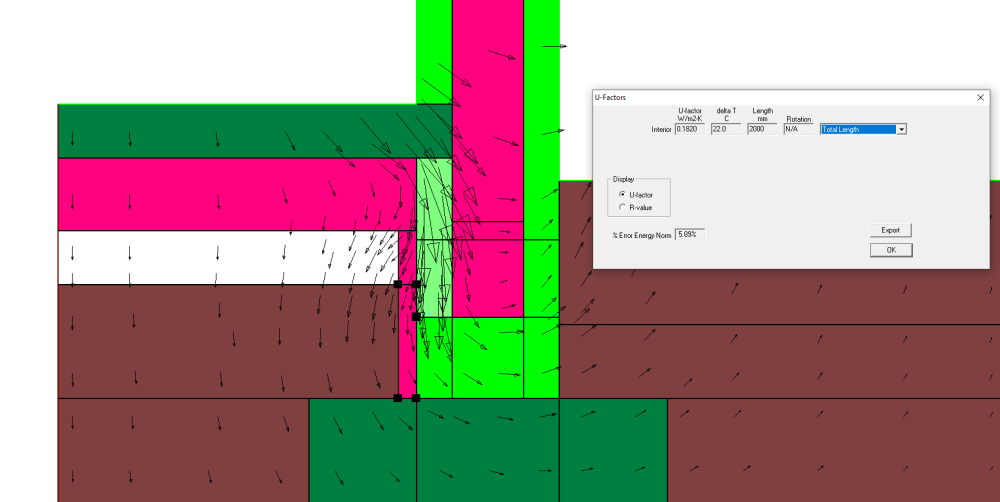

Iceverge Posted September 6, 2023 Posted September 6, 2023 Remember that once you have a "very good" detail you can spend a lot of money to get to an "excellent" detail for little benefit. I would use number 4. The benefit at the junction to increase to option 6 is only 0.0034 W/mK. For a freezing day with a house of perimeter of 50m you would only be using an extra 3.4W to heat the house. Even for passivhaus it's off the scale of a small difference.

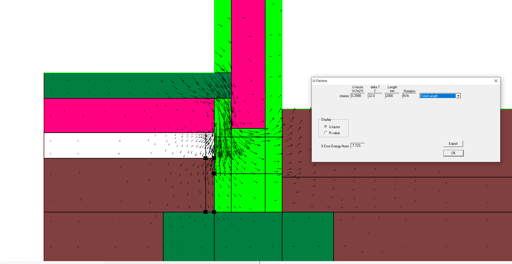

Iceverge Posted September 6, 2023 Posted September 6, 2023 Out of interest, here is what would happen if you took a more BREGS approach to the junction and forgot to use Aerated Concrete blocks and put in standard dense blocks everywhere. About a 100w difference in heating the house on a freezing day. 1

JohnMo Posted September 8, 2023 Posted September 8, 2023 On 06/09/2023 at 00:19, Iceverge said: Just aerated blocks inline with insulation + 25mm PIR upstand to slab. It gives a better internal U Value. For this one 208w. I used something like this but with a 70mm upstand.

JohnMo Posted September 8, 2023 Posted September 8, 2023 (edited) 23 minutes ago, Big Jimbo said: Can i ask. Over what distance ? Not sure how I calculated the previous posts. Must have had a decimal place wrong or something. But also the floor temp would be closer to say 23 at the perimeter not UFH flow temp. So for a building regs detail, with a 50m perimeter. The heat loss is for the total perimeter. 0.1 X 50 x 17 x 0.2568 = 22W or 0.5kWh per day. For other detail I referenced 0.1 X 50 x 17 x 0.1435 = 12W or 0.3kWh per day. Edited September 8, 2023 by JohnMo
ADLIan Posted September 8, 2023 Posted September 8, 2023 If we assume a floor with perimeter 50m and area 100m2 with a U-value of 0.15 W/m2K. The rate of heat loss associated with the floor and perimeter would be as follows; Floor only = 100 x 0.15 = 15 W/K Perimeter heat loss(using SAP default psi-value) = 50 x 0.32 = 16 W/K Perimeter heat loss(using dense block psi-value, insulated cavity) = 50 x 0.17 = 8.5 W/K Perimeter heat loss(using enhanced psi-value, with aircrete block inner, insulated cavity) = 50 x 0.08 = 4 W/K The exact geometry of the floor/wall junction may change the psi-values but above are the right order of magnitude.
