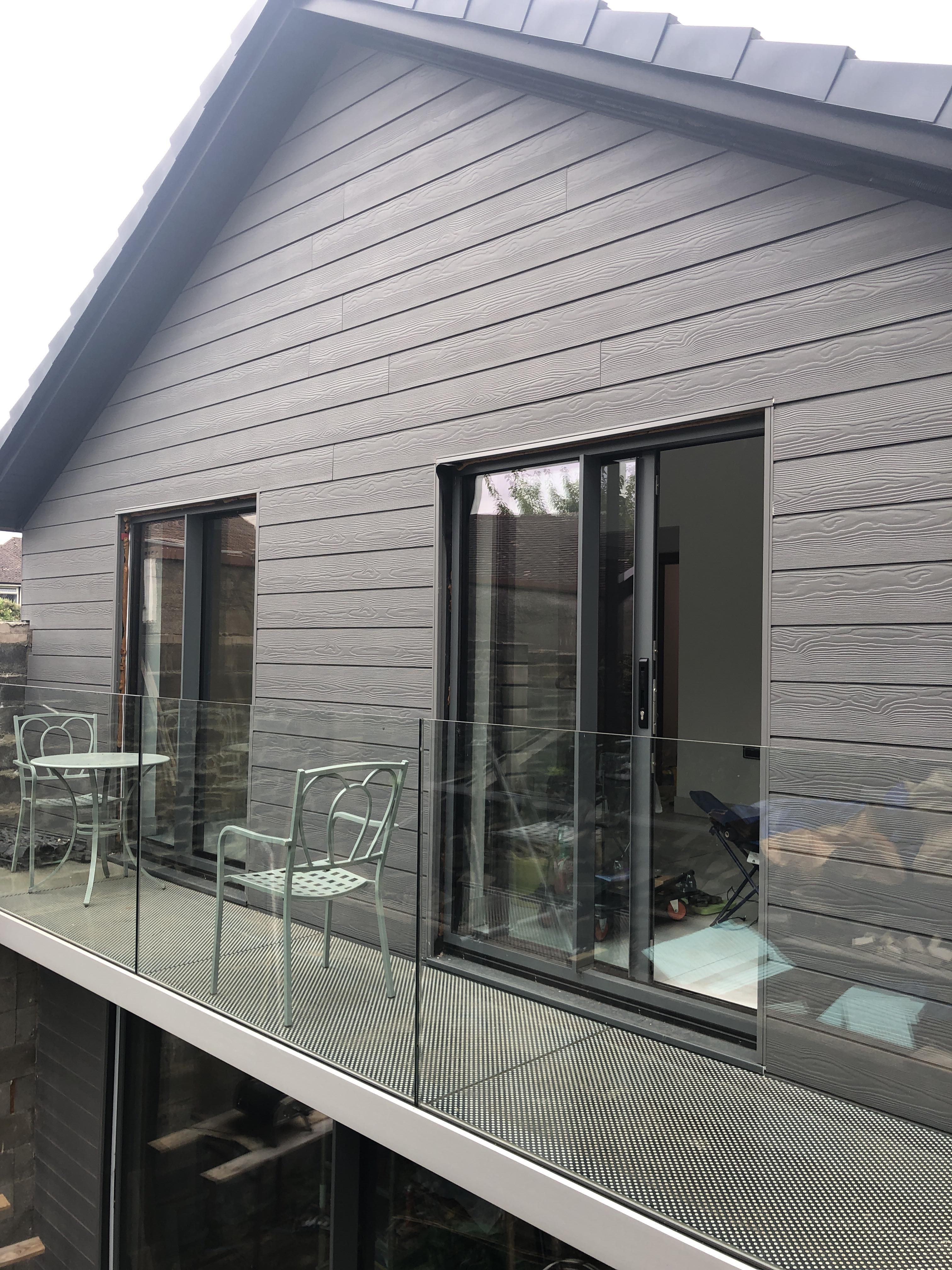

Cedral does scratch easily . Touch up paint doesn’t hide the scratch ( as dries to a different shade ) . Once up though ( and away from hands that can scratch it ) ; looks great . Easy to install horizontally; vertical more challenging. Also when cut the end exposed looks poor . So you might require lots of the nice matching beading / cornering which is of course expensive .
Here’s mine at the rear of the property. I’ve not touched it in 2 years even to clean .

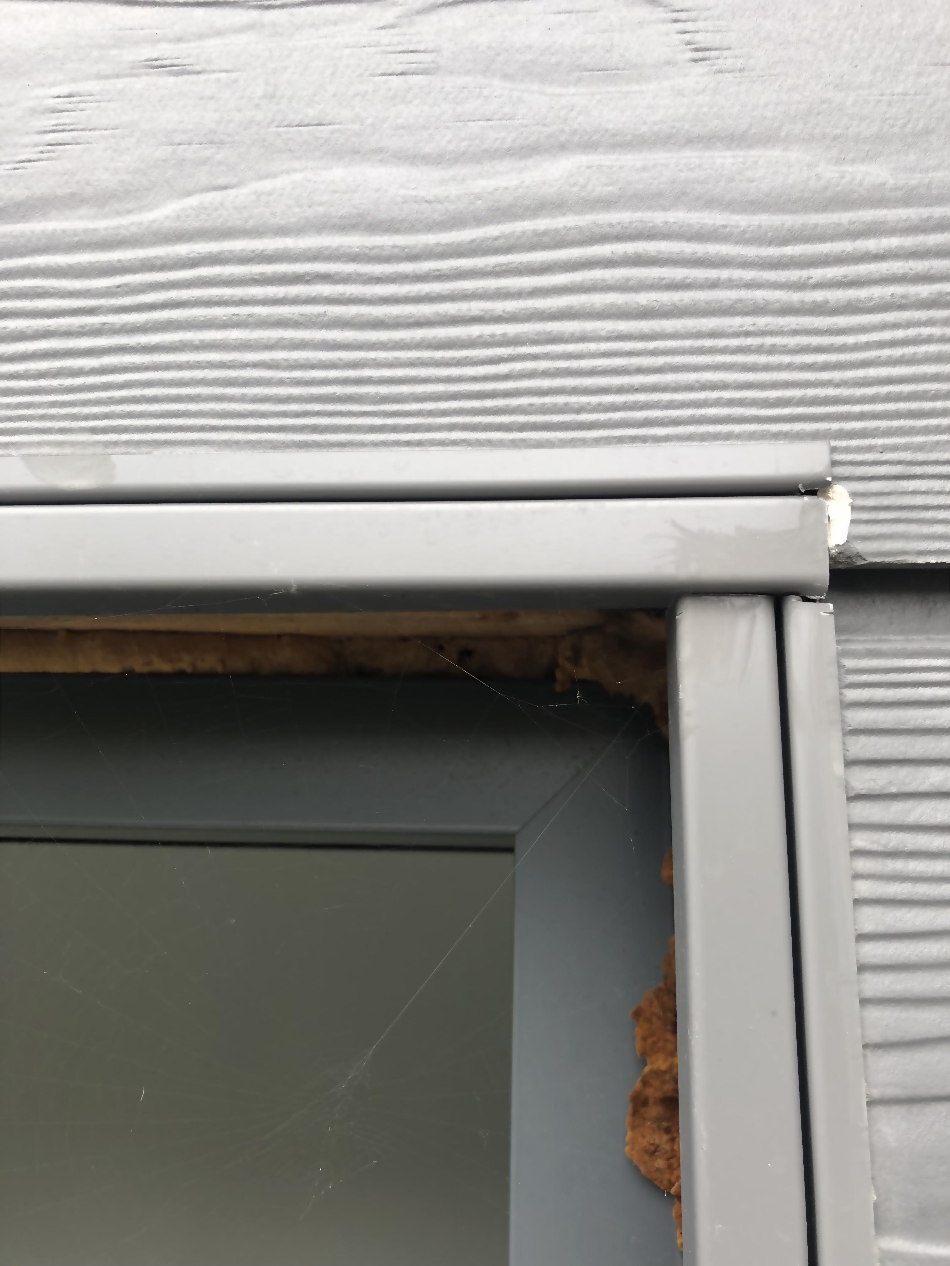

Some scratches ‘repaired’ with the touch up paint ?
I will tidy up the corners later ( can re align the beading ) . Probably get some custom ral squares made to stick over the corners and hide vertical to horizontal join .
