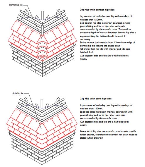

So, started laying roof tiles on small hip dormer reusing plain concrete tile etc.
Battons matched to original roof which has dictated the gauge on the dormer
The problem is this.... Got as far as only the second row of tiles and the bond is off... 1/3 and 2/3 (see image)
Laying the tiles left to right and it works out to an exact number of full tiles.
 What am I doing wrong?

Posted
So you may want to cut the bottom tile to make it "bond" correctly - are you sure they aren't Arris tiles on the corners..?? Bonnets tend to kick up more on the edges.
Picture below may help
Posted
It looks to me that the gauge is set too tight for that bonnet.
I assume the bonnet is not original to your roof.
If your gauge is say 90mm, then imagine it was 100mm it would push the bonnet up, therefore moving the second row of tiles across.
This could be solved with a tile and a half, or by moving the bonnet up so the bottom of the bonnet would not be exactly inline with the row of tiles by say 10mm, or you might find you have enough variation in the width of the tiles to have a pile of wide and a pile of narrow tiles to overcome this, but more fiddly and time consuming

Posted
Have you got a double row (double cover / starter course) on the base line, not sure I can see it in the picture, without it the water will run through the gaps on the base row and into the fabric also the geometry alters quite a bit!

Posted
@PeterW
@MikeSharp01
Yes I have put a double row at the eves.
I think I'm going to have to live with an uneven side lap as I all my very comprehensive search for reclaimed concrete plain tile and a half has resulted in a grand total of 11 tiles!!!

Posted
@PeterW
I've set out 4 rows on the front face with each row decreasing by one tile as I progress upwards.... But it's getting gappy! And without tile and a half I'm left with a gap of about 65mm.a time cut to that would look bodged or not?
Losing the will to live /tile!
Posted
looking good, but it doesn't look like you've put any compo under those bonnets???
Its a good idea to do this as you go, so hopefully you have just laid them loose and not nailed them in!
  • Like 1
Posted
@bassanclan
You've spotted the deliberate mistake!
I tried to do as I went on the last.. and only other hip....I did and I made a total fist of it. So this time I'm doing  it at the end in one go as it's such a small roof.
Posted
And I don't understand why the bonnets don't kick up more. The others I've seen sit virtually horizontal
Posted
If the roof was less steep (e.g. 35 degrees) then the bonnets would kick up more, but personally I think they look excellent how you have them in your picture, it means you are seeing more of the tile and less of the compo
