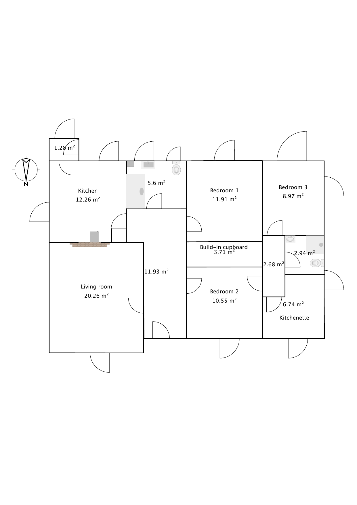

tjure2k Posted October 11, 2021 Share Posted October 11, 2021 Hi, first post here. My wife and I are about to exchange contract on a detached bungalow built in the 1960s and are planning to give it a thorough overhaul. The structure of the bungalow appears to be very sound, but the heating and insulation really need some modernisation. In particular, we would like to: demolish the porch near the kitchen and extend the kitchen 2m into the garden insulate the concrete floor, by excavating the concrete slab install an underfloor heating throughout the whole house replace the existing oil boiler with an air source heat pump replace the hot water tank with a hot water cylinder (with 3x coils to be compatible with an ASHP, solar thermal collectors, wood burner) insulate the loft (between and under rafters) Potentially later: MVHR install a wood burner and connect the back boiler to the hot water cylinder install solar thermal collectors, connect to hot water cylinder To reduce the risk we are thinking of doing this in two stages. We are planning to live in the small annexe (right hand side on the floor plan) while the work to extend the kitchen, excavate and insulate the floor in hall, living room, kitchen, main bathroom and bedroom 1 is being carried out. This is also when the ASHP and the hot water cylinder is installed. In the second stage we'd continue the excavation, insulation and installation of the underfloor heating in bedrooms 2 and 3, the kitchenette and the smaller bathroom. This is quite a bit of work, and we are rather inexperienced in this, so I'm looking for some feedback how realistic this plan is, potential problems and how long this would realistically take (waiting for the builders to be available, the new concrete floor to dry, etc). Would it make sense to hire someone to manage the project for us? We did some research and found companies that rent electric boilers for the time we are living in the annexe. Is this a sensible arrangement? I had a chat with a builder who advised against excavating the concrete floor and to use some thin insulation on top of the existing concrete. We think it would be beneficial to insulate properly (as it was also the biggest item in the EPC) and if we don't do it now, we probably won't do it later. I'd be grateful for any feedback. Thanks Link to comment Share on other sites More sharing options...
Ferdinand Posted October 11, 2021 Share Posted October 11, 2021 I did a thread about a 1960s one here. Not quite the same, but some stuff will be useful - especially perhaps my non-intrusive way of running services. Does it have asbestos? Have a look at raising the door heights (depends on ceiling) and putting in say 100mm of Celotex over the slab. 1 Link to comment Share on other sites More sharing options...
tjure2k Posted October 12, 2021 Author Share Posted October 12, 2021 Thanks Ferdinand for your reply, I rather enjoyed reading through your thread of the renovation of the bungalow, it turned out quite nice. We also aim to turn the bungalow into a house that doesn't cost a lot to heat. The driving force is more the intolerance of the missus against drafts and cold spots. I take a dislike to damp, and luckily the house seems not to suffer from any noticeable damp. (The MVHR planned for one of the later stages should reduce humidity further.) Luckily we don't appear to have any asbestos in the house. We had 8 samples taken and to our surprise they came back all clear (NADIS) except for a cold water tank in the loft (£250 quoted for removal). The Artex ceiling and the roof tile undercloak came out clear, even though the homebuyer's surveyor was quite sure adamant the under cloak... The rooms are 2.36m high, which is already close to the recommended height of 2.33m, so we are quite reluctant to take any more height away. We don't plan to move from this house, so we are prepared to spend a bit more to get the floor insulated properly. As long as the costs stay reasonable. 1 Link to comment Share on other sites More sharing options...

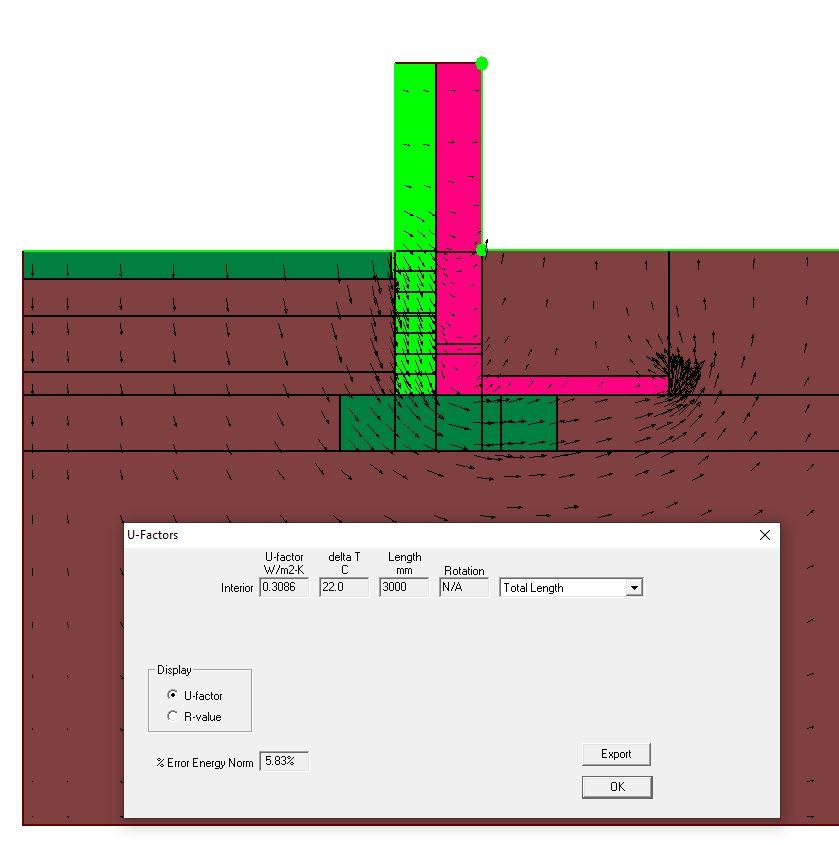

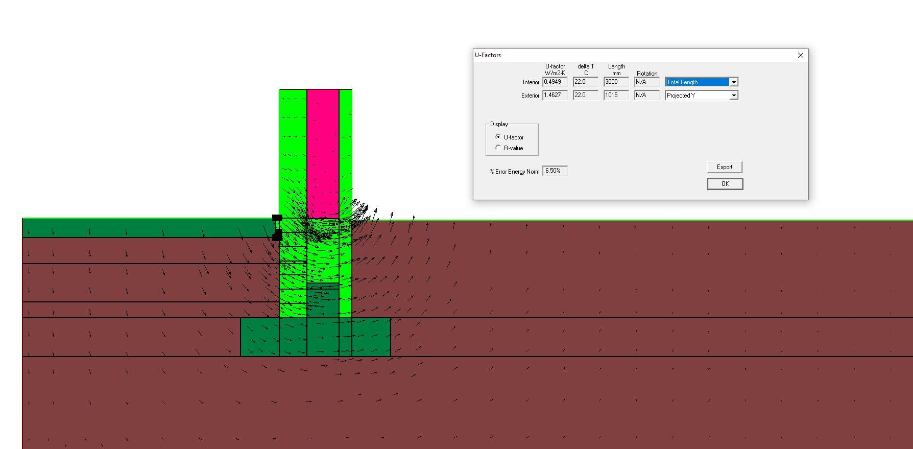

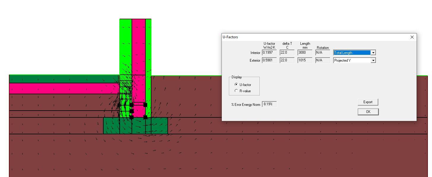

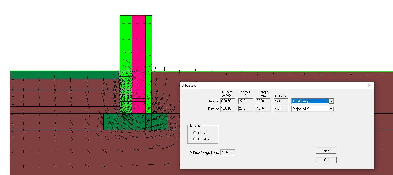

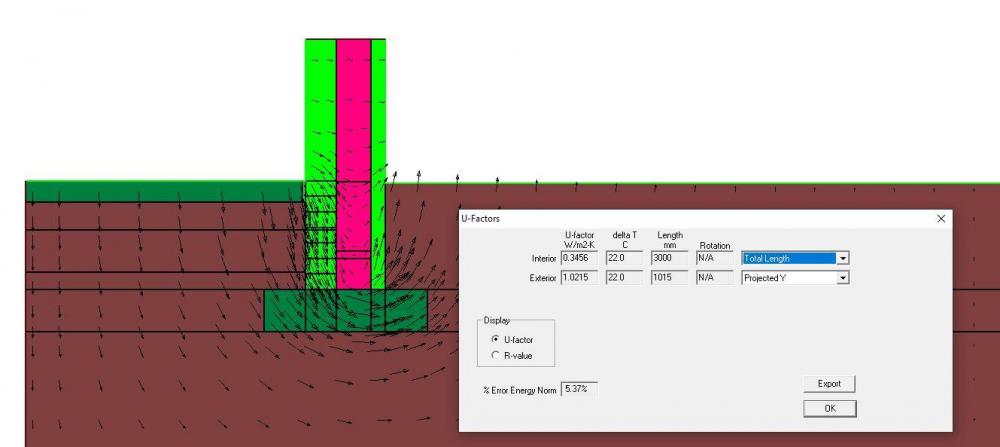

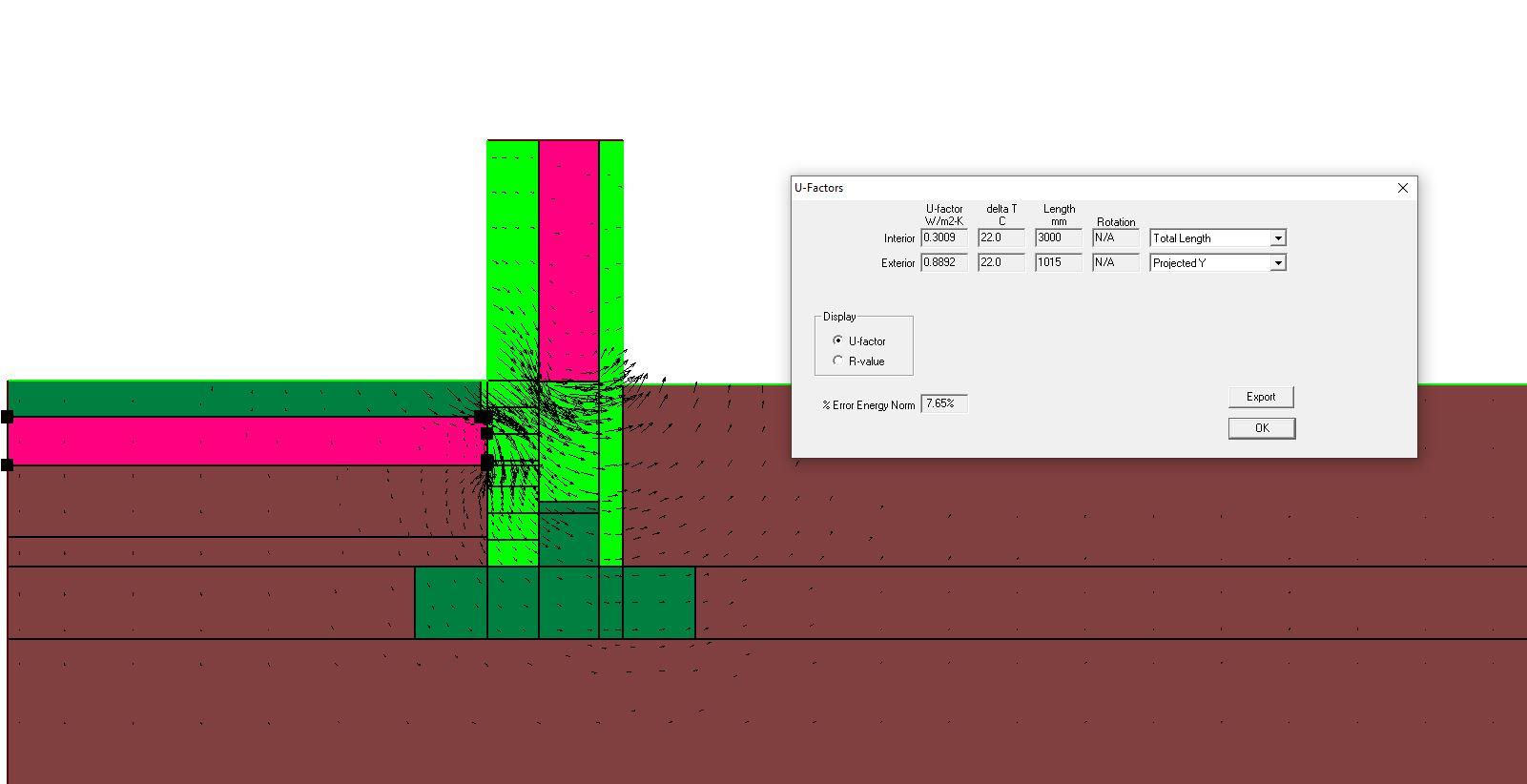

joth Posted October 25, 2021 Share Posted October 25, 2021 19 hours ago, Iceverge said: . Included a 1m wing and added 25mm of EPS above the floor to take the underfloor heating pipes. U value is 0.27 overall. I'm going to make a crude estimation and say this is the equivalent of putting 250mm EPS in your floor and not taking any measures against the wall/floor junction. Are you aware of anyone who has done the external horizontal wing? It was a detail on our plans, but our builder really wasn't happy to install it as they felt it wouldn't be very robust and likely cause whatever is above it to subside. We could still achieve Enerphit without it, so it was removed Link to comment Share on other sites More sharing options...
Iceverge Posted October 25, 2021 Share Posted October 25, 2021 (edited) Americans. https://www.jlconline.com/how-to/foundations/a-frost-protected-shallow-foundation_o 1 hour ago, joth said: It was a detail on our plans, but our builder really wasn't happy to install it as they felt it wouldn't be very robust and likely cause whatever is above it to subside Your builder needs to do more reading, it'll make him happier. EPS can be used in lieu of ballast in supporting railway lines. Edited October 25, 2021 by Iceverge Link to comment Share on other sites More sharing options...
ADLIan Posted October 26, 2021 Share Posted October 26, 2021 Its been a while since I used THERM but those GF U-values do not look correct - the U-value is more dependent upon the size, shape and edge conditions of the slab (plus any insulation). I would expect the ground floor of a 'typical' dwelling to have a U-value of approx 0.12 W/m2K with 200mm of EPS in it, adding vertical edge insulation would be of little benefit to the U-value in this instance. With no insulation the U-value would be approx 0.65 W/m2K, adding vertical edge insulation perhaps reducing this to 0.45 W/m2K. The external wing insulation would probably have little effect on the U-value - it is more for frost protection in colder climates. Link to comment Share on other sites More sharing options...
joth Posted October 26, 2021 Share Posted October 26, 2021 12 hours ago, Iceverge said: Americans. https://www.jlconline.com/how-to/foundations/a-frost-protected-shallow-foundation_o Your builder needs to do more reading, it'll make him happier. EPS can be used in lieu of ballast in supporting railway lines. Interesting! To be fair, it was the PH architect that authored the detail but couldn't back it up with evidence on longevity of the construction. IIRC the detail on our plans didn't mention what base the EPS should be laid on, which would be a lot of the issue. Either way I can see this would be easier done on a new build than a retrofit around existing founds, as ours was. Thanks Link to comment Share on other sites More sharing options...
