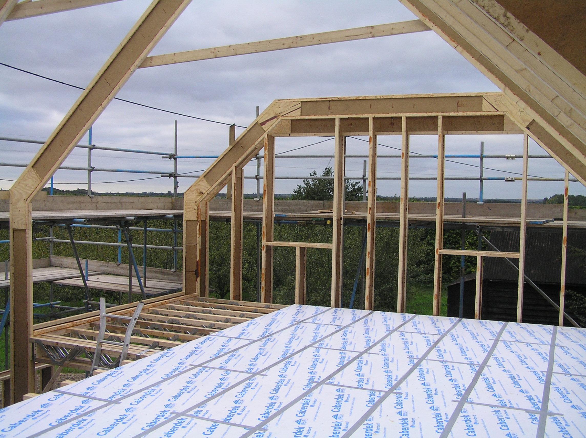

Ours was six weeks at this time of year between fitting the first floor and the roof being water tight. We used Caberdek and had the joins taped and we didn't have any problems although water pooled on the floor and I swept if off when required.
good to know. I'll find out tomorrow what our floor decking is and can report back!
I used Kronospan Fastclean deck with the joints taped - they guarantee up to 42 days (I recall) exposed.

It was done by the TF company but I think it was a type of gaffer tape but it had a metalised, (if that's a word), surface. It never came off until the protective layer was removed.

My caberdek joints were not taped but enough glue between sheets made the joints waterproof, I didn’t remove the excess until the roof was on.
