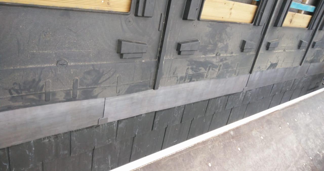

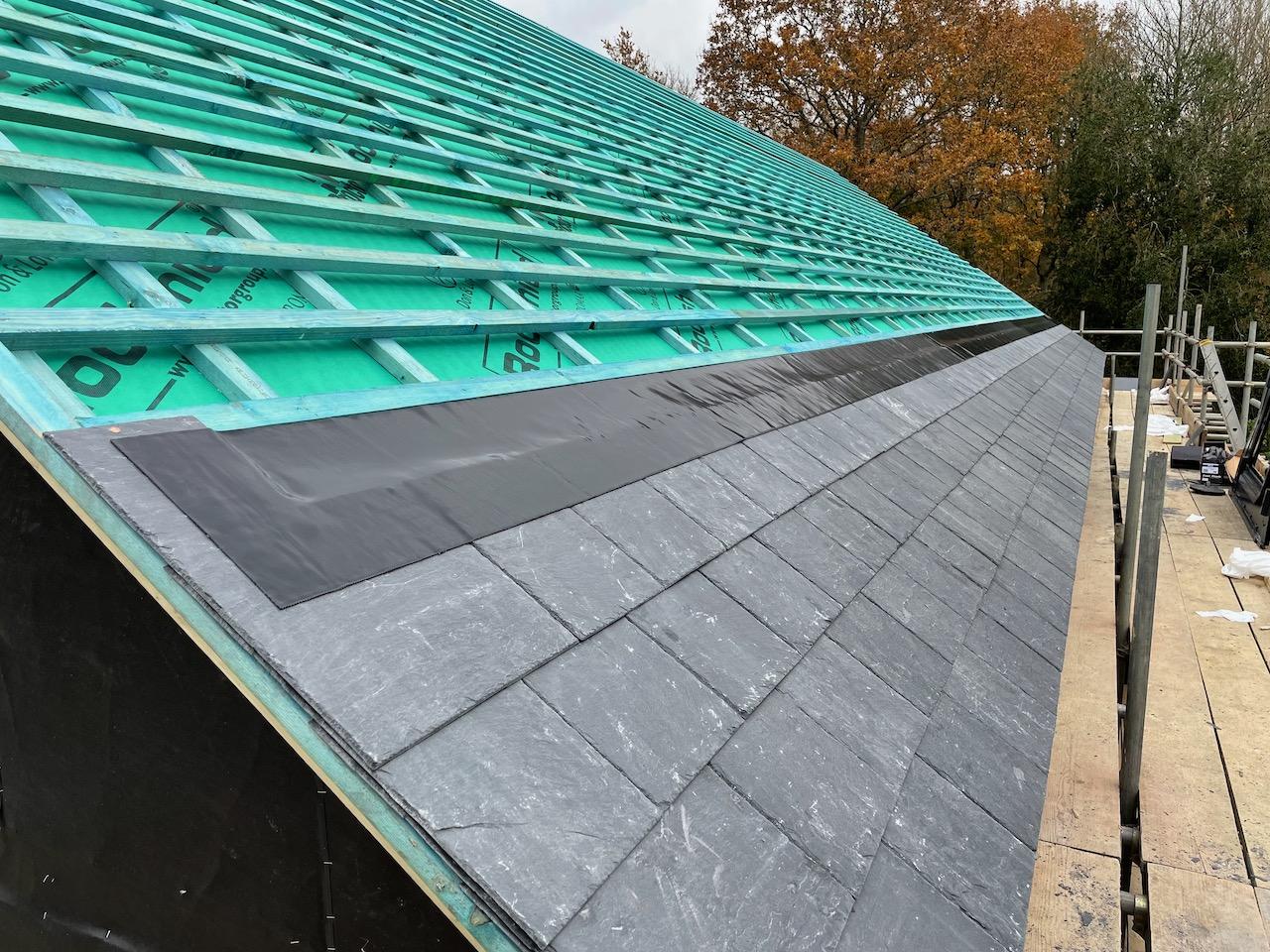

LiamJones Posted January 10, 2024 Posted January 10, 2024 On 24/10/2021 at 11:16, Thorfun said: our solar PV company sent us photos of lead flashing details for the GSE trays. the roofer said no problem and will be using Code 4 300mm lead flashing so we're going that route. @Thorfun do you know how the lead was held in place? Perhaps by those clips, do you know what they are called?
Thorfun Posted January 10, 2024 Posted January 10, 2024 20 minutes ago, LiamJones said: @Thorfun do you know how the lead was held in place? Perhaps by those clips, do you know what they are called? sorry. that's not a photo of our setup. we used a sticky fast flash product on ours. 2

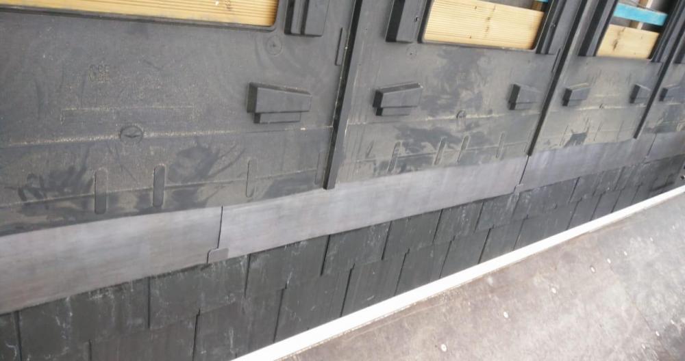

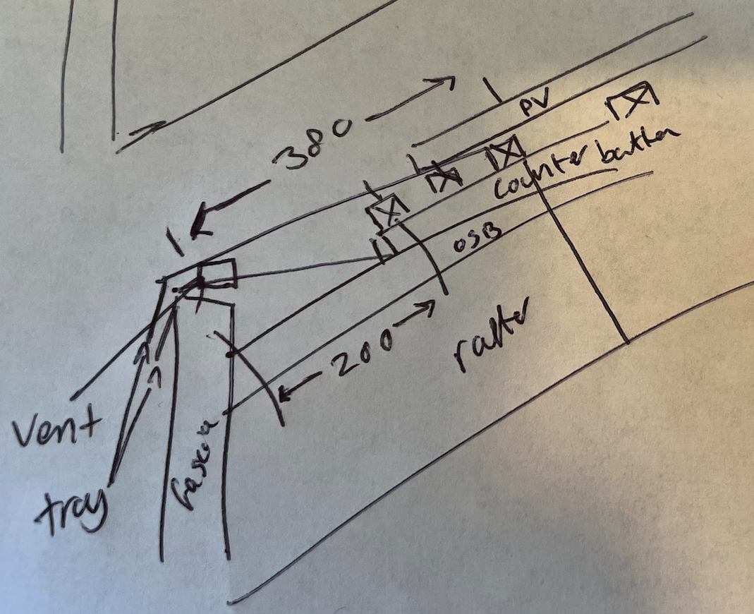

LiamJones Posted April 15, 2024 Posted April 15, 2024 On 11/07/2023 at 10:40, Jenki said: when I've got the solution, I'll blog the install and stand back for the replies... Have you managed to get installed yet? Im getting confused about the direct to eaves connection detail. they seem to want a 380mm eaves tray, but all standard trays are no more than 200mm. also a bit confused on how to get the ventilation under the panels, where would i put an "over fascia vent", between the two eaves trays? it all starts to look a bit messy if you kick up the last tile.
Jenki Posted April 15, 2024 Posted April 15, 2024 I installed 1 row of tiles at the eaves, and used fake lead flashing under the tray to the top of this row, it looked a better option than the panels into the gutter. I mentioned some of it in This blog, but I'll look later if I have any pictures of this flashing detail. 1 2
