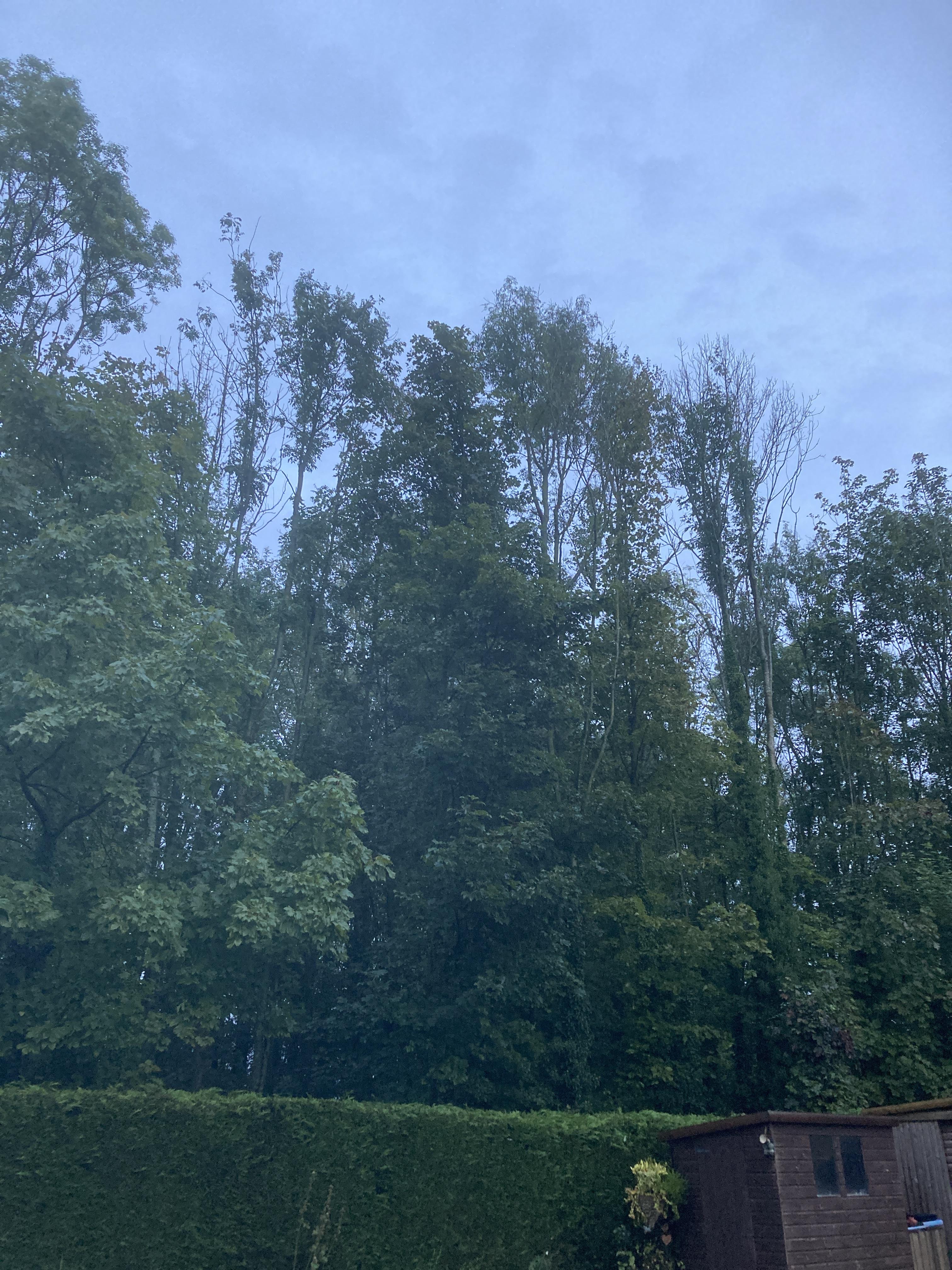

nod Posted September 30, 2021 Share Posted September 30, 2021 (edited) We are surrounded by Ash 7-12 metres high I’ve cut down about 40 of them and I’ve cut a deep x in the stump with my chainsaw Two years on all the stumps except four oak have rotted completely Edited September 30, 2021 by nod Link to comment Share on other sites More sharing options...
