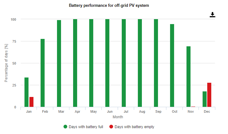

I considered what if our house was where yours was in Scotland with a 15kW array and a 20kWh battery storage system. ( Best installed price I reckon would be about £30,000)
According to PVGIS you would still be short for about 1/4 of the days in december.
You would have to make further lifestyle compromises like cooking on solid fuel, restricting appliance use etc during the winter. An electric vehicle would be out of the question Nov- Feb.
If you were to consider the same case in Brighton, with a 12kW array and a 7kWh battery you would short less than 7 days a year.
I think in your situation the electricity connection is your only option unless you want to live a country lifestyle of 100 years ago. Perhaps consider your petrol cost saved by changing to an electric vehicle as part of the equation when getting a grid connection.

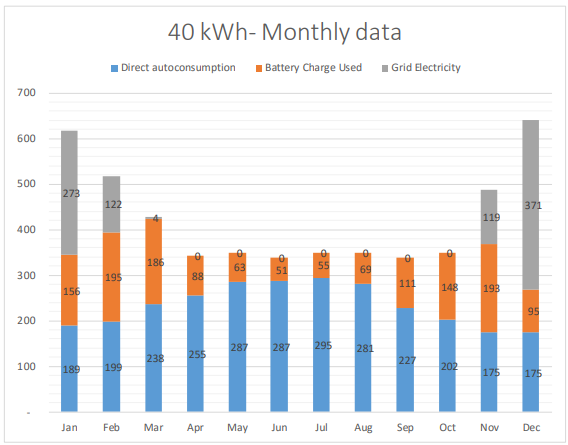

On 02/10/2021 at 10:21, pdf27 said:
https://www.bere.co.uk/assets/NEW-r-and-d-attachments/Lark-Rise-Self-consumption-study-by-Energelio-160429.pdf is worth reading deeply if you're seriously considering going off-grid. It's the calculations for how close to autonomy you can get with a ~200m2 Passivhaus in the southern UK with 13kW of PV and a battery of varying sizes.
Even with a very big battery (40 kWh in this case), in December it's still importing ~60% of electricity demand from the grid.  Per PVGIS for Aberdeen, you'd need at least a 30kW ground-mount system to meet demand in December, which is the hardest month to handle - in the process producing 27,000 kWh nearly all of which would go to waste. You could probably downsize a bit as you're looking at a smaller house, but given how well insulated the example given is you're going to struggle with getting a 50% reduction without going full Passivhaus. Going off-grid with only PV and batteries in the UK is exceptionally hard.
Assuming you need 500 kWh in December to give you some margin (most of the power coming from PV throughout the year), you only need a steady-state power of 700W to keep things going which isn't huge. Small wind turbines are very site-specific and a bit of a lottery though - average capacity factor seems to be in the 15-20% region (inferring you'd need ~5kW installed power), but can be very high or low.
One interesting note - heating demand is 1000 kWh of electricity a year in this model and DHW another 800 kWh/year. Take that away and over an **average** year, you'll be able to run everything else 100% on PV. In the model the COP is assumed to be 2.8, so heat demand is 5100 kWh/year => equivalent to about 400 kg of Propane. So an LPG boiler plus standby propane-fuelled generator in case you get a week of miserable weather might be a decent option in your case. As noted the power draw will be very low from it - it's only there as a backup for the few times a year that the batteries run out and need a top-up, so fuel burn and running hours will be relatively low.
Resale value is going to be higher on-grid and running costs a bit lower, but not shockingly so. It's really important that the house is very low-energy though - the cost per kWh of off-grid energy is much higher than on-grid. If it was my build, at £30k I'd go for a grid connection (mostly considering resale and the faff-factor), but if it ended up being a lot more (£50k+) then off-grid is feasible.

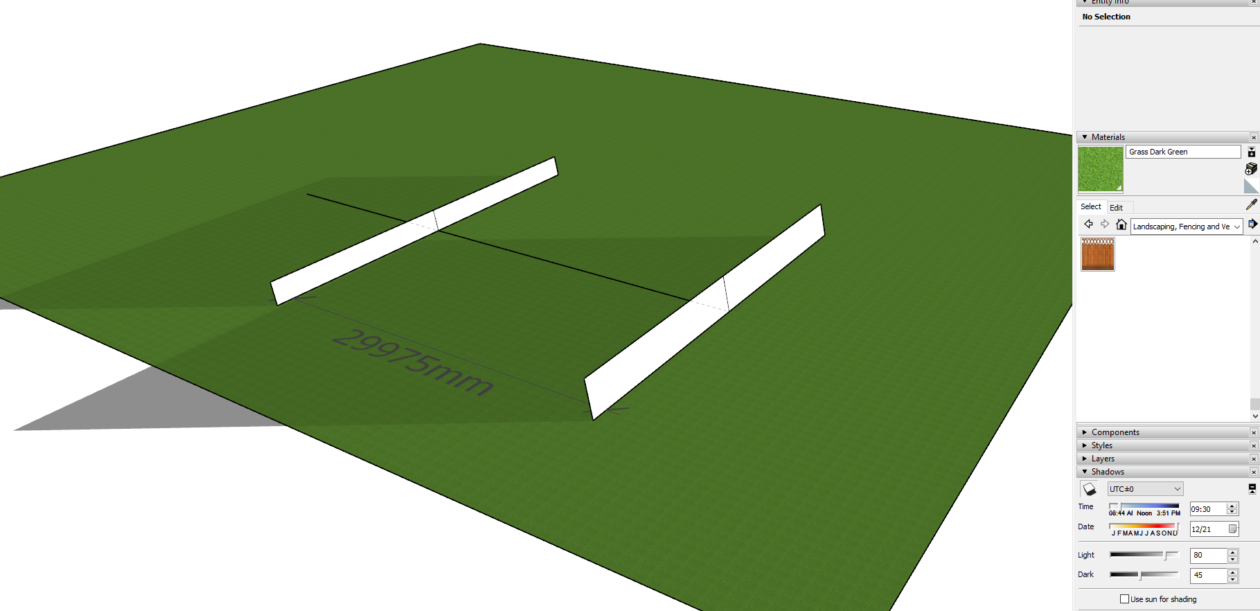

On 02/10/2021 at 11:23, Iceverge said:
@pdf27
An excellent post. I will dissect the full PDF later
One point I would caution though with this is they had their array at 10deg (due to architectural/planning constraints I assume).
If they were able to mount them at 75deg they would have been much more optimum for winter production. Annual production would have only dropped slightly 10.9MWh to 10.4 but their December production would have doubled from 237kWh to 487kWh.
I wonder if this would have resulted in significant shading? They would need a lot more surface area to spread out the panels to prevent shading at this angle.

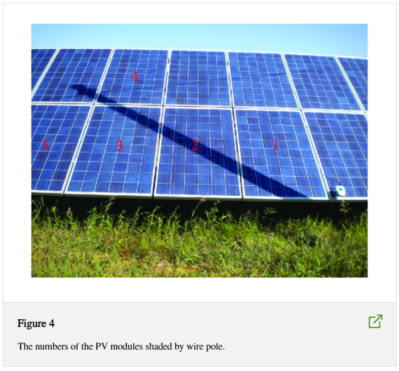

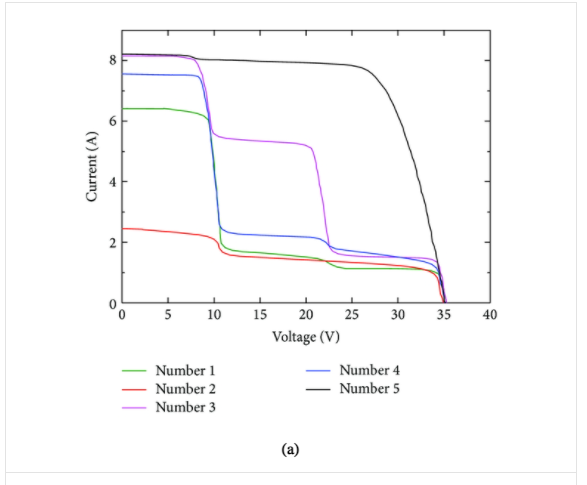

Any shading is bad news for solar panels.
Have a look at the below picture and graph. Panel 5 is considered a reference unshaded panel.
For a ground mount array you should assure that all panels are unshaded from 09:00 to 15:00 local solar time on the winter solstice. Practically this may preclude setting them out in multiple rows at your latitude as the spacing will be very large.
https://www.hindawi.com/journals/ijp/2014/763106/

At your latitude, with 2m high panels mounted 1m high on level ground you would need 30m spacing to ensure minimal spacing.
Unless you plan to burn something for winter heat/DHW or live like a narrowboater you're better off getting a grid connection.
