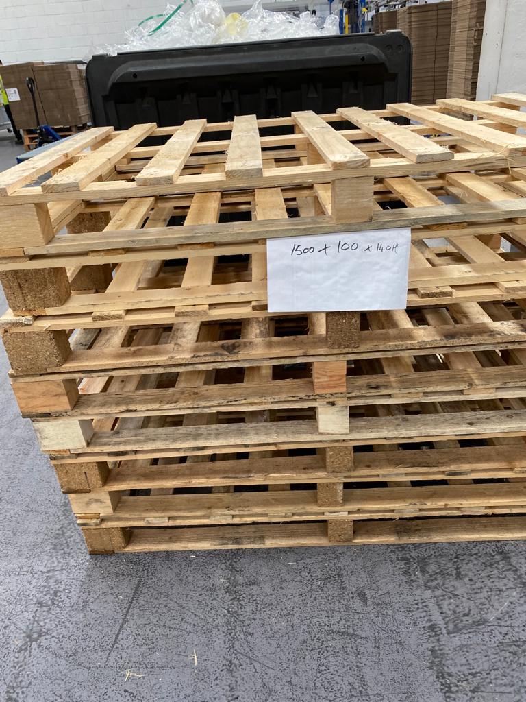

Onoff Posted September 29, 2021 Share Posted September 29, 2021 31 minutes ago, Drums617 said: Is there such a thing,surely 30 quid a time now? That looks great though. Hope so, I'm due to collect fourteen 1500x1000 pallets! The shed in the photos was made by someone with little or no woodworking skills when he started. Just nudged in the right direction. Link to comment Share on other sites More sharing options...

saveasteading Posted September 30, 2021 Share Posted September 30, 2021 Pallets are worth nothing if you want to sell them. Suppliers charge you a deposit for them ten wont take them back. Therefore there are lots of them unwanted, especially by merchants and on sites. any builder would rather give them away than skip them. just beware of the very clever minimalist ones that are made of very skinny timber and mdf, cardboard/chipboard. Link to comment Share on other sites More sharing options...
ProDave Posted September 30, 2021 Share Posted September 30, 2021 I built an entire shed of dismantled and rebuilt pallets. Several were stripped for useable fencing wood, and I have just used the last 9 of them to floor my "solar shed" with the remainder joining the firewood pile. Link to comment Share on other sites More sharing options...

Carrerahill Posted September 30, 2021 Share Posted September 30, 2021 14 hours ago, Drums617 said: Is there such a thing, surely 30 quid a time now? That looks great though. Where have you been asking? Non-reusable pallets are a waste product of the logistics industry. The country is awash with them. I build log stores with them and break up into kindling or use the big blocks as firewood. The blue/red/green stamped ones are reusable pallets which will stay in service for x number of trips however they are used by logistics routes where return journeys or repeat services can keep the moving back and forward. I know a security guard our business estate and gathers 400-500 odd at a time then sells them for a pound each. Link to comment Share on other sites More sharing options...
Onoff Posted September 30, 2021 Share Posted September 30, 2021 (edited) Bigger pallets can yield decent lengths of "shed" wood. Can be a bit of a mission to break them up successfully without a pallet buster.....like the one I made: (It now has the addition of a couple of strategically placed springs to stop the angles tipping forward). Edited September 30, 2021 by Onoff 2 Link to comment Share on other sites More sharing options...
