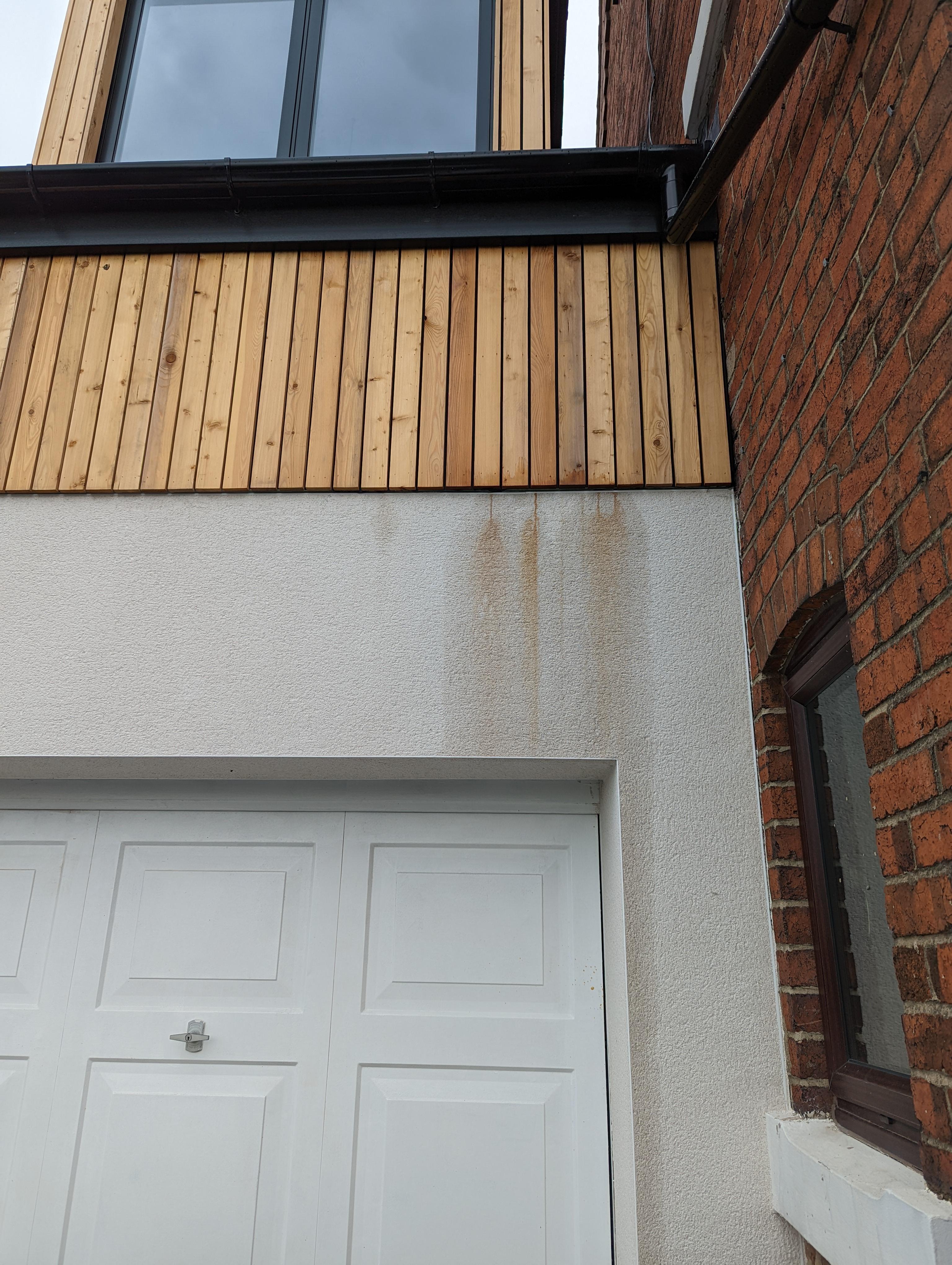

daunker Posted September 29, 2021 Posted September 29, 2021 (edited) I have untreated Siberian larch cladding and just had the renderboard below rendered a couple of weeks ago. The larch was put on in April. Anyway just had some rain and seems like the water running down the cladding is staining the new render below. This is only after two rainy days... Really worried how this will look by end of winter? The rendering is thin coat system. Is there anything I can do to stop this happening, and secondly to clean if presumably I can stop it. Edited September 29, 2021 by daunker
nod Posted September 29, 2021 Posted September 29, 2021 It is a common problem Only sealing the cladding will stop this 1
daunker Posted September 29, 2021 Author Posted September 29, 2021 (edited) Thanks very nuch. Any drawbacks to sealing it, is there a good product? As it's in situ I'll only be able to do the front face. Will it stop leaching on its own accord, or is that a very slow process. Any advice on cleaning will rain and sun bleach and wash it or is there a recommended cleaning agent. Sorry for all questions thanks @nod. I'd not heard of it before or I'd have not put up untreated, I thought all the coatings were to colour preserve from sun bleaching (which doesn't overly concern me) Edited September 29, 2021 by daunker
ukmgranger Posted July 26, 2022 Posted July 26, 2022 Hi there @daunker Did you ever resolve this issue? We have exactly the same problem. When it rains, the cladding is leaching onto the white render below. It also drips onto the windowsills and stains the render around these, and also stains around the boiler flue, and outdoor lighting on the render too. Looks pretty awful at the moment to be honest. We wanted the cladding (Siberian Larch) to weather naturally to a grey, but are worried it is ruining the render in the process. 1

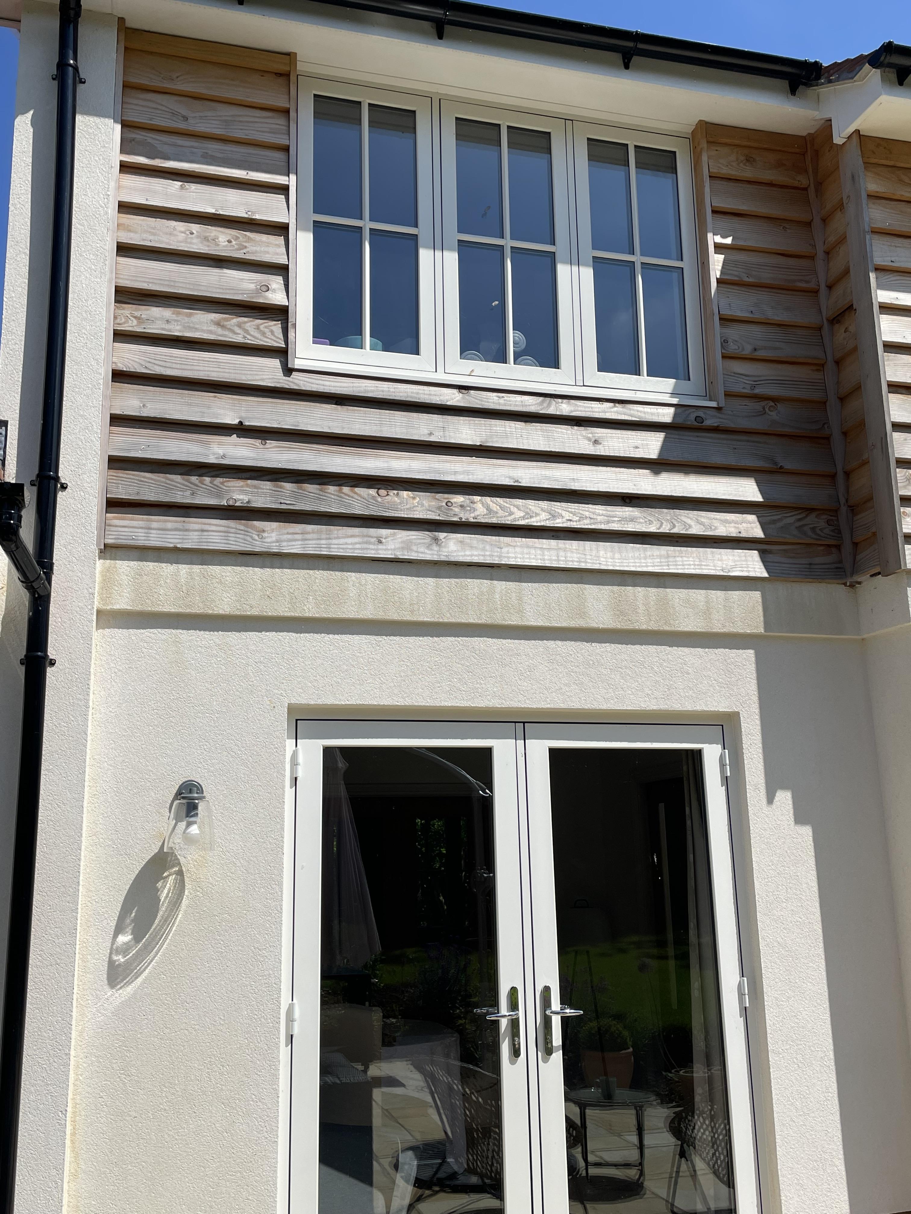

Strawberry Posted May 20, 2024 Posted May 20, 2024 Hi @daunker and @ukmgranger I have the same thing happening on my newly renovated house - it looks terrible! I have VPI thin coat render below Douglas fir cladding with staining as per your photos. I am wondering if you found anything to clean the stains from the render? Or to stop the staining? @daunker I see that sunlight may have improved things for you - is the staining completely gone now? many thanks all 😃
Russdl Posted May 20, 2024 Posted May 20, 2024 On 20/05/2024 at 19:32, Strawberry said: I have the same thing happening on my newly renovated house - it looks terrible! Expand That’s bad news. It needs a proper drip flashing to stop what’s happening in the pictures above, which I guess you don’t have. I suspect one could be retrofitted, but at a cost. Can you go back to whoever installed it all in the first place and get them to rectify it and then fix the render? Is the work guaranteed? Got a photo? 1

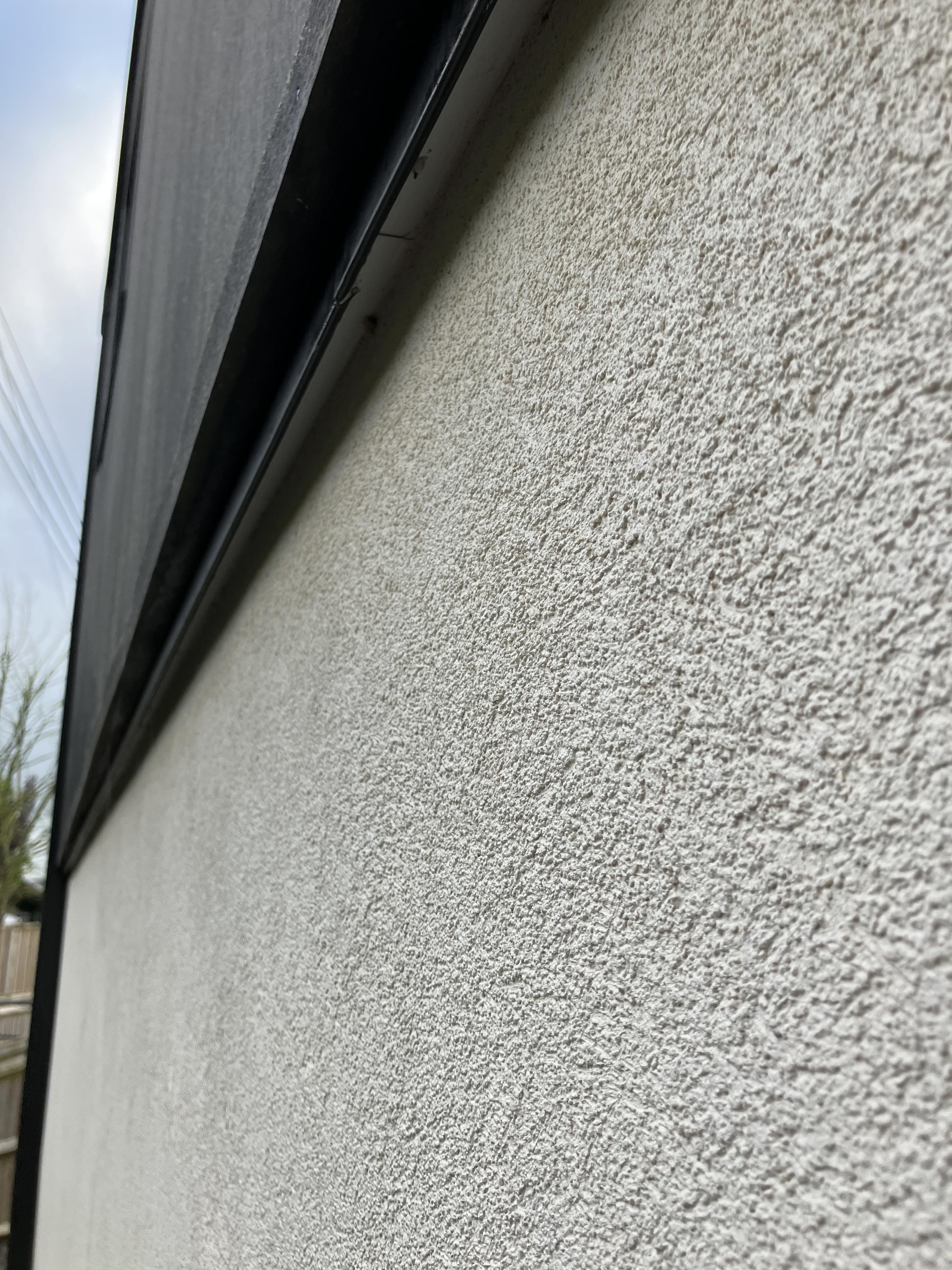

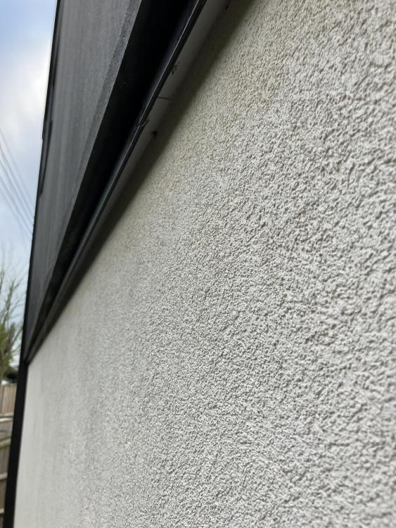

Strawberry Posted May 21, 2024 Posted May 21, 2024 Thanks for your reply @Russdl I have attached a photo which shows the problem we face. The staining is mostly contained to the band detail we have which runs below the cladding. Getting the builder back who did the work won’t be possible - to be honest he followed the architect drawings/spec and nothing else was indicated on it. I had thought of having a drip tray retrofitted which we can do. I briefly mentioned my idea to a renderer and it wasn’t well received as they indicated we would still get staining from wind blown rain. Has anyone who has a drip tray able to advise here? Also what sort of spec should I be looking for? I think the alternative might be stain blocking the cladding which will be more expensive as it will require scaffolding all round the house 😏 Thanks so much for your time.

Strawberry Posted May 21, 2024 Posted May 21, 2024 Thanks for your reply @Russdl On 21/05/2024 at 17:15, Andehh said: Seeing as render doesn't absorb water, any stain would surely eventually wash off? Just a game of patience to let it all leach out the wood, then wash awahm Expand hmmmm - only thing is, these stains don’t wash off. Have tried pressure washing on the fan setting and also used brick acid which removes tannin drip stains on the render caused by our oak frame porch, but not these stains from the cladding. I would be happy (delighted in fact!) to just sit back and wait if I felt confident the situation will resolve itself, but am not feeling confident about that approach at the moment. @Russdl - if you have photos or spec for your drip flashing that would be great. Thanks so much for your time.

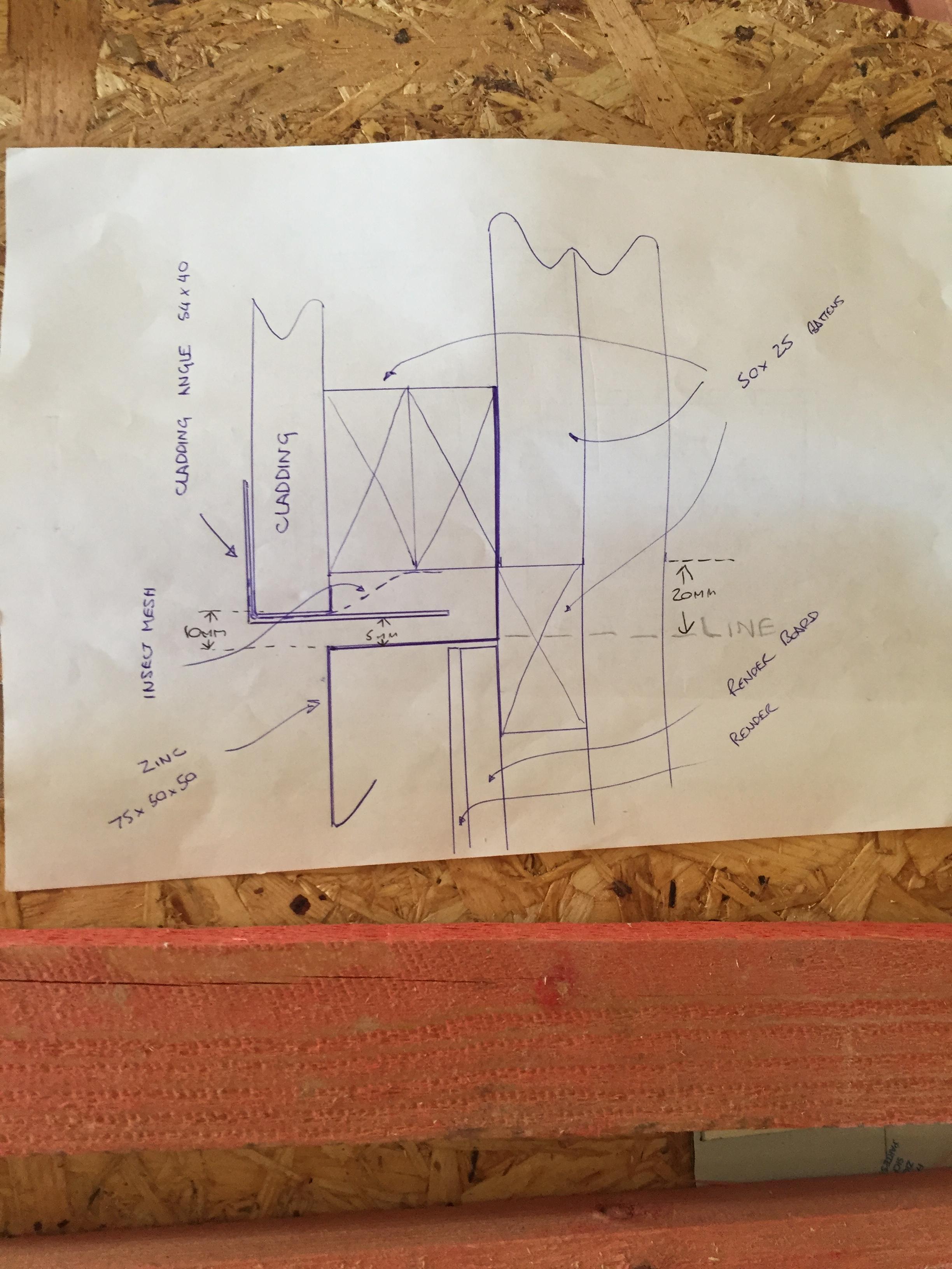

Russdl Posted May 22, 2024 Posted May 22, 2024 @Strawberry still not made it home yet but I’ve found one of my drawings detailing the cladding/render join and the zinc drip. It obviously doesn’t have to be zinc, or metal. Just anything to stop the water going directly from cladding to render. It’s not that clear but our zinc drip is a stretched out ‘Z’ shape. It may be possible for you to do something similar to the drawing below and slide something up behind your cladding so that it can be firmly fixed in place and then project out over the render.
Strawberry Posted May 22, 2024 Posted May 22, 2024 Thanks very much for this, @Russdl I have reviewed the construction drawings prepared by our architect and there is no mention of a flashing detail here. It seems your work is of a higher quality! Thanks very much for this - it is very helpful. I am reluctant to spend (more) money unless I feel confident it will improve/resolve the situation and it has been difficult to get to this point. I also noticed you are just up the road from us - albeit with a nicer looking house I imagine 🤣
