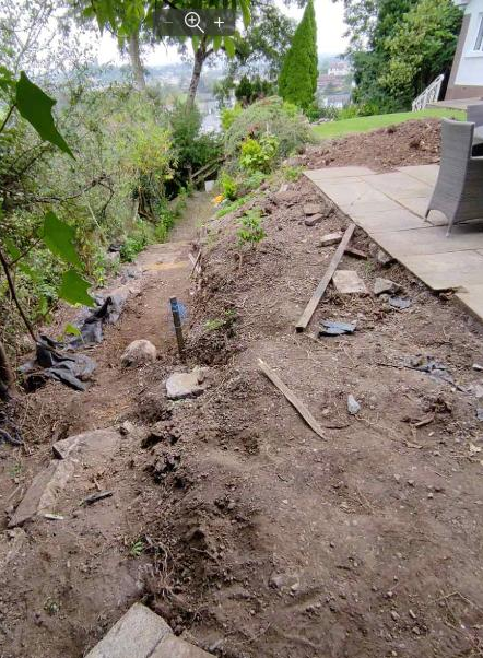

mangers Posted September 29, 2021 Author Share Posted September 29, 2021 50 minutes ago, Andy brown said: Could you not use another solution? Every thing needs to brought in from front to back. Zero direct access in the back. Concrete lego blocks would be perfect but they'd break my back carrying them in from the front. ? In addition to retaining wall, the 2m high gabions will allow me to level out the garden with back fill. Had thought of raised decking but i'd still need something to retain the bank. Here's a picture from a few weeks ago... have since dug/pickaxed more since. I honestly don't mind the carrying of stone from front to back, wheelbarrow at a time. I could spend 1 hour in the gym or get a great weekend workout this way. Link to comment Share on other sites More sharing options...
Haylingbilly Posted September 29, 2021 Share Posted September 29, 2021 I had 10 tonnes to shift about 30meters distance but 5m incline. My structural engineer recommended a lightweight solution as was worried about the weight of gabions on the back of the house. Thank god he did, the lightweight solution nearly broke me! Do you even need a retaining wall there - looks like it is for landscaping and is the bank stable enough as it is? If you do a sleeper wall would be so much easier to move - probably 100kg of material to move per linear meter vs 3 tonnes! I really would test moving a tonne of stone before you commit to moving 300 odd tonnes. That is a massive undertaking, really is. I had the same view as you regarding an alternative to the Gym but my solution ended up being a tonne but it was still no laughing matter! Link to comment Share on other sites More sharing options...
mangers Posted September 29, 2021 Author Share Posted September 29, 2021 2 minutes ago, Andy brown said: moving 300 odd tonnes Well that would kill me, I only need (only says he) about 40t. I was thinking of making a small investment in one of these if the going gets too tough... it'll squeeze nicely down the side of house to the back. That bank you see in picture has been like that since I tackled it in our first lockdown. Hasn't budged. Not to say it won't budge. It might some day. Not a gamble I'm willing to take. Not even with a sleeper retaining wall. I'd just feel happier with something a bit more solid and weighty down there. One option is to just retain this bank with 1m3 of retaining gabion. Then instead of going another 1m course higher in gabion, just have a raised decking to level garden. Anyway, this digresses from main thread title. I'll start another thread on that if I get that far. Link to comment Share on other sites More sharing options...

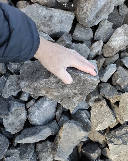

mangers Posted September 29, 2021 Author Share Posted September 29, 2021 (edited) 56 minutes ago, Dave Jones said: if the gabions need facing ...they don't in my case. Anything goes, as long as it's cheap and structurally sound. Got call back from delivery guy... here's break down so far: 40t clean limestone (150mm) @ £9 per t = £360 £40 delivery for every 5 ton, 8 deliveries = £320 Total delivered = £680 (inc. vat) - works out at £17/t delivered. All I need to know now is if (clean) limestone is suitable and if it is I think I got myself a bargain considering I can get it delivered incrementally like above in 5 ton batches. Edited September 29, 2021 by mangers Link to comment Share on other sites More sharing options...
Cpd Posted September 29, 2021 Share Posted September 29, 2021 1 hour ago, Andy brown said: Do you even need a retaining wall there - looks like it is for landscaping and is the bank stable enough as it is? I would second this, it looks like where you have already cut the bank back it’s already greening up which is a good sign it’s fairly stable, obviously I can’t see in detail but the solution your looking at seems a bit over the top. I have a very similar bank I cut back 10 years ago with the information of putting gabions in and it’s still not done and still not fallen down and it’s right behind my house ! I am just put of by the cost of the actual gabions….. and I cannot get more than 2 tons of stone at a time. I have still not come up with a cheap solution so can’t help on that front but I have moved hundreds if not thousands of tons of stone by hand over my life (stonemason) and it’s really a pig of a job when it’s a situation like your explaining. Just make sure you really do need to (or really want to) go down the gabion solution before committing! For another job I made my own out of fencing wire ! The volume of stone it took was catastrophic but it had up to 1m behind it fully filled with stone as well. Link to comment Share on other sites More sharing options...
markc Posted September 29, 2021 Share Posted September 29, 2021 (edited) Got to agree with the above, gabions (still trying to auto correct) are intended in place of cast in situ walls/abutments or sheet piling etc. if the bank is well established then the root systems will hold it Edited September 29, 2021 by markc Link to comment Share on other sites More sharing options...

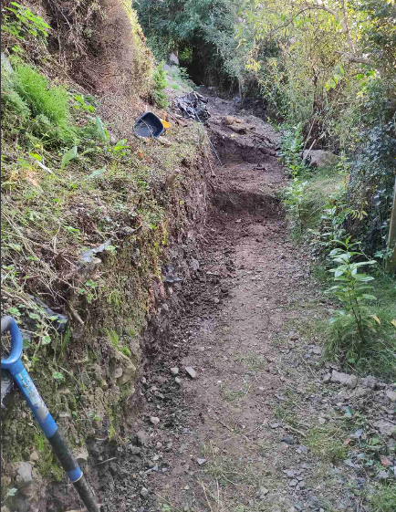

mangers Posted September 29, 2021 Author Share Posted September 29, 2021 Thanks everyone for your feedback. Food for thought. Here's another angle. The bottom of trench is around 4m below the house level and 8m horizontally away from the house. Gabions was my preferred option as 1. Solid 2. I wanted to extend and raise the back of garden up by 2 metres and back fill with soil. Though 2m won't level the garden it would make a huge difference. Link to comment Share on other sites More sharing options...

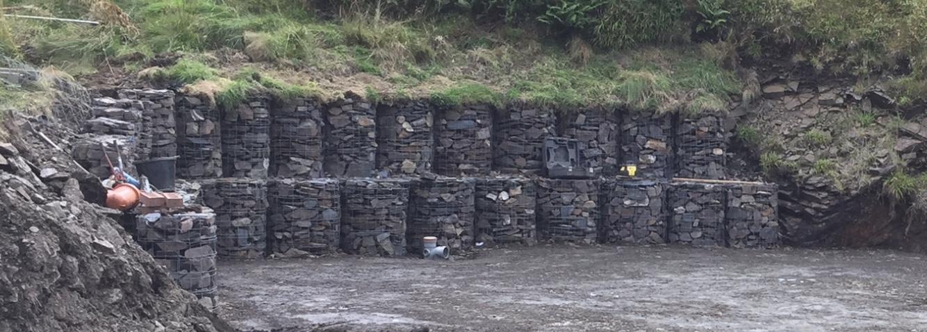

Cpd Posted September 29, 2021 Share Posted September 29, 2021 This picture put it into context, gabions will be perfect ! pictures speak a thousand words and all that….. 1 Link to comment Share on other sites More sharing options...
Haylingbilly Posted September 29, 2021 Share Posted September 29, 2021 36 minutes ago, Cpd said: This picture put it into context, gabions will be perfect ! pictures speak a thousand words and all that….. Doesn't it just? Now it makes sense... Gabions would work but I would not underestimate how hard it will be to move 50 tonnes by hand I would look at Criblock Retaining Walls - @mangersyou have the perfect space for them. 1 Link to comment Share on other sites More sharing options...

mangers Posted September 29, 2021 Author Share Posted September 29, 2021 CPD and Andy. Thanks for the gabion reassurance. Thought I figured it out all wrong. Andy, those criblocks look really interesting. The tiny bit I read I think I'd nearly prefer them than the gabion solution. Looking forward to a quiet house later once everyone is in bed to do further research and costs. 1 hour ago, Bramco said: expansive stone If I could source rubble or demolition brick I would, though I thought 40t of stone delivered for £680 was a decent price. Plans might all change if those criblocks are cost effective. Thanks folks. Link to comment Share on other sites More sharing options...
Dave Jones Posted September 29, 2021 Share Posted September 29, 2021 7 hours ago, mangers said: ...they don't in my case. Anything goes, as long as it's cheap and structurally sound. Got call back from delivery guy... here's break down so far: 40t clean limestone (150mm) @ £9 per t = £360 £40 delivery for every 5 ton, 8 deliveries = £320 Total delivered = £680 (inc. vat) - works out at £17/t delivered. All I need to know now is if (clean) limestone is suitable and if it is I think I got myself a bargain considering I can get it delivered incrementally like above in 5 ton batches. well if its not seen, then i would use 75mm-150mm mixed clean. will be easier to fill. Also the 3mm gabions tend to bulge easily the 5mm are much better. Dont forget to put the tensioner wire in the middle when half filled. Link to comment Share on other sites More sharing options...
