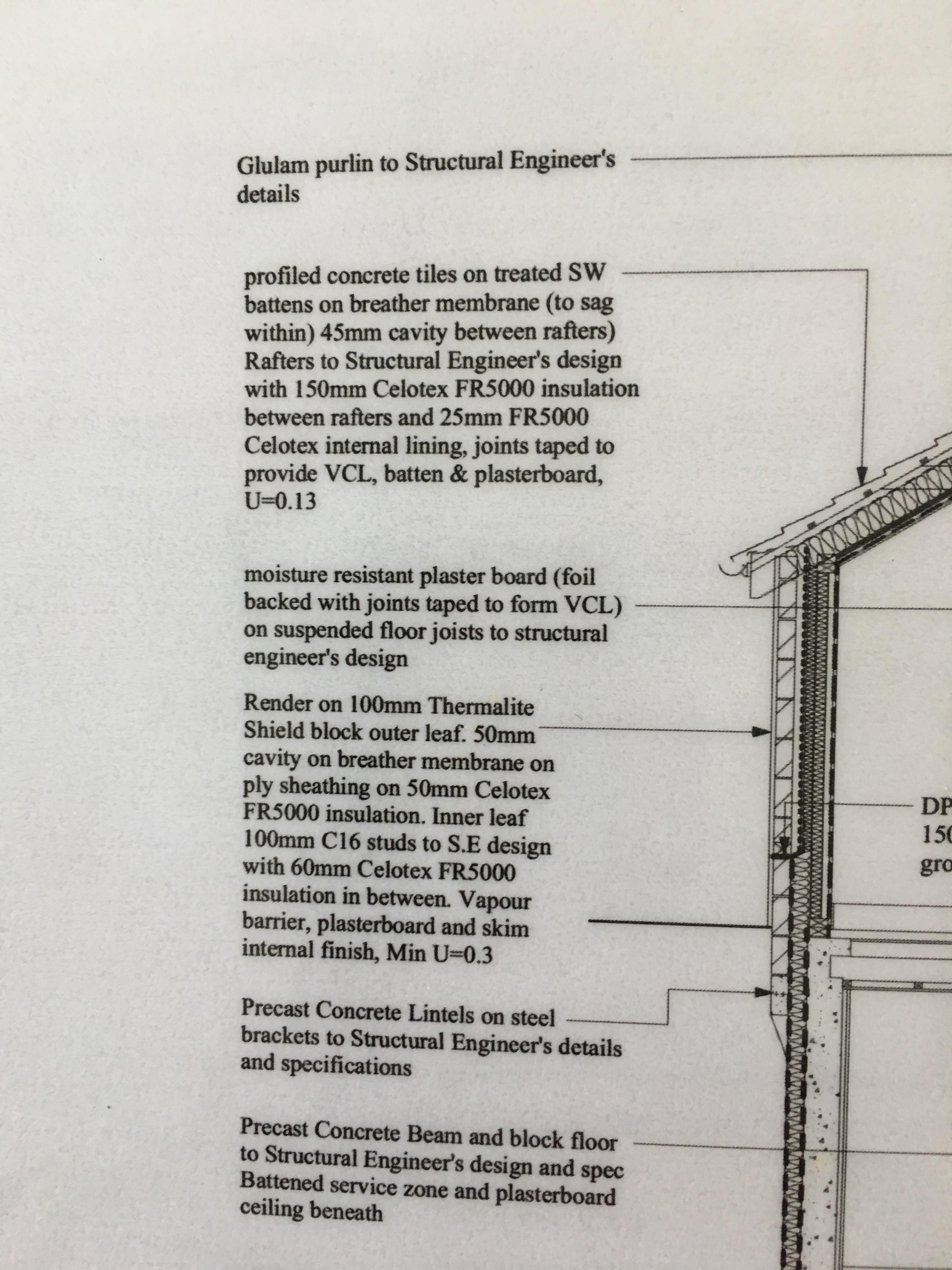

PeterW Posted March 31, 2017 Share Posted March 31, 2017 1 hour ago, pocster said: No . Build outer wall ; stick roof on . Then insulate inside and steel stud up . Why do the other way around ???? So are the structural brackets taking the load of the outer skin and the roof ..?? Have building control signed that design off ...?? Link to comment Share on other sites More sharing options...
Pocster Posted March 31, 2017 Author Share Posted March 31, 2017 Unless I'm missing something - yes take a look !! Link to comment Share on other sites More sharing options...
Pocster Posted March 31, 2017 Author Share Posted March 31, 2017 6 minutes ago, PeterW said: So are the structural brackets taking the load of the outer skin and the roof ..?? Have building control signed that design off ...?? SE approved the brackets that support the lintels down one side of the build Link to comment Share on other sites More sharing options...

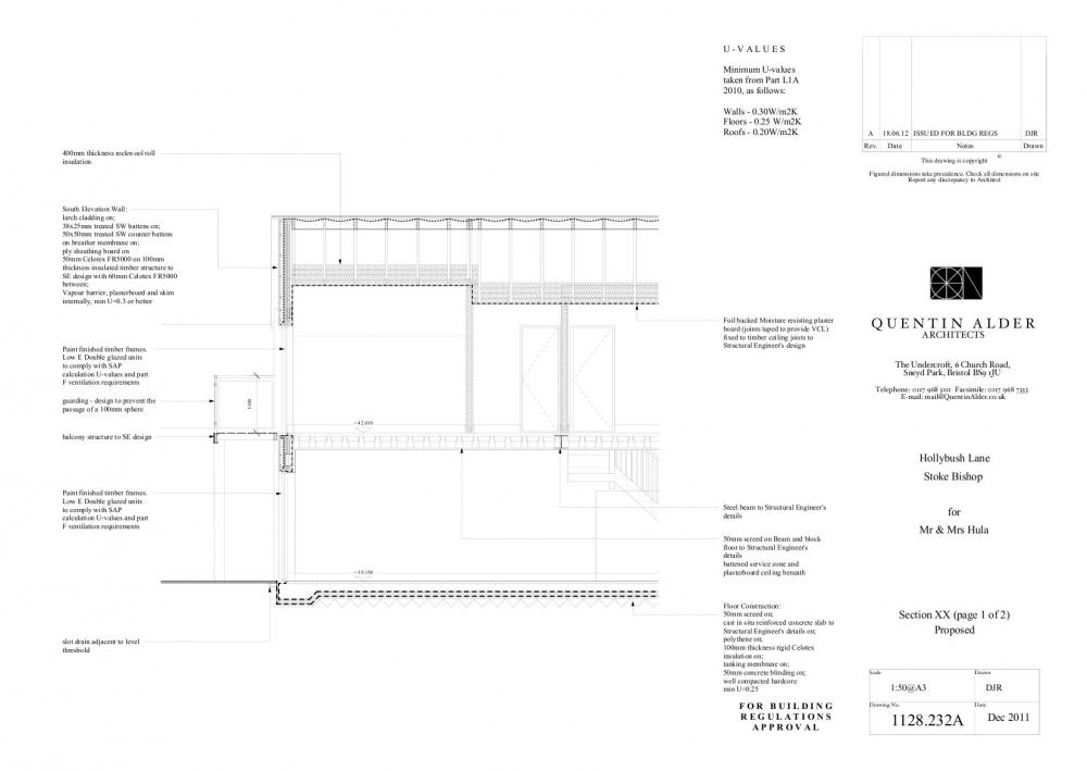

PeterW Posted March 31, 2017 Share Posted March 31, 2017 I hate to break it to you but the roof is sat on the inner skin, not the outer ... look how the blocks go up and through the roof joists in the design. The two rectangles with crosses at top and bottom are the sole and wall plates of the inner walls - are those supposed to be timber ..?? The roof joists sit on the wall plate and that transfers the weight through the frame to the sole plate , not the outer skin. Suggest you speak to your SE about that detail as that is how I read it. To add : read the build up. Inner leaf C16 to SE design. That's a structural timber frame. Link to comment Share on other sites More sharing options...
Pocster Posted March 31, 2017 Author Share Posted March 31, 2017 (edited) 3 minutes ago, PeterW said: I hate to break it to you but the roof is sat on the inner skin, not the outer ... look how the blocks go up and through the roof joists in the design. The two rectangles with crosses at top and bottom are the sole and wall plates of the inner walls - are those supposed to be timber ..?? The roof joists sit on the wall plate and that transfers the weight through the frame to the sole plate , not the outer skin. Suggest you speak to your SE about that detail as that is how I read it. Erm ok . If that's correct then what exactly is the inner skin made of ???? i can't see a definition for the inner skin in that diagram - or am I missing something ??? inner leaf c16 stud ??? ; does that take the roof loading ??? Edited March 31, 2017 by pocster Link to comment Share on other sites More sharing options...
PeterW Posted March 31, 2017 Share Posted March 31, 2017 It's a structural C16 100mm timber frame to SE design so I would expect its 100 x 50 C16 on something like 400 centres. Double sole and wall plate from that picture. Link to comment Share on other sites More sharing options...
Pocster Posted March 31, 2017 Author Share Posted March 31, 2017 1 minute ago, PeterW said: It's a structural C16 100mm timber frame to SE design so I would expect its 100 x 50 C16 on something like 400 centres. Double sole and wall plate from that picture. Right ! so internal timber stud to take roof loading . Therefore no point having steel studwork also - that was just for plasterboard etc etc . sorry ! My confusion !! Link to comment Share on other sites More sharing options...
PeterW Posted March 31, 2017 Share Posted March 31, 2017 It's not studwork, it's a timber frame. It has to be built as a structural element to the SE design which you need to get hold of. You can use steel dry lining profile where it's not load bearing. Link to comment Share on other sites More sharing options...
Pocster Posted March 31, 2017 Author Share Posted March 31, 2017 Ok thanks ! i guess because I don't have the SE design for this that's what confused me . appreciated ! . I'll just get my external block work up for now !! Link to comment Share on other sites More sharing options...
