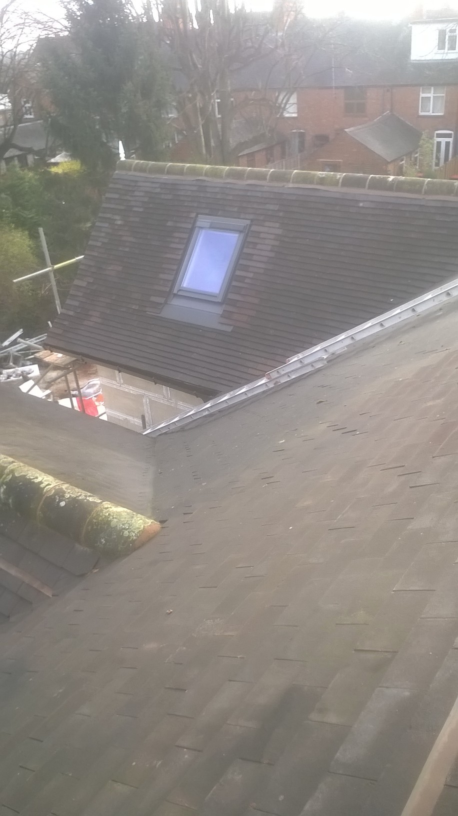

I had a similar desire, but looking for Acme Sandstorm in dark/black coloured, they have EVERYTHING at Carwarden, but at a price. £4.50+VAT for a tile and a half I decided to buy new.
At the end of the day nobody spends that much time looking at the roof.
You can see in this photo I used new tile and a halves. They are a decent match except where my supplier gave me staffs mixed instead of staffs blue, but I wasn't going to waste time going back to change them!

I can understand you wanting to get the right colour if it is on display at the front of the house, the ones in my picture are not easily visible (unless you are on the roof taking a photo).
Depending on the nature of the position etc have you thought about cutting two tiles to the size of a tile and a half and putting a lead soaker underneath, this could then be replaced as and when you find the correct tile and a half. (no good if you are cutting the tile and a halves)
