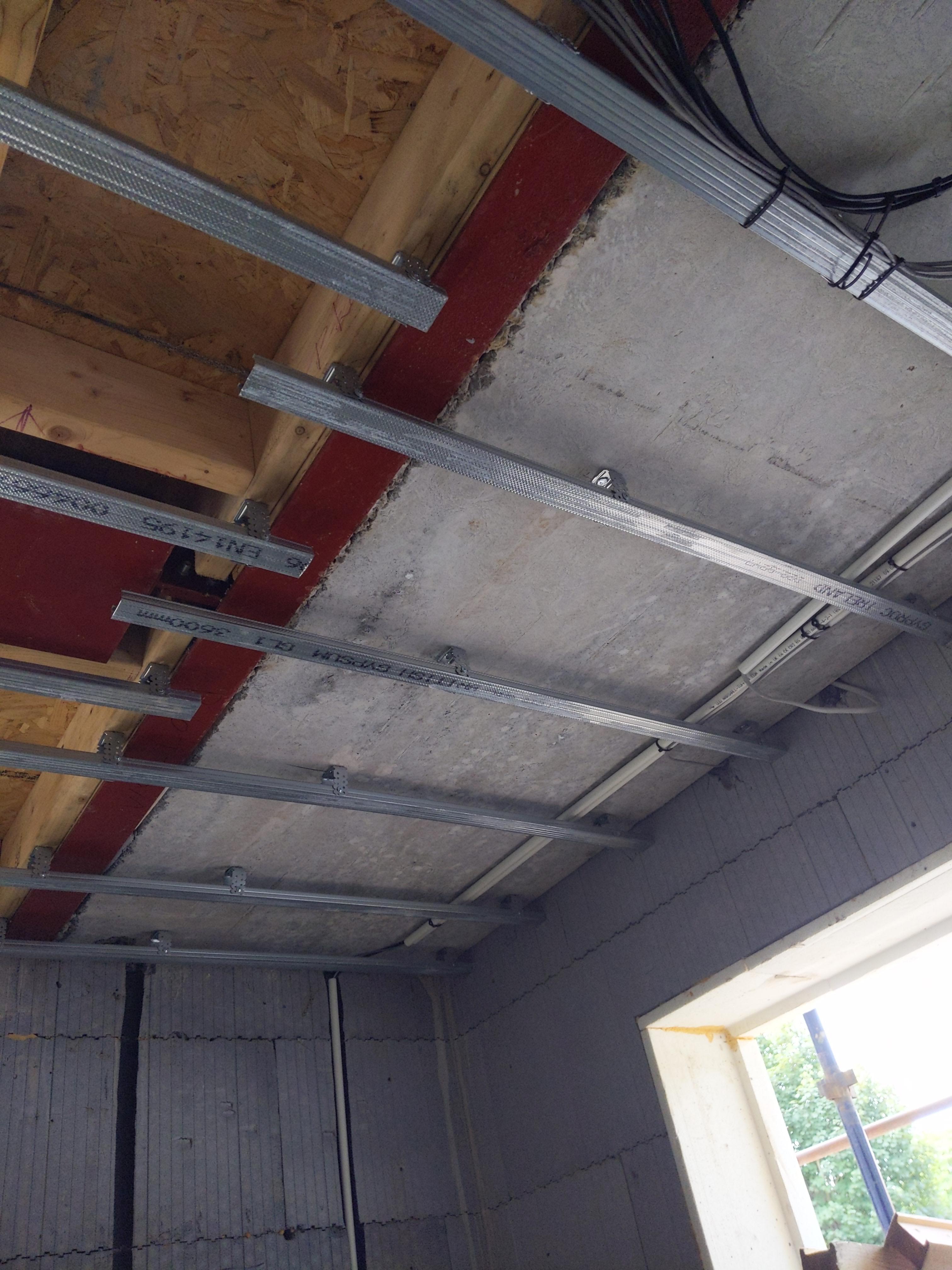

Conor Posted August 31, 2021 Posted August 31, 2021 Why don't you use metal suspended ceilings? I don't see how you could get a flat and straight ceiling with timber. Stick all your services in, then get the metal brackets and edge channels installed at the height required. It's very fast. 1 1
MortarThePoint Posted August 31, 2021 Author Posted August 31, 2021 2 minutes ago, Conor said: Why don't you use metal suspended ceilings? I don't see how you could get a flat and straight ceiling with timber. Stick all your services in, then get the metal brackets and edge channels installed at the height required. It's very fast. Architect included a 150mm MF void, but seems pointless (no ducting). MF needs at least 100mm I think. To get it flat I was planning to pack each mounting as @Mr Punter suggests. To mount the timber to the underside of the HCF I was planning on something like these masonry screws at 400mm c/c.
Conor Posted August 31, 2021 Posted August 31, 2021 (edited) 4 minutes ago, MortarThePoint said: Architect included a 150mm MF void, but seems pointless (no ducting). MF needs at least 100mm I think. To get it flat I was planning to pack each mounting as @Mr Punter suggests. To mount the timber to the underside of the HCF I was planning on something like these masonry screws at 400mm c/c. We're using gypline brackets for a 40mm ceiling. The guys had this room done before I'd finished my morning cup of tea and buildhub browsing. Edited August 31, 2021 by Conor 2 1

MortarThePoint Posted August 31, 2021 Author Posted August 31, 2021 1 hour ago, Conor said: We're using gypline brackets for a 40mm ceiling. The guys had this room done before I'd finished my morning cup of tea and buildhub browsing. Looks great, what system is that? Do you have a link to the brackets?
Conor Posted August 31, 2021 Posted August 31, 2021 1 hour ago, MortarThePoint said: Looks great, what system is that? Do you have a link to the brackets? It's from gyproc. All I know because it was a supply and fit from our MF contractor. Think it was about £12m2.

MortarThePoint Posted August 31, 2021 Author Posted August 31, 2021 6 hours ago, Conor said: It's from gyproc. All I know because it was a supply and fit from our MF contractor. Think it was about £12m2. Sorry you did say that. Found an installation video. The brackets look to be GL2 and the channel is GL1 (sections can be joined by GL3) and a perimeter of GL8 (also used for pattresses). GL1 brackets seem to normally go in at 600mm x 1200mm centres. GL3 joins sections of GL1 as required. In parts (Speed Pro not BG): GL1: 1.67m/m2, £1.14/m, £1.90/m2 https://www.builderdepot.co.uk/metal-lining-channel-3600mm-gl1 GL2: 1.4/m2, 12p each, 16p/m2 https://www.builderdepot.co.uk/195mm-gypframe-gypliner-brackets-gl2-box-of-100 GL3: 0.3/m, 0.5/m2, 12p each, 6p/m2 https://www.builderdepot.co.uk/gypframe-gypliner-channel-connectors-gl3-box-of-50 GL8: £0.83/m https://www.builderdepot.co.uk/metal-track-3000mm-gl8 An arbitrary 4m*4m room would cost 16m2*(£1.90/m2 + £0.16/m2 + £0.06/m2) + 16m*(£0.83/m) = £47.2 or about £3/m2 plus screws. BG may be more expensive as likely a better brand (?). 47x50 timber at 600mm c/c would be £2.75/m2 so GypLyner does compare well with the timber cost. Perhaps not so favourably historically, but based on where timber prices are now... Whilst the timber feels easier to install to a flat level surface, under the hollow core camber the ease of adjusting the metal frame looks very attractive.
PeterW Posted August 31, 2021 Posted August 31, 2021 Speed Pro and Gypliner are the same thing, and at trade price - those builder depot prices are a bit pricy - it’s as cheap as timber but faster to install.
