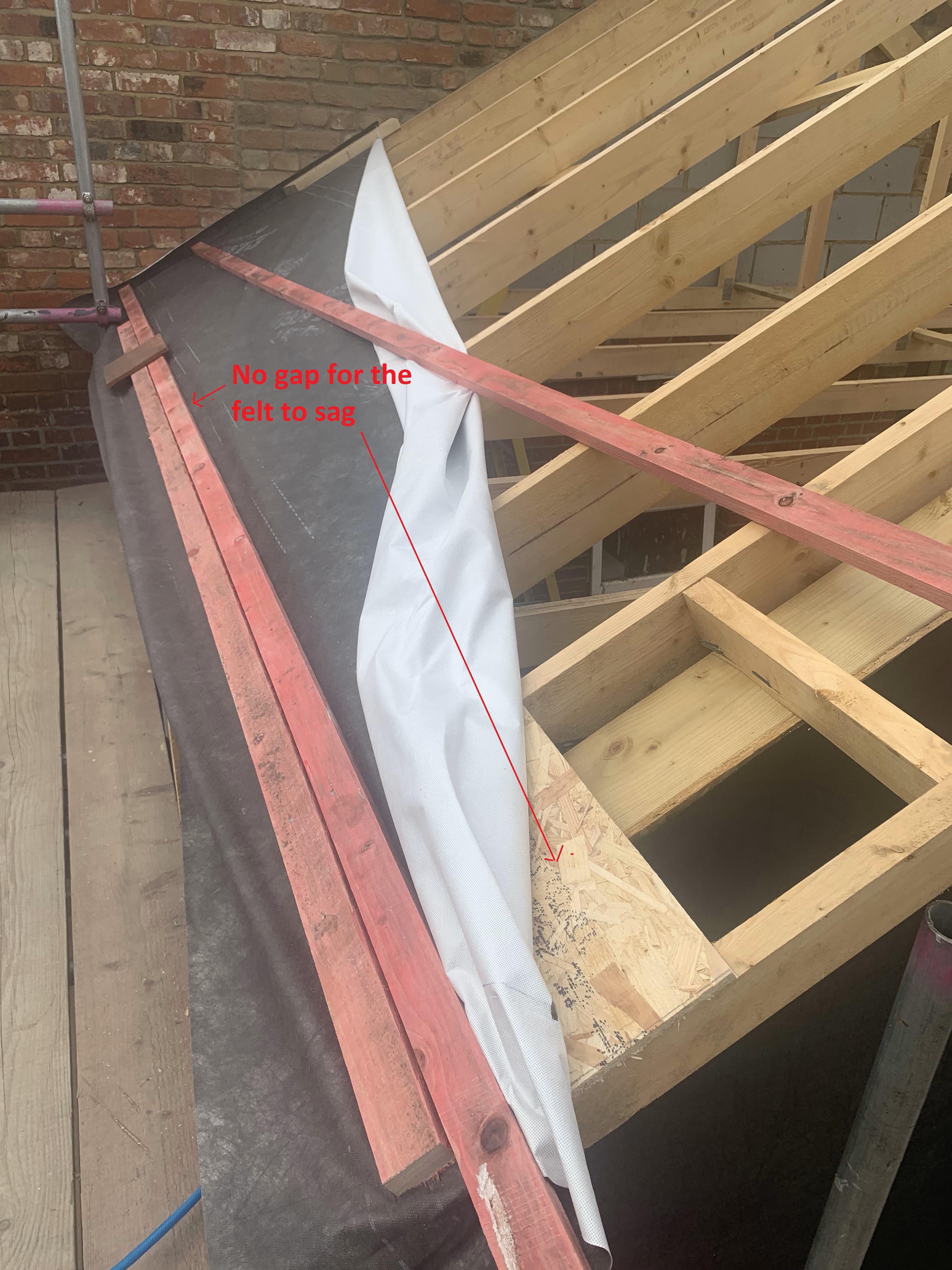

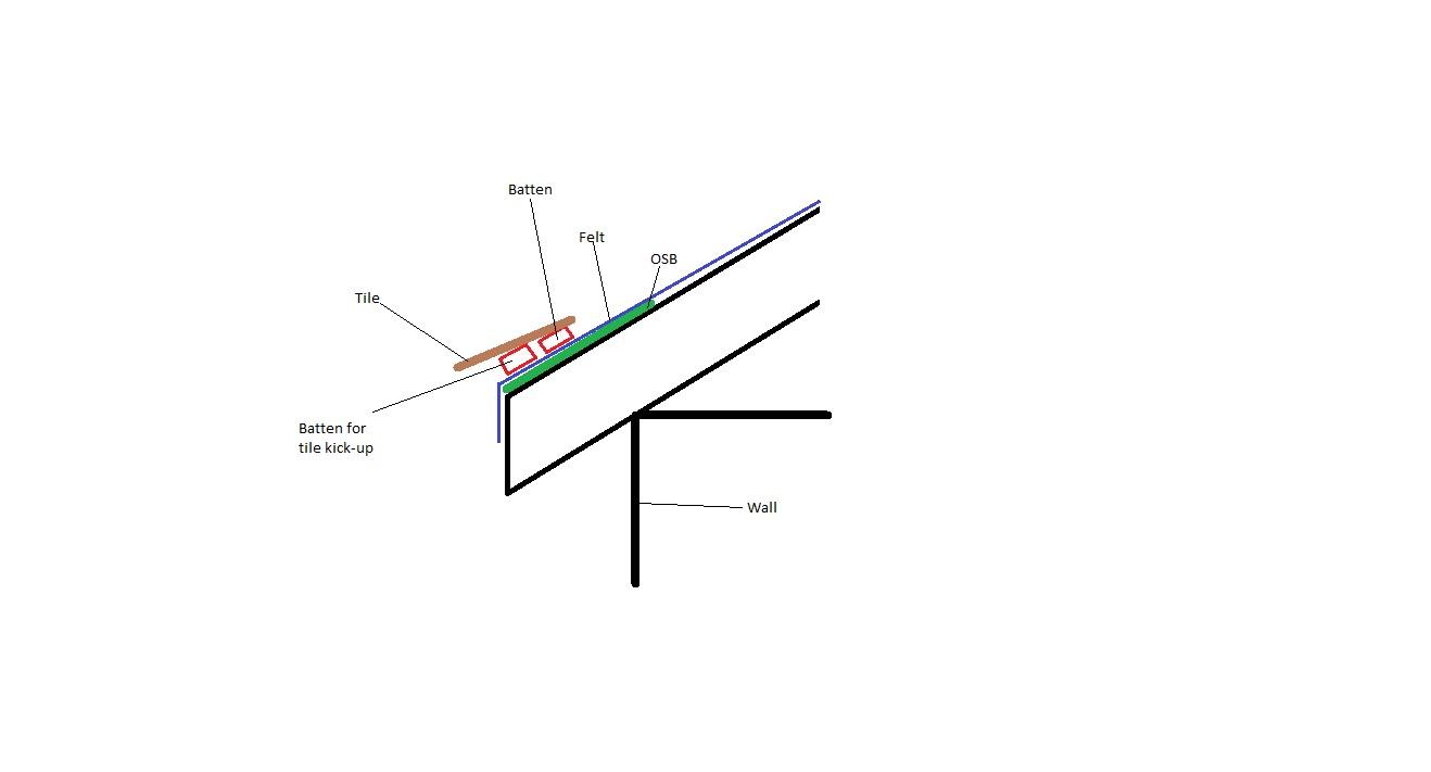

Ben100 Posted August 29, 2021 Share Posted August 29, 2021 (edited) Hi all, I've just started my first roof on my extension and have a few question. The design is like so. 1. Timber frame, with pre-built trusses 2. Exposed rafter tails 3. OSB sheet material over exposed rafter tails to hide the felt/membrane and battens 3. Felt/membrane over OSB with enough overhand to go into the gutter when installed 4. First batten to create a kick-up on the bottom tile 5. Additional battens to fix tiles 6. 20/30 tiles for 30 degree pitched roof How does this design sound? Am I missing anything? One concern I have is with the OSB and felt. The OSB creates a flat surface for the felt to site on, and the battens fix firmly to the OSB and rafters. This means that I do not have any gap between the last 2 battens and the felt. Is this an issue? The other felt and battens have a small gap between them so any water can escape. I'm concerned that water may/will get stuck here and rot the lower battens? Thanks in advance for any advice! Ben Edited August 29, 2021 by Ben100 Link to comment Share on other sites More sharing options...

Ben100 Posted August 29, 2021 Author Share Posted August 29, 2021 18 minutes ago, ProDave said: Sheet the WHOLE roof in OSB, the Scottish way, we call it "sarking" It makes for a so much better roof in so many ways for little extra cost. Could do, but it’s probably a bit overkill for the south of England ? But that does raise a question. How do you allow water to run out under the battens if you fix them to the flat OSB? Link to comment Share on other sites More sharing options...
James Newport Posted August 29, 2021 Share Posted August 29, 2021 Counter battens that follow the line of the rafters, then fix the tile battens to those. Link to comment Share on other sites More sharing options...

Ben100 Posted August 29, 2021 Author Share Posted August 29, 2021 8 minutes ago, James Newport said: Counter battens that follow the line of the rafters, then fix the tile battens to those. Again, counter battening seems a bit overkill for just the bottom two battens. Maybe I can lift the problem battens a few mm using shims or something similar? Link to comment Share on other sites More sharing options...
Onoff Posted August 29, 2021 Share Posted August 29, 2021 Tack some 50x6 ply strips over that bottom OSB up the line of the trusses? If that OSB is just to hide the battens/felt, then cut pieces that sit between the truss ends rather than on them? You'd need a little batten either side flush with the truss tops then screw the infill up to them. Overall though I'd agree, OSB the lot and counterbatten. I'm in the SE too btw. Has other benefits, felt sag allows vermin in. Ask me how I know! ? Link to comment Share on other sites More sharing options...

Ben100 Posted August 31, 2021 Author Share Posted August 31, 2021 19 hours ago, Dave Jones said: at £45 a sheet, hahahahha you could have used the black plastic eaves trays instead of osb, stapled to the truss then membrane over and batten nailed through. Wouldn't you end up with the same issue? The plastic eaves tray would stop the membrane from sagging in between the rafters and allowing any water out. Link to comment Share on other sites More sharing options...
Dave Jones Posted August 31, 2021 Share Posted August 31, 2021 the trays are purely aesthetic so when you look up from underneath you just see black rather than membrane. You can use osb and paint it black if you have money to burn. Link to comment Share on other sites More sharing options...
Onoff Posted August 31, 2021 Share Posted August 31, 2021 I'm all for reinventing the wheel believe me but I did wonder why you didn't go for plastic eaves trays in the first place. If you read the instructions on some of the modern, breathable felts it specifically says about fitting 1/4" thick or so strips along the line of the trusses so the subsequent battens sit up off the felt and allow free drainage. 1 Link to comment Share on other sites More sharing options...
scottishjohn Posted September 1, 2021 Share Posted September 1, 2021 13 hours ago, Onoff said: I'm all for reinventing the wheel believe me but I did wonder why you didn't go for plastic eaves trays in the first place. If you read the instructions on some of the modern, breathable felts it specifically says about fitting 1/4" thick or so strips along the line of the trusses so the subsequent battens sit up off the felt and allow free drainage. single batons will always cause a gather up of dust and bugs over time which is then a condensation dam it then holds damp and causes rot I would always for sarking it will always be stronger +stiffer in wind loads and make it easy to work on the roof while tiling or slating it Link to comment Share on other sites More sharing options...
Ben100 Posted September 5, 2021 Author Share Posted September 5, 2021 On 31/08/2021 at 18:37, Onoff said: I'm all for reinventing the wheel believe me but I did wonder why you didn't go for plastic eaves trays in the first place. If you read the instructions on some of the modern, breathable felts it specifically says about fitting 1/4" thick or so strips along the line of the trusses so the subsequent battens sit up off the felt and allow free drainage. Yeah, after thinking it through a bit more I ended up installing an plastic eaves tray. 1 Link to comment Share on other sites More sharing options...
