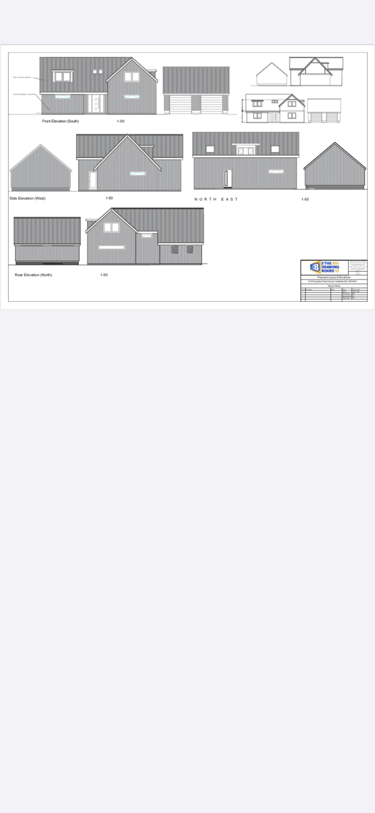

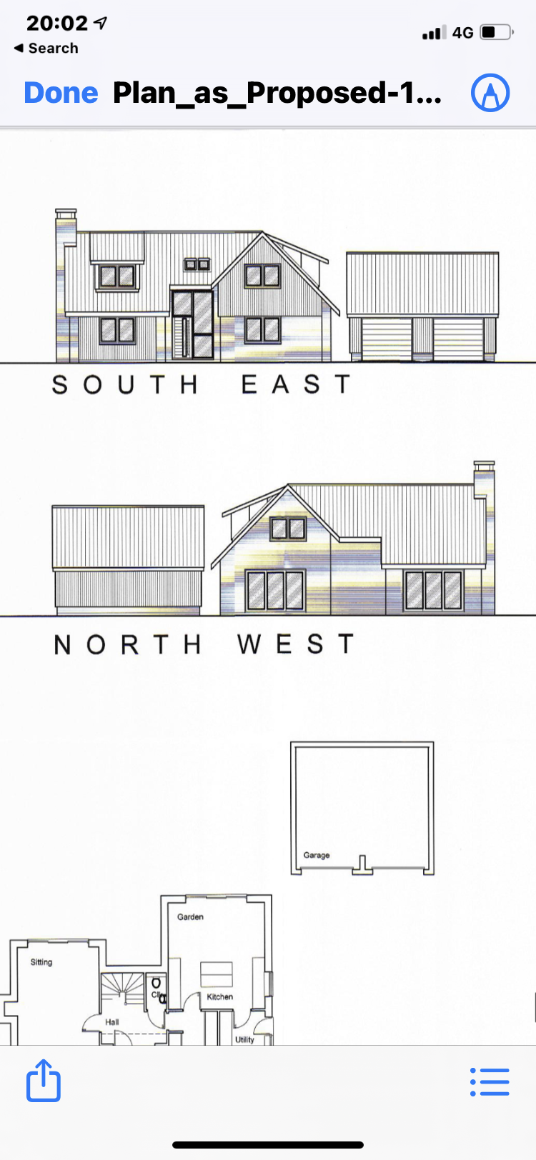

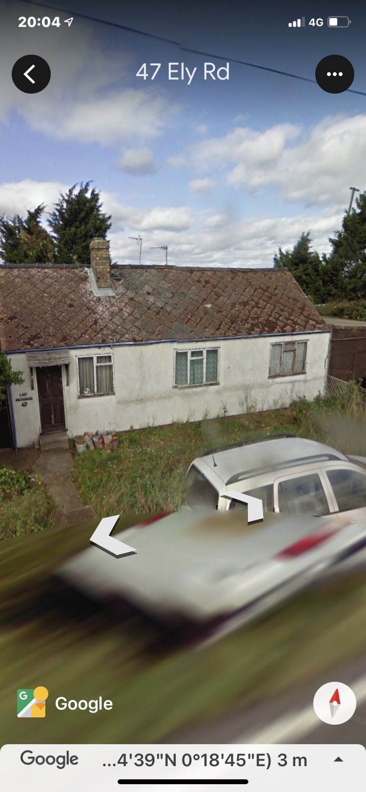

DragsterDriver Posted August 24, 2021 Share Posted August 24, 2021 (edited) Soooo... I have a plot with planning permission for a replacement dwelling. It’s a crap plot, flood zone 3 and railway on the boundary but budget dictates etc. here are the approved elevations: Looks classic ‘farmer house’ to me. Not pretty. i wanted something more modern, letterbox type windows etc: sadly today I received : Edited August 24, 2021 by DragsterDriver Bungling pics Link to comment Share on other sites More sharing options...

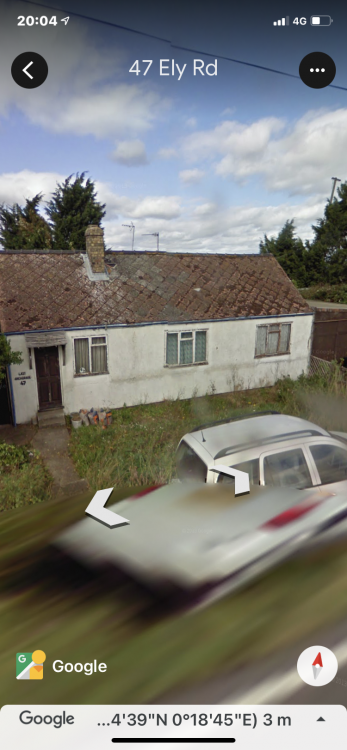

DragsterDriver Posted August 24, 2021 Author Share Posted August 24, 2021 (edited) This is the neighbouring house: these are on the same road Edited August 24, 2021 by DragsterDriver 1 Link to comment Share on other sites More sharing options...

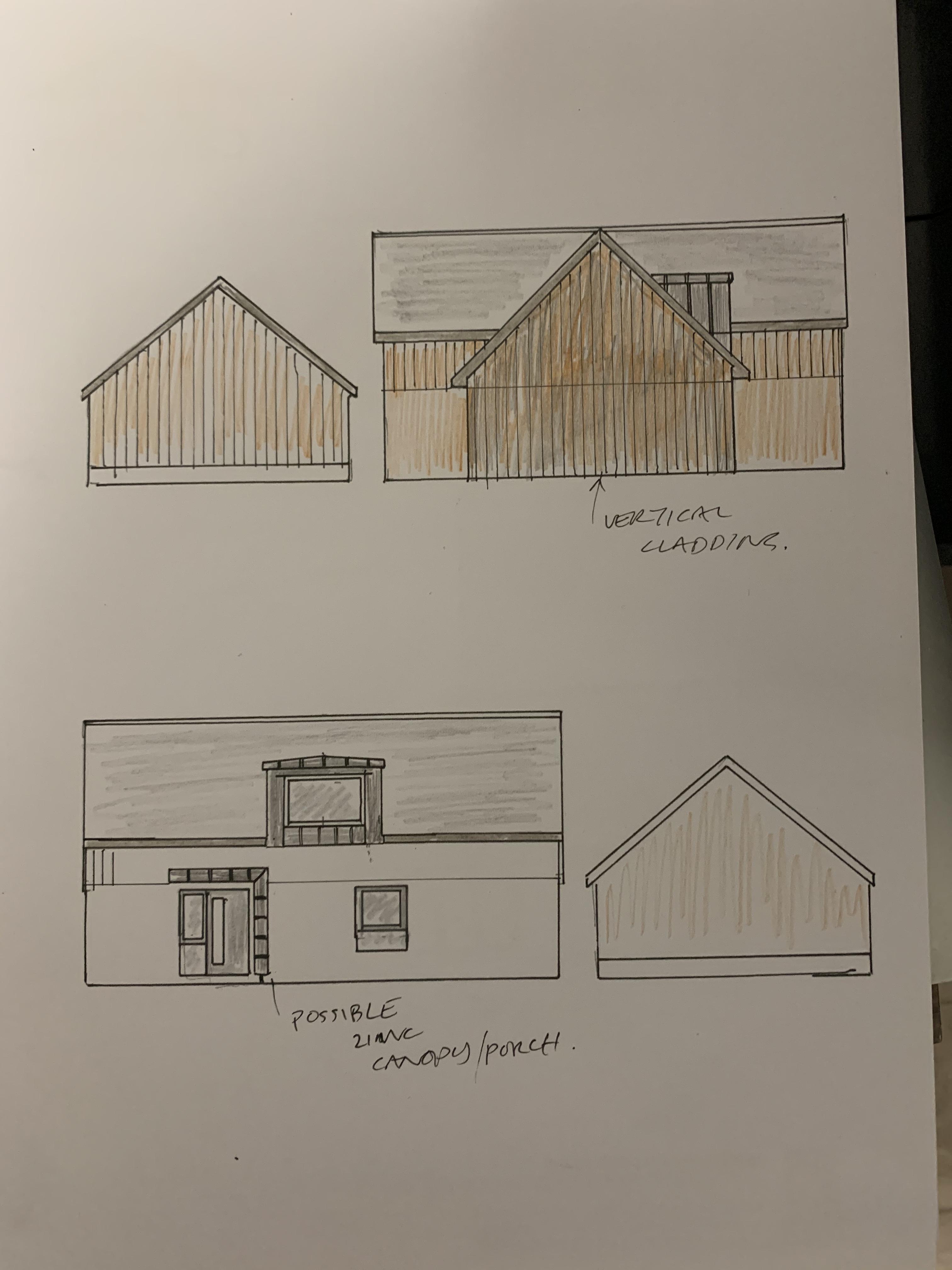

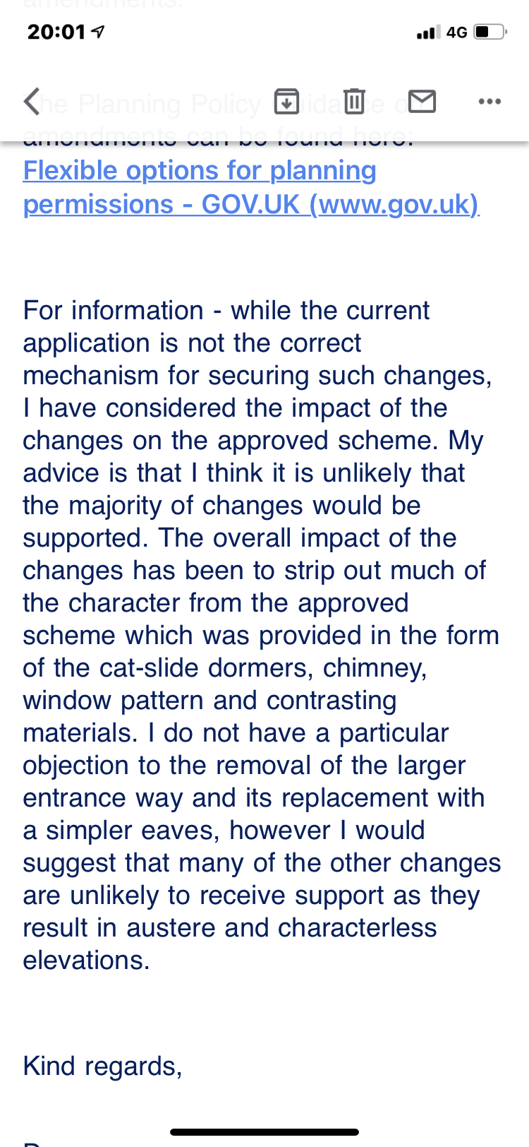

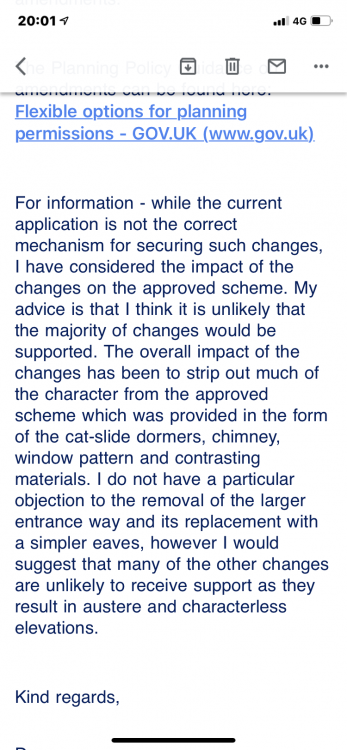

DragsterDriver Posted August 24, 2021 Author Share Posted August 24, 2021 (edited) From the planners reply it feels like they’re proper against changes, it did go to committee originally. “austere and characterless elevations.” Edited August 24, 2021 by DragsterDriver 1 Link to comment Share on other sites More sharing options...
AliG Posted August 24, 2021 Share Posted August 24, 2021 I don't like planners being so specific about design generally, especially looking at the other houses in the street. But, I don't understand what you are thinking with the redesign and planners do have some responsibility to try and achieve good design. Are you really proposing those tiny little windows, it would be awful and dark inside. BC may also have an issue with the lack of light and ventilation and it would impact the SAP score. 2 Link to comment Share on other sites More sharing options...
DragsterDriver Posted August 24, 2021 Author Share Posted August 24, 2021 It will have mvhr, one of the issues is it’s hemmed either side by an elevated rail line and elevated road, so the high level windows afford some privacy I can live with that but the cat slides and chimney... Link to comment Share on other sites More sharing options...

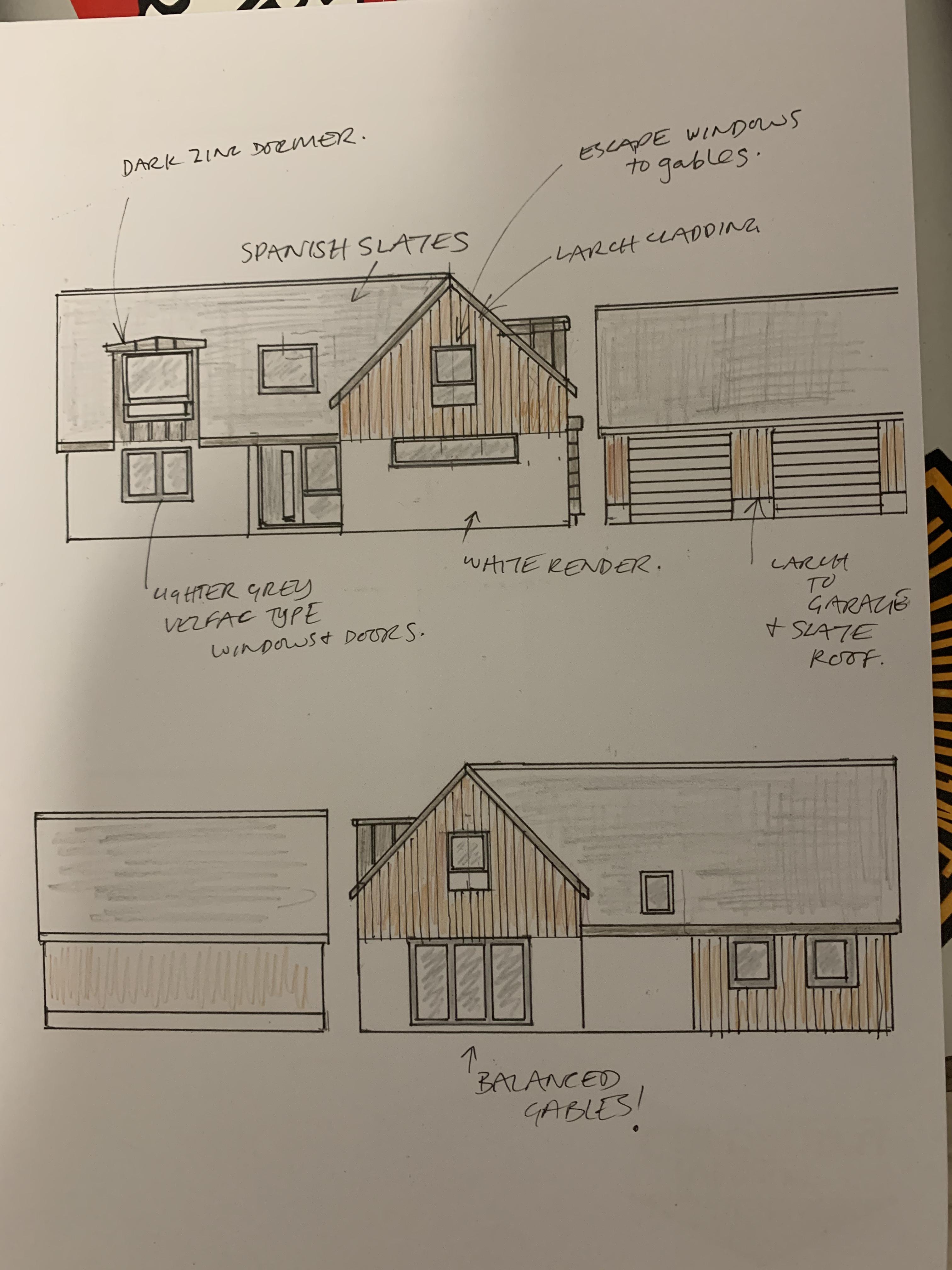

DragsterDriver Posted August 24, 2021 Author Share Posted August 24, 2021 I really wanted this type of dormer and at least a letterbox window to the kitchen. and try to balance the shape of the house a bit. Link to comment Share on other sites More sharing options...
AliG Posted August 24, 2021 Share Posted August 24, 2021 OK, now we're getting somewhere. Change the windows to a normal size. You'll regret living in a house with no natural light. This will help to fix the "austere and characterless elevations" For the chimney you have a strong argument that the government wants to ban stoves/fires etc and so houses shouldn't have chimneys. They also harm airtightness. I have two which are totally fake! Unless catslides are a feature of the area he doesn't have much of an argument. Why not change to the one you are suggesting, I think he maybe just wants it to have character not a specific design. Then maybe look to varying the outer finish in a modern way such as a mix of render and wood, something that you like that provides some variation. I suspect the windows and the creation of the large expanses of wall are the main problem. The planner will also like if you show willing. 2 1 Link to comment Share on other sites More sharing options...
DragsterDriver Posted August 24, 2021 Author Share Posted August 24, 2021 20 minutes ago, AliG said: OK, now we're getting somewhere. Change the windows to a normal size. You'll regret living in a house with no natural light. This will help to fix the "austere and characterless elevations" For the chimney you have a strong argument that the government wants to ban stoves/fires etc and so houses shouldn't have chimneys. They also harm airtightness. I have two which are totally fake! Unless catslides are a feature of the area he doesn't have much of an argument. Why not change to the one you are suggesting, I think he maybe just wants it to have character not a specific design. Then maybe look to varying the outer finish in a modern way such as a mix of render and wood, something that you like that provides some variation. I suspect the windows and the creation of the large expanses of wall are the main problem. The planner will also like if you show willing. Thanks! I have to say the latest plans do look a bit...meh. I can sympathise with the planner. He seems pretty waspy- I wonder if he’d entertain me emailing him some sketches and photos before redrawing? That’s what does me in- there’s no dialogue. Link to comment Share on other sites More sharing options...

shuff27 Posted August 25, 2021 Share Posted August 25, 2021 I inherited approved plans which included 2 chimneys, apparently they're a staple of the local design guide & the PO insisted on them. After buying the plot I gained approval to remove them after submiting a variation of condition application. My argument was chimneys on a new build are "anachronistic, unnecessary & contrary to the principles of sustainable design & construction." Feel free to use my wording - I made the last bit up so unsure if it's actually true but I think it sounds good! 3 Link to comment Share on other sites More sharing options...

Temp Posted August 25, 2021 Share Posted August 25, 2021 Personally I prefer the original design (if not the catslide). Think the new one is going to be dark inside with all those small letterbox windows. 1 Link to comment Share on other sites More sharing options...
DragsterDriver Posted August 25, 2021 Author Share Posted August 25, 2021 1 hour ago, Temp said: Personally I prefer the original design (if not the catslide). Think the new one is going to be dark inside with all those small letterbox windows. same! I’m going to redraw it tonight minus the chimney and catslides. I did email the planning officer back and left a voicemail- I’d just like a steer on anything else to please him but won’t hold my breath. catslides are the red line really- I’ve built a pair today and I hate them with a passion. Link to comment Share on other sites More sharing options...
Mr Punter Posted August 25, 2021 Share Posted August 25, 2021 So, your proposed entrance is considered an improvement. Keep that in but revert to the approved windows elsewhere. You could try pitched or curved roof dormers if the catslide is not your thing. Perhaps post up what you propose before you sent it to the planning officer as this could be your last chance to get this through. Personally I think the officer did you a favour and you dodged a bullet there. 1 Link to comment Share on other sites More sharing options...
DragsterDriver Posted August 25, 2021 Author Share Posted August 25, 2021 4 minutes ago, Mr Punter said: So, your proposed entrance is considered an improvement. Keep that in but revert to the approved windows elsewhere. You could try pitched or curved roof dormers if the catslide is not your thing. Perhaps post up what you propose before you sent it to the planning officer as this could be your last chance to get this through. Personally I think the officer did you a favour and you dodged a bullet there. On reflection I did see their point- I know how it would look but the plans are very bland. I’ll deffo post it up for comment Link to comment Share on other sites More sharing options...
the_r_sole Posted August 25, 2021 Share Posted August 25, 2021 I usually have to talk clients out of too much glass... The approved elevations are miles better than the revised ones, although there might be other poor houses around that should be the bar - but the approved elevations are definitely hurting your application because there's more detail in them. 1 Link to comment Share on other sites More sharing options...

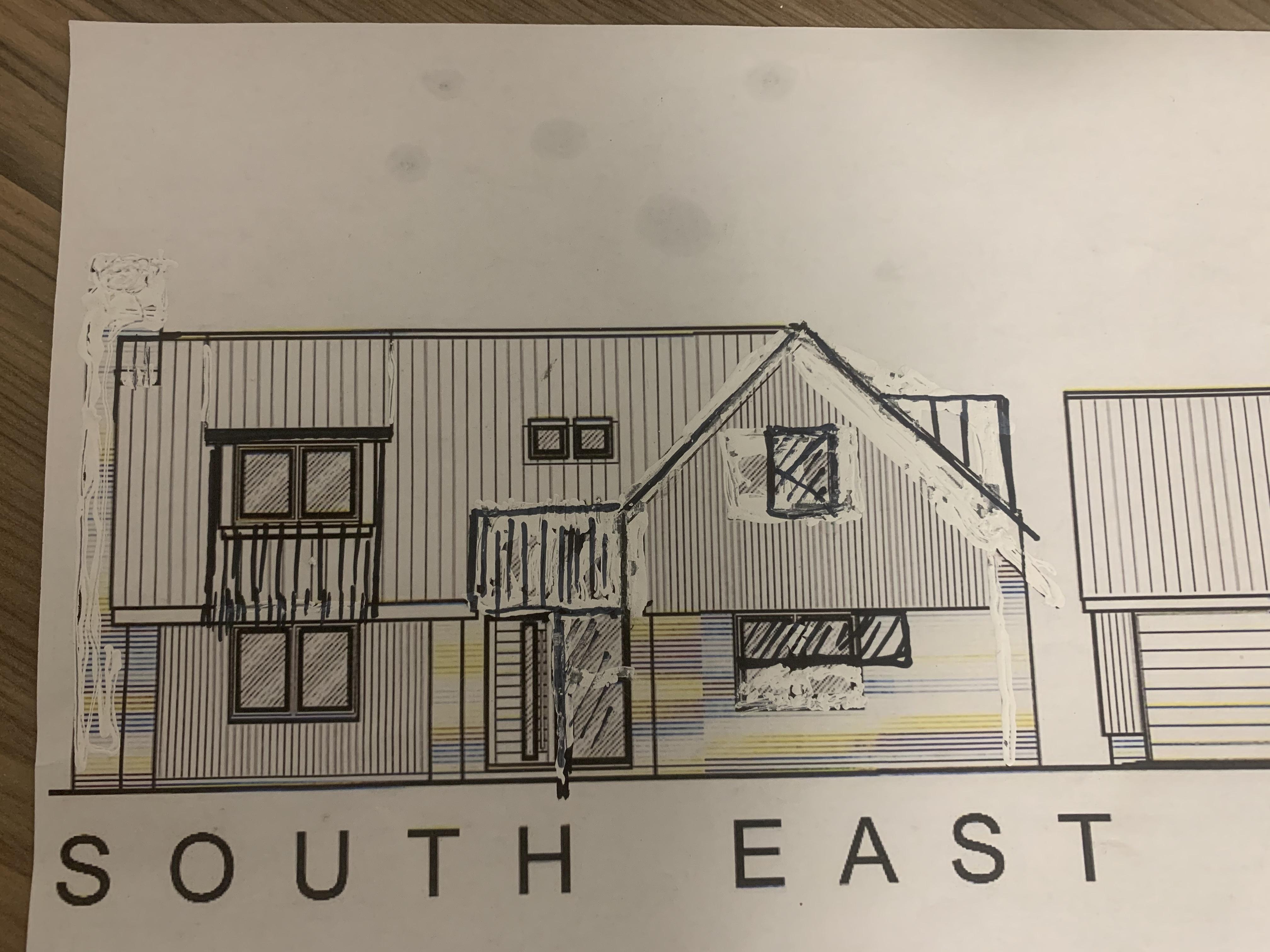

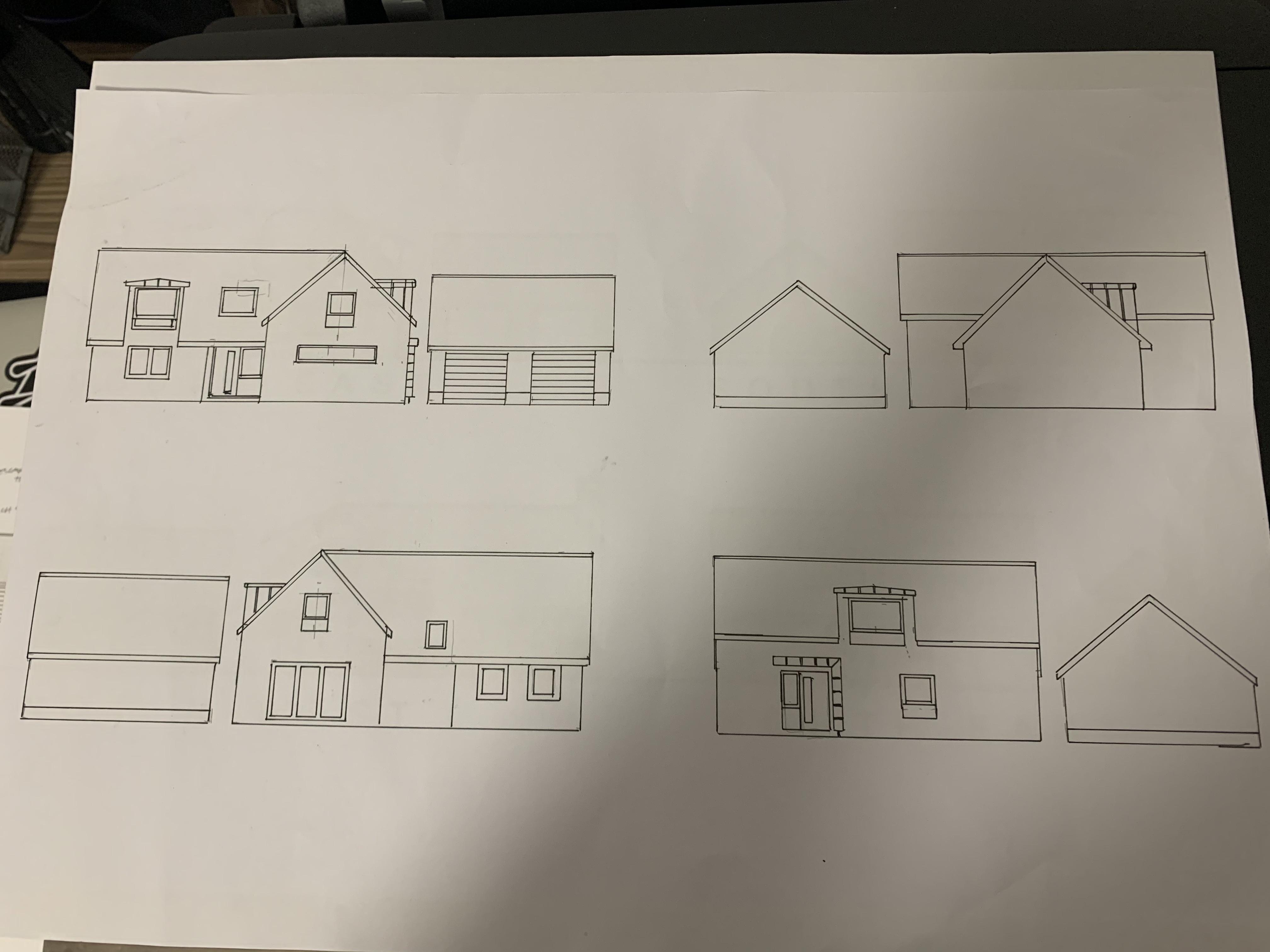

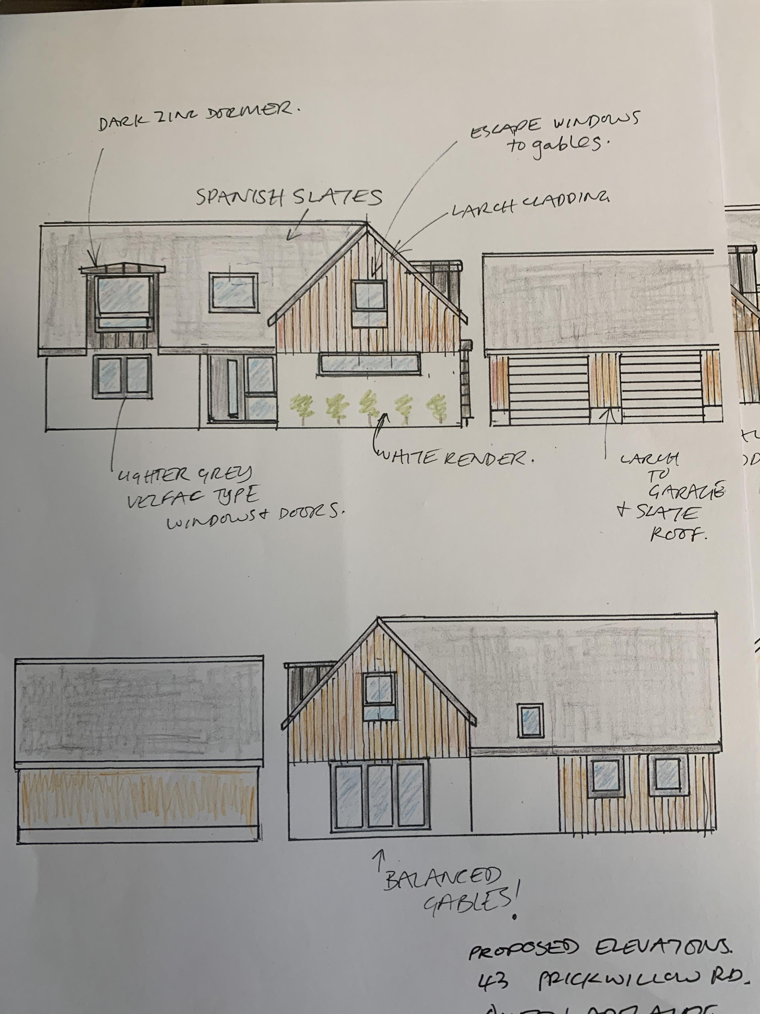

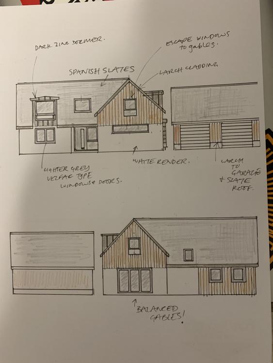

DragsterDriver Posted August 25, 2021 Author Share Posted August 25, 2021 So, good evening! I’ve borrowed some drawing pens and done some bits and I’m ready for critique ? not sure about the canopy/porch thing but it looks ‘warmer’ than the architect version?! 2 Link to comment Share on other sites More sharing options...

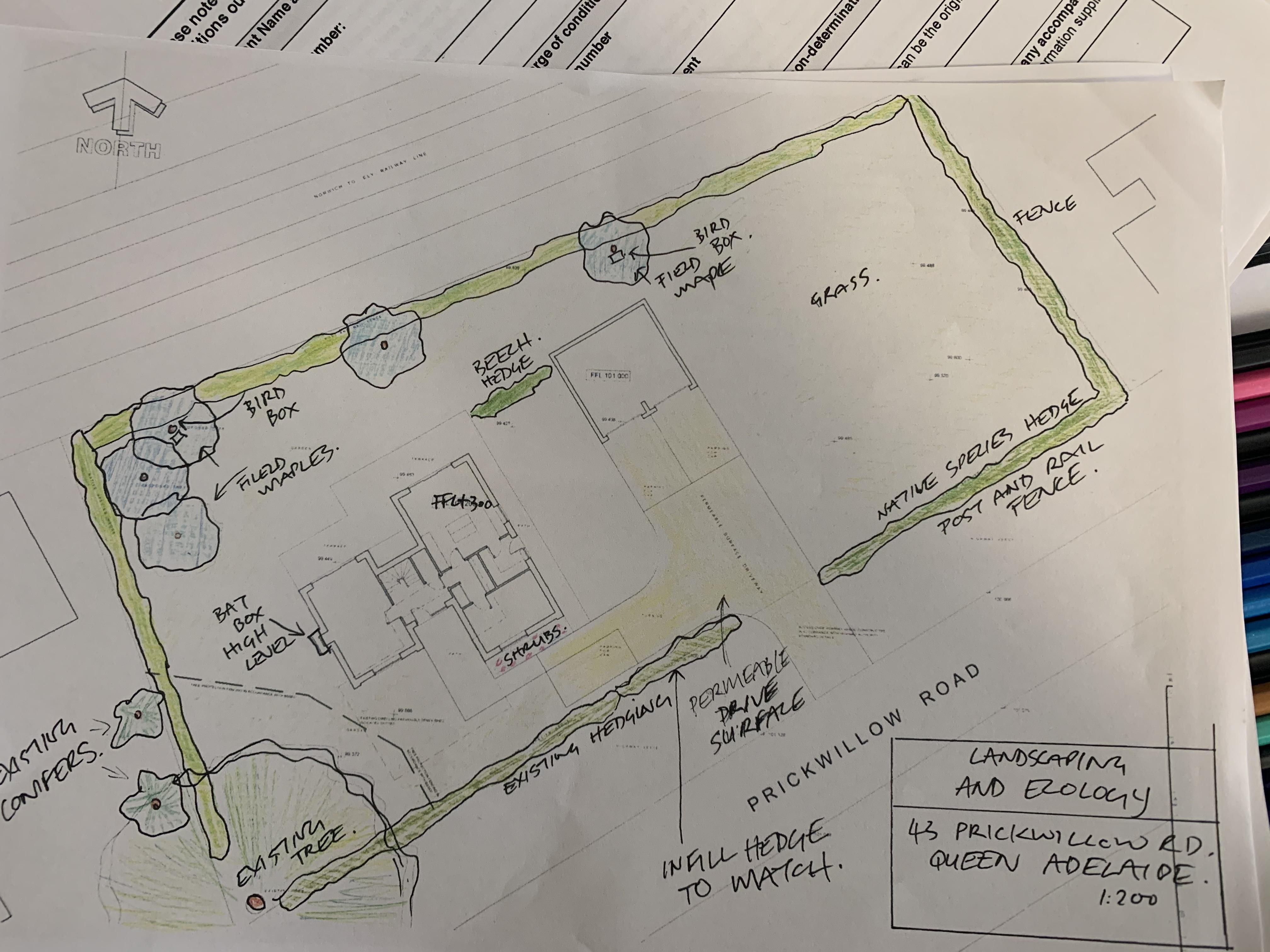

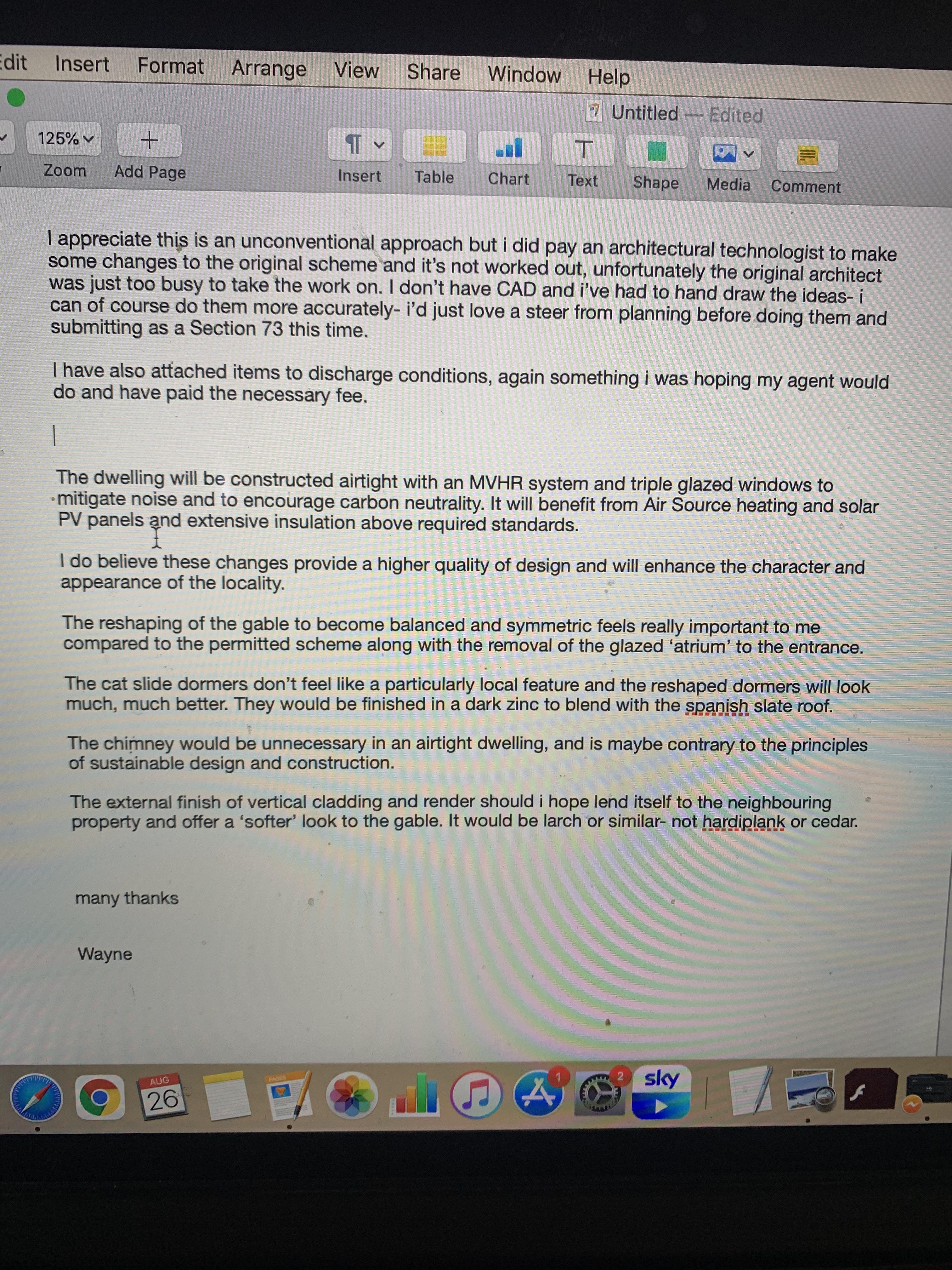

DragsterDriver Posted August 26, 2021 Author Share Posted August 26, 2021 Well that’s it, I’ve done my best. planning won’t answer calls or emails so I’ll send the missus over with these in an envelope to see if I’ll get any comment. also the conditions to be discharged, really glad I paid an ‘architect’ and still done it myself. and the ecology/planting- he’s another one. Link to comment Share on other sites More sharing options...
DragsterDriver Posted August 26, 2021 Author Share Posted August 26, 2021 17 hours ago, Mr Punter said: So, your proposed entrance is considered an improvement. Keep that in but revert to the approved windows elsewhere. You could try pitched or curved roof dormers if the catslide is not your thing. Perhaps post up what you propose before you sent it to the planning officer as this could be your last chance to get this through. Personally I think the officer did you a favour and you dodged a bullet there. hope ive not cocked it up. Link to comment Share on other sites More sharing options...

Mr Punter Posted August 26, 2021 Share Posted August 26, 2021 5 minutes ago, DragsterDriver said: Blown away by the feedback ? Don't get all needy on us! I am not good at elevations but with the SE one I prefer the windows in the approved scheme so stick with those. The slot window looks incongruous. The NW elevation looks OK. Timber cladding I can take or leave and it can often look tatty after a few years and weather differently depending on the elevation. With the covering letter, just say what you have done to address their comments: Entrance door and simplified eaves, contrasting materials and better resolved windows. They are not interested in the eco credentials unless it is policy for you to achieve some set level, in which case you would include visible stuff like PV and external ASHP on your plans. They can see enough from the elevations and plans and will in any case likely condition things like materials. One more iteration may be sensible (unless you have already sent it!). 1 Link to comment Share on other sites More sharing options...

DragsterDriver Posted August 26, 2021 Author Share Posted August 26, 2021 11 minutes ago, Mr Punter said: Don't get all needy on us! I am not good at elevations but with the SE one I prefer the windows in the approved scheme so stick with those. The slot window looks incongruous. The NW elevation looks OK. Timber cladding I can take or leave and it can often look tatty after a few years and weather differently depending on the elevation. With the covering letter, just say what you have done to address their comments: Entrance door and simplified eaves, contrasting materials and better resolved windows. They are not interested in the eco credentials unless it is policy for you to achieve some set level, in which case you would include visible stuff like PV and external ASHP on your plans. They can see enough from the elevations and plans and will in any case likely condition things like materials. One more iteration may be sensible (unless you have already sent it!). I’m a man on the edge! ? honestly thought paying somebody would make all this paperwork go away, wrong again! recieved a reply planner isn’t against t changes, but really wants his chimney and brick areas- do I really want to be sticking brick slips on a timber frame?... Link to comment Share on other sites More sharing options...
