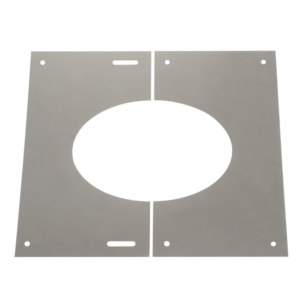

AliG Posted August 27, 2021 Share Posted August 27, 2021 You can get a flue collar that goes around the flue without removing it, something like this. I would fill the hole with rockwool for insulation and tape around the collar with heat resistant aluminium tape for air tightness. According to Google you can also just fill the hole with fire rated expanding foam, but this feels like a bit of a bodge. https://www.glowing-embers.co.uk/ChimneyAndFlues/TwinWallInsulatedFlueSystems/ShieldmasterTwinWallFluePipe/8200mmShieldmasterTwinWallFluePipe/8200mm30-45degFinishingPlate-ForTwinWallFluePipe Link to comment Share on other sites More sharing options...
