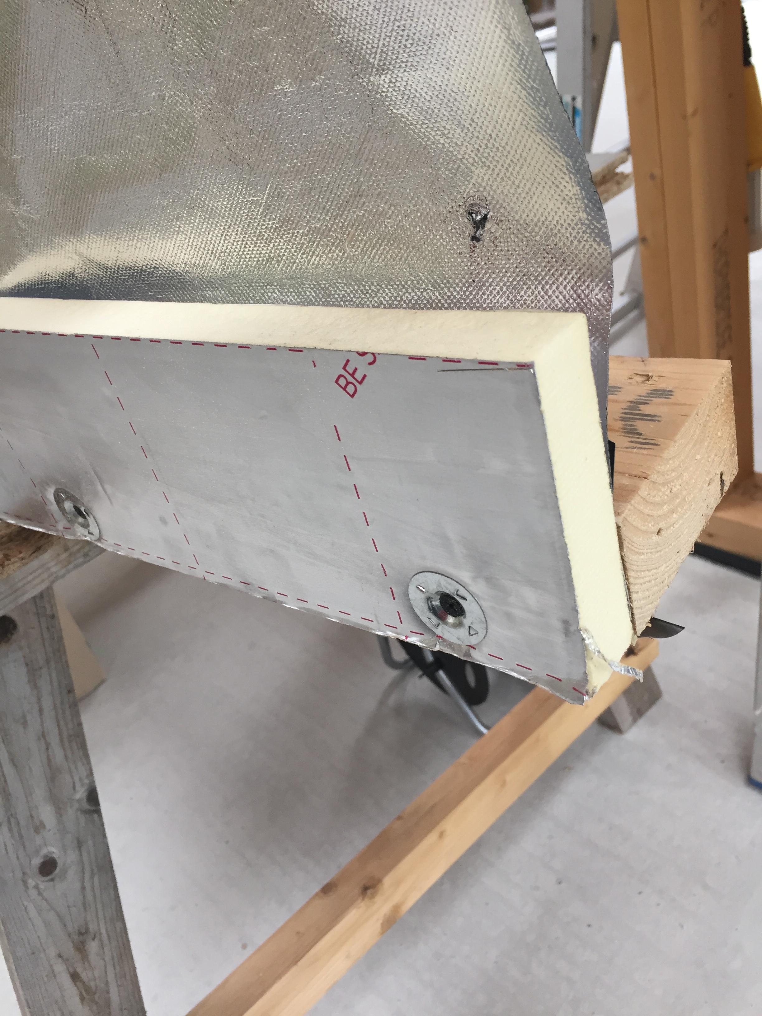

Longjock Posted August 21, 2021 Share Posted August 21, 2021 Hi All, Just planning on the fixings for the service cavity battens and was wondering what is best for minimising the leakage in the vcl? Ours is a SIPS with 1200 wide panels. Do I still place the battens at 600 centres or just where the panels meet (where the timber joints are)? Also I am putting a 85mm high perimeter strip of pir around the sole plate and was wondering what fixing to use again worrying about penetrating the vcl. All suggestions welcome! Link to comment Share on other sites More sharing options...

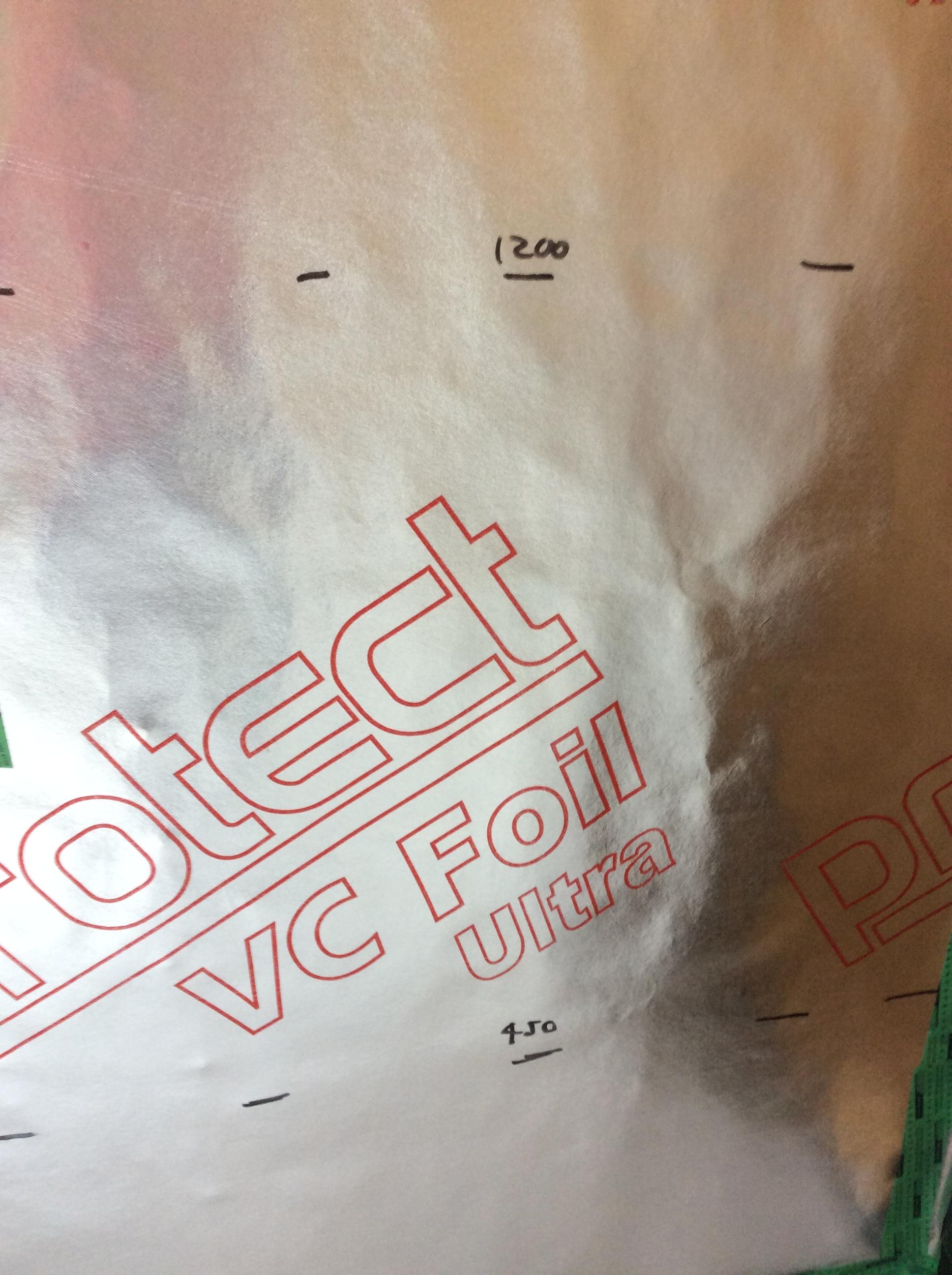

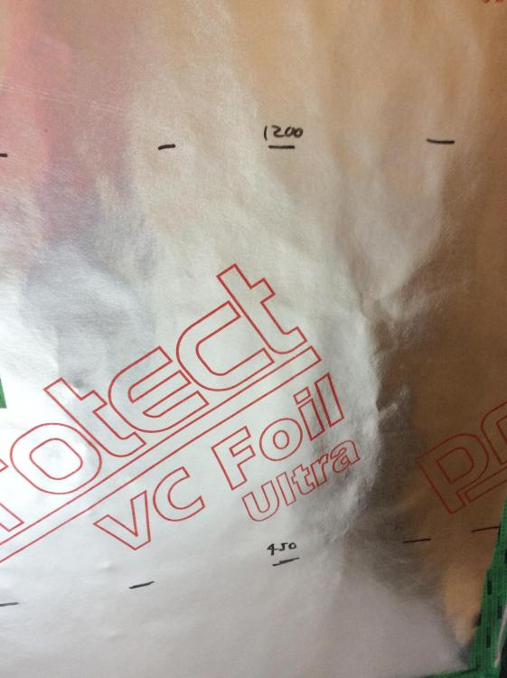

ProDave Posted August 21, 2021 Share Posted August 21, 2021 TOP TIP: Leave a small gap in your service battens at 450mm and 1200mm above floor level. Your electrician will thank you as it allows him to run socket and light cables horizontally in a safe zone without drilling the battens (and risking damaging the VCL) In a kitchen for kitchen sockets 1100mm is about right. Your electrician will thank you. 1 1 Link to comment Share on other sites More sharing options...

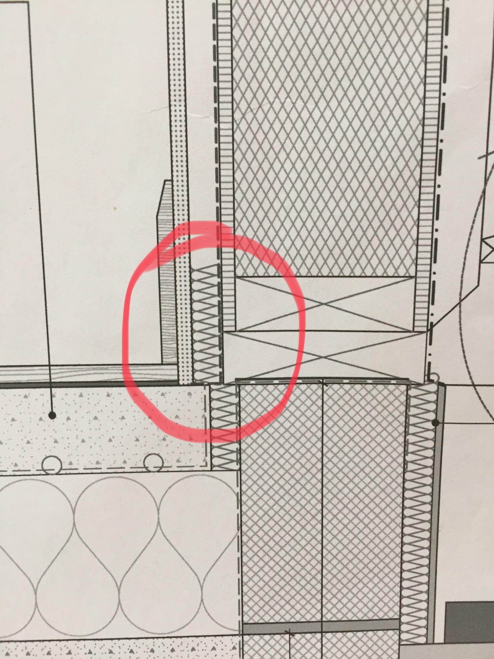

Longjock Posted August 21, 2021 Author Share Posted August 21, 2021 (edited) Pir will be on the inside. Already has rendered insulation on the outside block plinth covering the outside face of the sole plate. Drawings show another 25mm on the inside face. Floor is already screeded up to the bottom edge of the sole plate. The strip I’m planning to instal will sit on top of this but below a horizontal batten. Edited August 21, 2021 by Longjock Link to comment Share on other sites More sharing options...

Longjock Posted August 21, 2021 Author Share Posted August 21, 2021 Already prepped for that ? ProDave having read your advice on other posts. I’m using a mixture of 25 and 50mm battens where appropriate Link to comment Share on other sites More sharing options...
Longjock Posted August 21, 2021 Author Share Posted August 21, 2021 (edited) This is the detail showing the internal 25mm pir upstand. As it’s separate from the one in the screed (and internal of the vcl) I was thinking of screwing it to the sole plate but using insulation washers to help with getting the contact face tighter. As in the mock-up in the other pic Edited August 21, 2021 by Longjock Extra pic Link to comment Share on other sites More sharing options...
