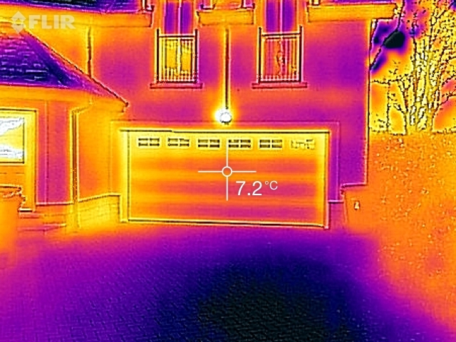

AliG Posted March 26, 2017 Share Posted March 26, 2017 I got an infra red camera for the iPhone a few weeks ago. Tried it out on my garage door this morning. The garage isn't heated but gets heat from the room above. Looks like the thing to avoid is windows in the door! Link to comment Share on other sites More sharing options...

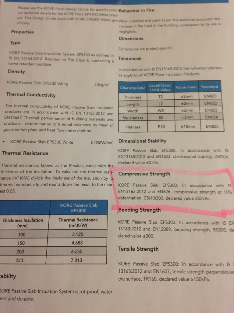

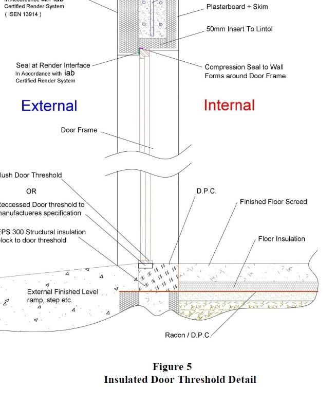

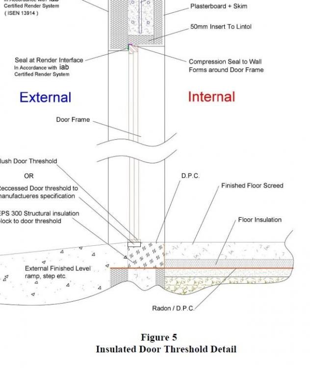

magnethead Posted May 21, 2019 Share Posted May 21, 2019 I'm pouring the rising walls this Friday thought it was about time to look into some threshold details, Does anyone have an issue with 'Structural EPS' ..Might be a similar block to what the Op mentioned. I hear passive slabs are made of this stuff, but calling EPS structural sounds weird to me, The spec gave 10% deformation at 302kPa which seems fairly good. Here's a detail for an insulated Door, I'm looking at mounting an insulated sectional door for the Integrated garage/workshop (Like above)....Would a detail like this be acceptable across a garage opening? Maybe pushing the block forward, so the Door lip can sit into a 1/2" channel (recommended by the door installer to handle water being blown in) Link to comment Share on other sites More sharing options...
Simplysimon Posted May 21, 2019 Share Posted May 21, 2019 going back to your idea of marmox, it's a 7kn building material, i would imagine it should be durable enough as a threshold as the surface is quite tough. Link to comment Share on other sites More sharing options...
magnethead Posted May 22, 2019 Share Posted May 22, 2019 I was looking at this material from Kore, it's coming in at 302kPa which is the same as 302Kn/m2 .... They build houses on top of this stuff, so it might just hold at the threshold, I'm still thinking of a slightly different approach, with a flagstone coming up to the garage door (I'll try and draw it up) Here's the spec sheet for that material Link to comment Share on other sites More sharing options...
AliG Posted May 22, 2019 Share Posted May 22, 2019 Although structural EPS can take a dead load I would be concerned that it would scrub away over time at the threshold, maybe you could put a hard cap on it, or use a narrower strip of PIR inside the door to create a break. Even an insulated garage door is pretty appalling versus a proper window or door. There will be so many cold bridges that I wouldn't worry about the threshold. Directly above this will be a thick rubber seal that provides virtually no insulation. I am not sure about a channel, wouldn't it just fill up with water. The key things to stop water being blown in are to have a flat surface for the door seal to press against. In my last house it was bumpy and water would come in at the low points and to have a run off on the threshold at the outside so that water running down the garage door runs away from the garage. My current house is constructed like this and we have no issues with water ingress. Link to comment Share on other sites More sharing options...

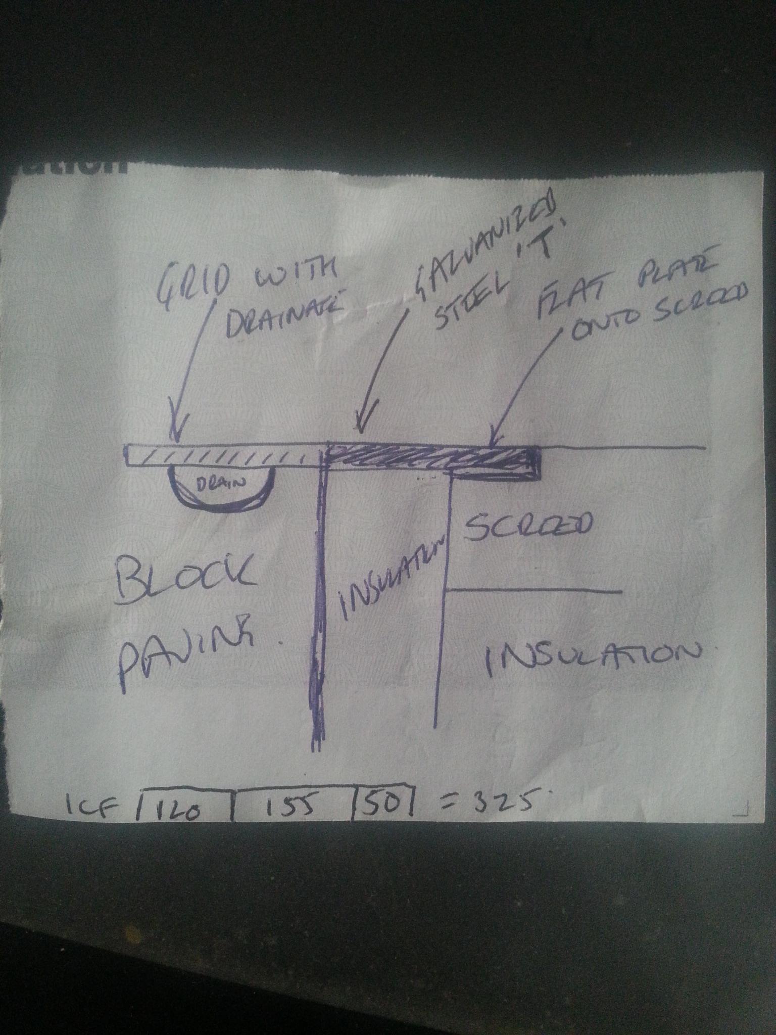

Vijay Posted May 22, 2019 Author Share Posted May 22, 2019 On 23/03/2017 at 22:02, Vijay said: I've got an idea for thermal break leading on from Nicks suggestion. I'll try and do a sketch tomorrow and post it on here for opinions. A quick sketch of the idea I had from what Nick said. I thought of installing a painted/galvanised steel "T" into the ICF core. On the garage side, I have insulation to give the break between the outside and the screed. On the outside part, I have slots cut into the horizontal face which would allow drainage. The garage door comes down onto the middle of the horizontal face of the "T", so I can get a nice flat face for the the door seal to go on. Good or bad idea?? Link to comment Share on other sites More sharing options...

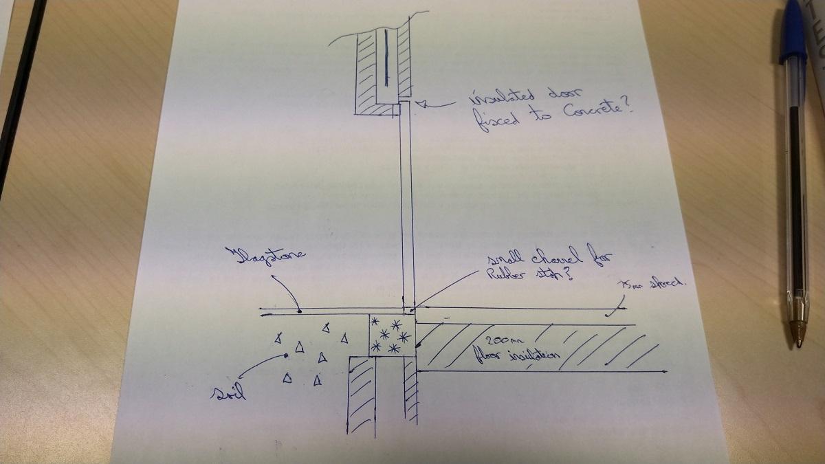

magnethead Posted May 22, 2019 Share Posted May 22, 2019 I was thinking the Cold bridge from the Garage skreed would be the worst, I'm loosing heat around the edges obviously...The insulated door company recommended leaving a small channel, 1/2 deep by 1 1/2 inch wide, just to catch any water that might be blown under it....Here's what i'm thinking...Can you see any problems The area with the stars is the structural EPS. Link to comment Share on other sites More sharing options...
magnethead Posted May 22, 2019 Share Posted May 22, 2019 How long do you reckon the galvanized steel would last @Vijay Link to comment Share on other sites More sharing options...
Russell griffiths Posted May 22, 2019 Share Posted May 22, 2019 A fibreglass angle would last forever and would be less of a cold spot. Link to comment Share on other sites More sharing options...
Ed Davies Posted May 22, 2019 Share Posted May 22, 2019 Stainless steel is also a lot less conductive [¹] that ordinary. [¹] Thermally and, by the way, electrically. Link to comment Share on other sites More sharing options...
Vijay Posted May 22, 2019 Author Share Posted May 22, 2019 Magnethead, when I read leaving a small channel, my first thought was it would be somewhere for crap to sit and then not let the rubber seal work properly? No idea how long galvanised would last, thought it was pretty tough?? I'd imagine it would cost a fair bit so I'd be happy for another solution @Russell griffiths do you mean a fibreglass angle for me or magnethead? Link to comment Share on other sites More sharing options...
