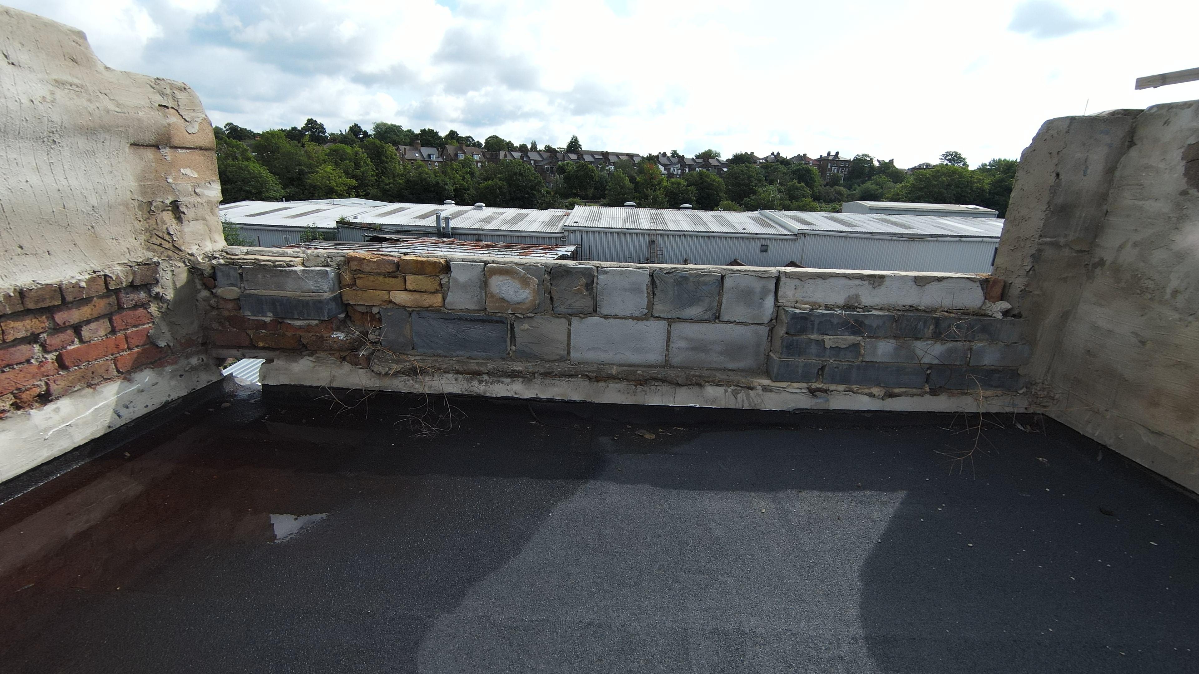

The wall itself is about 0.75m high on the rear and front, whilst the shared sides are about 1.5m high. I think I will ask for the rear parapet wall to be removed, as I would like to deck out the roof in the future - the rear side would provide access to the roof from the garden.
Below is an image of the rear parapet wall, with a view of the shared side walls. Pretty shocking!

Hi Ferdinand, I would remove the rear parapet wall seen in the photo above that is made up of a mixture of breeze blocks and red brick, which I believe the current owner put up - that section does not need planning permission to remove. I would have this section of the wall removed to the point where you can see the original white ledge.

Omg! The masonry is in a bad state, definitely needs work to make it waterproof.
looking at the pics the quote is more than reasonable.
as above, parapet walls are always more trouble than they are worth.

Rendering with sand and cement will not be a permanent cure
First you will need to stabiles the masonry
This can be done by drilling and fixing a s steel mesh You then need two coats of sika bagged render Expensive but totally watertight and permanent
Ive used this on the bottom of lift shafts whilst pumping water out
Any render beads will need to be S steel

The render price that he is quoting Is 2 days work for two men with less than £200 in materials and certainly won’t be a long term cure
So pretty high
I would at the very least stabilize the walls before doing anything else
and perhaps get a quote off a plastering contractor for the render

I've had a few 3 bed semi's re-rendered with simple s&c and dashed with 6mm clean limestone for under £5k (I guess it depends where in UK you are). As Nod said, it's a few days work on that job you have there and materials cost is virtually nothing using traditional sand and cement.
To me, your price sounds expensive. Also, it may be worth asking for other quotes advice to gauge what everyone suggests as solution. As you've found out here, there are a number of approaches to resolving it, with some being better than others.

Although it is not pretty, is there anything to suggest that the current setup has failed?  Also, how did you get access for the photo?  If it is easy to access you and currently watertight you could just get the wall meshed and rendered and order some aluminium copings that you could install yourself.
