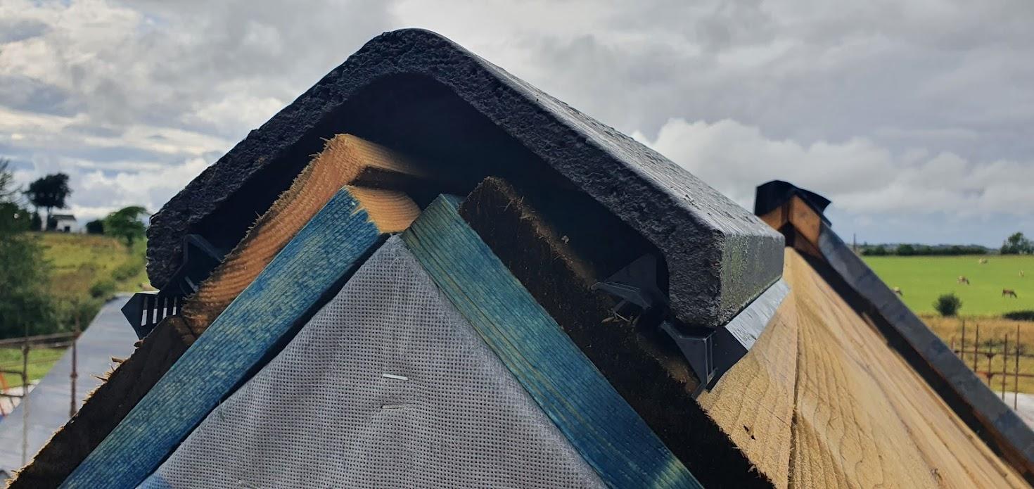

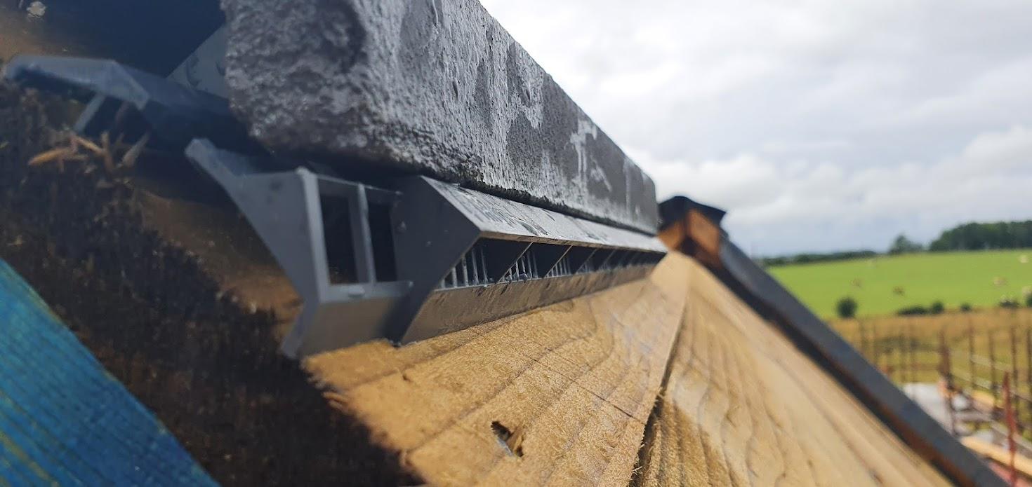

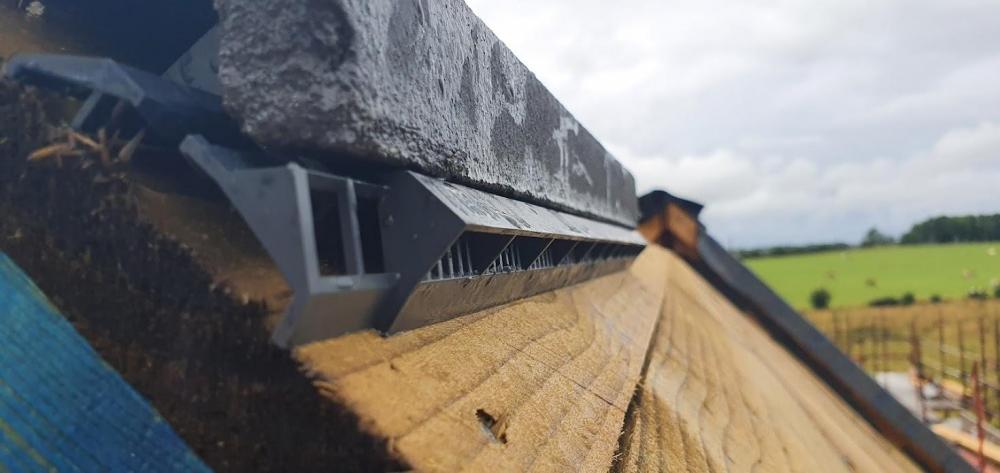

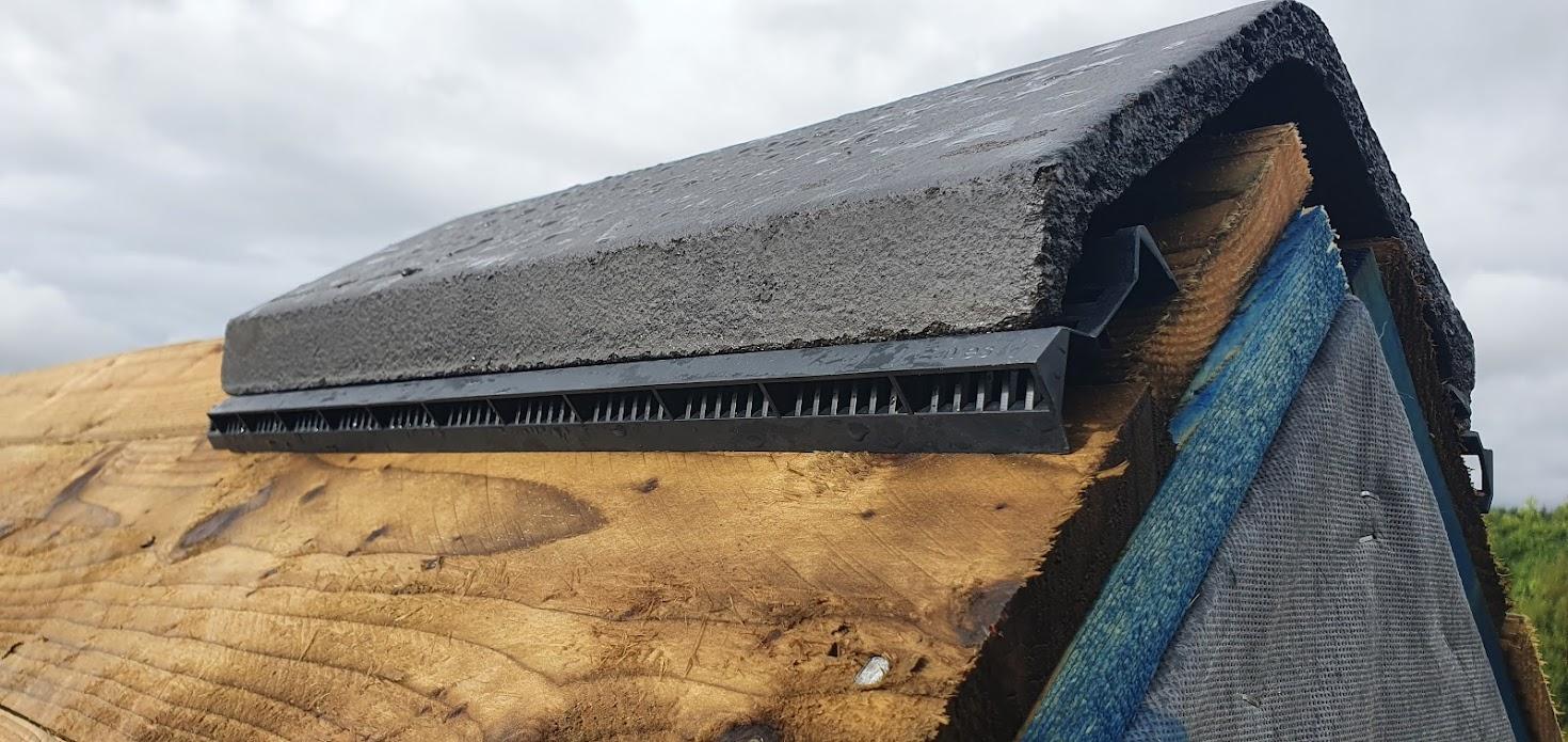

SuperJohnG Posted August 12, 2021 Share Posted August 12, 2021 (edited) Has anyone ever seen this ventialted ridge system? Roofing merchants dropped this off to see how it fitted. I am looking for a dry ridge ventilated system. So this cocrete ridge tile sits on these plastic bits which will rest on the slates and a seperate, but all be screwed together with a strap over the top between each ridge tile. I think it's sandtoft but have never seen it before. He reckons using this you don't need to roll out membrane bit. Has anyone used this or seen this? Keen to see if its any good or a load of rubbish. Slates obviously still to go on. Edited August 12, 2021 by SuperJohnG Link to comment Share on other sites More sharing options...
PeterW Posted August 12, 2021 Share Posted August 12, 2021 Looks like Weinerberger Profile Dry ridge - you still need the membrane lapped up and over the ridge. 1 Link to comment Share on other sites More sharing options...
SuperJohnG Posted August 12, 2021 Author Share Posted August 12, 2021 9 hours ago, PeterW said: Looks like Weinerberger Profile Dry ridge - you still need the membrane lapped up and over the ridge. I thought that, air should still flow well through through the membrane I assume, I do have two membranes as on one SIPS panel, then on one top of sarking. Link to comment Share on other sites More sharing options...
DragsterDriver Posted August 12, 2021 Share Posted August 12, 2021 Looks good- I really don’t like the adhesive ones Link to comment Share on other sites More sharing options...
makie Posted August 12, 2021 Share Posted August 12, 2021 Marley used to have one like this, works well but as someone else said it needs the membrane Link to comment Share on other sites More sharing options...

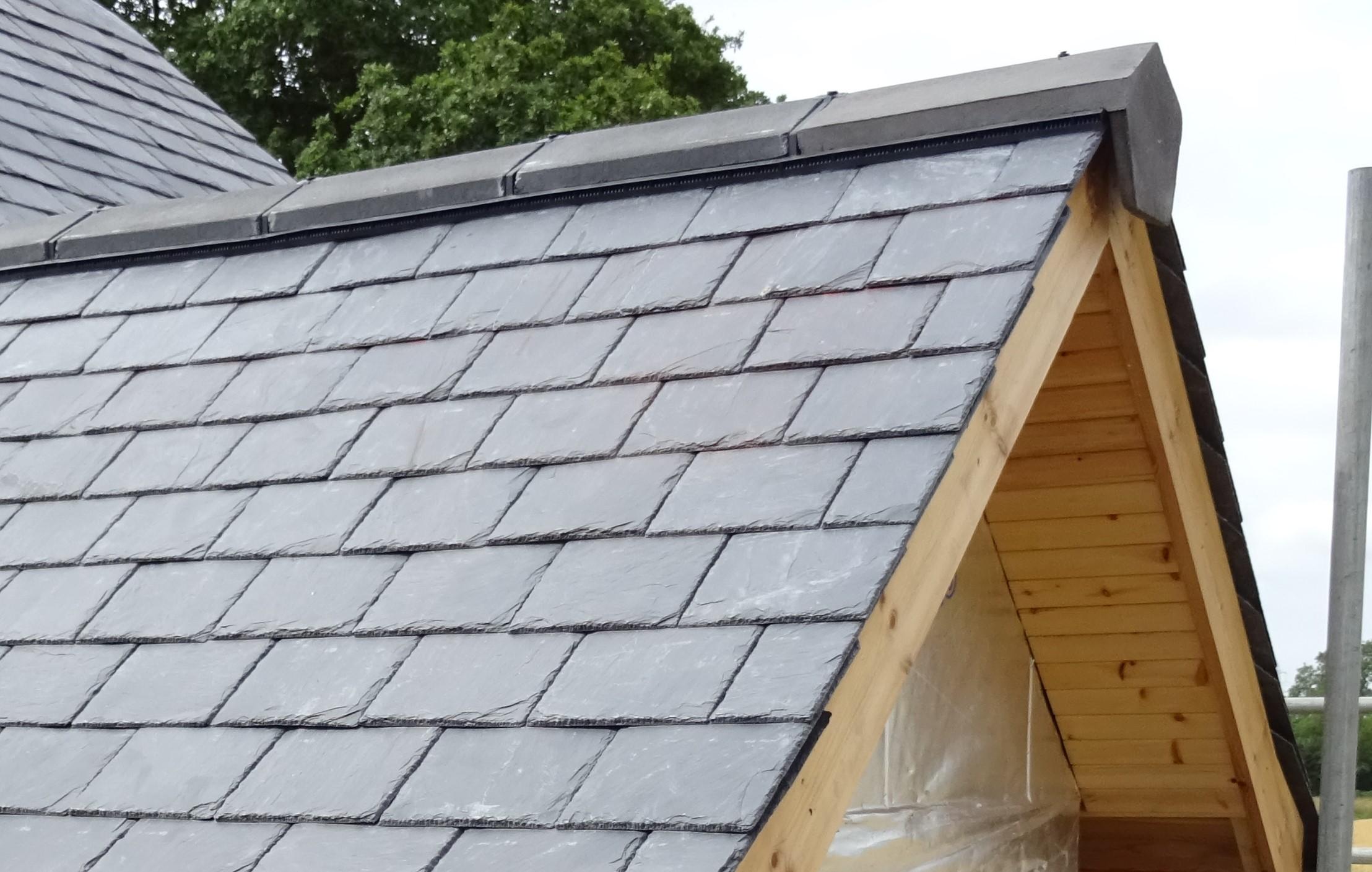

SuperJohnG Posted August 20, 2021 Author Share Posted August 20, 2021 I still seem to be mega struggling with this weinerberger bit, I quite fancy getting it. However the supplier has just advised the price is £85 plus vat for 2.7m, so in the end it is around £1360 for the 40m I need plus, ridge tile at around £3.5 a pop, makes it horrendously expensive for a ridge. The reason he was offering this was they cant get an angled ridge tile to suit my 90 degree apex, which seems a little crazy, but he says it is quite a steep pitch but this helped use a tile for s lesser pitch but allow it to clear the apex. Now I had reverted back into my shell and started to go back to a zinc ridge (ventilated( - which i don't want but at 400 quid it is much better priced. He is looking for the right ridge tile but its a bloody struggle to get these in under 18 weeks it seems. However I have now stared to question how the air gets out up here, at the ridge, and what's required in terms of air flow. The over fascia vents are 25mm and will allow lots of air in under the membrane and in between the sarking and SIPS panel (which also has a membrane) but at the top the the membrane is still lapped over the sarking, now as per @PeterW mentioned above that should be the case. But in the event I use the weinberger profile should I put a cut in the membrane to let the air out? everything will be covered with just air allowed in at the side vent as per the first picture. I know the membrane is vapour permeable, but it is windproof so wont allow a nice flow of air so do I need that really good flow or will the vapour permeable but do it? Also - there is a possibility he can get the right ridge tile to suit my pitch and in that case - it seems i can revert to a roll out dry ridge. Now If i do that - shoudl a cut the membrane allow air through then roll out the dry ridge roll, or is it just like a bit of membrane? or does it allow a lot more airflow while keeping the beasties out? help please - end of my wits with no solid advice. Link to comment Share on other sites More sharing options...

markocosic Posted August 22, 2021 Share Posted August 22, 2021 This useful? https://www.wienerberger.co.uk/content/dam/wienerberger/united-kingdom/marketing/documents-magazines/technical/UK_MKT_DOC_TEC_ROF_SAN_Dr_John_notes_roof_space_vent_001.pdf You're a sip structure? Therefore it MUST be well sealed warm roof so that the SIP doesn't turn into wet Weetabix Therefore the breather membrane that you have already that's lapped over the top is sufficient. And in theory no ventilation whatsoever if the roof can breathe (e.g slates with gaps not a standing seam metal roof) unless you're trying to keep the roof cool enough to avoid ice dams (in which case steep roof and lots of breathing above membrane and out of the ridge, and try to avoid breathing in warm air from walls that are heated by the sun etc) If you propose having another membrane above sarking, then battens, the roof finish, with all ventilation above the second membrane, then it's fine to lap this second membrane over the ridge just above sarking. When we were looking at SIPs the detail requested was a breathable membrane over the sip (one suitable for direct contact) right over the ridge; then vertical battens; then either counterbattens and standing seam or counterbattens and tiles or OSB and asphalt shingles etc; with ventilation between membrane and the roof finish at eaves and ridge levels. No additional membrane above this. The SIP folks would provide said membrane held in place with the vertical battens. I don't see why you'd have a second membrane of this is effectively what you have. Tiles and ridge just go on. Sarking kinda overkill given that there's already OSB there for shear strength in the roof unless I'm missing something? PXL_20210822_114836179.jpg Link to comment Share on other sites More sharing options...
