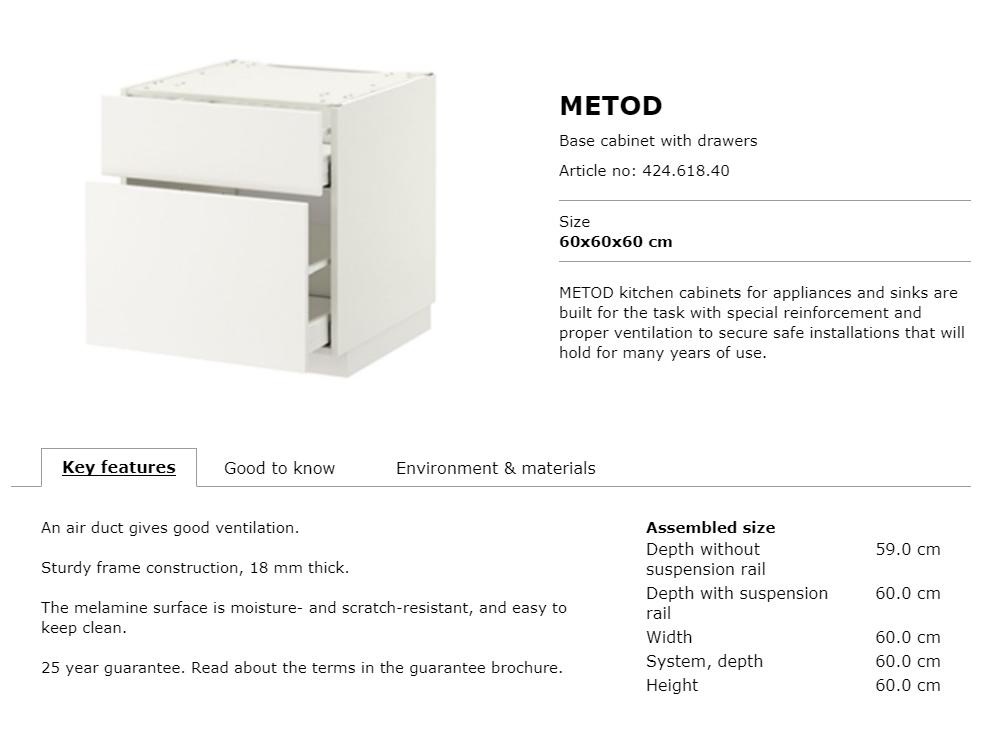

You can ask kitchen companies about their accessible kitchens (for wheelchair users) which are lower. You'll find some companies will be to afraid to say they don't cater for wheelchair users and try and work something out for you.
I know Ikea do lower base kitchen cabinets but don't know about other DIY companies. This is 60cm high so include the 8cm plinth and say 4cm for the worktop you're at 72cm tall.
