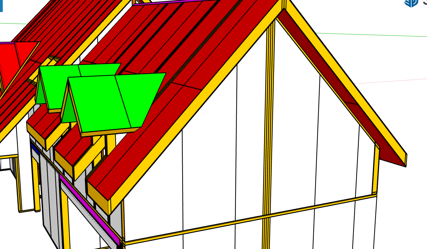

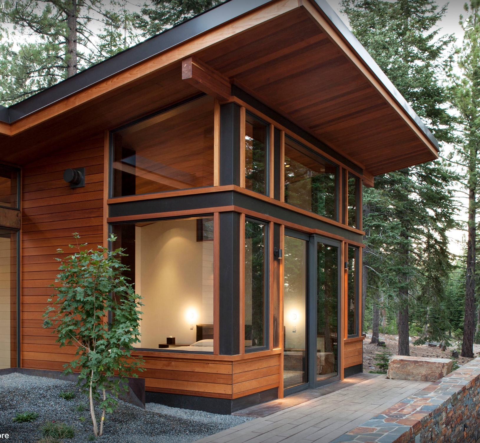

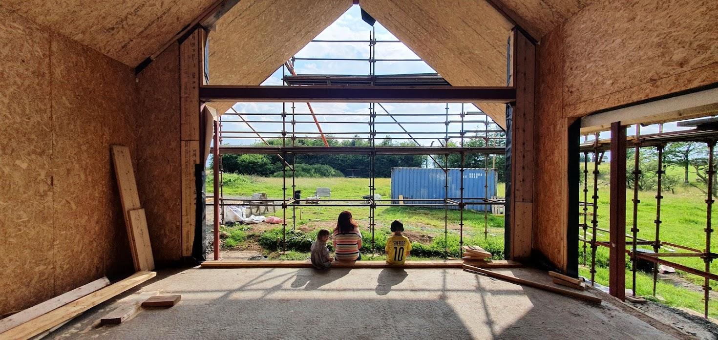

SuperJohnG Posted August 11, 2021 Posted August 11, 2021 I have a large canopy (3m) and these lovely profiled soffits which return at an angle and get rid of the box end soffit design. I have opted for Black ash fascia and I have black fibre cement cladding in places along with white renderboard elsewhere. Hence as a nice detail i wanted to get a lovely wooden soffit to contrast well with the black fascia and cladding and provide a nice view from inside the glazed gable. I have ben talking to Russwood forever about this, and siberian larch and themropine are on offer both at about 40/m2 ( I need 100m2). I had wanted red cedar but that's prohibitive at 100m2 just now! But both the larch and thermopine seems to be on 17-20 weeks whch is ridiculous. So ws looking tat what others used, to be cost effective and give a nice finish. Ideally it woudl be red cedar or a similar nice rich finish, but might not happen. Does anyone know any other good options that would do it justice? or good suppliers for quality materials. I did look at Vulcan today. who do aluminium wood grain finish cladding, looks lovely...but at 140m2 - thats mental! Few pictures below...one of @Alexphd1's arrnagement which is what i wanted. (sorry for stealing!). Also pictures of canopy so here will be windows where the wife and kids are sitting and you'll be able to see that canopy inside so wood clad will be nice.

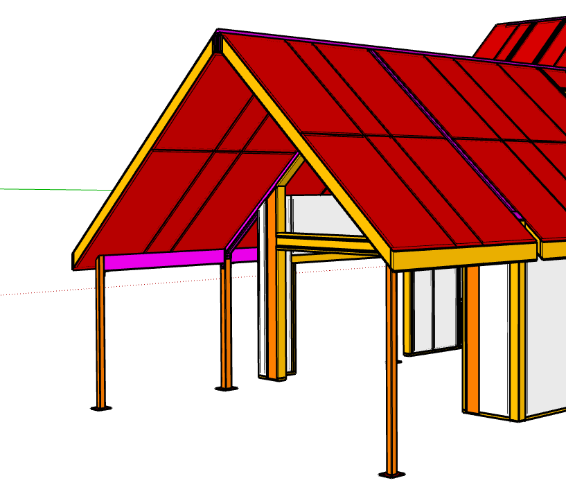

SuperJohnG Posted August 12, 2021 Author Posted August 12, 2021 4 hours ago, markocosic said: What will the detail at the gable end look like? (the vertical edge of the roof) having that not drip onto the underside or OSB probably most important? Hmm not quite sure which bit you mean do you mean up the verge? Its finished with Kytun, then barge board down as per the fascia detail. Added a few images of the mdoel so you can see the roof profile thanks,
Russell griffiths Posted August 12, 2021 Posted August 12, 2021 If you put something cheap and nasty under that open gable, you will regret it. Needs to be something a bit tasty.

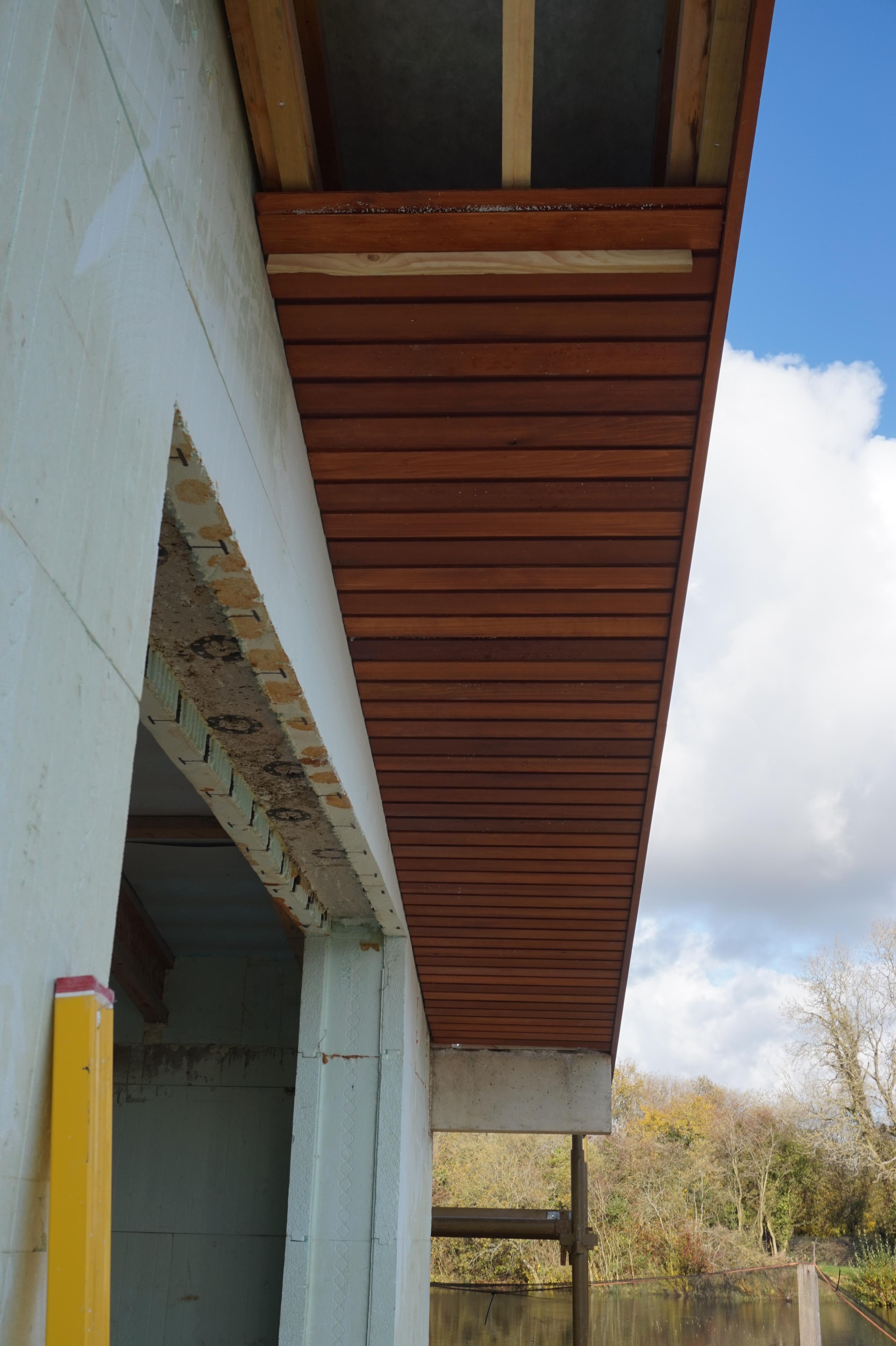

markocosic Posted August 12, 2021 Posted August 12, 2021 One could still 'cheat' though? As in it doesn't need to be thermopine or similarly stable it just needs to be look good? Indoor grade flooring as soffit? Glue and tack to OSB? Speedboat style random length oiled teak 30 Inc VAT at one of the sheds. Long bits for the big gable short bits for the regular soffits?
SuperJohnG Posted August 12, 2021 Author Posted August 12, 2021 8 hours ago, Russell griffiths said: If you put something cheap and nasty under that open gable, you will regret it. Needs to be something a bit tasty. damn you @Russell griffiths. trying to drag me down with you, but I'm 100% with you. Just not sure how the budget can take it. 5 hours ago, markocosic said: One could still 'cheat' though? As in it doesn't need to be thermopine or similarly stable it just needs to be look good? Indoor grade flooring as soffit? Glue and tack to OSB? Speedboat style random length oiled teak 30 Inc VAT at one of the sheds. Long bits for the big gable short bits for the regular soffits? this teak could certainly be an option. need to have a look somewhere.

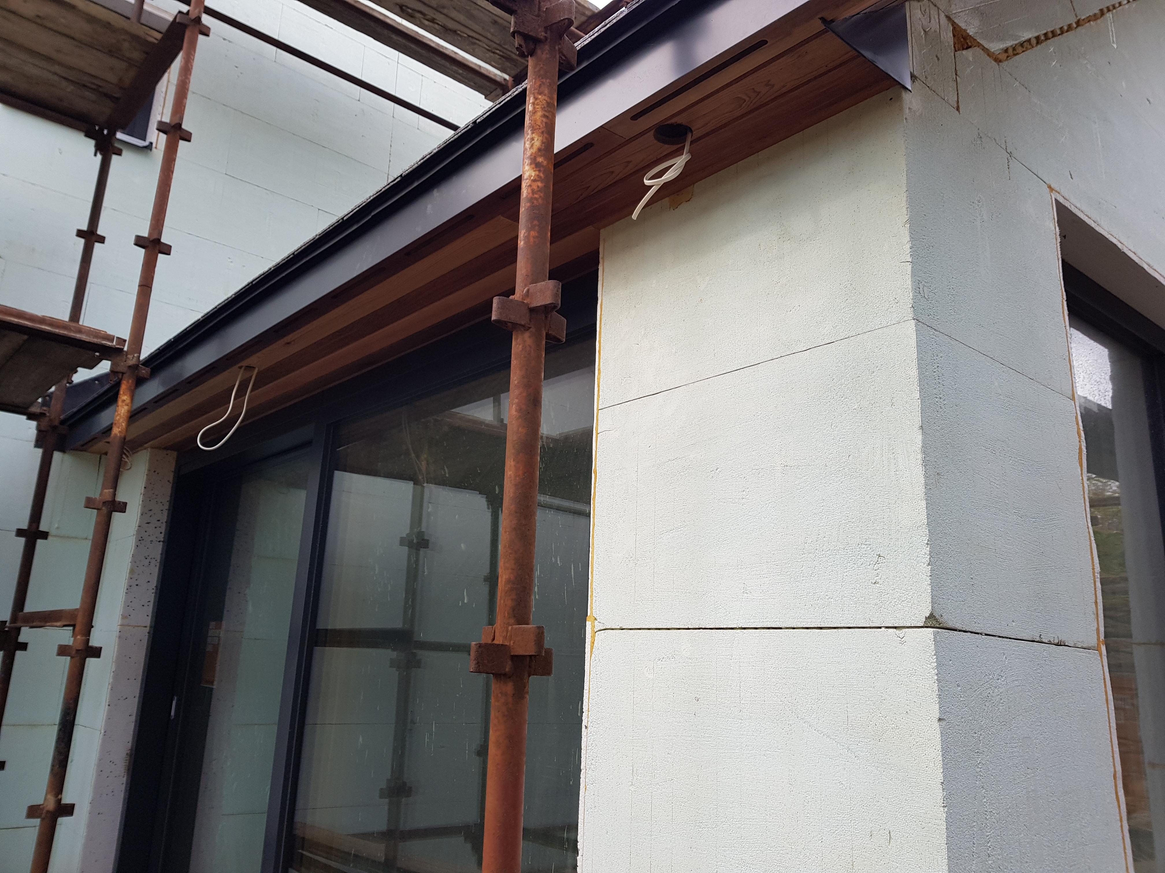

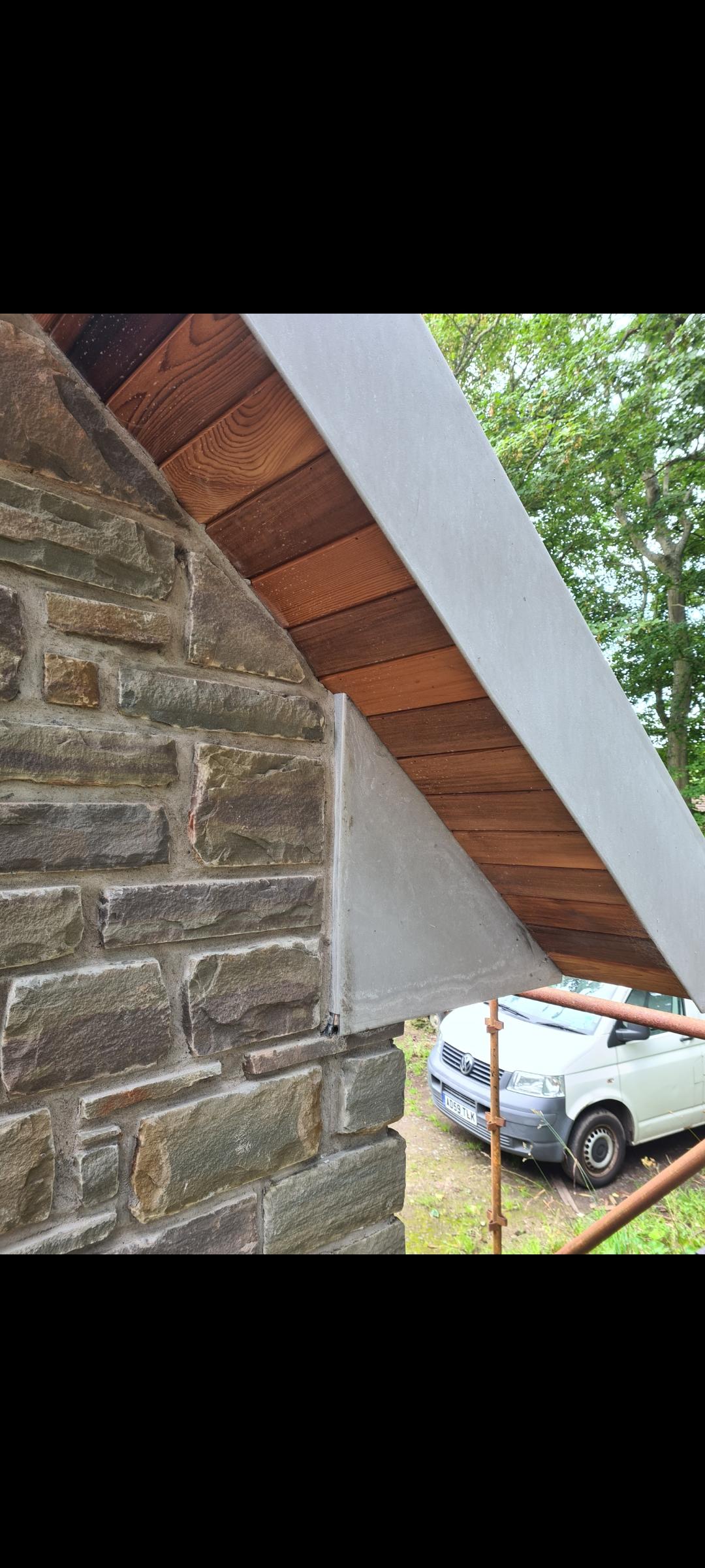

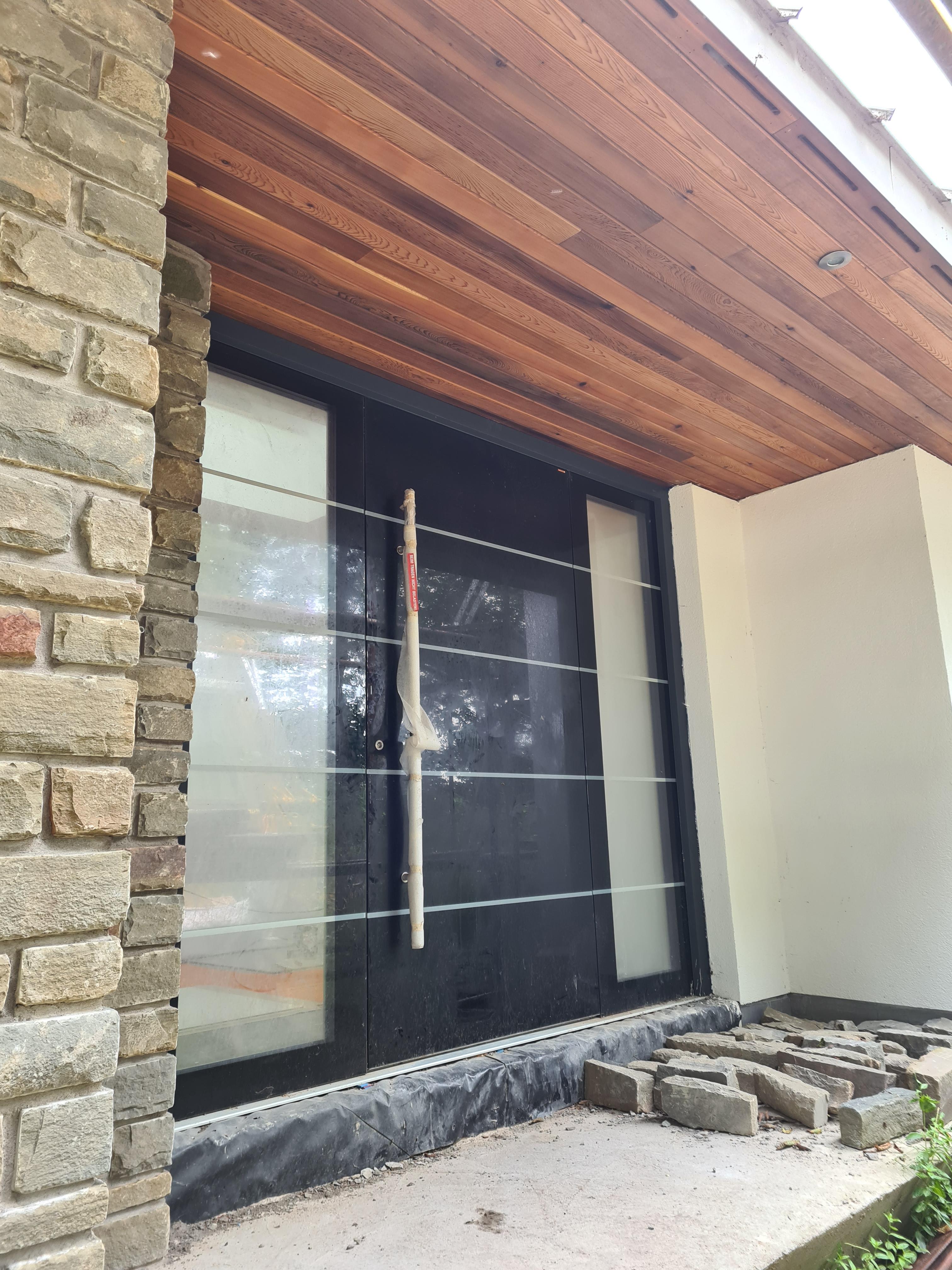

Alexphd1 Posted August 12, 2021 Posted August 12, 2021 Scary! Ruswood was way over when I priced a few years back. I ended up getting my cedar from travis perkins of all places who sourced it from a supplier in Glasgow. 1

markocosic Posted August 12, 2021 Posted August 12, 2021 It's been a tricky year to be building in wood! Especially if you'd planned timber frame with timber exterior wall cladding and timber roof covering and timber ceiling covering and timber floor covering and a timber deck ? We gave up and are leaving our deck / south wall / similar but less grand open gable unfinished until 2022. The sawmills (in Lithuania anyway) think they will have "satisfied all the silly priced futures contracts" by then. Prices won't go back to 2020 levels though. Maybe only +50% rather than +200%. Here's that miscellaneous teak from the shed FWIW - you should get a trade discount on top of that for tradepoint or visiting on OAP day with a borrowed granny etc. Go crazy bold and thin coat solid colour render onto the OSB? In all seriousness if you can wait I would wait. September futures in the US (which is where all the Euro wood went earlier this year) are down again https://www.bloomberg.com/news/articles/2021-08-11/lumber-falls-to-nine-month-low-extending-retreat-after-boom 1
Alexphd1 Posted August 13, 2021 Posted August 13, 2021 (edited) +1 for natural wood, I got a sample of the aluminium vulcan board tbh I was a wee bit disappointed. Edited August 13, 2021 by Alexphd1 2
SuperJohnG Posted August 15, 2021 Author Posted August 15, 2021 On 13/08/2021 at 10:59, Alexphd1 said: +1 for natural wood, I got a sample of the aluminium vulcan board tbh I was a wee bit disappointed. This looks great. Exactly what I'd hope for. Maybe I should try local and see where I get to would be very interested to find that Glasgow supplier

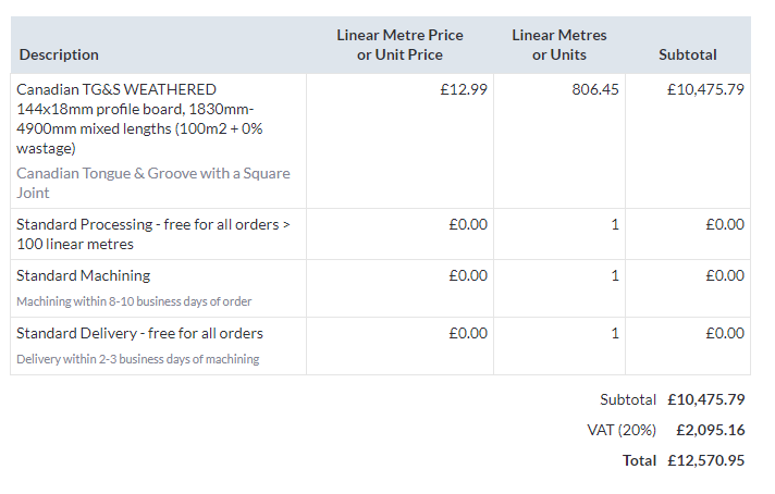

SuperJohnG Posted August 16, 2021 Author Posted August 16, 2021 hold onto your hats....western red cedar.
Russell griffiths Posted August 17, 2021 Posted August 17, 2021 (edited) Was £5.50 LM when I brought mine. I have another project that I need ?? Will need to keep my 12 year old truck another year or two. Edited August 17, 2021 by Russell griffiths
