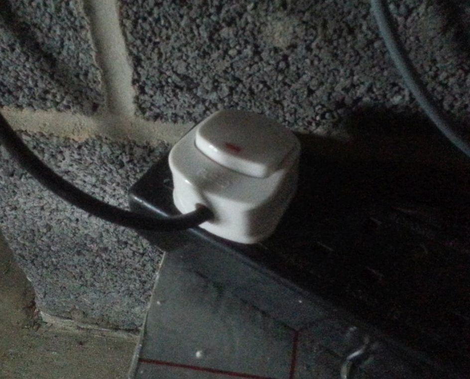

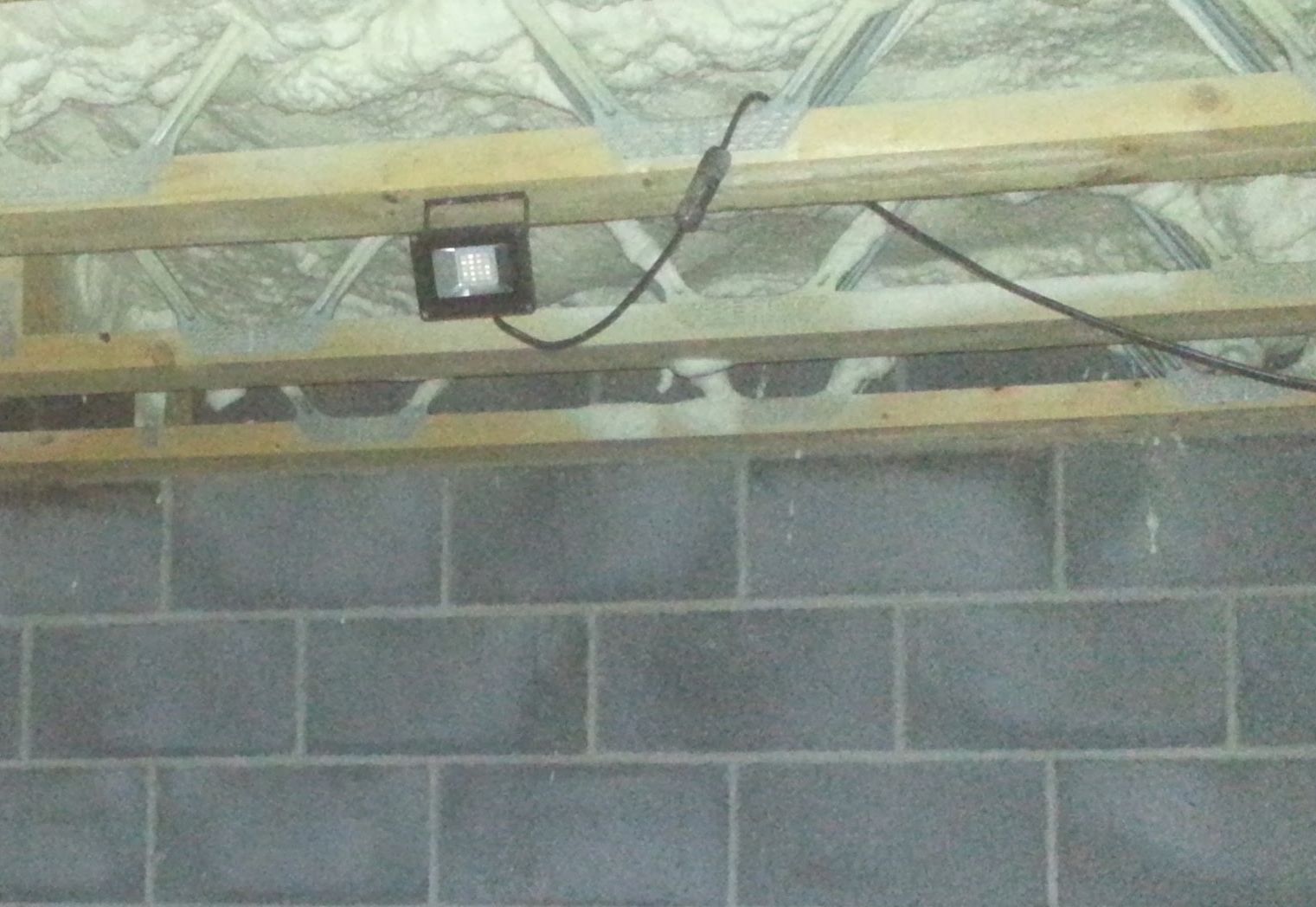

readiescards Posted March 22, 2017 Share Posted March 22, 2017 I've put a few of these cheap LED floodlights about: http://www.ebay.co.uk/itm/-/192036357719 Apart from the fact they didn't like a super cheap non-sine wave inverter and kept blowing up so I've upgraded to a sine wave inverter and they seem fine. To help the trades I've put some switched plugs on LED power cords: http://www.ebay.co.uk/itm/261904475129 But when the switch is OFF the LED floods are partially illuminating - this is happening on all the LED floods I have with these switch plugs on. Is it dangerous? A problem with the LED? A problem with the switch? A screwup by me? Thanks for any tips Paul Link to comment Share on other sites More sharing options...

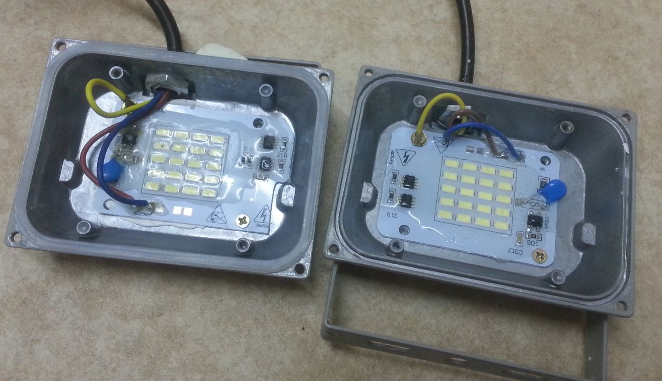

Jeremy Harris Posted March 22, 2017 Share Posted March 22, 2017 It's almost certainly leakage current. If these are Chinese, then please disconnect them and take them apart to make sure that they have an earth connected - my experience is that very often they don't! If the earth wire is properly connected internally, then check that the line and neutral are the right way around - again it's quite common for Chinese stuff to have them swapped, I've seen this on power supplies in particular, and once on a battery charger (not nice, it meant that the negative battery connection was sat at mains voltage................). It's also possible that instead of a proper LED driver they may just be using a capacitive dropper, sort of OK if everything is properly insulated internally, but again Chinese stuff can be poor in this regard. If you find that the light does have a proper LED driver inside, that the line and neutral are the right way around, and that the internal earth wire is properly connected to the alloy case, then you can still get leakage via the interference suppression capacitors fitted to the supply side of the switched mode LED driver unit. The problem is generally current flowing via earth in this case, not enough to cause an RCD/RCBO to trip, but enough to make the LEDs glow. If that's the case then the best fix is a double pole switch, but please disconnect the light and look inside for earth or wiring faults first. Sadly there are a lot of these that are just bloody dangerous. I bought 4 very similar flood lights and all four had the earth wire loose and unconnected inside the case, and they were all sold by, and badged with the name of, a UK company. 1 Link to comment Share on other sites More sharing options...

Jeremy Harris Posted March 22, 2017 Share Posted March 22, 2017 Just to add that I found the post showing photos of the unconnected earth wire in similar Chinese LED flood lights: With an earth conductor connection made to the case these lights are safe enough, and seem reliable. Link to comment Share on other sites More sharing options...
readiescards Posted March 23, 2017 Author Share Posted March 23, 2017 20 hours ago, JSHarris said: t's also possible that instead of a proper LED driver they may just be using a capacitive dropper, sort of OK if everything is properly insulated internally, but again Chinese stuff can be poor in this regard. Thanks Jeremy, attached a photo of the internals, I'm not sure if that is a proper LED driver or not? The earth connection within the units look secure and ok to me. However there is no earth connection in my setup as these lights are running directly from my battery inverter. Seems like I should add a connection to the world earth for safety reasons. I'm not sure if the live and earth are correct inside the unit, maybe someone can say from this photos (note these are from LED units that have failed but the working units are the same internally) Though I still find it strange the lights are semi-illuminating and a double pole switch seems best solution - do these exist as 'in plug' versions like these units? Link to comment Share on other sites More sharing options...
Jeremy Harris Posted March 23, 2017 Share Posted March 23, 2017 The earth connection looks OK, and the COB LED in this unit seems to be direct drive, via parallel connected BP5132H high voltage constant current driver chips. This arrangement means that the LEDs on the chip on board (COB) are connected in series and driven with full wave rectified mains. A side effect of this is that, like some GU10 LEDs, it's possible to get a slight glow from induced current in the wiring. What is puzzling is that the earth conductor in a three core cable should act to reduce induced current in the switched line to a very low level. Clearly it's not doing this in your case, so it's worth checking that there is continuity from the earth conductor in the LED to the protective earth for the installation, as it's possible that the earth has been disconnected somewhere. If all is OK, then the fix to stop them glowing is probably to fit a double pole switch. Big Clive has some details about this type of LED flood light on his YouTube channel: 2 Link to comment Share on other sites More sharing options...
