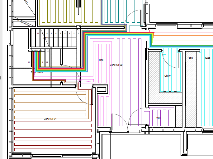

Bramco Posted August 7, 2021 Share Posted August 7, 2021 (edited) Hi, We're about to get the slab laid and have the UFH layout from the timber frame contractor. As you can see the plant room is to one edge of the layout and therefore almost all the UFH loops have to go through the hall and the doorway into the living space (off to the right of the diagram below). The proposed layout has the flow and returns for about 7 or 8 loops all bundled together as you can see from the diagram. I'm concerned that this will cause that area to warm up very quickly and therefore warm the returns before the slab at the ends of the loops are actually up to temperature. So measurements of the flow and return temperatures wouldn't give a true indication of the temperature of the slab. Would it be better to have the flow and returns more evenly spread across the hall area. They would of course heat this area as they are heating the rest of the zones. Edited August 7, 2021 by Bramco Link to comment Share on other sites More sharing options...
joe90 Posted August 7, 2021 Share Posted August 7, 2021 I didn’t like the idea of multiple pipes through doorways so (with the consensus on here) ran some pipes under walls (with a pipe sleeve of overflow pipe). This reduced pipe bunching and also reduced loop length a little. Link to comment Share on other sites More sharing options...
Russell griffiths Posted August 7, 2021 Share Posted August 7, 2021 I had a design like yours so I spaced flow and return at 150 like the rest of the house so if you shorten the pink purple loop and space them evenly across that area. Lose all runs in hall and just cover with flow return. Link to comment Share on other sites More sharing options...
Bramco Posted August 7, 2021 Author Share Posted August 7, 2021 Thanks for the good ideas. I'm still wondering though whether I'm worried about nothing. Would be interesting to hear from anyone that followed a plan like the one we have as to whether it was OK or whether it caused problems. Simon Link to comment Share on other sites More sharing options...
Bramco Posted August 7, 2021 Author Share Posted August 7, 2021 @joe90 and @Russell griffiths Just been looking at this again and wonder actually whether it wouldn't be better to have 2 manifolds, one in the utility to feed that area and the living space a total of 6 loops which could actually be reduced maybe to 5 as the long runs would be a lot shorter. That would leave a manifold in the plant room itself to handle the remaining 7 loops. Would require a feed and return from the buffer tank across to the utility which could run through the ceiling. And 2 separate pumps the living space would be one zone, so that would be good - I think... Simon Link to comment Share on other sites More sharing options...

andy Posted August 9, 2021 Share Posted August 9, 2021 19 hours ago, Bramco said: @Nickfromwales passive raft/slab Simon Hi Simon I had a similar desgin, I sleeved the majority of the pipes (and all flows) where they bunched to minimise heat transfer in areas I didn't want to overheat. I used this suff (red for flow, blue for return): https://pswtradesuppliers.co.uk/ufh-foil-pipe-edge-insulation/136-16-18mm6mm-pipe-insulation-lagging-blue.html This has worked fine with no excess heat in areas I didn't want it. And I have a split floor on my slab with a manifold on each floor. Hope that helps! 1 Link to comment Share on other sites More sharing options...
Bramco Posted August 9, 2021 Author Share Posted August 9, 2021 4 hours ago, andy said: Hi Simon I had a similar desgin, I sleeved the majority of the pipes (and all flows) where they bunched to minimise heat transfer in areas I didn't want to overheat. I used this suff (red for flow, blue for return): https://pswtradesuppliers.co.uk/ufh-foil-pipe-edge-insulation/136-16-18mm6mm-pipe-insulation-lagging-blue.html This has worked fine with no excess heat in areas I didn't want it. And I have a split floor on my slab with a manifold on each floor. Hope that helps! Great help - thanks Simon Link to comment Share on other sites More sharing options...
Nickfromwales Posted August 9, 2021 Share Posted August 9, 2021 On 08/08/2021 at 15:00, Bramco said: @Nickfromwales passive raft/slab Simon Hi. With such low flow temps ( as associated with these types of emitter ) I really doubt that you’ll get any issues whatsoever. I would run the pipes under the stairs though, instead of dog-legging through the plant corridor. Come up into the manifold from behind, or even relocate the manifold under the stairs to free up some more space there if there’s nothing else under the stairs. 5 hours ago, andy said: I used this suff (red for flow, blue for return): That would be better than nothing, but again I think probably unnecessary with such very low flow temps. 1 Link to comment Share on other sites More sharing options...

Nickfromwales Posted August 9, 2021 Share Posted August 9, 2021 I’ve never laid serpentine in any of my installations. Reverse / inverted is the best layout afaic and allows for much better heat dispersion and almost zero 180o ‘U’-turns, which are not great for enhancing flow rates. Also, if installing on anything less than 200mm centres, inverted is the only layout that allows for tightly packing in the pipes. On my current project, an MBC TF passive raft, the pipes are going in at 100mm centres to maximise water volume in the system ( to aid the operation of the ASHP + cooling ) and that can only go in via inverted at that distance apart. If going DIY then serpentine may look simpler, but inverted really is a doddle to lay, me imho easier than serpentine as you’ve not got to perform so many ‘U’-turns ( which are difficult / easier to kink the pipe with when performing scores of them with each loop ? ). Link to comment Share on other sites More sharing options...

RHayes Posted August 11, 2021 Share Posted August 11, 2021 On 07/08/2021 at 16:20, Bramco said: @joe90 and @Russell griffiths Just been looking at this again and wonder actually whether it wouldn't be better to have 2 manifolds, one in the utility ... Agree with Simon, when designing our systems we always seek to put the manifold in a central location for that reason. If its not too late and if supply pipework runs supported it I'd recomend putting the manifold in the utility and send some pipes under walls, that way you minimise any pipie bunching and reduce transit pipework lengths. However coming back to the design, we have done many like that over our 18 years and don't typically have a problem. Insulating the flow pipework is a good idea where they are going through a narrow hallway as you have here. Link to comment Share on other sites More sharing options...
