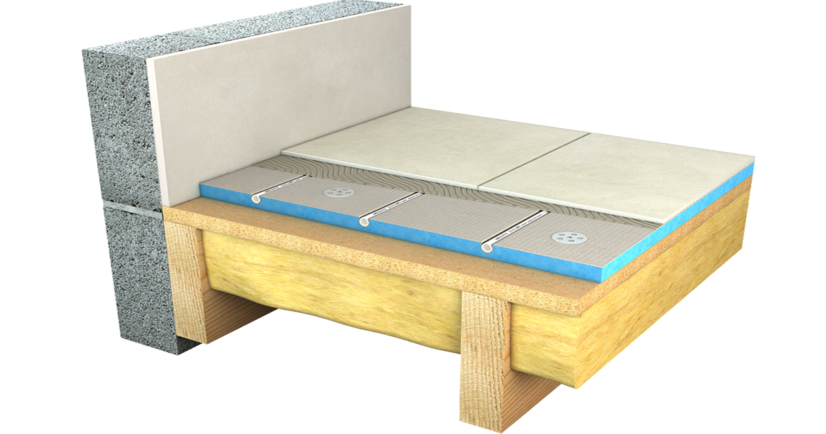

Nickfromwales Posted August 5, 2021 Posted August 5, 2021 I would get a Hybrid ( oil uplift ) ASHP and condense the solution. That would allow ASHP only where minimal heating is required, but then burn oil to fortify when, and only when, necessary. The 70m2 Will likely need 4 loops, as you’ll want to be well under 100m for each individual loop length to maximise even heat output across the whole area. Pipe size and centres ( distance from pipe to pipe ) will be dictated by the system you choose, but given this is retrofit which is incredibly tricky to get right I would 100% be using an overly system. If height is an issue, recess battens to accept 22mm P5 and finish them flush with the joist tops. Then I would skin the whole floor with 9mm ply glued and screwed for integrity. Then fit your overlay system on top of that with as much insulation in the build up as possible. Forget “thermal mass” you just want the heat getting to the room as directly as possible. Minimum 100L buffer tank, because of oil / ASHP, but if both they will need to become a multiple coil thermal store to hydraulically separate the different systems to suit. On 03/08/2021 at 08:30, David R said: 50mm pumped screed on top of the joists / chipboard flooring in order to make use of the thermal mas Expand This will only give you a slightly better emitter, but at a cost. I would buy insulation not screed. Finally, draught-proofing the subfloor will be your biggest return, more so than insulation. Use foam a plenty, run the 9mm ply 8mm short of the external walls and then fully foam the perimeter. This will pay huge dividends.
AliG Posted August 5, 2021 Posted August 5, 2021 The Celotex will give you enough insulation. Make sure it is well sealed as @Nickfromwales points out. It sounds like you can use either the kind of build up shown above - 22mm board, overlay panels, tiles or board plus screed on top of it. I might disagree with Nick here. If you have room for the 80-90mm build up of 22mm chipboard plus screed plus tiles I would do that. The reason is that you are going to need a high flow temp / floor temp to heat that area. I think this will work better in a heavier floor. TBH I would be worried that you are going to struggle to heat the space. What kind of glazing will it have? 50% glazing is close to a conservatory. Is it 50% including the internal walls to the rest of the house? If it is not triple glazed you will struggle to put out enough heat from the floor. You might well need the oil boiler for colder times when the required flow temp will be too high for the ASHP. In my last house we retrofitted the kitchen with UFH in this manner and I had to run the flow temp at 62C to keep the room warm in winter. It really struggled. I think we only had 100mm Celotex under the floor however and I didn't do it myself so don't know how well it was done.
Nickfromwales Posted August 5, 2021 Posted August 5, 2021 On 05/08/2021 at 12:12, AliG said: I might disagree with Nick here. If you have room for the 80-90mm build up of 22mm chipboard plus screed plus tiles I would do that. Expand 6 and two 3’s. More insulation, less losses, lower flow temp > better CoP from HP. There’s only so high a flow temp you can run at the end of the day. Look at how well electric UTH works in a bathroom
