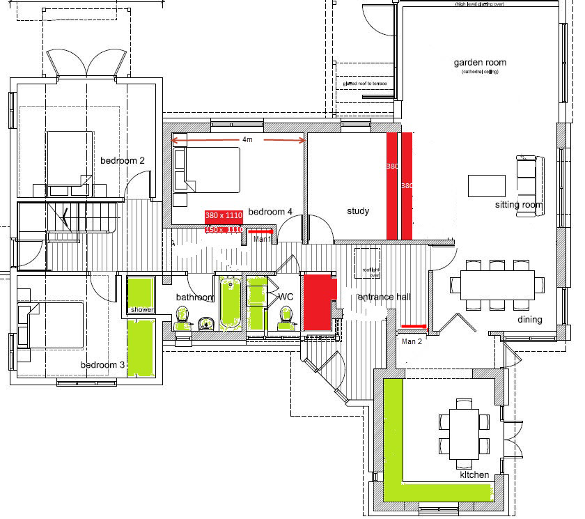

oranjeboom Posted March 20, 2017 Share Posted March 20, 2017 After a number of UFH quotes I have ended up with 2 that I need to choose from for my 150sqm floor area. One provider (Provider “W”)has quoted from 2 manifolds (7 ports) due to the long pipe runs. The other has provided just the one 12 port manifold (Outside bedroom 4) and some of their pipe runs are just over 100m (think the allow for 105m). They have not elaborated on how they achieve this. I have attached a floor plan showing locations of manifolds (“Man 1”, “Man 2” in red ). Green areas are those depicting locations which will be offlimits to UFH (Kitchen units, toilets, built ins etc), and those in red, are further areas that won’t accept pipework (structural additions mostly). Biggest issue is the long pipe runs to sitting room/garden room if I am just using one manifold in location outside bedroom 4. That’s why provider “W” had added another manifold in entrance hallway. The additional manifold means they are £400 dearer that the other quote. Single manifold means that most of the hallway will just be feeds going off to control the kitchen/garden/sitting/dining rooms, so reducing temps in those areas will ultimately impact temps in the entrance hallway area. I don’t mind paying the additional £400 if it means a more efficient system. However, having 2 manifolds, also means two pumps to power and more parts to go wrong. “W” will have 4 loops in the garden/sitting/dining room. I suspect that the other provider may simply have put in 5 loops to keep the lengths down. “W” has essentially said this is the best they can do. I have had a play with loopcad but that’s not really helped me with any decision making. So seeing whether the experts have any real life experience here / opinions that may sway me to go for 1 vs 2 manifolds. Efficiency is what I am after, but I also don’t want to be shelling out for a new pump every few years if it’s being overworked. FYI: · 150mm pipe spacing · Pipework tied to mesh in concrete (no screed) · Boiler location in loft above dining room on rightermost wall · EWI, 3G glazing, 300mmEPS (or PIR equivalent) in most floors Link to comment Share on other sites More sharing options...

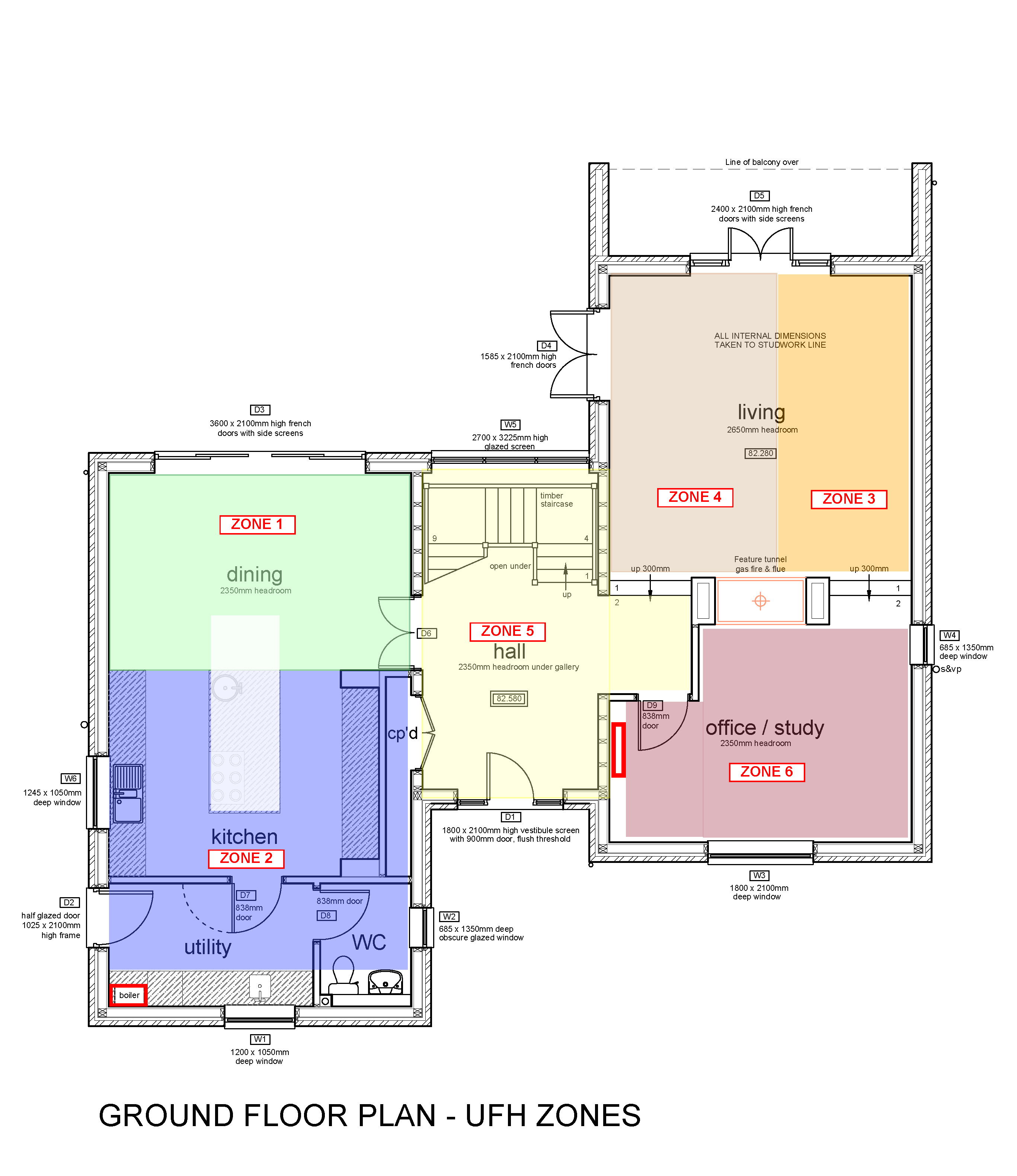

ProDave Posted March 20, 2017 Share Posted March 20, 2017 MAN1 looks pretty central. 12 zones seems a lot? 1 per bedroom, one for bathroom and wc, one for kitchen and 3 for living sopace would probably be plenty.Even saying 2 for kitchen and 3 for living space, that's only 10 zones. I would not have a zone for the hall. We have and it never comes on. There's so little outside wall to loose heat and so much internal wall to gain heat, plus you will have incidental heat from pipes running under it. If you can find a way to route pipes under the wall from the study to the lounge it would make pipe runs easier. 200mm pipe spacing works well for us on a house with ordinary levels of insulation so I would say 150mm is too close. Link to comment Share on other sites More sharing options...

RandAbuild Posted March 20, 2017 Share Posted March 20, 2017 Our GF UFH has just been installed - 6 circuits amounting to about 600m of pipe @ 200mm centres, the longest being 103.4m. A single manifold should be fine, as long as the manifold is fairly central in the layout Link to comment Share on other sites More sharing options...

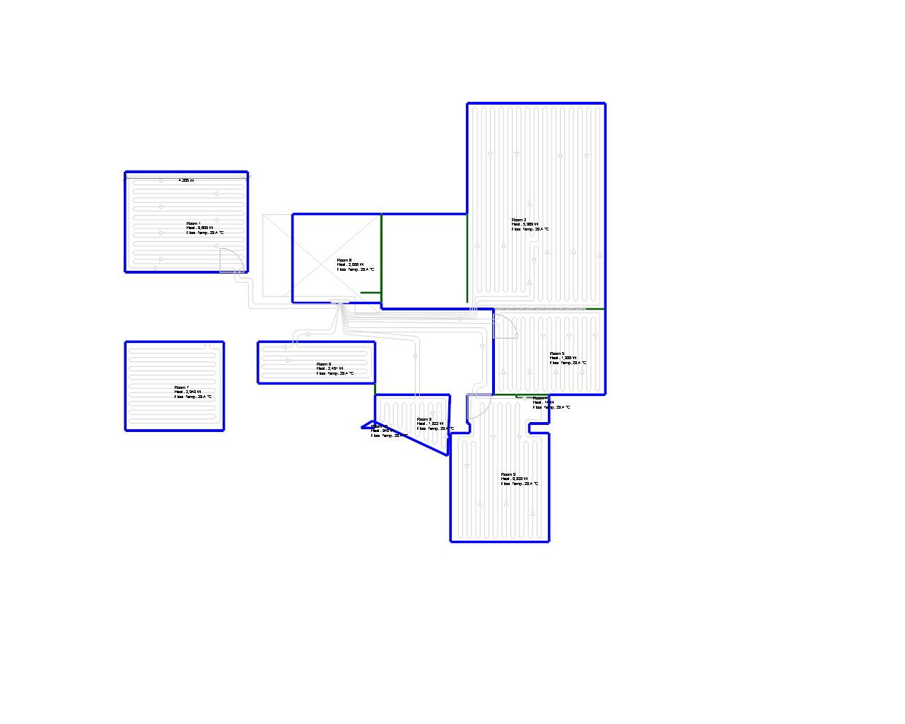

PeterW Posted March 20, 2017 Share Posted March 20, 2017 I've done 400m off one 5 port manifold and the issue you have is that the manufacturers like to quote at low deltaT so they don't get caught out with not enough heat being available. Persevere with LoopCad and it's excellent - mine were accurate to within 10m overall and I used the Wunda trays. Zip tying to mesh will be pretty easy if you can space to the mesh size. Is it ASHP or gas boiler ..? Link to comment Share on other sites More sharing options...

oranjeboom Posted March 21, 2017 Author Share Posted March 21, 2017 On 3/20/2017 at 14:40, PeterW said: Persevere with LoopCad and it's excellent - mine were accurate to within 10m overall and I used the Wunda trays. Zip tying to mesh will be pretty easy if you can space to the mesh size. Is it ASHP or gas boiler ..? Had another attempt last night. Just managed to lose the flamin' background floor plan somehow.....grrrrr! Not pretty, but I can see at least see where the metrage is going. Longest loop appears to be the living room areas as expected, but the dining room circuit could extend into the lounge area. Or potentially add an extra circuit in the lounge/garden room areas. Changed my mind from ASHP to gas boiler. Potentially do that later when the house has convinced me it's good enough for an ASHP! On 3/20/2017 at 14:54, Nickfromwales said: I bolted two manifolds together ( 7 + 5 ), one pump one TMV / blender set with no issues, in a draughty poorly insulated house with 2.9m ceiling height. Didn't have enough space to put one long manifold in so just joint them with bent irons so the manifold went around the corner of the cupboard under the stairs. ? At least 5 loops were just short of 100m and one was around 130m. Worked like a dream. 130m? That sounds somewhat reassuring then with my longest around 117m, unless I can get Wunda to re-look at their design. On 3/20/2017 at 16:37, ragg987 said: On the pipe spacing, it is a balance you need to strike. With 200mm spacing you need the flow to be hotter than with 150mm to emit the same amount of heat. Of course 100mm will allow you to run cooler. With an ASHP, cooler is more efficient. Why not 100mm? A bit like asking why not target U-value of 0.05 instead of 0.1 - diminishing returns at some point. Also, the pipe loop-back with 100mm spacing would bell out, with 150mm spacing it is more comfortable. Yeah, hoping 150mm should suffice, especially with a boiler at this stage, maybe an ASHP in future. Link to comment Share on other sites More sharing options...

oranjeboom Posted April 12, 2017 Author Share Posted April 12, 2017 Just now, PeterW said: Two manifolds can be joined with a couple of brass elbows. You can go round a corner then .... The problem I had was they they were charging approx £350 more for having two manifolds in the first place. But that was for having two of them in different locations in the house (see plan at very top). Cupboard is about 800 x 350 (internal dims) so can't go 'round a corner', but potentially could have one above another. Would that still require 2 pumps, or could I have 1 operating both in this configuration? Link to comment Share on other sites More sharing options...

Nickfromwales Posted April 12, 2017 Share Posted April 12, 2017 33 minutes ago, oranjeboom said: But now the flamin' designers have realised that my existing hallway cupboard is not long enough to fit the 12 port manifold (905mm). I'm about 100mm short. Designers, eh? ? So, can we assume they have already suggested separating the pump and blender from the rails? Link to comment Share on other sites More sharing options...
oranjeboom Posted April 12, 2017 Author Share Posted April 12, 2017 4 hours ago, Nickfromwales said: Designers, eh? ? So, can we assume they have already suggested separating the pump and blender from the rails? 900mm is just for the manifolds I think, and does not even include the pump and blender!! Will confirm that tomorrow though. Link to comment Share on other sites More sharing options...

PeterW Posted April 13, 2017 Share Posted April 13, 2017 An 8 port and a 4 port in tandem will fit with elbow on the corner - that shouldn't need much engineering to fit it and will be simpler than trying to cross over multiple pipes if they are above each other. 1 Link to comment Share on other sites More sharing options...
oranjeboom Posted April 13, 2017 Author Share Posted April 13, 2017 3 hours ago, PeterW said: An 8 port and a 4 port in tandem will fit with elbow on the corner - that shouldn't need much engineering to fit it and will be simpler than trying to cross over multiple pipes if they are above each other. Not even sure that would fit. At the moment I have approx 800mm x 400 in the cupboard. Need to ring them and see. Another thought I had was to use the manifold that I will have upstairs (for 2rooms and a hallway) and increase that from a 3port to say a 7 port to feed some of the downstairs rooms. Means I would only need an 8 port manifold downstairs. Main concern would be the extra pressure on the upstairs manifold pump if it's feeding some of the loops downstairs. Link to comment Share on other sites More sharing options...
Nickfromwales Posted April 13, 2017 Share Posted April 13, 2017 Ok. Thinking cap on ? Have the pump and blender then a 5 port manifold. Take irons ( brass fittings ) out the ends of both tails, perform a 180 turn and fire back into a 7 port manifold directly in front of the 5. That should stop the second manifold short of the pump bleed screw and leave you enough room to dismount the pump for replacement. Get your plumber to use all compression fittings on the flow and return pipework, gate valves as soon as the F&R enters the cupboard and a drain off cock so you can easily remove the lot in minutes with just a spanner and screwdriver. ? Sorted. Link to comment Share on other sites More sharing options...
