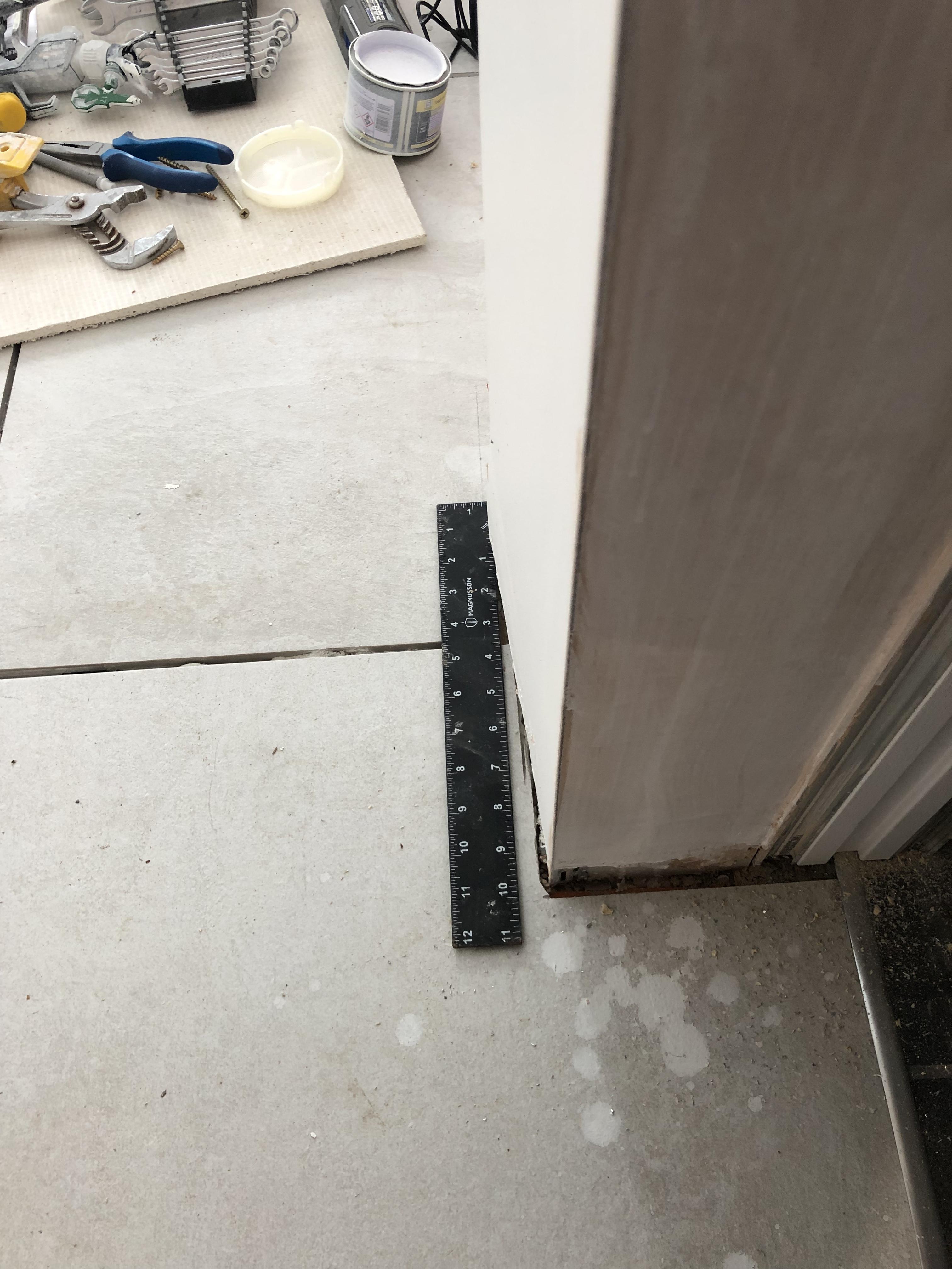

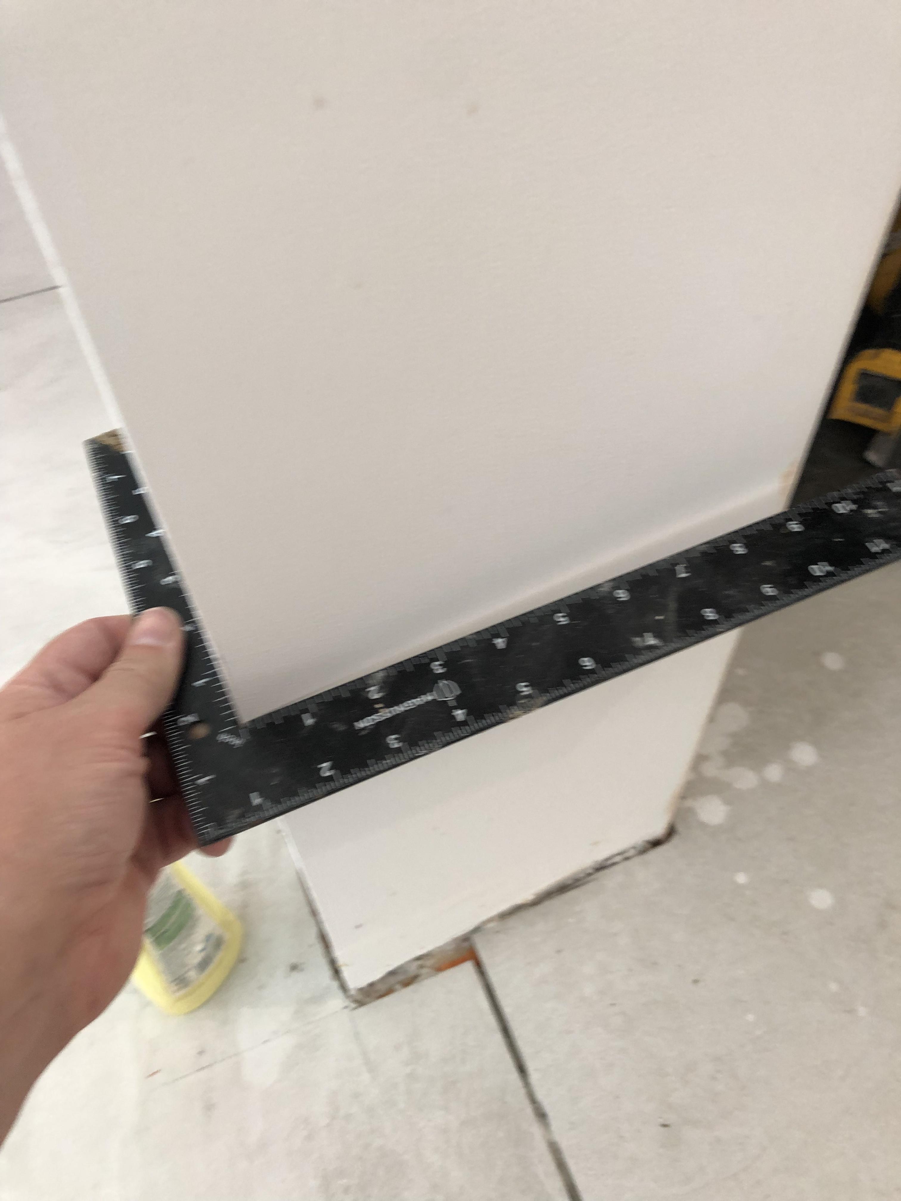

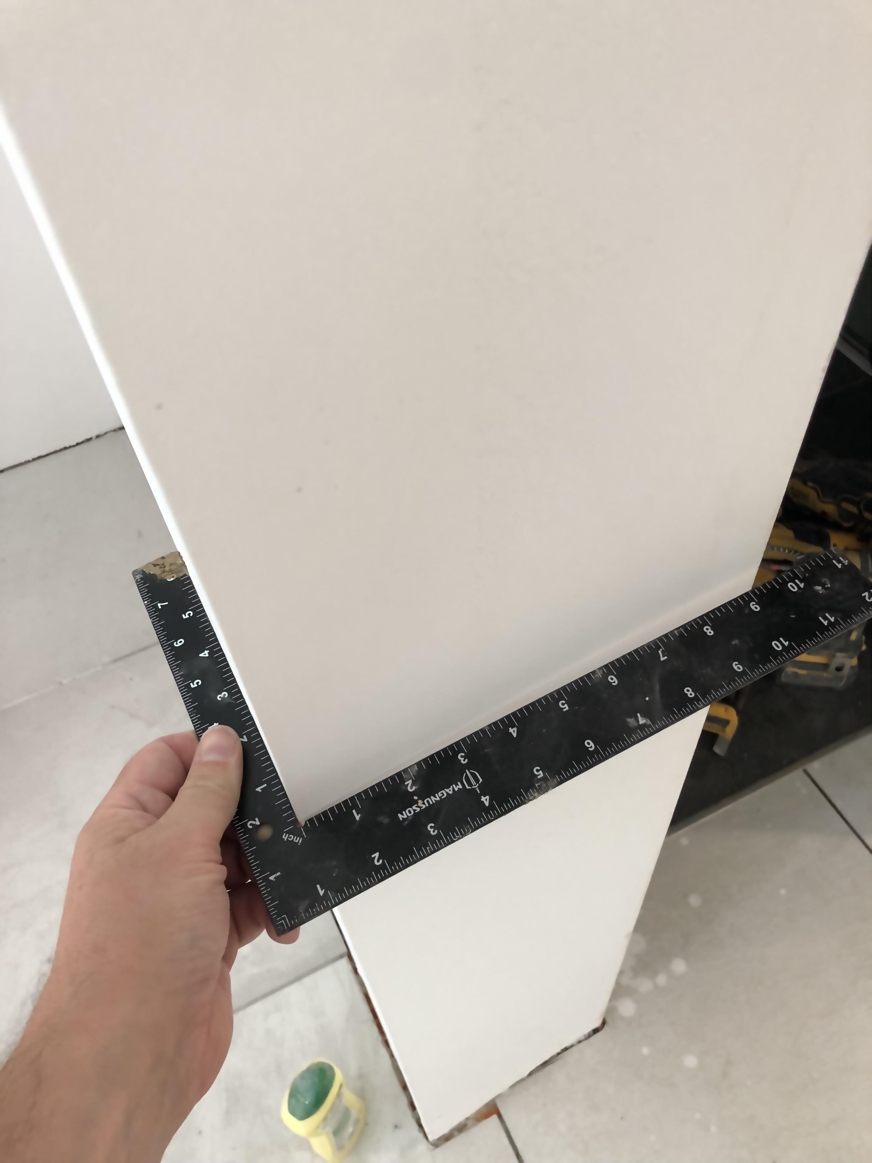

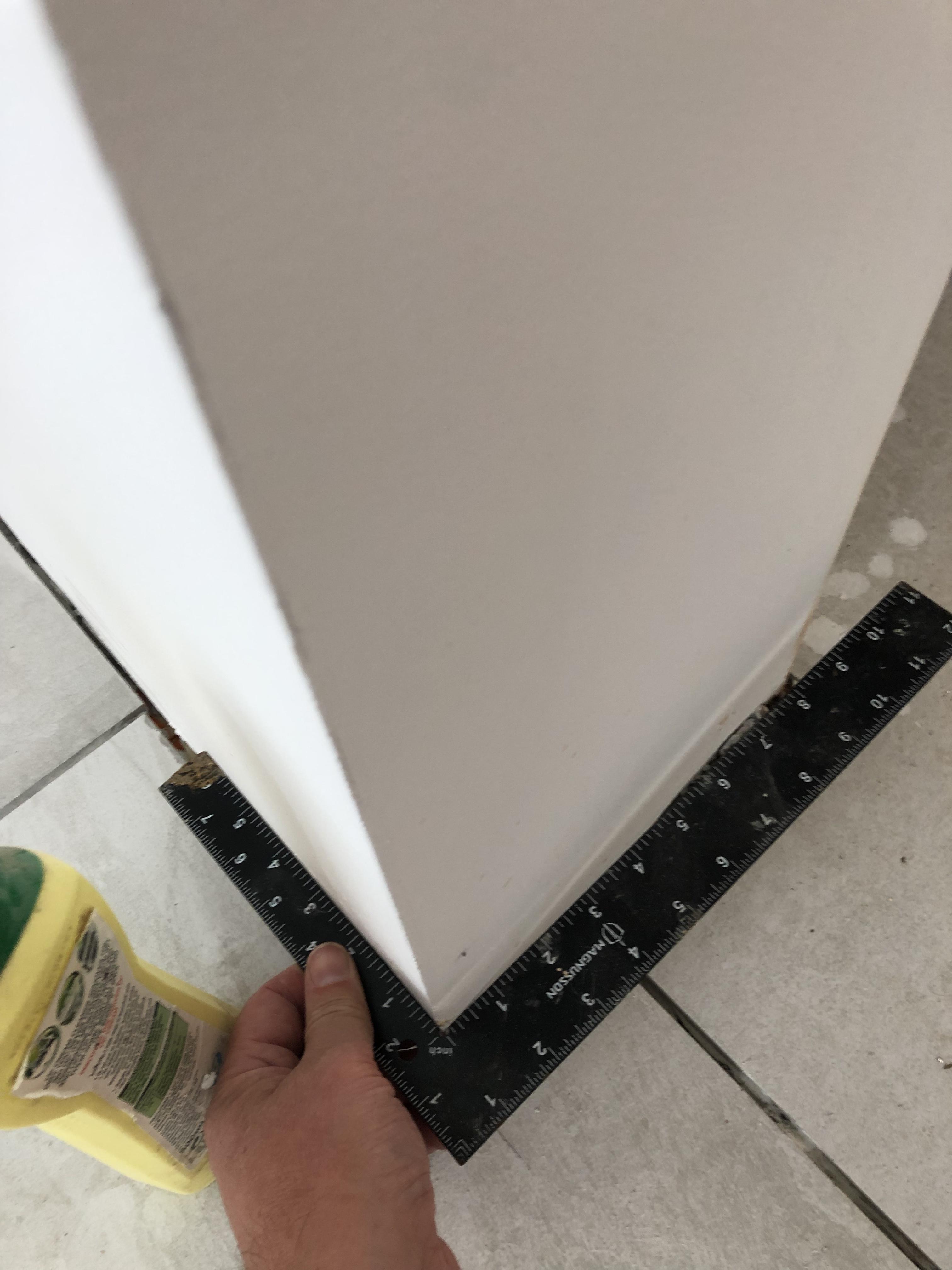

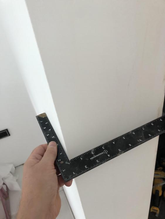

Pocster Posted July 31, 2021 Posted July 31, 2021 I did the boarding and whilst a bit out I can’t believe I was this far out . As you can see the square corner twists as it gets lower to the floor . As I plan an upstand tile at the base it will either be on the piss or have a chunky 10mm gap at one end . If I leave this can a plasterer fix this ? I.e straighten the edge and blend in ? . As said at least 10mm out at the base ; too much for a plasterer to correct ?

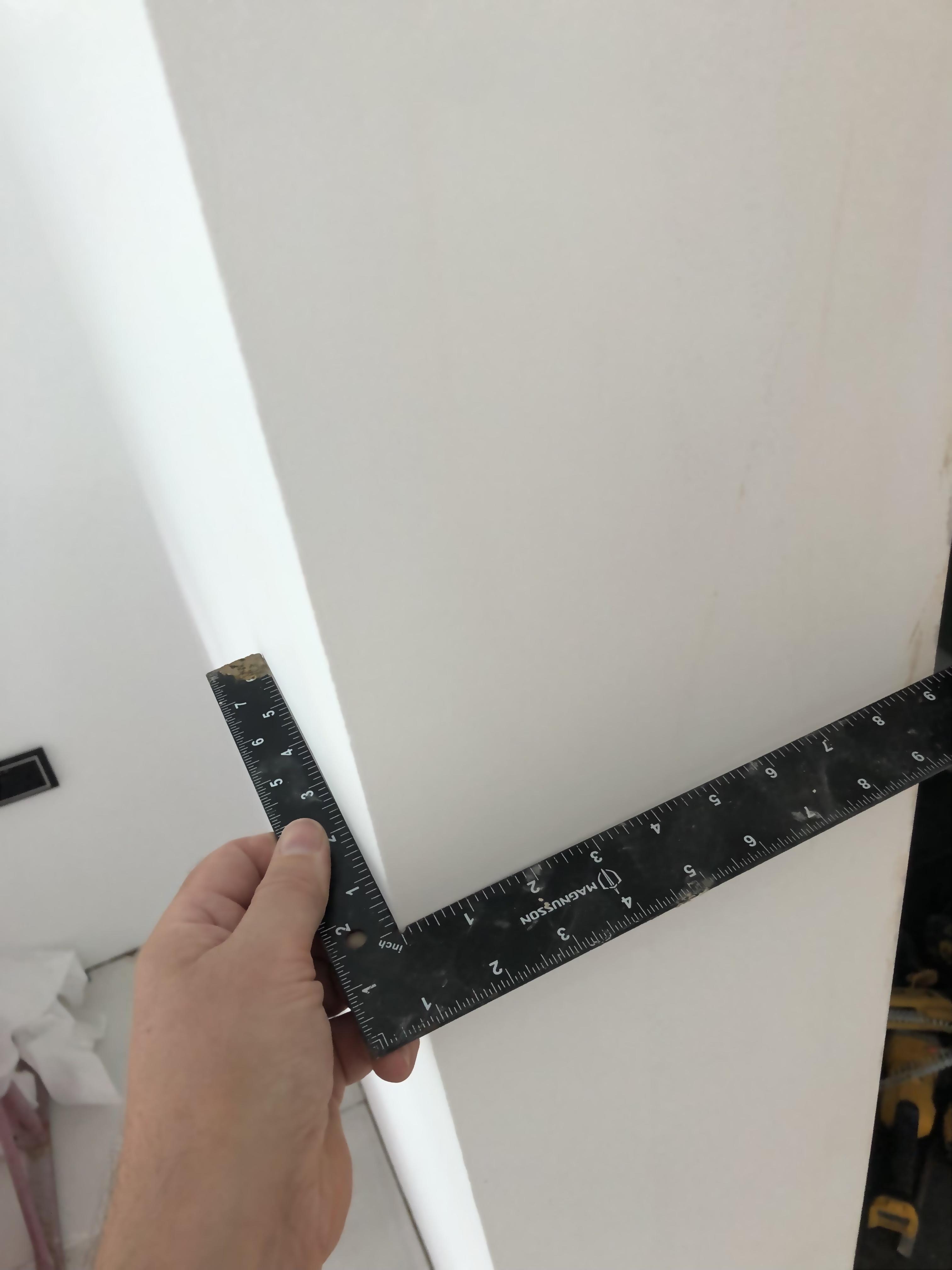

Pocster Posted July 31, 2021 Author Posted July 31, 2021 Better photo showing how far out at the base
joe90 Posted July 31, 2021 Posted July 31, 2021 I would be tempted to knock the beading off this corner and re set it correctly square and fill the majority with bonding and get a new skim put on. But @nod will be along shortly to tell you the correct way to do this ?
ProDave Posted July 31, 2021 Posted July 31, 2021 The lesson from this is check it is square BEFORE the plasterer comes.
Big Jimbo Posted July 31, 2021 Posted July 31, 2021 Get that sorted you rough git. if you dont that is going to bug you forever. IMO to big to leave buddy. 1 1
nod Posted July 31, 2021 Posted July 31, 2021 If you ask him to pleeeease bed the bed bead It will take him an extra 10 minutes to square it up
Pocster Posted July 31, 2021 Author Posted July 31, 2021 18 minutes ago, nod said: If you ask him to pleeeease bed the bed bead It will take him an extra 10 minutes to square it up So just let the plasterer do it ? Nothing for me to do ? ?
Pocster Posted July 31, 2021 Author Posted July 31, 2021 28 minutes ago, ProDave said: The lesson from this is check it is square BEFORE the plasterer comes. It was . Plasterer changed it ?
ProDave Posted July 31, 2021 Posted July 31, 2021 7 hours ago, pocster said: It was . Plasterer changed it ? Well make him un change it then? 1
Pocster Posted July 31, 2021 Author Posted July 31, 2021 12 minutes ago, ProDave said: Well make him un change it then? He’s long gone . Booked up now until next year ! . When I need more plastering I’ll get it fixed then .

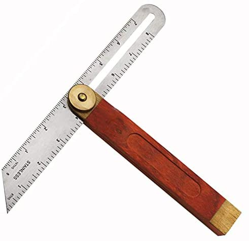

Onoff Posted August 1, 2021 Posted August 1, 2021 Get yourself a couple of bevel gauges in different sizes, for this sort of thing for sure. Very useful.
Pocster Posted August 1, 2021 Author Posted August 1, 2021 7 minutes ago, Onoff said: Get yourself a couple of bevel gauges in different sizes, for this sort of thing for sure. Very useful. No need now. All corners done. I'll get plasterer to fix it next time he's in
