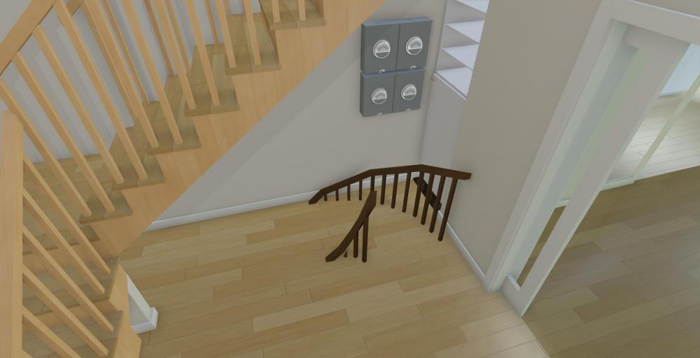

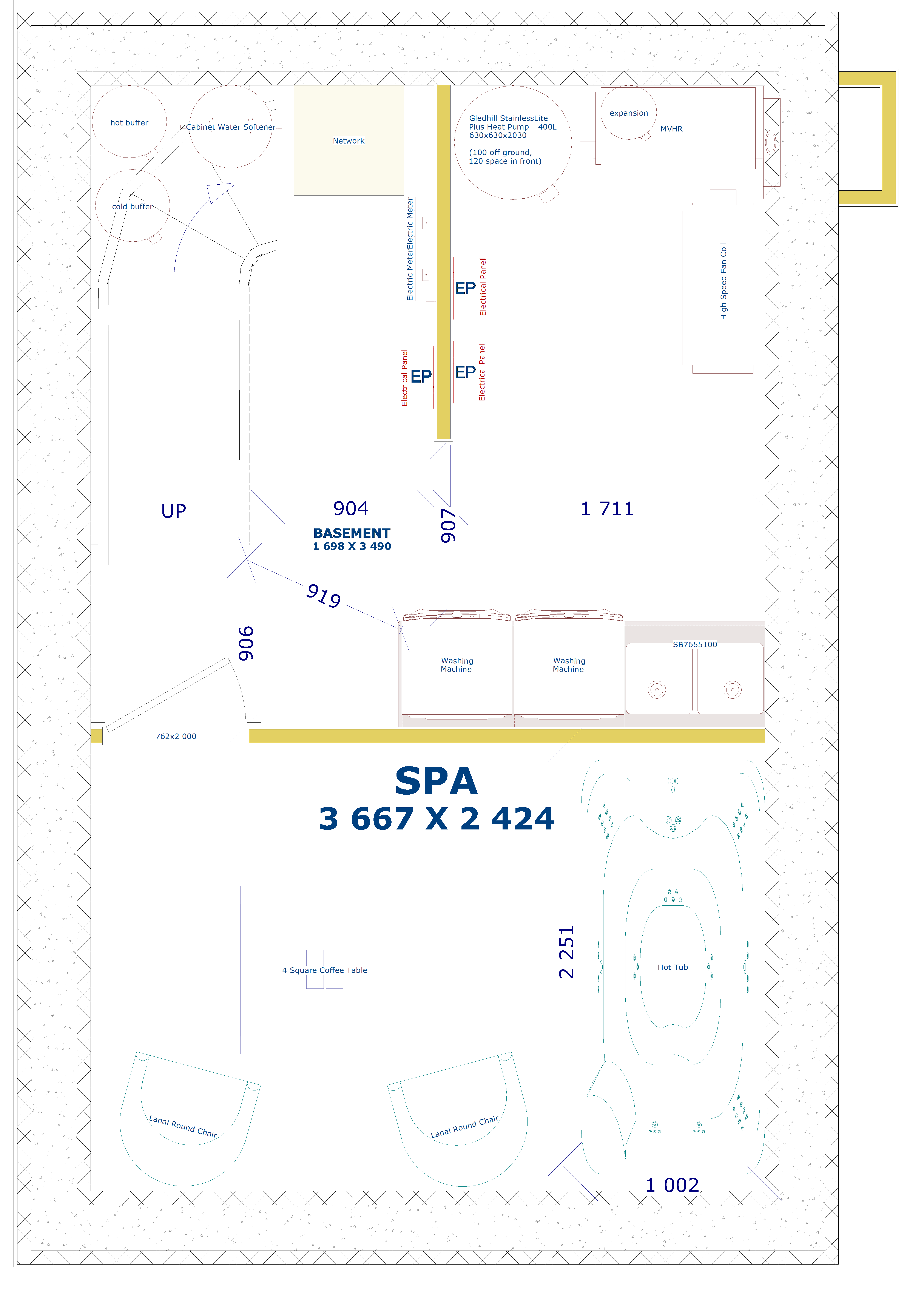

puntloos Posted July 28, 2021 Share Posted July 28, 2021 Is there some way to work out which type of stairs can fit which types of furniture? I've never seen some easy way to predict if a "standard couch" can go up a spiral staircase, for example. My current conundrum is that I am tempted to put a hot tub in some spare basement space, where the stairs are 1m wide. (in the current design!) Of course I can put the tub in before sealing up the basement somewhat but what if it springs a leak or gets embarassingly grotty? How can I be 'reasonably sure' that I can get it out? (note, this is an 'under stairs' stair, so the right wall is just a flimsy wall that can be taken out.. my *hunch* is it should be doable.. or? Link to comment Share on other sites More sharing options...
Bitpipe Posted July 28, 2021 Share Posted July 28, 2021 14 minutes ago, puntloos said: Is there some way to work out which type of stairs can fit which types of furniture? I've never seen some easy way to predict if a "standard couch" can go up a spiral staircase, for example. My current conundrum is that I am tempted to put a hot tub in some spare basement space, where the stairs are 1m wide. (in the current design!) Of course I can put the tub in before sealing up the basement somewhat but what if it springs a leak or gets embarassingly grotty? How can I be 'reasonably sure' that I can get it out? (note, this is an 'under stairs' stair, so the right wall is just a flimsy wall that can be taken out.. my *hunch* is it should be doable.. or? Good luck with that, they are usually craned into position - unless it's a very lightweight bath with spa jets. If you have straight stairs you may stand more of a chance but curved are always tricky to navigate furniture through. If you're having wet services, what's your plan to get waste water to ground level? Sump & pump. Link to comment Share on other sites More sharing options...
puntloos Posted July 28, 2021 Author Share Posted July 28, 2021 (edited) 20 minutes ago, Bitpipe said: Good luck with that, they are usually craned into position - unless it's a very lightweight bath with spa jets. Good point. The one I had in mind - https://www.thehottubwarehouse.co.uk/product/the-bliss/?sfw=pass1627298380 - is 150kg dry weight, 5000 quid. Will 4 burly guys/gals be able to do this? Will my stairs actually hold 4 burly guys and a 150kg bath? Quote If you have straight stairs you may stand more of a chance but curved are always tricky to navigate furniture through. Absolutely true. Quote If you're having wet services, what's your plan to get waste water to ground level? Sump & pump. Yep, full sumppump system planned anyway , not in the least because also the chiller coil, washing machines need it. Edited July 28, 2021 by puntloos Link to comment Share on other sites More sharing options...

Bitpipe Posted July 28, 2021 Share Posted July 28, 2021 15 minutes ago, puntloos said: Will my stairs actually hold 4 burly guys and a 150kg bath? This is your issue. Our stone baths were 180kg each. The temp MDF stairs were held up with 4 screws at the head. I ended up using a genie lift to get them to first floor level and even that was a bit heart stopping at times. 1 Link to comment Share on other sites More sharing options...
Pocster Posted July 28, 2021 Share Posted July 28, 2021 2 minutes ago, Bitpipe said: Our stone baths were 180kg each. The temp MDF stairs were held up with 4 screws at the head. 5 screws you would of been ok ? Link to comment Share on other sites More sharing options...
Bitpipe Posted July 28, 2021 Share Posted July 28, 2021 14 minutes ago, pocster said: 5 screws you would of been ok ? No doubt. Problem was basement stairs were directly underneath and similarly braced so would have been a 2 floor drop Link to comment Share on other sites More sharing options...
Ferdinand Posted July 28, 2021 Share Posted July 28, 2021 TBH that's the same size as a normal 3 person sofa. I'd design in a removable piece of floor, with a hook above. Link to comment Share on other sites More sharing options...
puntloos Posted July 28, 2021 Author Share Posted July 28, 2021 1 hour ago, Ferdinand said: TBH that's the same size as a normal 3 person sofa. I'd design in a removable piece of floor, with a hook above. The tricky part there is that our hallway (that goes alll the way up) is above. I suppose..... that doesn't *necessarily* have to be a problem to have the winch be 8 metres ... hm. Are there stairs that can have a piece "easily" removed? Or would you recommend 'middle of the hall'? Link to comment Share on other sites More sharing options...

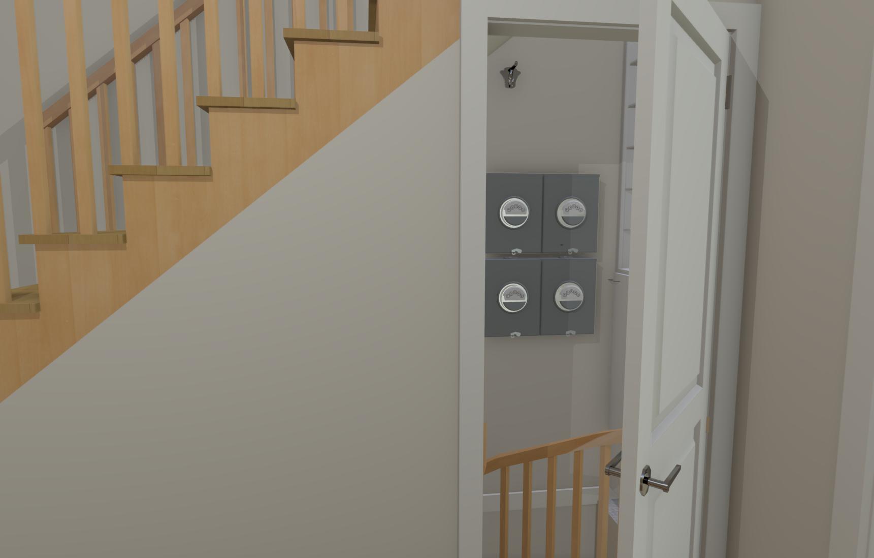

DevilDamo Posted July 28, 2021 Share Posted July 28, 2021 Any reason why the door to the Spa doesn’t open inwards as in its current position, will not comply? Link to comment Share on other sites More sharing options...
puntloos Posted July 28, 2021 Author Share Posted July 28, 2021 24 minutes ago, DevilDamo said: Any reason why the door to the Spa doesn’t open inwards as in its current position, will not comply? No reason, amateur design on my part. Are you saying regulations are not ok with this? Link to comment Share on other sites More sharing options...
DevilDamo Posted July 29, 2021 Share Posted July 29, 2021 9 hours ago, puntloos said: No reason, amateur design on my part. Are you saying regulations are not ok with this? Your 906 dimension needs to increase to 1162 as that would then provide you with 400mm clearance between the face of the stair and leading edge of the door. Alternatively, change the door so it opens into the Spa. Link to comment Share on other sites More sharing options...
