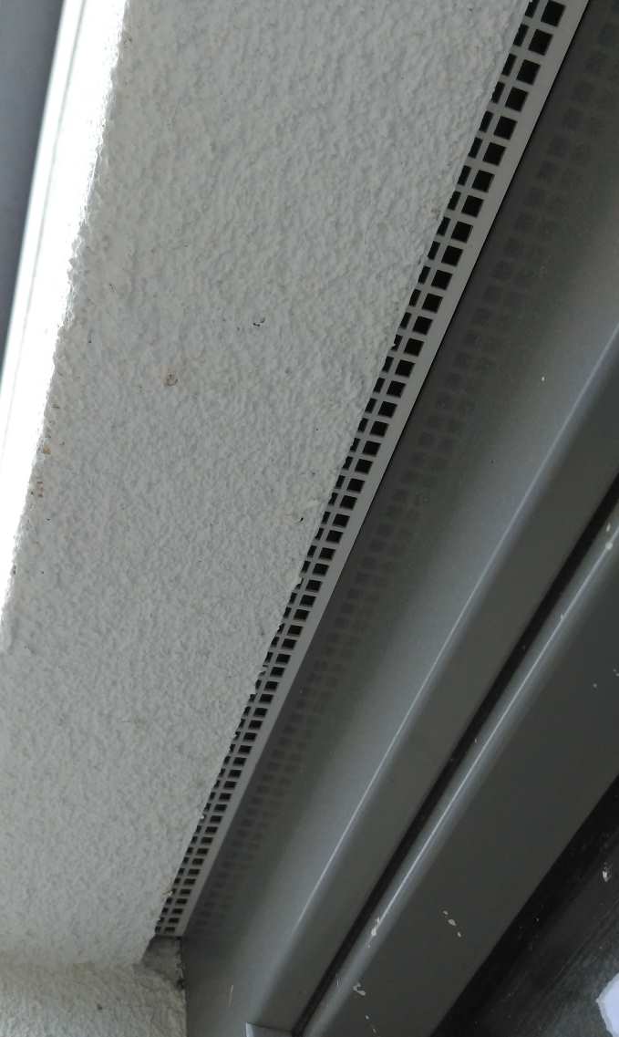

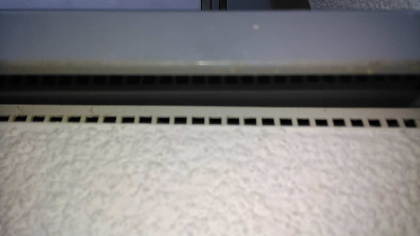

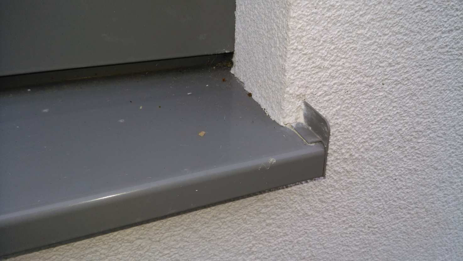

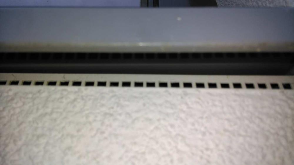

Do factor in the price - I was surprised (unpleasantly so) at how expensive it is. Love the look, though.
The detailing should be done with your render system supplier - each one seems to be slightly different, however attached ours. The fuzzy image (no 3) shows detail under the aluminium cill.
window headwindowcill.thumb.jpg.31faa442c593eaa1f4981db1640fa7e2.jpgbelowcill.thumb.jpg.7fa6c5dc0cf8265fa79e89ff768cd56e.jpgbrickslips.thumb.jpg.54c63f594178376ec75e46a2a763efa7.jpg

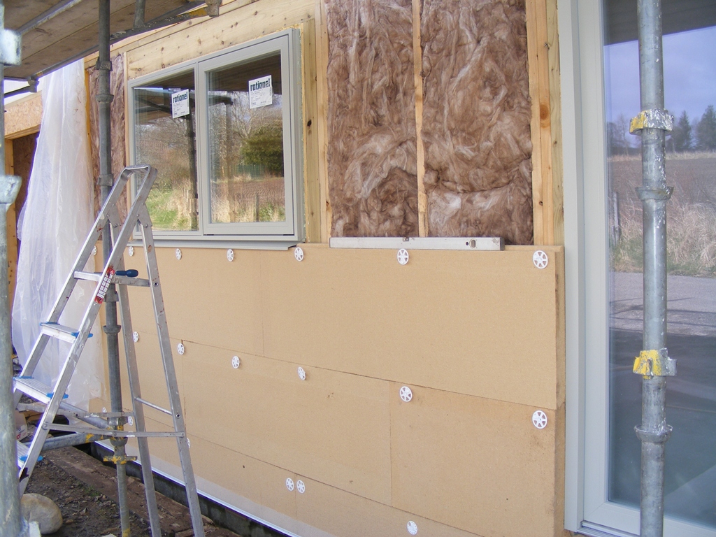

I didn't want a block outer skin. I wanted the whole wall make up to add to the buildings insulation. Hence why I settled on100mm thick wood fibre board. I guess I am lucky I don't need a mortgage, and not planning to sell in a hurry.
One advantage of the wood fibre system is there is no cavity, so no need for weep ventilators no expansion joints.
The window detail seems to some extent be a local thing. Up here they almost never continue the rough cast top coat into the ingo's, instead leaving those just finished with the base coat. I did insist my garage door ingo's which are much deeper were done with the top coat.

Brick plus cavity =150mm thick for almost no contribution to insulation.
Wood fibre board applied direct to (thicker than normal in my case)  timber frame =100mm thick, and adds more insulation to the building. The lack of cavity and hence need to ventilate it will also make the structure more inherently air tight.
Battens, counter battens and render board is probably not a lot thinner than the wood fibre board, and does not add the the insulation. Plus, like the block or brick skin needs vents and expansion joints.
This was a technique we saw in one German kit-house supplier. Quite a neat solution. We decided to go with MBC in the end and played safe with having the cavity as per TRADA recommendations rather than risk warranty issues at a later date. Our MBC house external walls were not level enough to fix fibreboard tight to the timberframe - we had to use spacers (you can see this in the image I posted earlier) beneath the battens to achieve a square face to render on. Don't know if this is typical or just our build.
Link to comment
Share on other sites
Our Timber Frame was perfectly flat enough to fix the wood fibre direct to it with long screws and big plastic washers (the pictures just shows a few scres, a lot more were added later)
