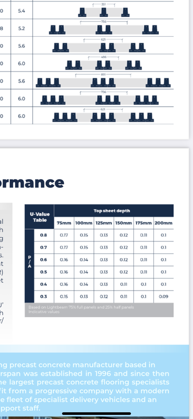

DragsterDriver Posted July 20, 2021 Share Posted July 20, 2021 Morning! can anybody advise on my block and beam- what U value i need? not a passiv house but very well insulated timber frame with underfloor heating https://www.floorspan.co.uk/efloor-plus/system-overview/ Thanks! Link to comment Share on other sites More sharing options...
Russell griffiths Posted July 20, 2021 Share Posted July 20, 2021 If you allow more height in your build up you can use a cheaper insulation design it in now. If I was doing mine again I would have 250mm of eps. I have 200mm now. It’s cheap as chips compared to pir insulation. Buy direct from the factory, eps 100 not the flimsy stuff you find in wickes. 2 Link to comment Share on other sites More sharing options...
DragsterDriver Posted July 20, 2021 Author Share Posted July 20, 2021 That’s what I was thinking! That floorspan system is eps so 200mm is their biggest. Link to comment Share on other sites More sharing options...

Buzz Posted July 20, 2021 Share Posted July 20, 2021 5 hours ago, DragsterDriver said: Morning! can anybody advise on my block and beam- what U value i need? not a passiv house but very well insulated timber frame with underfloor heating https://www.floorspan.co.uk/efloor-plus/system-overview/ Thanks! Took the advice of many on here and designed in 3 course's of brick above the beam floor to give 175 eps and 50mm flow screed , sap calcs show a u value of .12 . Used floorspan for the block and beam floor no issues 3 week turnaround from order to delivery. 2 Link to comment Share on other sites More sharing options...

Scoobyrex Posted July 21, 2021 Share Posted July 21, 2021 (edited) 1 hour ago, DragsterDriver said: Soon find out! I just received my floorspan quote using the 200mm EPS infills, it is £200 cheaper than using concrete blocks, I can use thinner PIR ontop saving another £1300 and have a higher U value by 0.1. Delivery I was quoted was 5-6 weeks I think the costs difference has somewhat todo with the current concrete block price. The only downside is the polystyrene infills need protection from impacts during the build. Edited July 21, 2021 by Scoobyrex 2 Link to comment Share on other sites More sharing options...

Scoobyrex Posted July 21, 2021 Share Posted July 21, 2021 33 minutes ago, DragsterDriver said: the insulated ones should have a mesh embedded slap above- which I’ll put the underfloor in and power float before erecting the timber frame So you would mesh and screed, then add a membrane, PIR or EPS, underfloor heating then screed again. there goes the height and the cost savings. 1 Link to comment Share on other sites More sharing options...
Russell griffiths Posted July 21, 2021 Share Posted July 21, 2021 1 hour ago, Scoobyrex said: So you would mesh and screed, then add a membrane, PIR or EPS, underfloor heating then screed again. there goes the height and the cost savings. Nope.beams, infilled with insulated blocks, insulation board, mesh, ufh pipes, concrete topping , not screed. I would have done this but but it was a couple of grand dearer, being that insulation was dear and blocks cheap. Funny how its changed. 1 Link to comment Share on other sites More sharing options...
