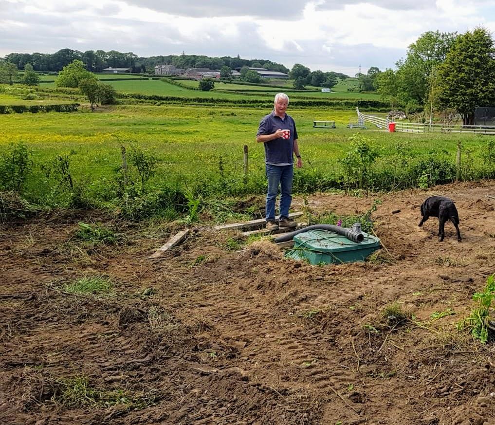

cbk Posted July 15, 2021 Posted July 15, 2021 Looking for a bit of guidance on choice of Septic Tan and whether i need a vent pipe.. I've already installed the drainage field as pic and this includes a vent pipe on plot boudary at the lowest point. There will also be a vent pipe on main soil stack to house. So my question is do I also need to attach a vent pipe to the Septic Tank? Or is there a brand of tank that will allow airflow through the tank using my existing vents? Max occupancy will be 8 people for christmas etc. but regularly there will only be 2 people. I think the recommended tank size would be around 3750 - 4000 litres and it needs to be a low profile type to minimise excavation as site is on shale with limited topsoil. Any recommendations on which brand is most suitable would be much appreciated.

IanR Posted July 15, 2021 Posted July 15, 2021 (edited) 26 minutes ago, cbk said: Local BCO has approved a Septic Tank, so do not intend to go down the STP route. Have you met the General Binding Rules? https://www.gov.uk/guidance/general-binding-rules-small-sewage-discharge-to-the-ground It's more difficult with a Septic Tank. It comes down to whether the system and leach field is designed to British Standard BS 6297:2007. What's made you go with a septic tank rather than a small treatment plant? Edited to add: Do you know that water table will never rise up to the surface in the area of the leach field, even temporarily after heavy rain? You could have raw sewage coming up to the surface if it does. Edited July 15, 2021 by IanR

jack Posted July 15, 2021 Posted July 15, 2021 Discharging sewage onto a slate base with minimal topsoil cover? I suppose your garden will grow well! 2
saveasteading Posted July 15, 2021 Posted July 15, 2021 The rules re septic tank discharge are rightly more onerous, but there is no reason why the further digestion should not occur in the drainage beds, which are larger anyway. However my own preference is to use a more sophisticated treatment tank. It is basically a septic tank with more chambers and bubbles. They are not that much more expensive if you shop around. Of course there is the running cost of electricity, but against that, there is much better digestion and less frequent need to de-sludge. And 20% less soakaway to build, and reduced risk of problems if the tank gets heavy use at any time.

saveasteading Posted July 15, 2021 Posted July 15, 2021 There are some that have a big wheel sploshing round. Most just have an air pump, like in a goldfish tank, to keep the contents moving and break the surface. if there is any noise it will likely be a buzz from a loose support.. Have used Marsh Industries in the past, because they are real and will speak to you. I especially liked that their tanks are shallow. This makes it very much easier and safer to install, without so much worry of hole collapse. I see that hydroclear now does shallow ones too, also at around £2,000. they include a telescopic shaft to the cover which i will be looking into. Septic tank maybe £700 cheaper? Does anybody know if a septic tank requires an outlet inspection chamber, as for treatment tank? Can't see why it should not.
PeterW Posted July 15, 2021 Posted July 15, 2021 2 hours ago, saveasteading said: Does anybody know if a septic tank requires an outlet inspection chamber, as for treatment tank? Can't see why it should not. No - the reason is the leach field is a secondary treatment location unlike a soakaway for a treatment tank which releases water of much higher quality.
saveasteading Posted July 16, 2021 Posted July 16, 2021 I thought the tank was so that a test of quality could be taken, and so that should apply to both. The liquid after a treatment tank is going to be much better quality than from a septic tank. However, I can see that will matter even more if discharging to water course. OR, can I use a leach field for a treatment tank, instead of a soakaway, and avoid the test chamber? That will surely be the best of all, in dealing with any occasional overload.
saveasteading Posted July 18, 2021 Posted July 18, 2021 Currently reading all the rules, in both the Scottish and England and Wales versions. I see that both septic tanks and package treatment plants needs sampling and inspection access at both inlet and outlet. see Document H2 , clause 1.23 This then refers to H1, 2.48 which implies that an ordinary inspection chamber suffices. result! or result? But the Scottish document requires this. Therefore it is possible that this is also expected in England and Wales, and they are still available to buy as an expensive (£300) 'thing'.
