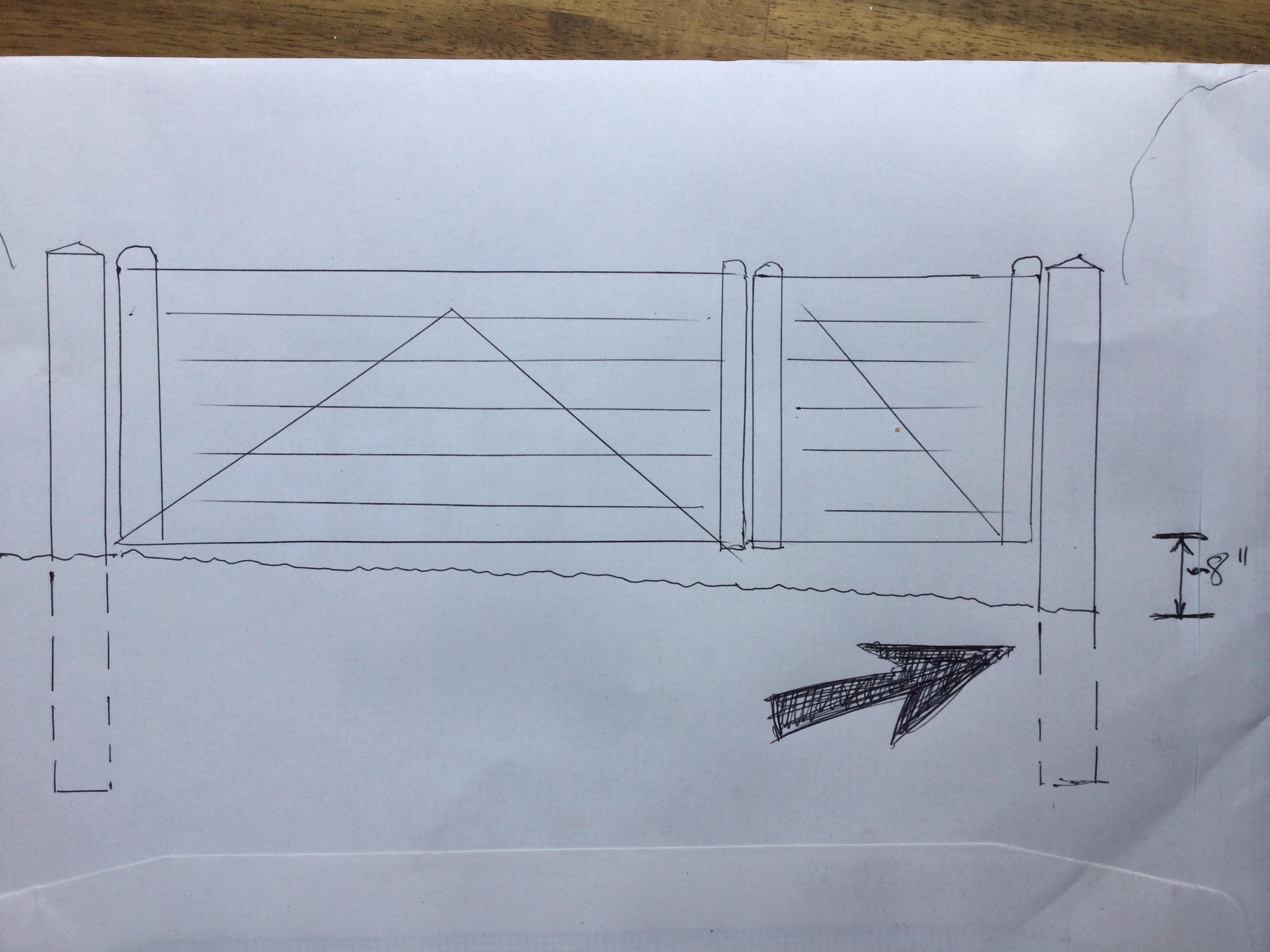

zoothorn Posted August 3, 2021 Author Posted August 3, 2021 Chaps if you could help. Im back grappling with the problem, if it is a problem, of the sloped drive. The slope across the gate. On my higher side, the longer 8' gate will hang from the post, so here the post can go into ground the correct depth. I can effectively do this. But I need to start from the other post 1st.. problem arises: So this lower side, with the gap that will have to be below the shorter 4' gate, the post it hangs from of course will have to be (approximately) 8" set higher. Because of the slope, in order to get the gates level. The gap underneath is no concern at this juncture. What is troubling me is therefore, the depth of this post.. bc it'll have to be set into the ground 8" less. Now, I assume if these 6 x6" width shallow- pointy- topped posts, at 7ft long, will need to go into the ground 3ft. So my higher gate post, will therefore be 8" less. From my pov, I can see at least that this higher gate is the smaller one/ less weight upon this post. But even so, will it being set only 2ft 4" into the ground. Does anyone have any idea what Im talking about? Thanks, zh
zoothorn Posted August 3, 2021 Author Posted August 3, 2021 Diagram. Its the RHS post looking at it here, I need to start from.. because this gate is the most critical to position right up flat to the perpendicular hedge behind it. Thanks, zh
zoothorn Posted August 3, 2021 Author Posted August 3, 2021 @joe90 or @markc Hi chaps, I wonder if you could voice an opinion. I was just about to fly into town to get my posts, crack on start digging... but this connundrum occured to me, so I'm stuck not knowing how to proceed. IE do I need completely different posts? Or is my RHS one ok set in so 'shallow'? thanks zoot.
markc Posted August 3, 2021 Posted August 3, 2021 2 minutes ago, zoothorn said: @joe90 or @markc Hi chaps, I wonder if you could voice an opinion. I was just about to fly into town to get my posts, crack on start digging... but this connundrum occured to me, so I'm stuck not knowing how to proceed. IE do I need completely different posts? Or is my RHS one ok set in so 'shallow'? thanks zoot. Hi ya mate, how shallow is shallow? as it’s the small gate you don’t need a lot of depth as long as the ground I’d hard which I believe you mentioned digging through slate which would be good
joe90 Posted August 3, 2021 Posted August 3, 2021 As the shorter gate is fixed to the shallower post I do not think it’s a problem, just make sure you back fill with postcrete or something very solid. ?
zoothorn Posted August 3, 2021 Author Posted August 3, 2021 11 minutes ago, joe90 said: As the shorter gate is fixed to the shallower post I do not think it’s a problem, just make sure you back fill with postcrete or something very solid. ? Great, was hoping you'd say this or so.. panic over. Maybe I can set both post tip tops a few inches lower than usual, equal to each other I assume is 'correct', pinching every inch depth possible as it were. 11 minutes ago, markc said: Hi ya mate, how shallow is shallow? as it’s the small gate you don’t need a lot of depth as long as the ground I’d hard which I believe you mentioned digging through slate which would be good Hi markc, shallow.. well I guess 8" less set into ground than my ok LHS post. Just done a diagram before / above. I hope to fk I dont hit slate!! Ill have to get a pro in to help if so. It is clay tho.. so possibly helps solidity on this post, if not my dreaded dig me 'ole jobs. Thanks chaps, zh
