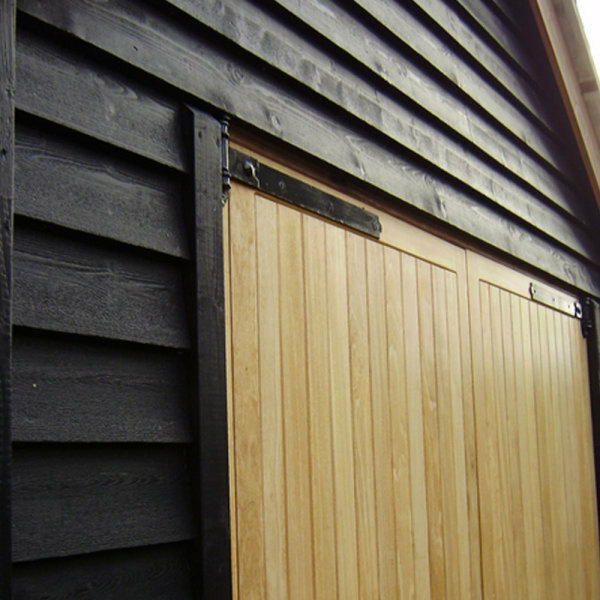

Ben100 Posted July 7, 2021 Share Posted July 7, 2021 Hi all, I'm looking to clad the outside of my timber frame extension, and was wondering where the best place to buy the timber was? Are you guys going to online companies or buying from local timber merchants? Cheers, Ben Link to comment Share on other sites More sharing options...
ToughButterCup Posted July 7, 2021 Share Posted July 7, 2021 Local. Pro Wood did us proud. Give Alex Wood 07881806650 and ask him if he knows someone local to you. We're just south of the Lakes. God's Own Country. Ian Link to comment Share on other sites More sharing options...
Roundtuit Posted July 7, 2021 Share Posted July 7, 2021 I bought Siberian larch from an on-line seller, based about 50 miles away. The price was great, quality was pretty average, and service was poor. I'd shop around and get samples. Local is nice, but if the timber is coming from Siberia, the last 100 miles is neither here nor there. Link to comment Share on other sites More sharing options...
SimonD Posted July 7, 2021 Share Posted July 7, 2021 8 hours ago, Ben100 said: Hi all, I'm looking to clad the outside of my timber frame extension, and was wondering where the best place to buy the timber was? Are you guys going to online companies or buying from local timber merchants? Cheers, Ben I think it depends on where you are and the local suppliers you've got access to and what species you're looking for. I bought my British Western Red Cedar from Cedar Direct they supply Canadian cedar too. I had good service and when my order was ready, I got a call from a yard with number telling me it was from Brecon. All very close to me. They do supply nationally. Link to comment Share on other sites More sharing options...
markocosic Posted July 7, 2021 Share Posted July 7, 2021 Look at it first. Familiarise yourself with 'what do did see' and 'what you might see' in terms of grade A/B and C etc. You want to avoid surprises! Link to comment Share on other sites More sharing options...
Ben100 Posted July 10, 2021 Author Share Posted July 10, 2021 Thanks all, I’m looking for feather edge cladding and to paint it black. It’s a common look around here in north Essex. As I’m painting it the actual look of the wood isn’t that important. I think I’ll go for Siberian larch as it’s hardy and inexpensive. Link to comment Share on other sites More sharing options...
Temp Posted July 10, 2021 Share Posted July 10, 2021 (edited) You can get it ready painted. I don't remember where we got ours from but 14 years later I've only just arranged for someone to repaint it. Edit: Buildbase sell ready painted but shop around.. https://www.buildbase.co.uk/timber-doors-sheet-material/pse-cladding/outdoor-cladding/pre-painted-sawn-featheredge-cladding-black-32x175mm-x-43m-100010914-2832383 Edited July 10, 2021 by Temp 1 Link to comment Share on other sites More sharing options...
Mr Punter Posted July 11, 2021 Share Posted July 11, 2021 On 10/07/2021 at 13:42, Ben100 said: I think I’ll go for Siberian larch as it’s hardy and inexpensive. I got some a few years ago from Vastern Timber. May be worth getting a quote. It is quite splintery so wear gloves. 1 Link to comment Share on other sites More sharing options...
Ben100 Posted August 11, 2021 Author Share Posted August 11, 2021 I have a quote from a local timber yard for 32x175 Black Painted Feather Edge 4.8mtr lengths @ £2.60MTR+VAT. Sounds pretty good! Link to comment Share on other sites More sharing options...
