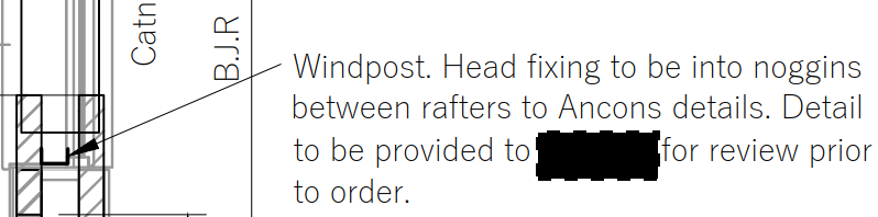

Moonshine Posted July 2, 2021 Posted July 2, 2021 I need a couple windposts in my build, I have never come across them before. From my googling they don't seem an off the peg purchase. Anyone got any ideas where I can get them and typical costs?

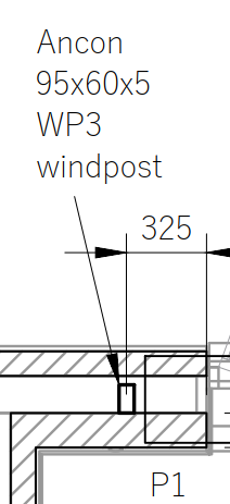

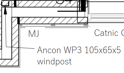

Moonshine Posted July 2, 2021 Author Posted July 2, 2021 3 hours ago, PeterW said: What’s the spec from the SEng..? This is what is on the drawings.
markc Posted July 2, 2021 Posted July 2, 2021 Ancon are based in Sheffield and supply a lot of specialist Stainless steel building products
Temp Posted July 2, 2021 Posted July 2, 2021 Looks like your SE has suggested a mix of C and box sections from them specifically. Lots of info on their site.. https://www.ancon.co.uk/products/windposts
PeterW Posted July 2, 2021 Posted July 2, 2021 All standard stuff then. You need to know a few bits of detail to order them but U.K. Lintels do them so why not bundle all your steelwork up for a price https://uklintels.com/product-range/windposts/
Mr Punter Posted July 2, 2021 Posted July 2, 2021 The Ancon stainless ones are expensive but decent spec. They seem to work by making them easy for the SE to specify and the builder to install. They have slots for wall ties and different top connection options. Once they are built in they act in tandem with the masonry. We have lots where there are just skinny piers between openings that would otherwise fail.
