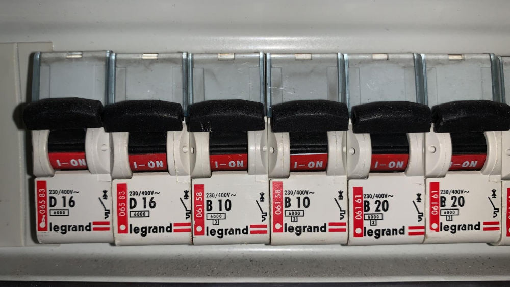

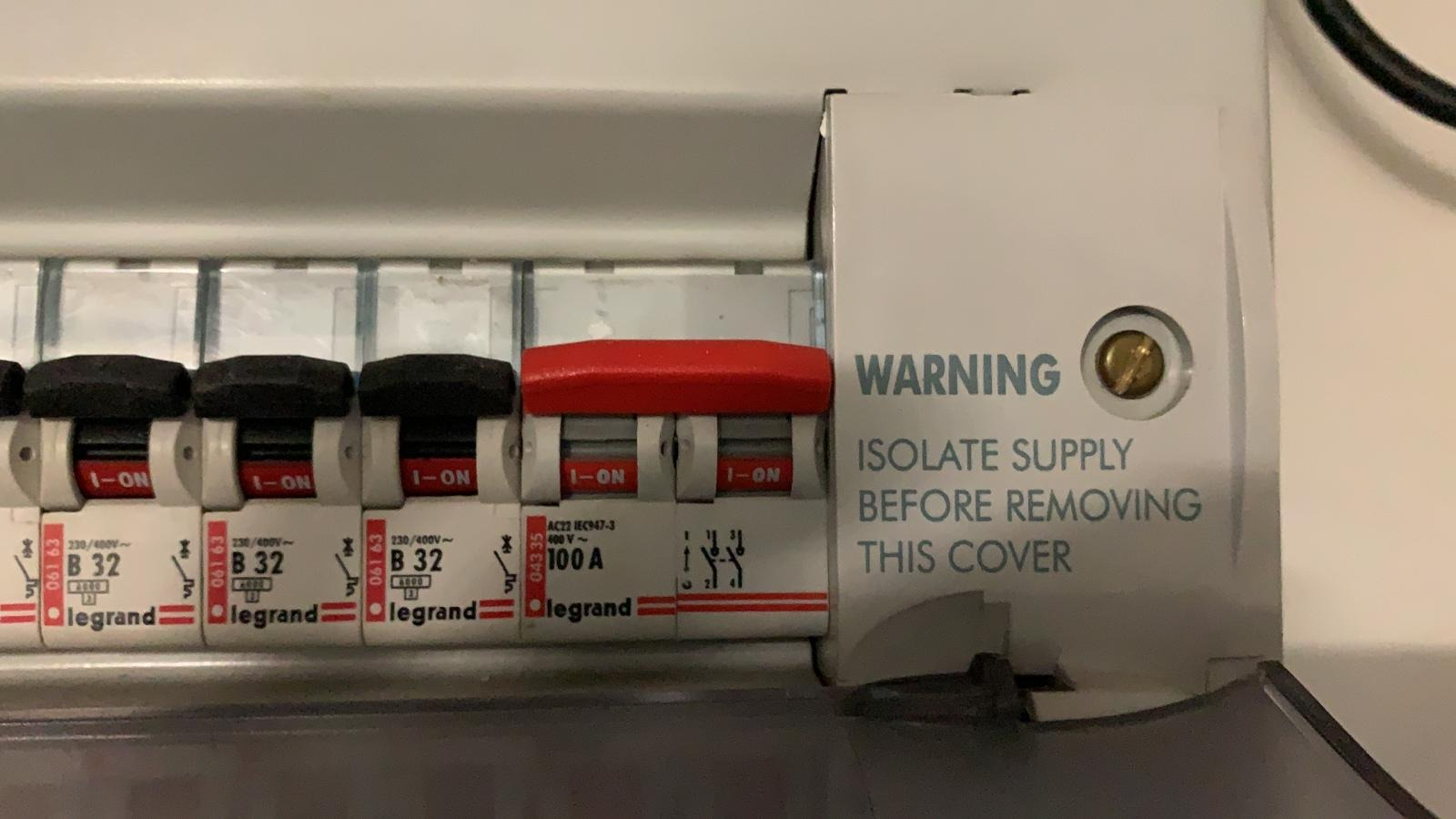

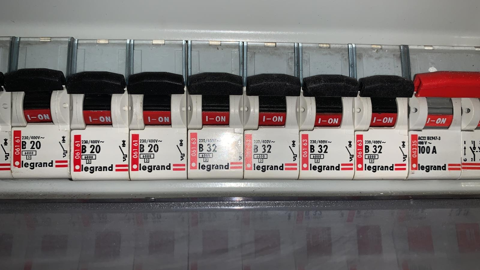

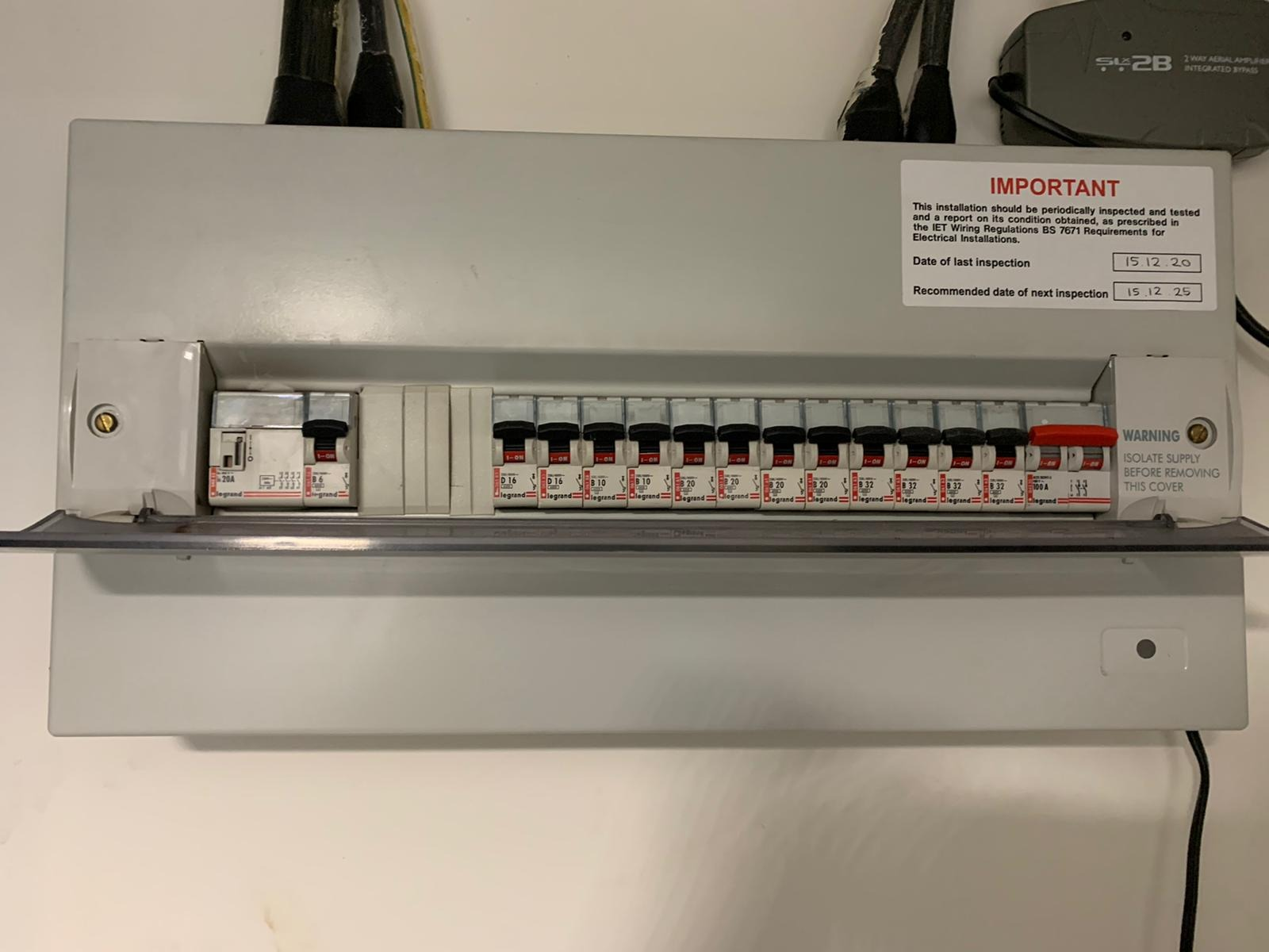

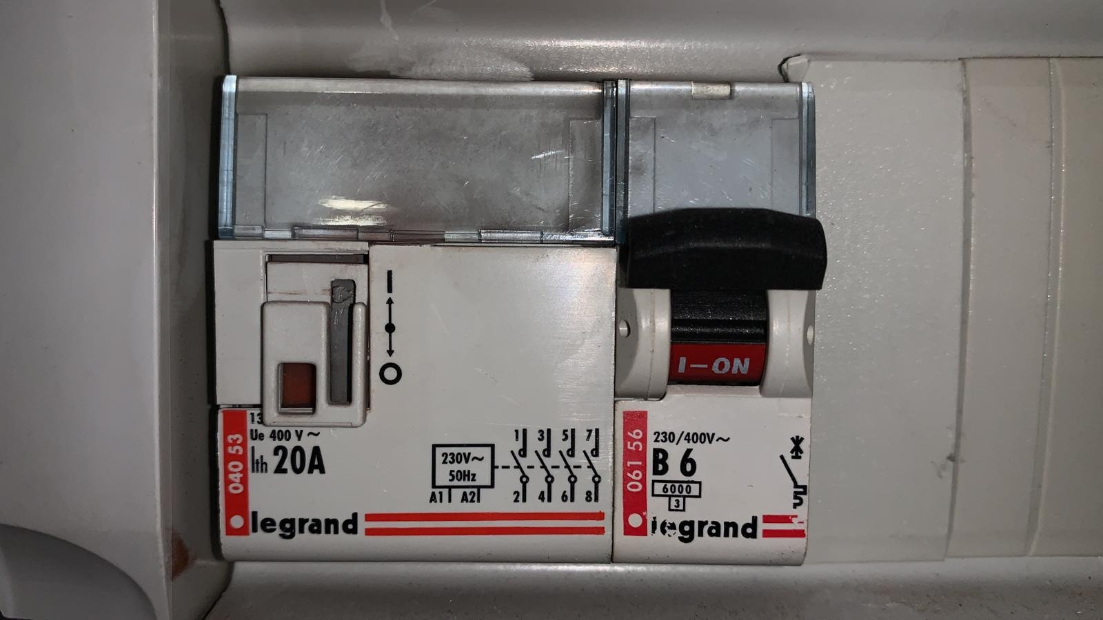

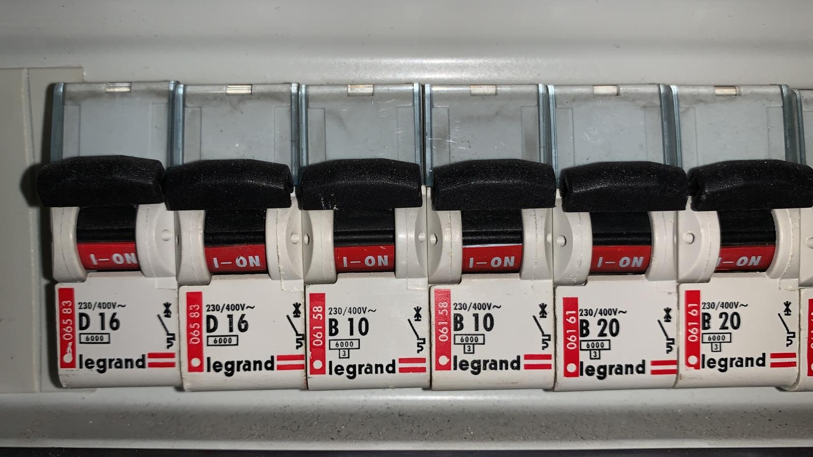

MikeSharp01 Posted June 28, 2021 Share Posted June 28, 2021 Our son and his girl friend have just moved into a rented flat in Manchester and they have a heap of problems with it even though its only a few years old. Firstly - the hot water is supplied by a tank with two immersion heaters down low at the bottom of the tank but neither appears to be heating up even though the lights are on on the wall switches from which they seem to be controlled. There appears to be no timer in the circuit anywhere - which I found odd, the pulse rate of the main meter does not change as you turn these immersions on and off and there is no hot water! Secondly, and perhaps more worrying is the CU which is not labelled and appears not to have any leakage trip devices and as it is not labelled it is hard to work out what the contactor does: See pics below: Any thoughts - what am I missing here? Link to comment Share on other sites More sharing options...

Onoff Posted June 29, 2021 Share Posted June 29, 2021 (edited) I wonder if that board has come from a commercial setting and been fitted at mate's rates? ? Weird that contactor on the left and the D breakers in a domestic setting...though all "on" they might not all be used. Legrand is good gear mind. Might be able to add a few RCBOs on selected circuits. Edited June 29, 2021 by Onoff Link to comment Share on other sites More sharing options...

ProDave Posted June 29, 2021 Share Posted June 29, 2021 Report the no hot water to the landlord, his job to fix it. And ask for a current EICR for the electrical installation as rental properties should have now. While you are at it check the provision of smoke alarms. When was the flat actually built? If only a couple of years ago it should have rcd protection on everything. Link to comment Share on other sites More sharing options...
