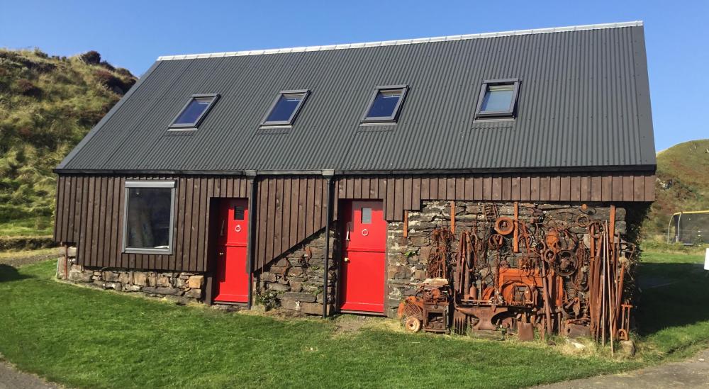

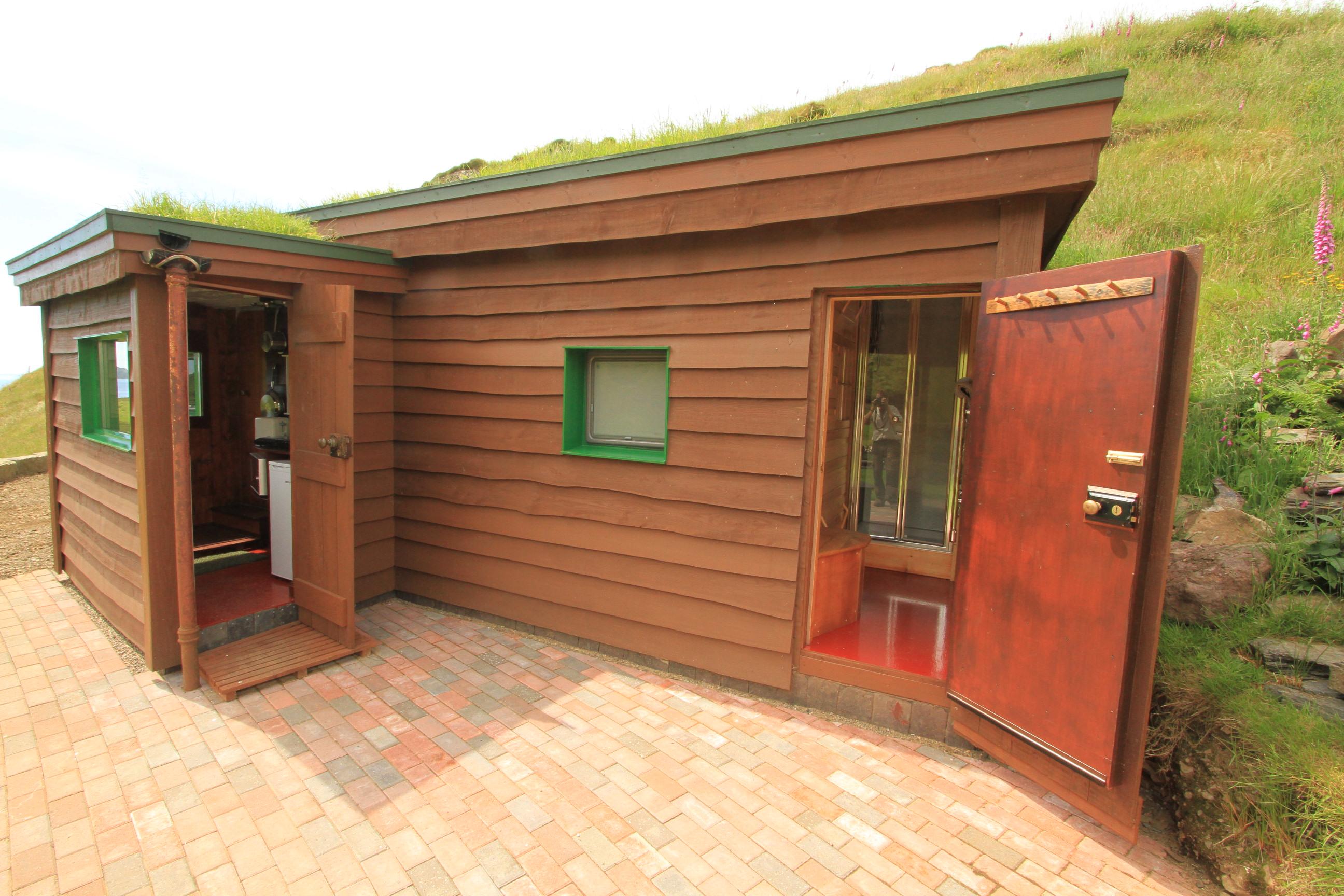

I like this: (painted board on board facade with "rukki roof" standing seam steel)
She likes this: (weathered board on board facade AND roof - rukki roof is perceived as too common out here
So in the spirit of happy wife happy life we're going to do painted board on board for both walls AND roof:
I'm fully aware that this is a daft roof covering but at this point I'm committed to giving it a go with the promise that the cuteness / timelessness of it will be worth it.

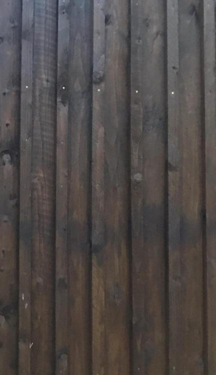

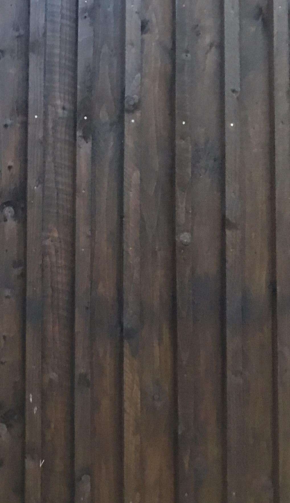

Cladding material:
The boards are ROUGH sawn and nominally 150x25 mm. 6 months ago €5/m2 would have got clean boards with  8 corners and 4 good edges. In the current climate...you get what you get and you're grateful.
On paper it's a mix of pine / spruce. Looking at it I'd say mostly pine and I'd guess it's from logs trees no more than 300 mm diameter. (so some of the grain runs in interesting directions) Lengths ordered were 3.7m and 4.9m. Lengths supplied are anywhere from 4m to 6.5m and working out which is which is an exercise for the reader. (An "I can give you a delivery date for miscellaneous wood that's probably long enough; but it you want it graded and trimmed you're paying double or waiting until winter" type situation.)
Finished sizes are in the 140-150 x 20-25 mm range depending on how dry the board is now vs when it was sawn. Some are bone dry and almost look like planed wood. Others are possibly twice the weight and look like they were chainsawn into planks.
I'm busy grading / rough trimming / stacking these at the moment.
We have "good" boards with 4 edges along their length; no holes/bad knots; no major twist or bend or cupping. These are going to be the "outboard" boards.
We have "ok" boards with 4 corners at the bottom end and 2 edges; no holes/bad knots in the centre; some twist or bend or cupping allowed. These are going to be the "inboard" boards. (2 good edges upwards and 4 good corners downwards so that from the ground you see good ends and the bad edges are turned inwards/bad ends hide inside the eaves/ridge)
We have "good but short" boards that are going to go above/below doors and windows, and be gut down into "fillers" for the eaves
And we have "bad" boards. Some are straight but have holes in them. Some have splits in them. Some have twist/cupping in them. My plan was to rip these into the "25x75 mm" horizontal battens that will support the cladding.

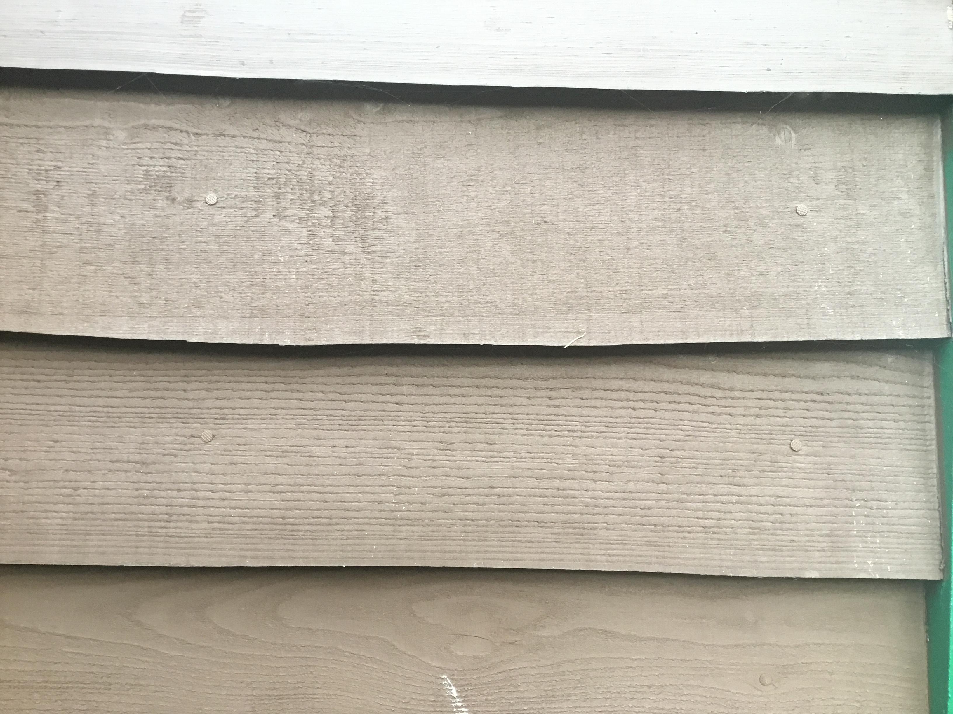

This photo gives an idea of how bad the upper ends of the "ok" boards are.
We're expecting to have lots to choose from (the order was for 150% of nominal requirement ignoring the door/window holes) and cut many of the "poor" roof boards into "better" wall boards or even  "great" battens. I've added some extra spacers in that stack and ratchet strapped it tight whilst it dries some more. Perhaps they'll decide they like their new shape. For fixing purposes let's assume that I'm trying to tame these boards though!

I have not used painted screws before - maybe something I should look into.
It works. In fixing steel roofs the best bet is an integrated nylon head the same colour as the roof. Plastic caps fall off.
Once though had a very large roof that was a special colour. Hilti dipped all the screws (and washers) in the right colour of paint. I expected it to come off in the tek gun or over a couple of years but it didn't. Presumably they knew what paint to use.
For timber screws I have simply primed and painted over screws, and it usually works. It shouldn't show from any distance. Yellowish screws on pine. silver on white and it may not need paint... not sure with brown or black.
Doesn't work if screws as waxed sadly. Might get away with it with Toolstation / Screwfix silver/gold screws but everything I find here is waxed by default for installation purposes.
Except black phosphated plasterboard screws or silver sheet steel screws. Don't want those though! (high strength and easy to paint the heads but brittle and rust within the wood in the case of plasterboard screws)
Ruddy 2021...if you see half a dozen screws...then try half a dozen screws...don't expect the same half a dozen screws to be in stock the next week or ever again! Have sourced another two screws to try. Cheapie goldscrews hopefully without wax this time. Fancy C3 rated torx screws that will definitely work but haven't found in 70 mm yet.
Need to think how to get these up on the roof AND paint them. it's a 9:12 pitch (37 degrees) and I wouldn't want to walk that / would rather avoid smashing freshly painted boards with a ladder laid on it if possible.
I think order of operations (critique welcome) should be:
- Fix 25x70 battens to roof using some 'standard' waxed screws that don't need pilots
- Pre-cut the ends of all roof boards square. Pre-drill all the roof boards using a jig.
- Pre-mark the battens for width (where the every board should go)
- Roof monkey at the ridge, Ladder monkey on the ground, and throw a rope with a noose to hoik the board up onto the roof
- One string at the eaves to line up the ends of all the roof boards for "height"
(maybe make that an "end stop" so that the boards just slide down the roof into position and we need only get the width right?)
- Ladder monkey at eaves lines up the width AND the "height" and pops a screw into a pre-drilled hole
- Roof monkey at the ridge lines up for width and pops a screw into a pre-drilled hole
- Rinse and repeat x150
- Roof monkey pops in the rest of the 4.5 x 50s or 5x50s holding these boards on through pre-drilled holes
- Roof monkey can still climb up and down the 9:12 roof using the ~90 mm gaps between boards and the battens
- Roof monkey does second / final coat of black on these "inside" roof boards; on the top face including screws AND the weathergrooves
- Predrill AND pre-paint the "outside" roof boards
- Definitely fit an "end stop"
- Noose the "outside" roof boards the same way but stack them somehow? (four boards in a gap, every 4th gap?)
- Roof monkey takes their time fitting all the screws AND painting each screw with a dab of paint after it's installed (to paint the screw and seal it to the wood as much as is possible)
- The roof largely remains climbable even though all the boards are up there
- I can tie a ladder to an "overhang" for when we get to the ends. There is an area of roof at the end (gable overhanging the deck) we are not boarding until later (when we source the deck materials and the underside of the roof materials - not for some time yet)

Fixing centres 45 and 95 on a board that's 140ish mm wide and has a 30 mm overlap works for undoing cupping and twist.
5*50 mm screws for these boards. Battens are 25*70 mm (reject cladding slit into two) use cordless drill not an impact for setting the screws.
And if you've got good shoes (e.g. hiking boots / vibram sole then rough sawn timber is walkable at 9:12 pitch (37deg) which was a surprise.
