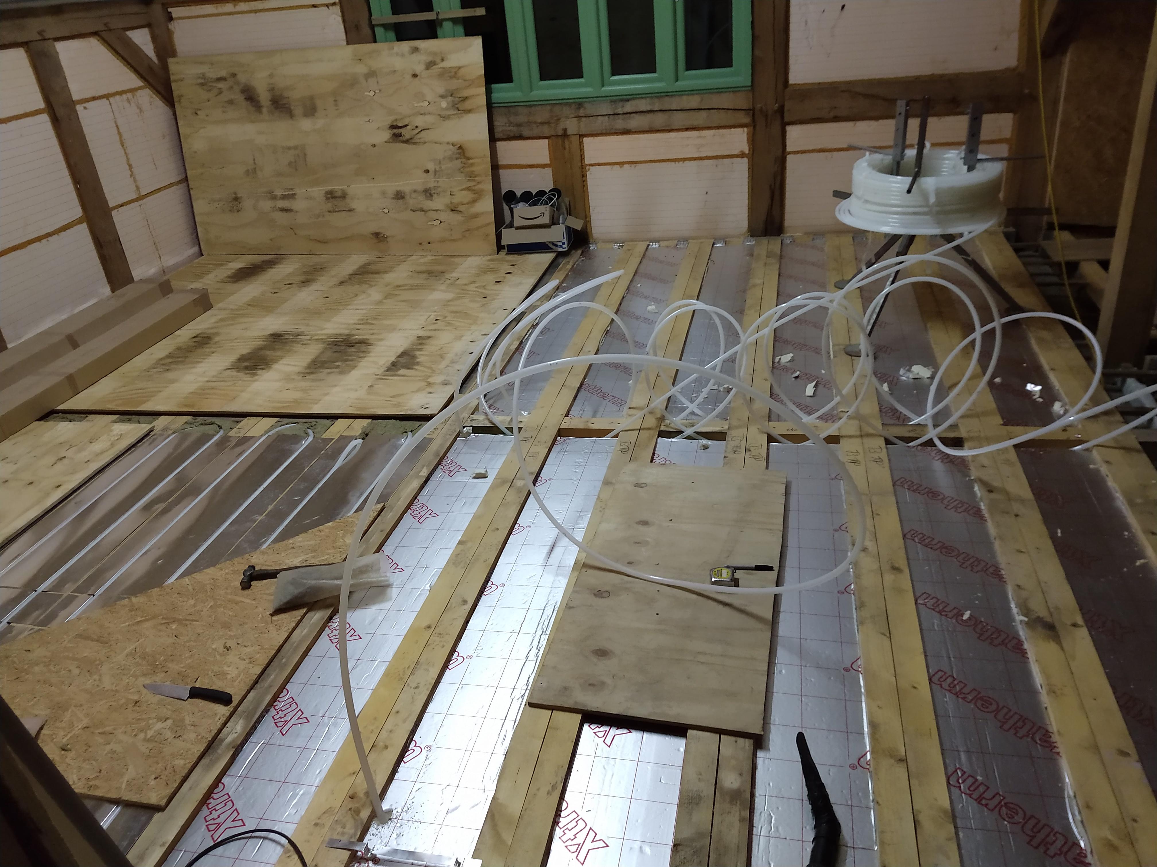

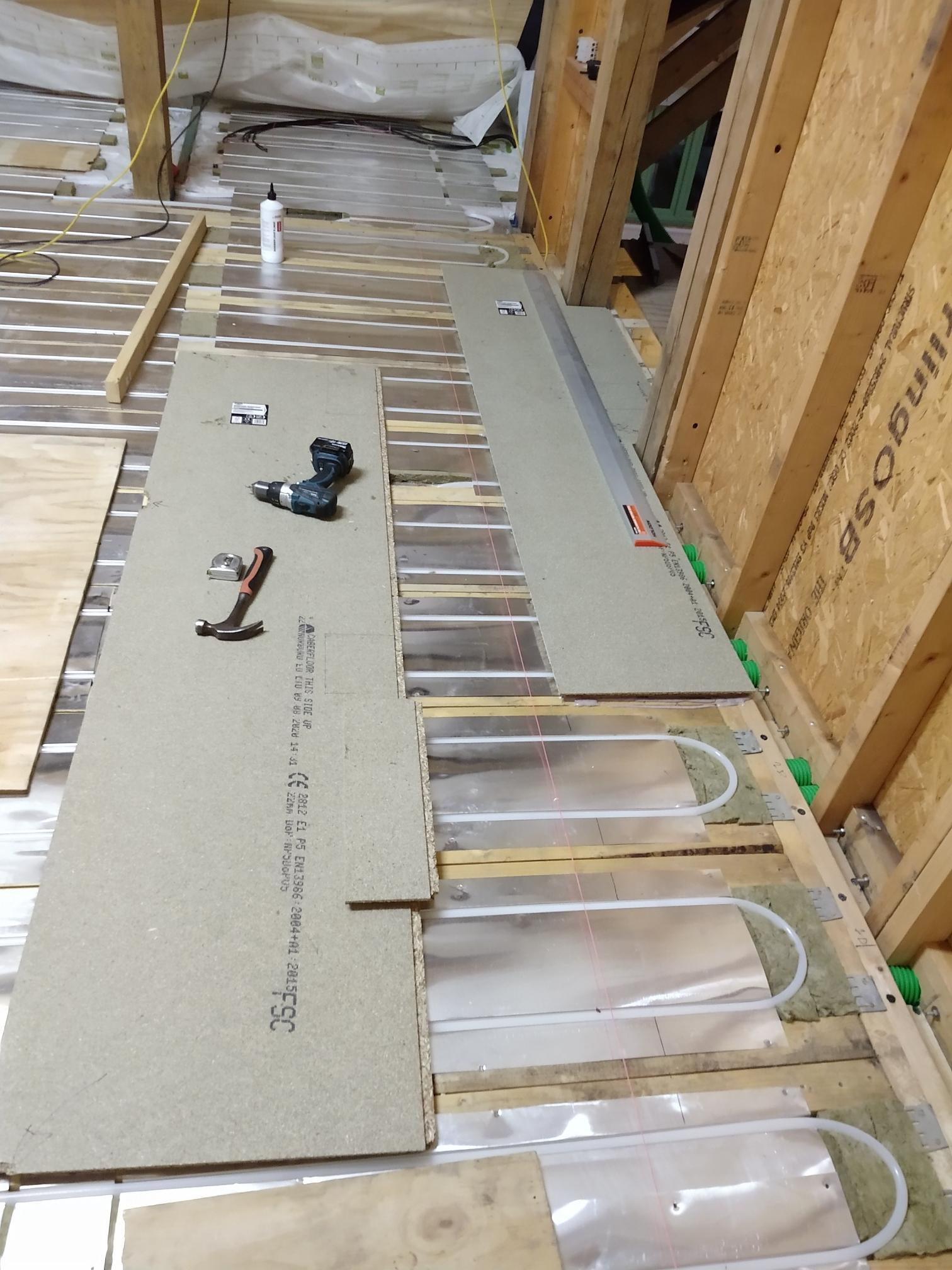

If you use flexible pipe and plan your route, posi joist can be done with no loss in height.
Here's mine half way throughIMG_20201013_212403175.thumb.jpg.b7dbbe09a9ea936ea568ece7ed940af5.jpg
You just keep your loops within the joist at the ends and cross over/ under in the middle

The other rooms I have will be done using similar layout, but using the fit from below spreader plates as is easier I think
So does that mean you have not 'notched' the posi joists but instead run the return loop through the web of the joist up to the next spreader plate?  I assumed this would create an airlock problem but maybe you have a solution to this problem?
No problem with having a loop of pipe going down.
It is when you have a loop of pipe going UP that you open up the possibility of air collecting in that loop and an air lock.
