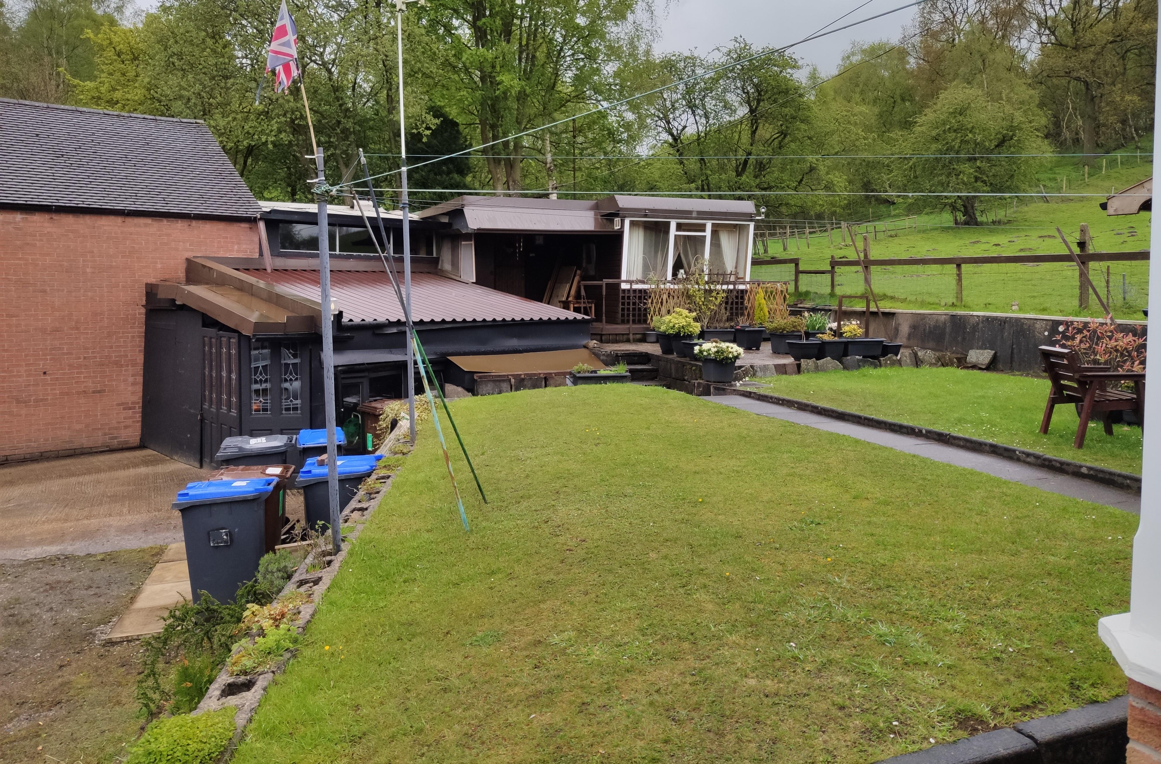

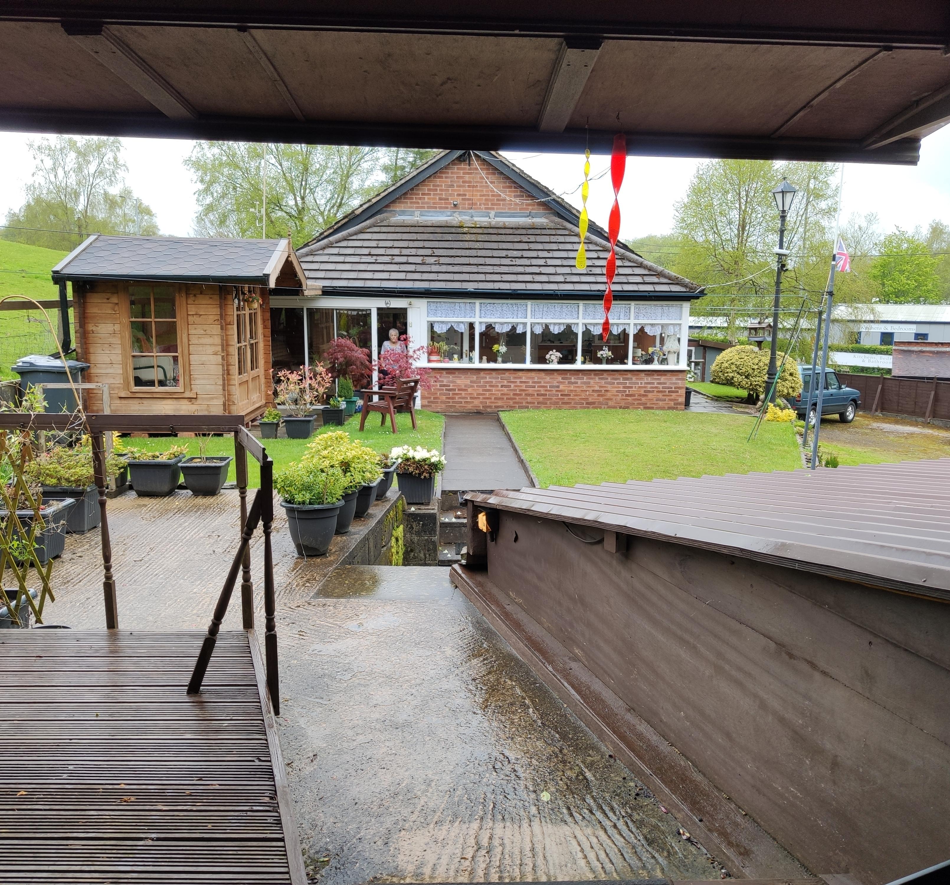

DanielAllen Posted June 24, 2021 Share Posted June 24, 2021 So we've had planning denied on a couple of points but one of which being the council states the space around dwellings means the house needs to be 22m from my grandparents bungalow (The plans show it at 17m). They're gifting us the land so they are obviously fine with it. What I don't get though is we're already demolishing and replacing a dwelling that is currently closer to my grandparents than what we're actually building on the land (14m from their bungalow). Surely this should be taken into account? I'm losing the will to live with our planning officer!! Link to comment Share on other sites More sharing options...
ProDave Posted June 24, 2021 Share Posted June 24, 2021 Post the plans. It is all to do with distance between facing windows (usually) Link to comment Share on other sites More sharing options...

DanielAllen Posted June 24, 2021 Author Share Posted June 24, 2021 0301 - East Elevation - Proposed.pdf 0302 - South Elevation - Proposed.pdf 0303 - West Elevation - Proposed.pdf 0002 - Site Block Plan - Proposed.pdf 0003 - Site Block Plan - Existing.pdf 0300 - North Elevation - Proposed.pdf Link to comment Share on other sites More sharing options...
DanielAllen Posted June 24, 2021 Author Share Posted June 24, 2021 Link to comment Share on other sites More sharing options...
DanielAllen Posted June 24, 2021 Author Share Posted June 24, 2021 50 minutes ago, ProDave said: Post the plans. It is all to do with distance between facing windows (usually) It is becuase they're facing windows she's saying. As you can what is there currently which until my Aunty passed away a couple of years ago was lived in with rates being paid on it is even closer to my grandparents bungalow than the proposed house Link to comment Share on other sites More sharing options...

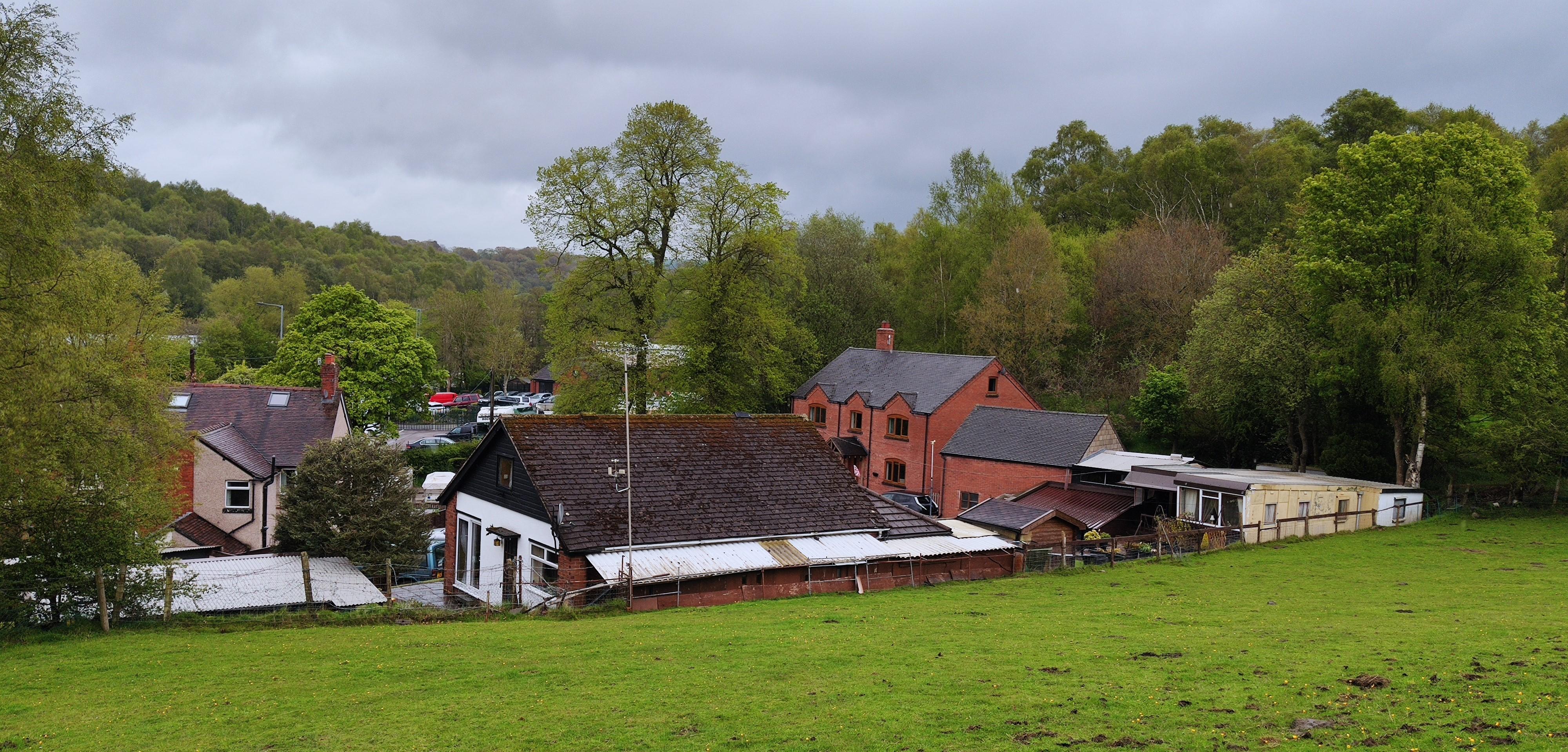

joe90 Posted June 25, 2021 Share Posted June 25, 2021 9 hours ago, DanielAllen said: What I don't get though is we're already demolishing and replacing a dwelling that is currently closer to my grandparents than what we're actually building on the land (14m from their bungalow). So what is this dwelling? Pictures, plans? Link to comment Share on other sites More sharing options...
DanielAllen Posted June 25, 2021 Author Share Posted June 25, 2021 36 minutes ago, joe90 said: So what is this dwelling? Pictures, plans? Posted them all after the initial 1 Link to comment Share on other sites More sharing options...
ProDave Posted June 25, 2021 Share Posted June 25, 2021 So are you saying that ramshackle collection of "sheds" that look to be built on the back of the garage has been lived in as a dwelling until a couple of years ago? Was the planning application therefore considered as a "replacement dwelling"? The obvious thing to me would be only have high level or obscured windows facing the bungalow and put larger windows looking out to the side over the adjoining field. Link to comment Share on other sites More sharing options...
IanR Posted June 25, 2021 Share Posted June 25, 2021 10 hours ago, DanielAllen said: What I don't get though is we're already demolishing and replacing a dwelling Does that dwelling have planning permission, for a fixed dwellinghouse, not a caravan? Could you leave some walls in place so that what you wish to do is an "extension" rather than a demolish & rebuild, or are the existing walls (attached to the caravan) not structural. Link to comment Share on other sites More sharing options...
ProDave Posted June 25, 2021 Share Posted June 25, 2021 1 minute ago, IanR said: Does that dwelling have planning permission, for a fixed dwellinghouse, not a caravan? Could you leave some walls in place so that what you wish to do is an "extension" rather than a demolish & rebuild, or are the existing walls (attached to the caravan) not structural. That's a good point about it being a "caravan" Apply for a certificate of lawful development for a residential caravan, and I believe then you can then replace it with any other caravan without further permission or even building regs. I am not suggesting you buy another caravan, but that you build a new well insulated building that is capable of being moved and fits the definition of a "caravan" and for that it does NOT need to be on wheels. Link to comment Share on other sites More sharing options...
DanielAllen Posted June 25, 2021 Author Share Posted June 25, 2021 3 minutes ago, ProDave said: So are you saying that ramshackle collection of "sheds" that look to be built on the back of the garage has been lived in as a dwelling until a couple of years ago? Was the planning application therefore considered as a "replacement dwelling"? The obvious thing to me would be only have high level or obscured windows facing the bungalow and put larger windows looking out to the side over the adjoining field. Yes with rates paid! My family on that side has never had much money so they made do. My aunt lived in it until 2016 I think it was! The existing use was cited as "C3 Dwelling House; existing derelict/disused caravan house" on our application. The description is "Proposed New Detached Self-Build Dwelling House" Her main issue seems to be the distance between the properties, she's never mentioned about obscuring the windows to overcome this Link to comment Share on other sites More sharing options...
DanielAllen Posted June 25, 2021 Author Share Posted June 25, 2021 8 minutes ago, IanR said: Does that dwelling have planning permission, for a fixed dwellinghouse, not a caravan? Could you leave some walls in place so that what you wish to do is an "extension" rather than a demolish & rebuild, or are the existing walls (attached to the caravan) not structural. They aren't structural unfortunately and the caravan dwelling is over 60 years old now, some facings and the roof has been changed but nothing we could do with it to make the application just an extension Link to comment Share on other sites More sharing options...
