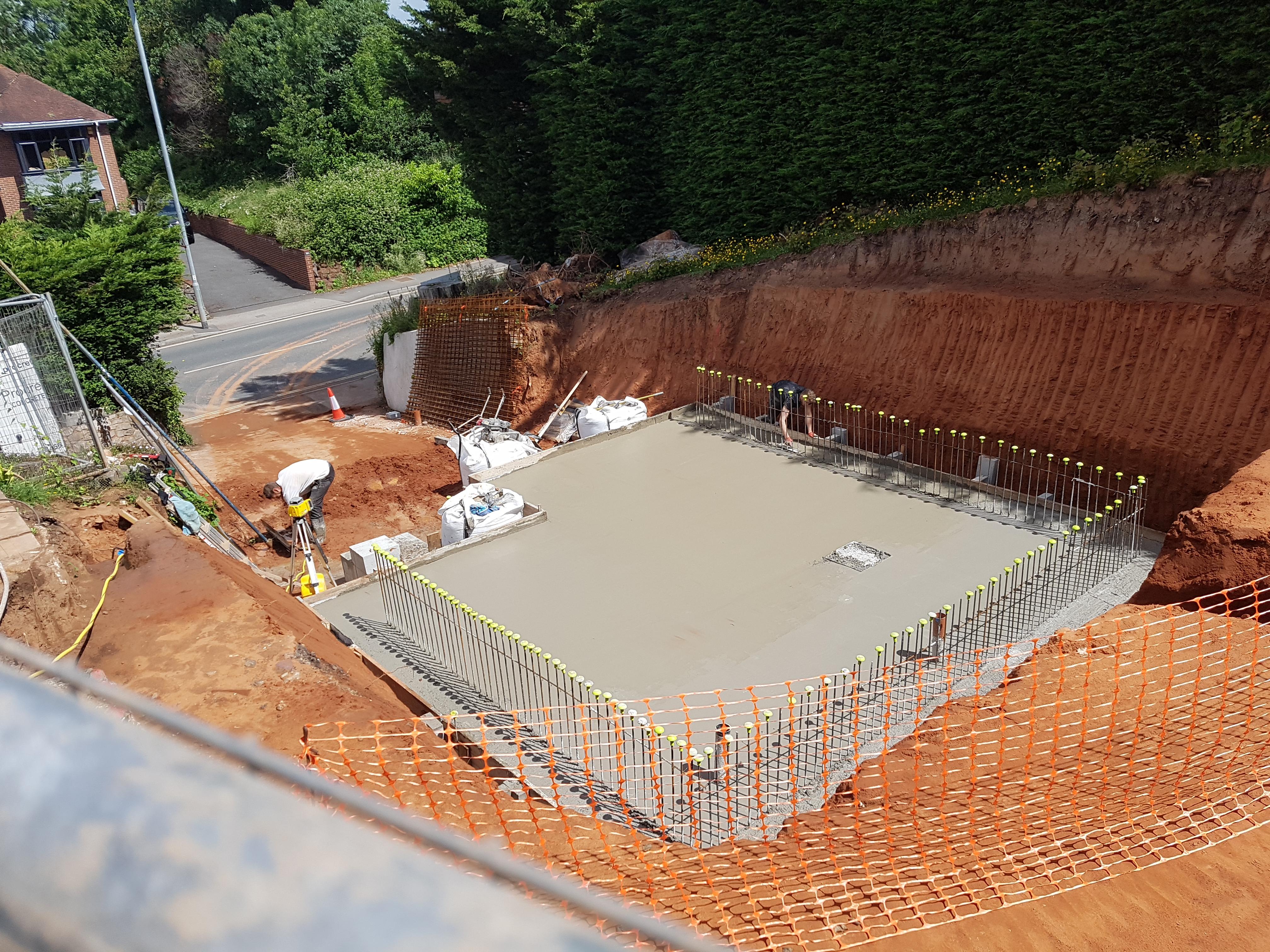

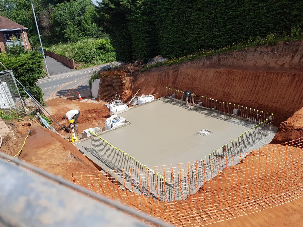

Moonshine Posted June 25, 2021 Author Share Posted June 25, 2021 Slab laid, 120 slump, though the gw was complaining it was going off too quickly 2 Link to comment Share on other sites More sharing options...

Ronan 1 Posted June 25, 2021 Share Posted June 25, 2021 4 hours ago, Moonshine said: Slab laid, 120 slump, though the gw was complaining it was going off too quickly ??if he struggled to work it at 120 he'd have been in big trouble had he got it at 80 like he wanted.... I'm sure your just glad to have it poured, congrats ? 1 Link to comment Share on other sites More sharing options...
Moonshine Posted June 26, 2021 Author Share Posted June 26, 2021 On 25/06/2021 at 18:38, Ronan 1 said: I'm sure your just glad to have it poured, congrats ? Thanks, it's a big weight off my mind now it's done. Appreciate your informed help massively! 1 Link to comment Share on other sites More sharing options...
