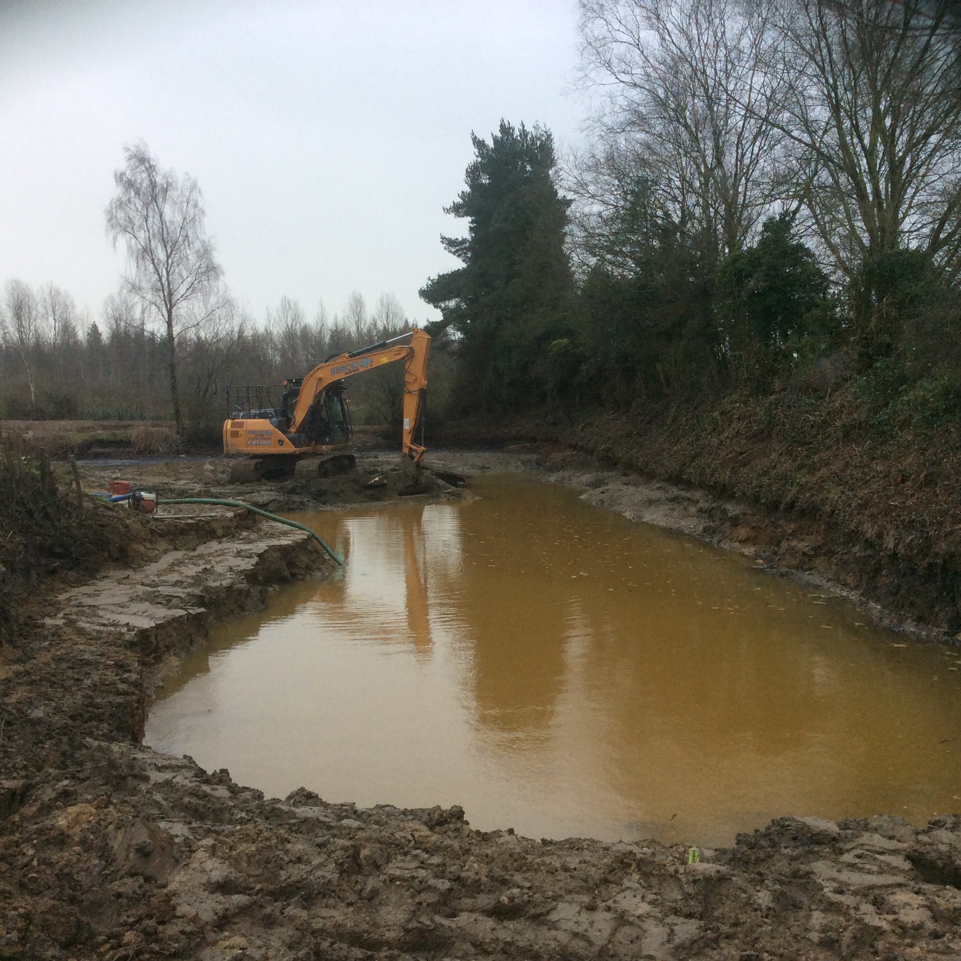

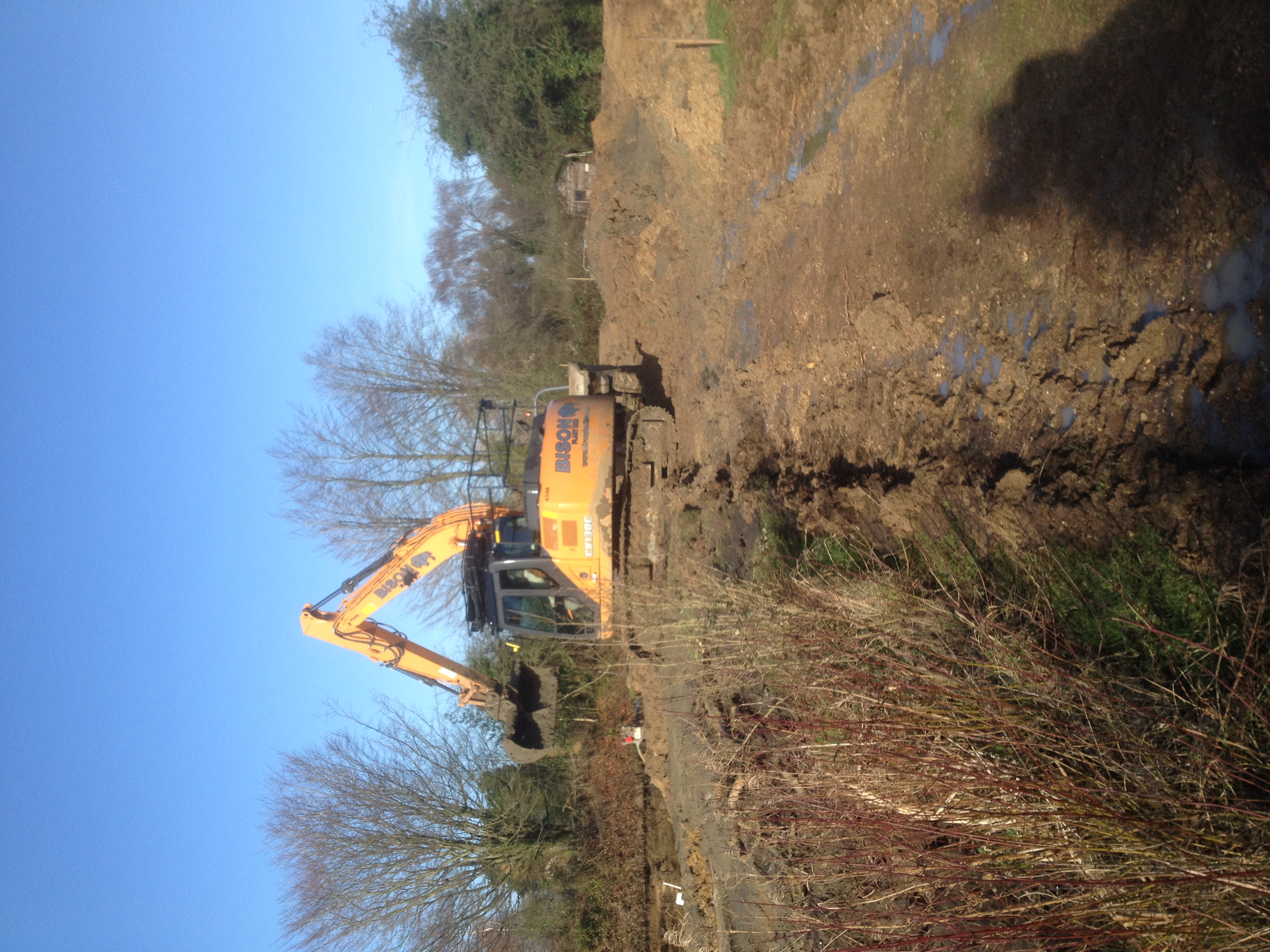

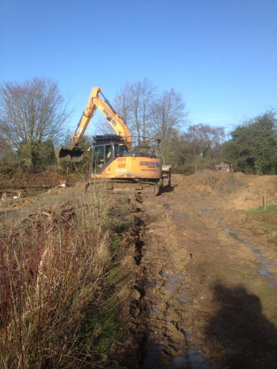

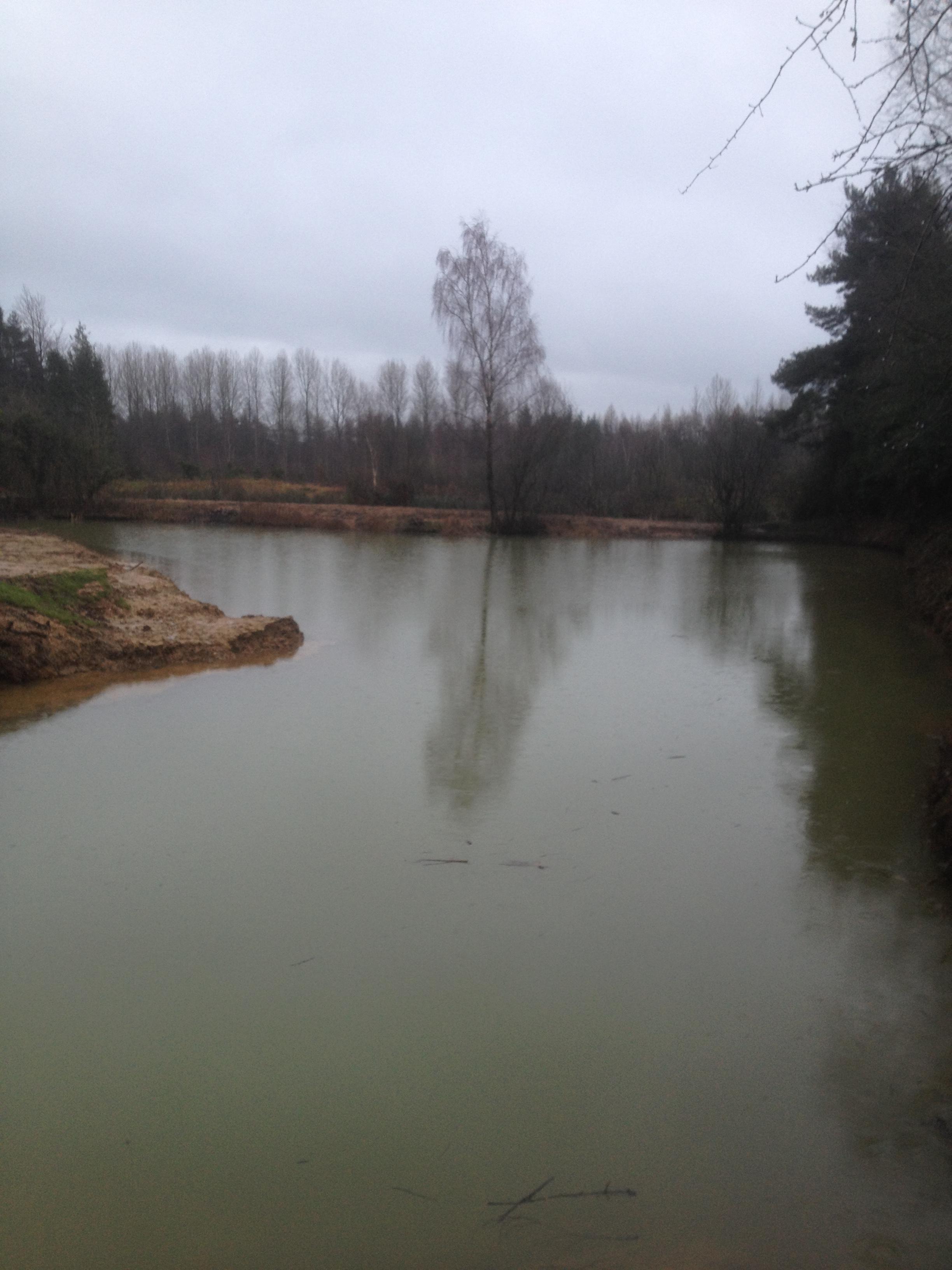

Russell griffiths Posted March 10, 2017 Posted March 10, 2017 Do it don't tell anybody. We have 3 lakes and a number of large ponds, every time we look into getting consent for something it ends up costing us a fortune. Tell nobody don't upset anybody doing it and get it done. The one in the pic is about a third of an acre, took a week with a 14 ton machine. No spoil left the site cost £1400 to dig and about £200 to plant it and re,seed around it with a wildflower mix. But then again don't listen to a word i say I'm just a bit dodgy. ? 2

vivienz Posted March 11, 2017 Author Posted March 11, 2017 Lovely pond, Russell. It looks a little bigger than our planned one, but OH seems to be getting more ambitious by the day. Well now, Peter W, this pond could, indeed, be used for water storage for the stock. In fact, thinking about it, that could be its main purpose in life. Ahem.

vivienz Posted March 12, 2017 Author Posted March 12, 2017 Hi Russel, Did you line your ponds with anything to retain the water?
Russell griffiths Posted March 12, 2017 Posted March 12, 2017 This was going to be a question I was going to ask, 1, where is the water coming from? 2, how are you going to keep it in the hole? 3, as far as I see it if you dig below the water table it will fill up on its own, but it will go up and down as the water table does. Your water will disappear two ways. One evaporation, two it will run out the bottom and sides of the hole. So you really need to do a bit of testing. Dig a few test holes and see what the ground is like. We are on gravel with a very high water table, as you can see from my pics we have more trouble trying to keep the water out than keeping it in.
