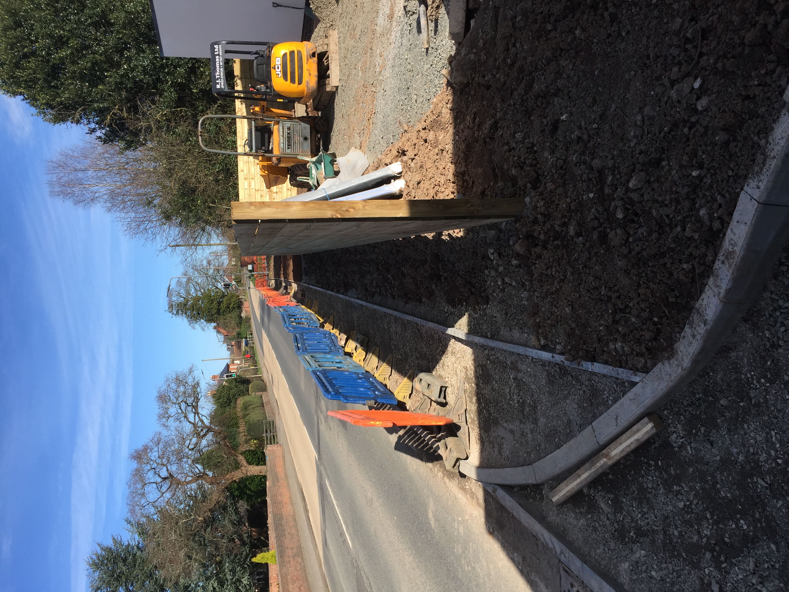

Trw144 Posted March 9, 2017 Share Posted March 9, 2017 Before I call the planning enforcement officer, can anyone tell me what the legal situation is... The planning permission on our plot shows a hedgerow fronting the road that passes by, and it our intention to plant a hedgerow on this boundary. However, inside of this boundary, we have already erected a 6ft fence to give us privacy whilst the hedge grows, and ensure our two young children (3 and 5) are kept safely back from the road. Because of this, it would appear that someone has contacted the local planning enforcement officer to say that we are in breach of the planning as we have a fence, not a hedge. My belief, rightly or wrongly, was that, provided I planted a hedge on the actual boundary of the property, then if I decided to lose a bit of garden and erect a fence on the inside of my boundary, then I am entitled to do this. Once the hedge has grown, no one will see my fence anyway. Does anyone have any experience or knowledge of this area? Link to comment Share on other sites More sharing options...

Trw144 Posted March 9, 2017 Author Share Posted March 9, 2017 Thanks Ferdinand, yes I think the grey area is what the term "next to a highway means". From the road in-front of the property, I have a 1.1m wide pavement (just installed), around 800mm for the hedge to be planted, and then my fence. At the end of the day, the hedge will eventually grow above the fence so it does nt really make any difference. Link to comment Share on other sites More sharing options...

Trw144 Posted March 9, 2017 Author Share Posted March 9, 2017 Here s a pic.. Link to comment Share on other sites More sharing options...

Trw144 Posted March 9, 2017 Author Share Posted March 9, 2017 That gap is longer than an arm so you would have to trespass! Link to comment Share on other sites More sharing options...
