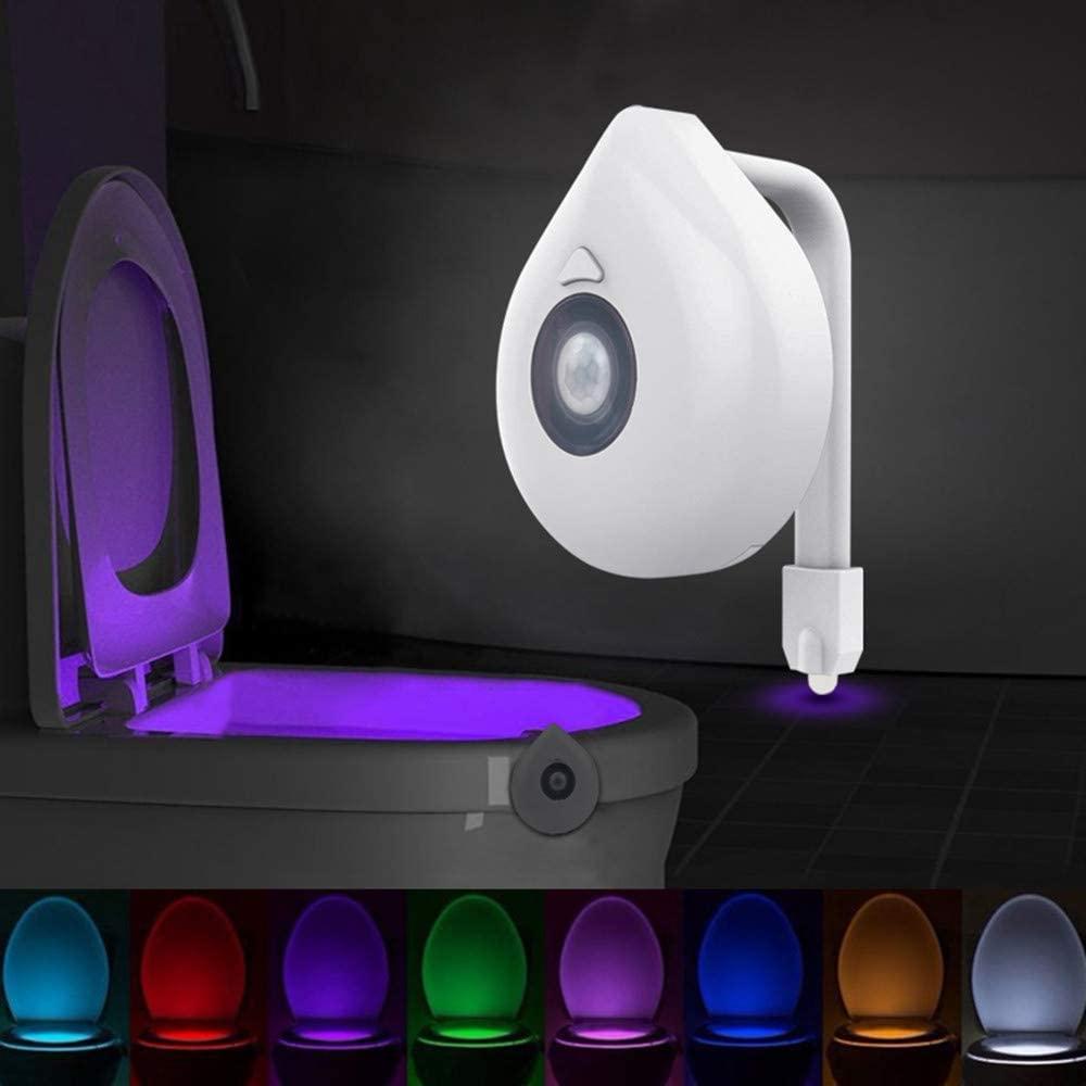

patp Posted June 13, 2021 Share Posted June 13, 2021 Wish I had known this earlier Peeps may remember my struggle with having an en suite because of the disturbance to my sleep when OH goes to the bathroom. I, eventually, caved in and we have incorporated an en suite into our build. The sparkies tell us that you can get vanity mirrors that switch on with a wave of the hand when the door is closed. I really wanted a night light in there as you can get red ones designed to not disturb our circadian rhythms. Link to comment Share on other sites More sharing options...

Onoff Posted June 13, 2021 Share Posted June 13, 2021 3 hours ago, patp said: Wish I had known this earlier Peeps may remember my struggle with having an en suite because of the disturbance to my sleep when OH goes to the bathroom. I, eventually, caved in and we have incorporated an en suite into our build. The sparkies tell us that you can get vanity mirrors that switch on with a wave of the hand when the door is closed. I really wanted a night light in there as you can get red ones designed to not disturb our circadian rhythms. Sorted! ? https://www.amazon.co.uk/Automatic-Operated-Presents-Bathroom-Washroom/dp/B08HQFGS6L/ref=asc_df_B08HQFGS6L/? 1 Link to comment Share on other sites More sharing options...
patp Posted June 14, 2021 Share Posted June 14, 2021 Fantastic! Thank you so much. Link to comment Share on other sites More sharing options...
